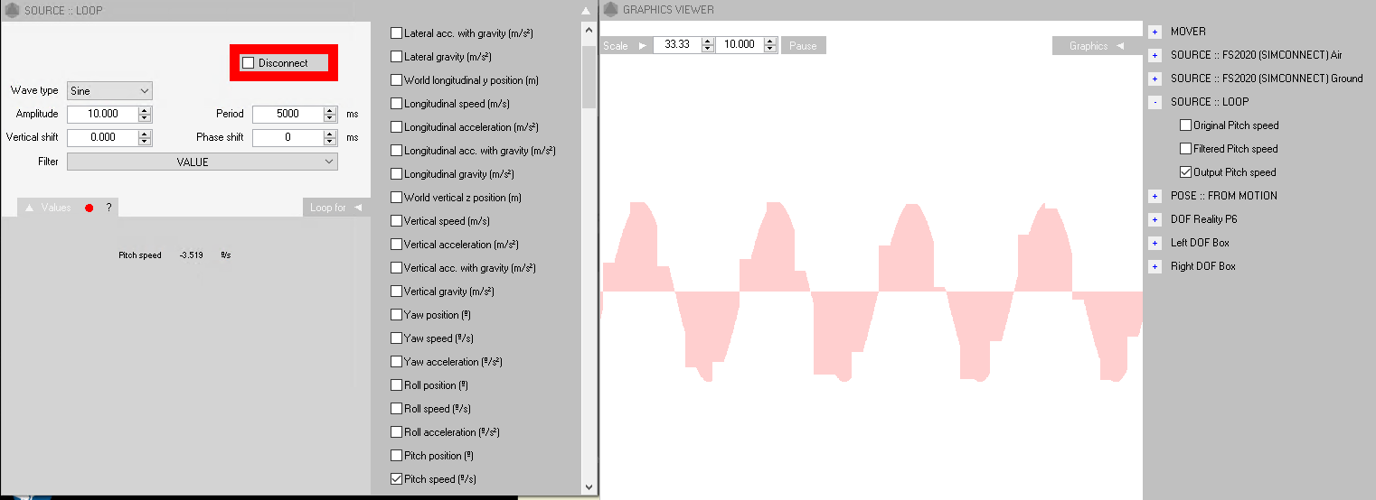

    I'm taking my first steps with setting up filters, so for starters I have used the loop source to generate a sine wave on the "pitch speed" channel, and the graphics viewer to display that curve (no filters involved so far). As you can see in the attached screenshot, the signal jumps about once every second. The graphics viewer output stops at that point and continues after a small jump.
    Does anybody know what might be causing this?

    It is apparently the FlyPT process as a whole that gets held up every second. If I grab one of its windows with the mouse and quickly move it around, it gets stuck for a moment every second. Doing the same with an other window (like notepad, for instance) moves around smoothly.
    </edit>
    <edit 2>
    I also had the FS2020(SIMCONNECT) source in the config, but not connected. After deleting that source it ran smoothly. Strange, but now I can continue exploring filters :).

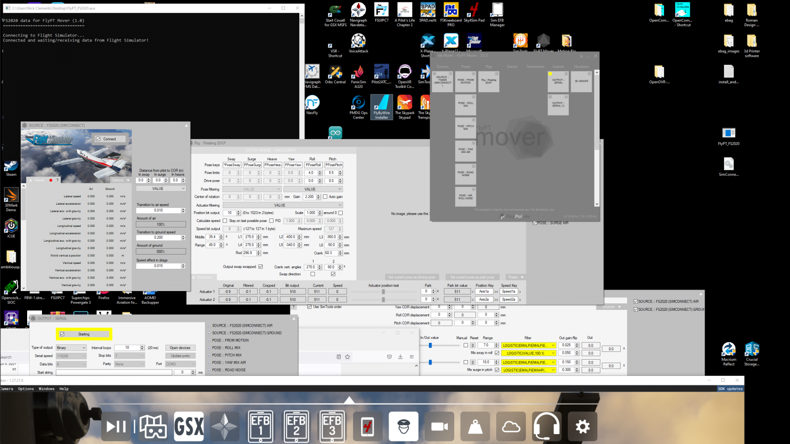

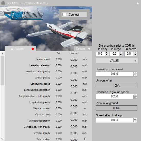

    I have just finished building my 2dof Rig , similar to RonanDesign. (A big thankyou to you :) ) Im now trying to connect to MS2020, but Im not seeing any telemetry data when I hit the connect button.!!! I have merged Ronandesigns Mover file.
    Any help will be much appreciated.

    I never had any problem with that. Make sure you have latest FSUIPC installed, the correct version for MSFS. Connect box turns read and I can see telemetry data every time. The only exception is when IRQ changed on my rig (you can force the same IRQ all the time in Windows) and if IRQ is not correct FlyPT can freeze and not connect.

    I have made sure I have FSUIPC up and running , also FlyPT_FS2020 started 100S after MS2020. As you can see the FlyPT_2020 has the message Connected and Waiting/receiving data from Flight Simulator?? But still no telemetry data in FlyPT Source??? Any ideas??

    Do I need to have the Payed for version of FSUIPC?
