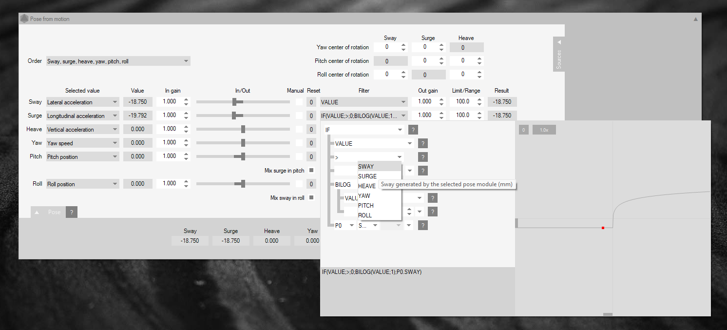

    A glimpse at if and variables from anywhere in mover.
    Here, picking the result of sway in the pose.
    I can add Sin Cos... easy to do right now.

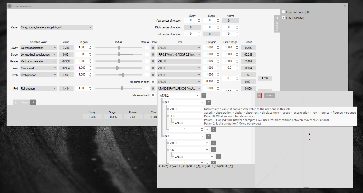

    Maybe add a INTANGLE and DIFANGLE function? This would integrate or differentiate angles in a rollover proof fashion. I am no math genius but from stack overflow I got the impression it could be solveld like this
    DIFANGLE = ARCTAN2( DIF(COS(Value), DIF(SIN(Value))
    What it is basically doing is building vectors out of the angles, differentiating the values for the sine and cosine separately, and then converting the differentiation result (the change) back to an angle with the arctan function with two parameters. I guess that would then give you the difference angle between the samples.
    That's at least how I understood it could be done.

    New graphics, resizable and we can select colors. Better for some tests I needed:
    @Avee , you mean this:
    Did not test or think about it, but it's already possible.

    That DIF function seems to already have an angle option? It's not in 3.5.3 though.

    No, it will be in the new version

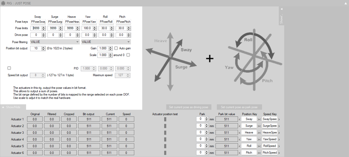

    Hi, you need to use the rig called "Just Pose".
    With that, the "Actuators" are the pose.
    You use those actuators on the output.
    The actuators use the keys: Yaw, Roll, Pitch...
    So when you use those actuators, you are sending the pose.
    Something like this:

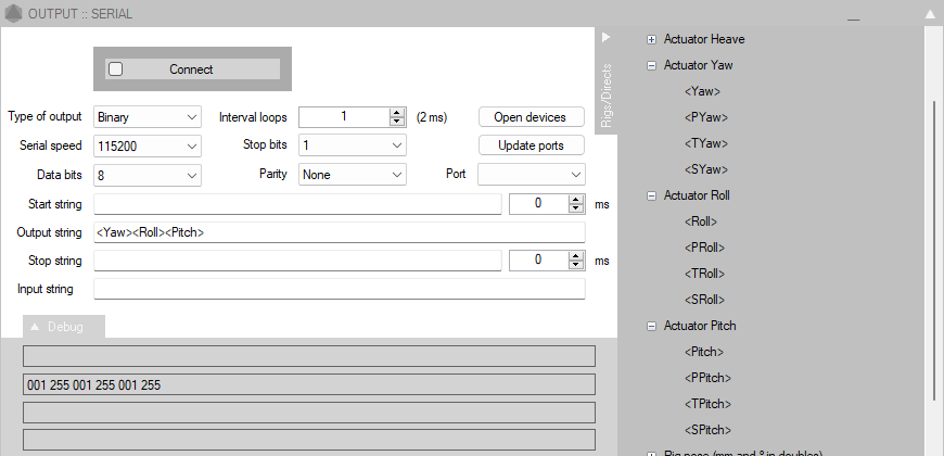

    Hi @pmvcda , I tried what you suggested and it doesn't seems to work. Here the settings: Immagine 2023-01-23 163624.jpg
    Not sure what is going on. SMC3 seems to work fine. I can move the motors and change pwr and direction. Any suggestions?

    I just posted an example, you need to setup the output to use it with the smc3.
    See here: https://www.flyptmover.com/outputs/smc3-and-sps

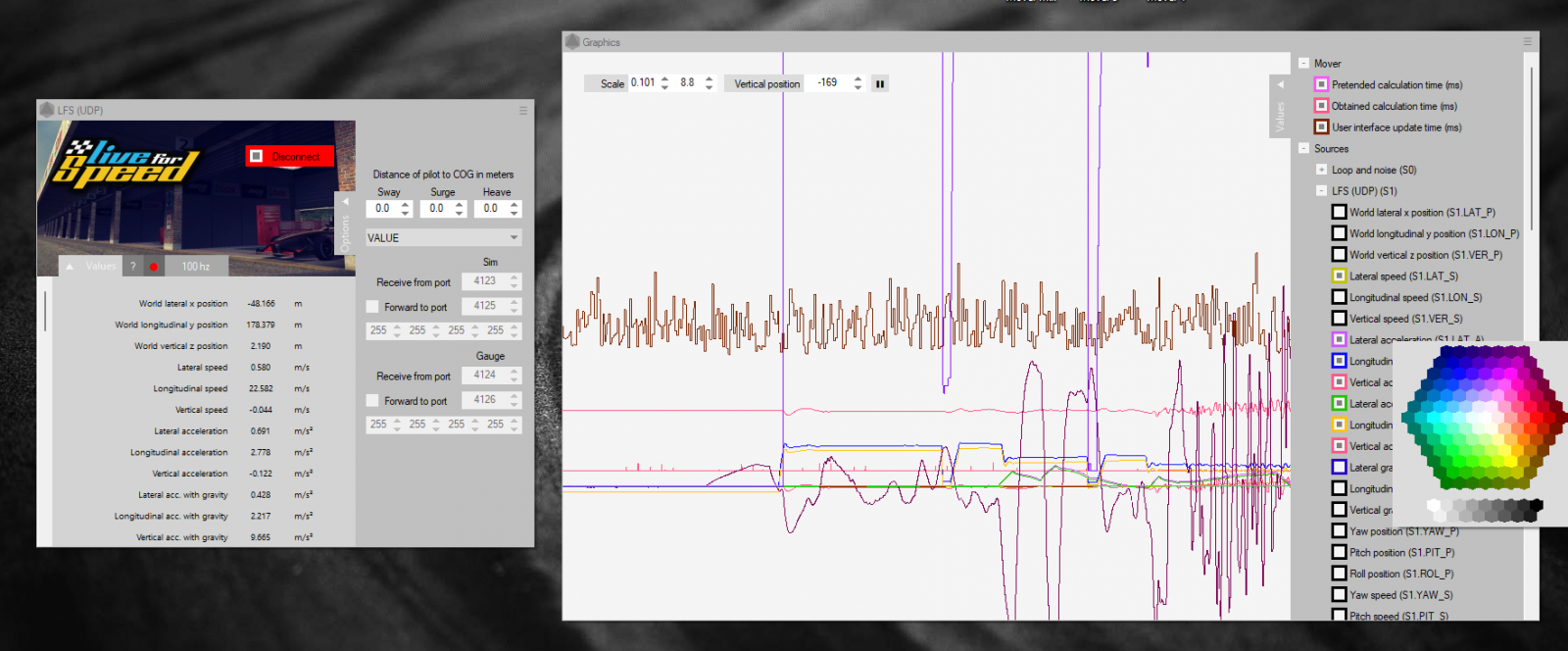

    Sorry for the dumb question, but I have updated to the latest mover and my udp sources stopped working (LFS, Dirt, Dirt Rally). I may have changed something in simtools also. But if I'm not wrong, the udp sources bypass simtools. So, that should not be the problem. Do the games using the udp sources needs to be patched? Is there anything special to do? It's been so long since I messed with Mover (and I'm too lazy to read the 154 pages).
    I did had movement with LFS before I updated and Mover works like a charm with Assetto.
