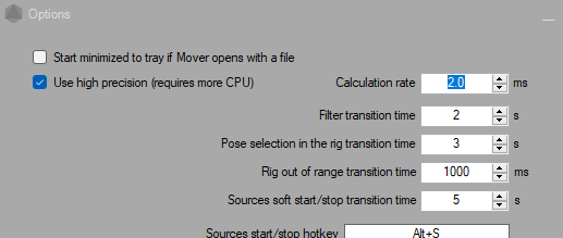

    Sorry if this has been asked before, but I couldn't find anything searching on google.
    I'm a bit confused regarding "Calculation rate" and its relation with the sampling frequency of the raw telemetry data.
    Say for example that my game pushes telemetry data at 100Hz.
    Is there a point then to have calculation rate anything lower than 10ms ?
    In this case, what happens when I set the calculation rate to 1ms ?
    Is there some upsampling happening somewhere on the original data ?
    How does this impact the window upon which the filters act ?
    Having experimented with it, I am quite confused: lowering the calculation rate (i.e. faster) seems to increase the overall gain of the system, and increasing the calculation rate (i.e. slower) seems to muddy everything.
    I have experimented this on iRacing (which I think FlyPT is acquiring telemetry at 60Hz, but I can't be sure, as iRacing also allows for 360Hz telemetry with a delay of 16.6ms).

    From what i recall, iRacing has 360Hz, but not for all the data. Mover uses 60Hz.
    You can change the rate in Mover, but this affects the filters behaviour.
    In my opinion, you should keep the 2ms just because almost everyone is at 2ms and it will be easier to share setups and any comment about filters presumes you are using that frequency.

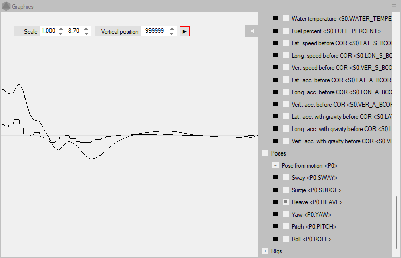

    Most of the filters are sample based, not time, so the results are different if you change the frequency.
    Also, even if the game send at 10ms, using 2ms gives you more resolution on the filter output:
    The squared line is LFS data at 10ms, the smoother one is a filter over the same data at 2ms, "erasing" the square effect of the curve and giving you more resolution.
    But this is just guidelines, Mover allows you to experiment.
    EDIT:
    The muddy effect happens in low pass filters, because passing from 2ms to 1ms is like apllying the low pass 2 times to the same data. EMA filters are sample based, producing that effect when you change the rate.

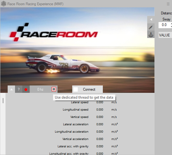

    I did not update the iRacing source yet, but frequency will show like you see in the LFS source:
    100Hz
    This is a UDP source. In the Shared Memory:
    We can use a dedicated thread to get data at the frequency of the game instead of Mover frequency.
    This is all dependent on how we get data and how we check if the received data is new.
    For iRacing, I can make it next, but getting it at 360 is no problem, unless something changed recentlly.

    Ok, from scratch:
    User interface in Mover works at the same frequency of Windows (usually 60Hz) unless the load is too high slowing it down.
    The load increases with more Modules, and some are heavy in visuals.
    Mover calculation thread uses an interval of 2ms by default, or 500Hz and is independent from the UI.
    This means all calculations (including filters) are performed at that frequency. You can use 1ms or less in the high precision increasing the frequency or lowering (change it in options).
    To output data I allow the user to say how many calculations exists between each output ()Interval loops). So if we use 2ms and we specify 5 calculations, the output is sent at 10ms or 100Hz.
    So at 5 calculations 4 are discarded and not sent to the hardware.
    Now the sources, your main question:
    We receive data at the frequency the games send it. We get all the packets sent by the game in a dedicated thread.
    Each time a packet is received, the data in Mover is updated.
    Meanwhile the calculation is running and reads the stored data in Mover.
    If the frequency of Mover is lower than the game frequency, you might loose some packets, but I don't know any game sending at more than 500 Hz.
    Since the calulation uses an higher frequency, it uses the same value in multiple calculations.
    For example game sends at 60Hz, Mover works at 500Hz, the same value is used around 8 times.
    There's no interpolation in the received values. If you want to, you can use a filter to smooth and generate the interpolation.
    There's many internal details that change with each game, like timers, identify new packets or calculate some values from others...
    That's another problem.
