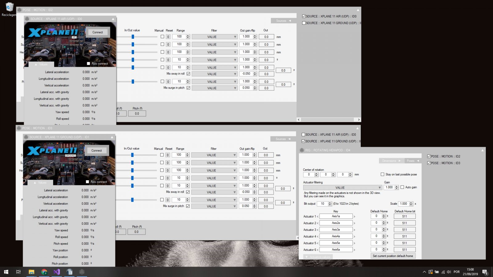

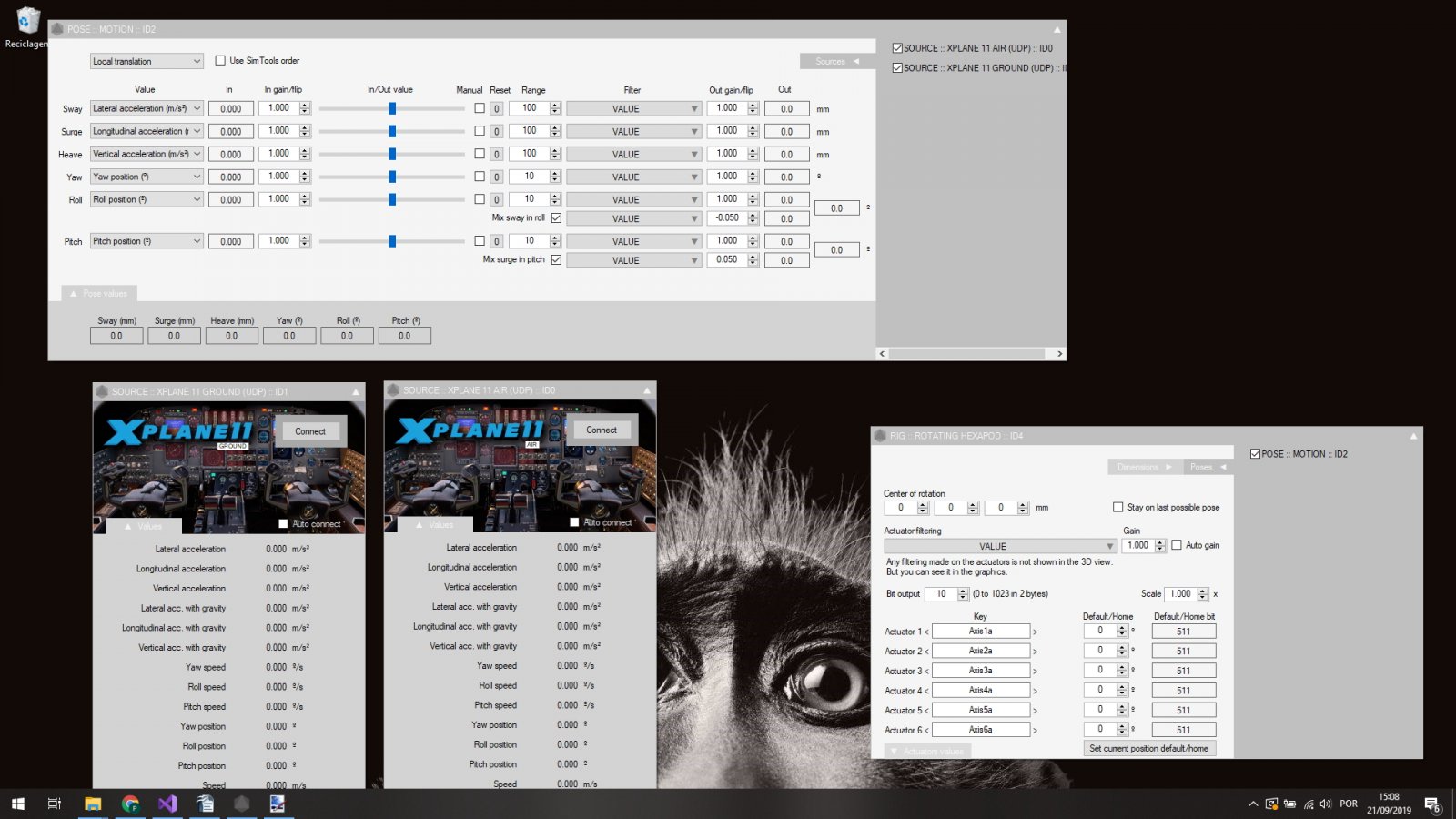

    You should see values.
    But you are showing the window for air.
    If your plane is in the ground, only the ground window is updated.
    The 17, is strange... But you have to check the values I said above.

    Small update. Ignore the post above.
    Ok, everything goes in to the “ground” window but 0 everywhere in the “air” window

    Got it thanks

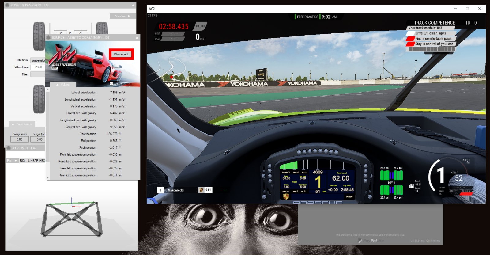

    FlyPT Movers 2.1
    New version in the first post.
    - Corrected Assetto Corsa source (for AC and ACC)
    - Corrected some directions in other sources
    - Corrected small bug when disconnected from a source

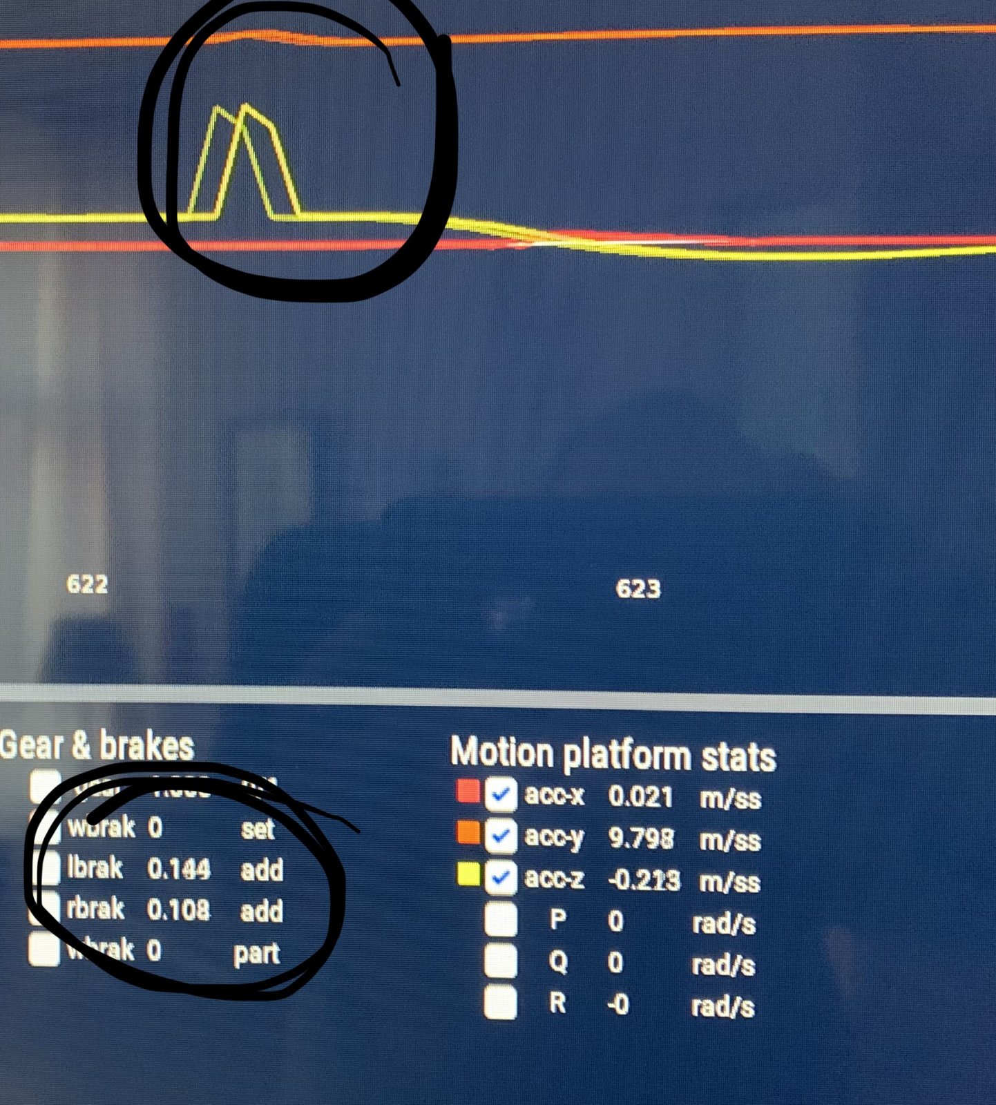

    Issue Nr. 1 is a back longitudinal kick at the very end stop. It concerns the ground speed below 2.1kt. It produces a huge sharp corner (up to 0.5, - 0.8G) when the braking force is above 0.1
    I talked with A. About this problem and he advised to apply a LPF on those.
    Maybe in the future it will get corrected but I am afraid it will take ages.
    There is also some lateral spikes at very low speeds which would need to be filtered or skipped.

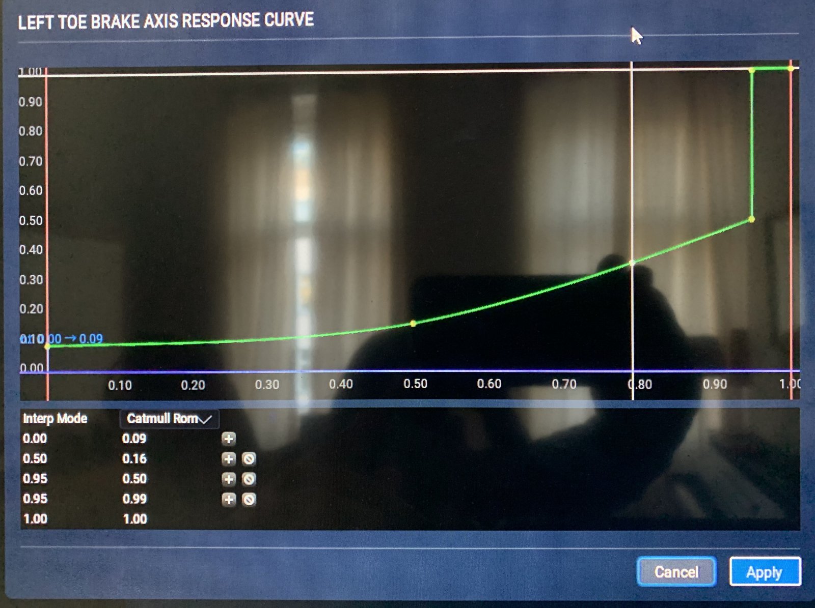

    For a better control of the brakes I advise a custom curve as natively, from at least a half of pedal course a full braking force is applied. (For Austin this is a realistic behavior.)

    The spike...
    Does this happens in all situations under that speed and braking force?
    If so, it might be possible to ignore the spike in the source. I can try to see if I achieve that effect.

    Sipkes first maybe. This should give you a better idea about what I have in mind:
    It happens mostly with a braking force above 0.1 and affects the ground speed up to 15-20 kt
    It’s pain in the ass because we need a coherent behavior especially the longitudinal one also at low speed.
    I would try
    - a “triple order EMA LPF” on side acceleration below 20kt only if brakes are applied greater than 0.1
    - a “triple order EMA LPF” on longitudinal acceleration below 5kt only if brakes are applied greater that 0.1
    Do you have a better idea ?

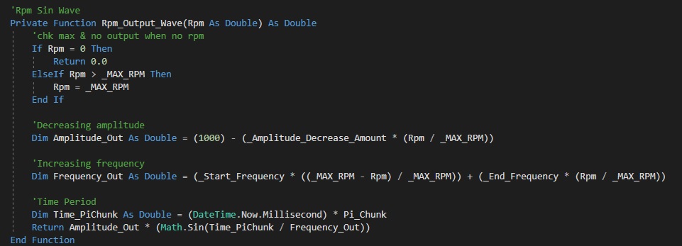

    Under “warnings” you have a variable going from 0 to 1 ( 1 is a complete stall )
    I was clearly told that in Cessna, not only the controls but the entire plane is shaking.
    You could build up a sine with a fast period / very low amplitude just after it starts (let’s say from 0,3 stall variables at 20Hz ) and increasing the amplitude and decreasing the period as it reaches a full stall. (At 5Hz for ex.)
    When I get a chance I will mesure it with phyphox in Cessna until now real pilots like @Dirty could maybe share their experience.
    EDIT:
    The sine for RPM could start at 30hz at ilde with higher amplitude and increasing the Hz rate as RPM goes up

    Btw. The RPM code left by @yobuddy has made many users happy

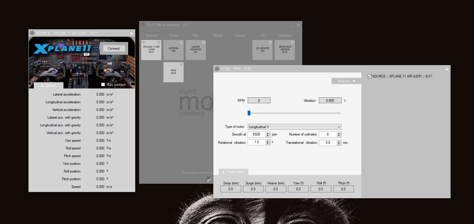

    For RPM we have already a pose calculation:
    Add -> Pose -> From Motor
    I didn't test it much.
    Give it try and see if we need anything more.
    Don't forget to add it to the rig:

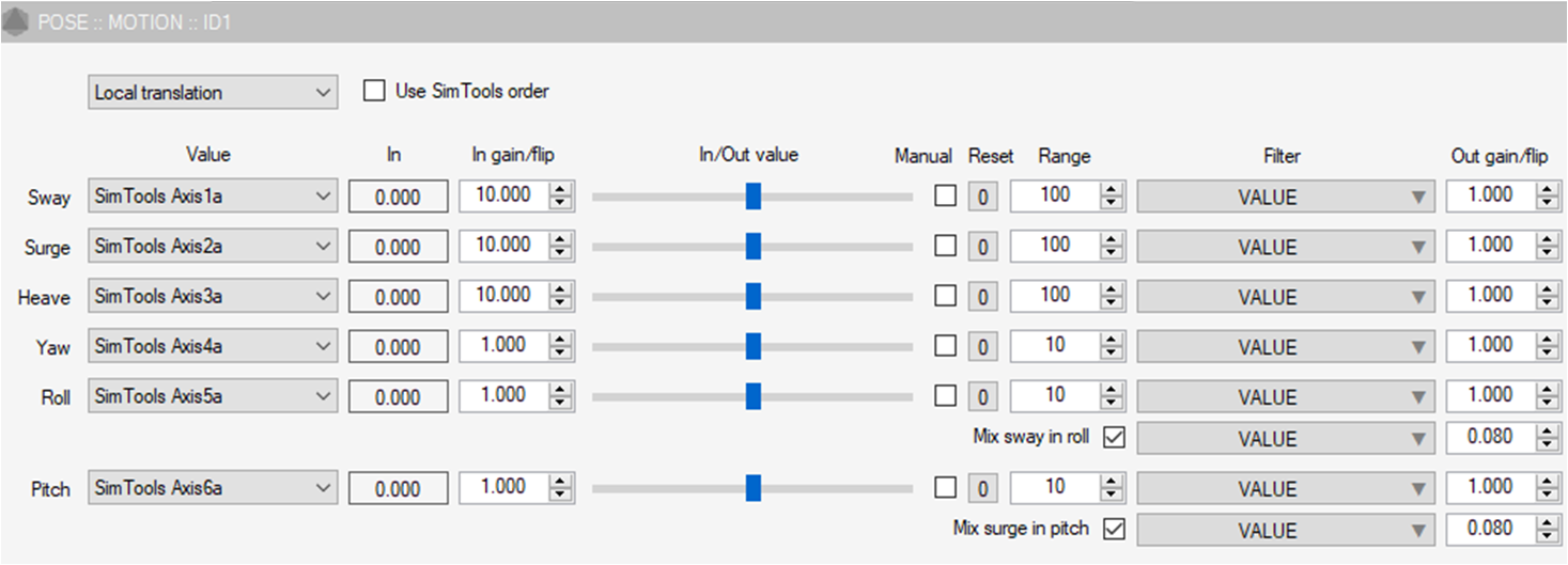

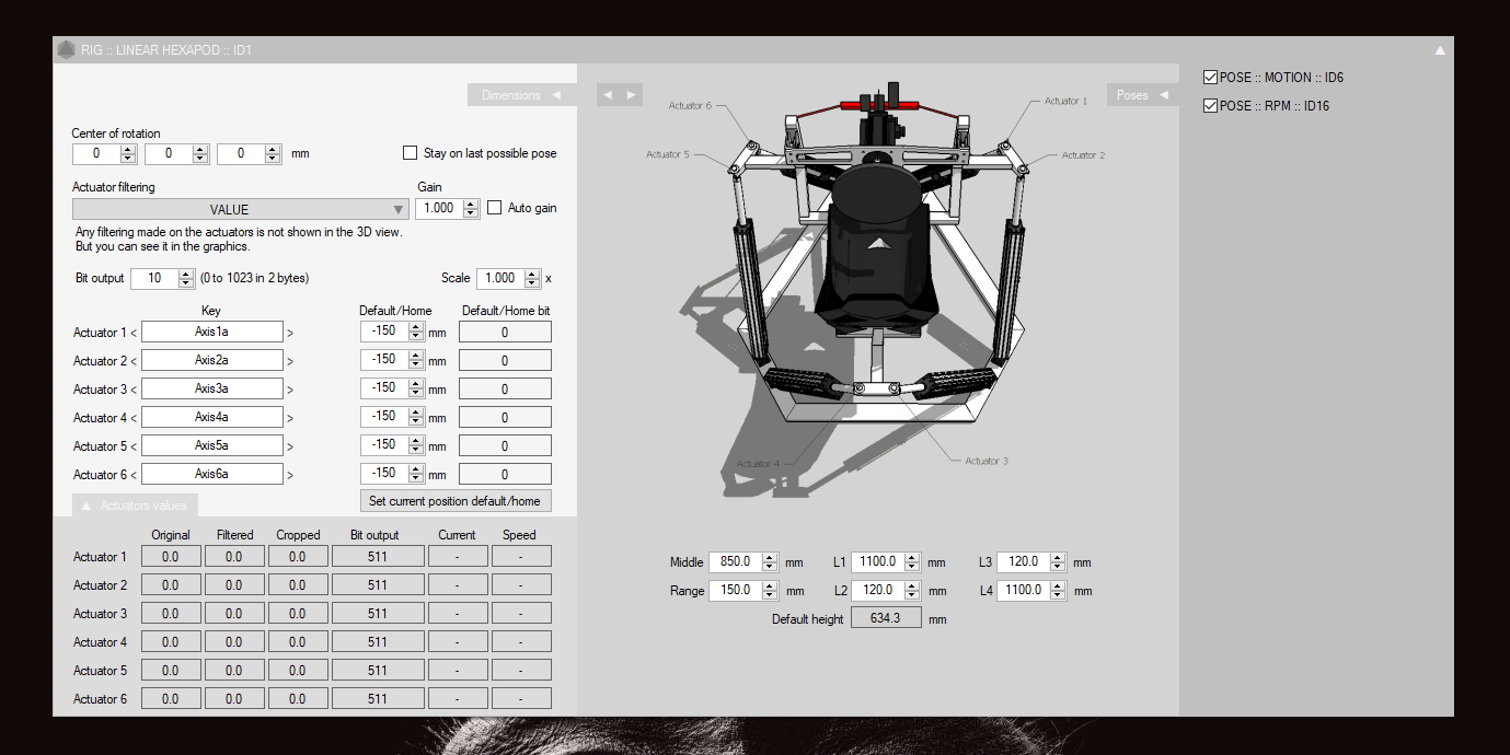

    ok so far i have the rig moving just 2 questions (I'm using simtools)
    - I have 30% CPU usage with the base settings 2ms and high resolution, is it normal ?
    I have yet to make the rig move with a game, so I have no filtering for the moment ..
    - in the pose section => in gain / flip I had to set YAW ROLL PITCH to 0.055 to match the data comming from simtool which seems to be plus or minus 180, is it correct ?
    Thanks for you huge work ..

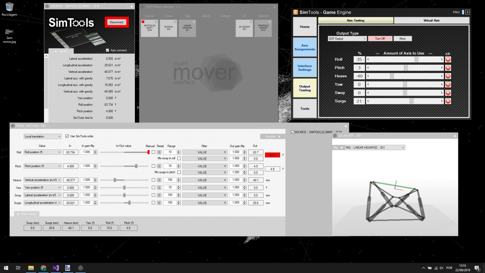

    Related to SimTools:
    Don't forget that data coming from games is affected by the tuning center.
    You are correct in relation to -180 to 180.
    Why are you using that value in gain/flip? To limit the input to your range?
    You don't have to. The range is the limit you want in the rig.
    You should use some kind of filtering to fit the -180/180 inside your range.
    OK, the simplest one is using gain, but you could use other types of filtering with return to zero to optimize the your ranges.
    Also notice there are two gains/flips, one on the input and another on the output. This was just to simplify the use of the interface and have a fast way of limiting values instead of messing inside the filter control.
    The sliders min/max are related to the range you define, not the input values.
    Just as reference to others, this is the way I setup both programs: (image is a composition of 3 images)

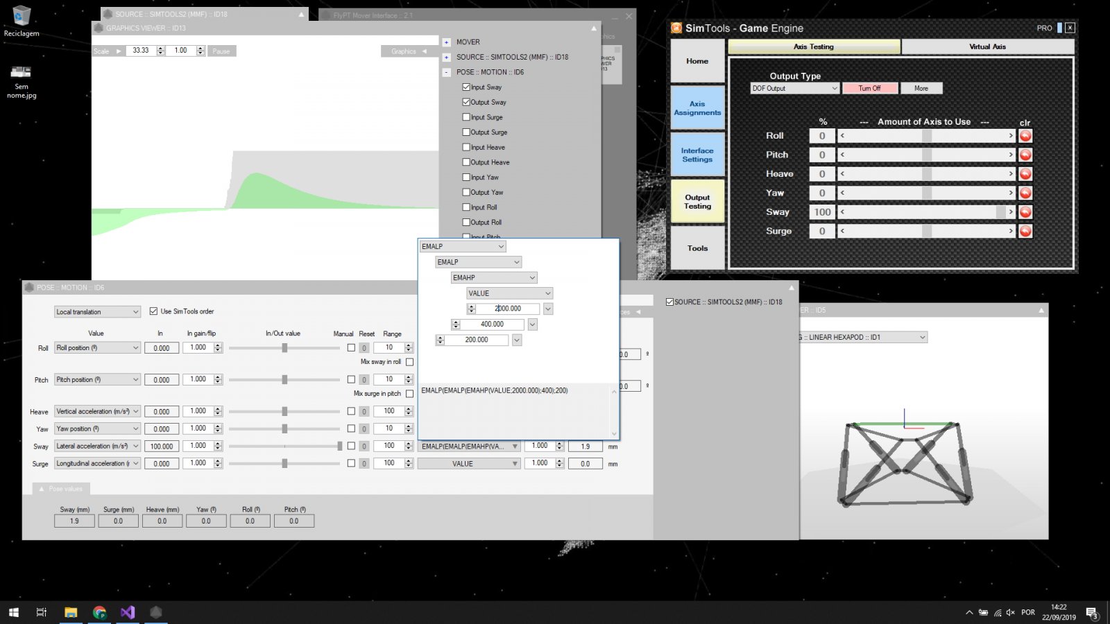

    In FlyPT Mover:
    With this I get a relation of 1:1.
    Simtools gives a range from -180 to 180.
    In FlyPT Mover, I have the range defined to 10, so it limits output to -10 to 10.
    Since the slider is limited to -10/10, it's red because input is larger than 10 (it's 63.734 in the image).
    Also in the right, we have the value red, because the result is out of range.
    On the lower left are the values sent to the rig. We can see that Roll is 10. That's the range we defined.
    Now I could add a filter to limit it to the range like: (Changed from roll to sway because of scale in the graphic. It's easier to visualize the effects)
    Just try.
    See the graphic? Grey is the input, green the result.
    It makes the rig return slowly to zero but also represents the inputs you receive.
    Even so it could go out of range.

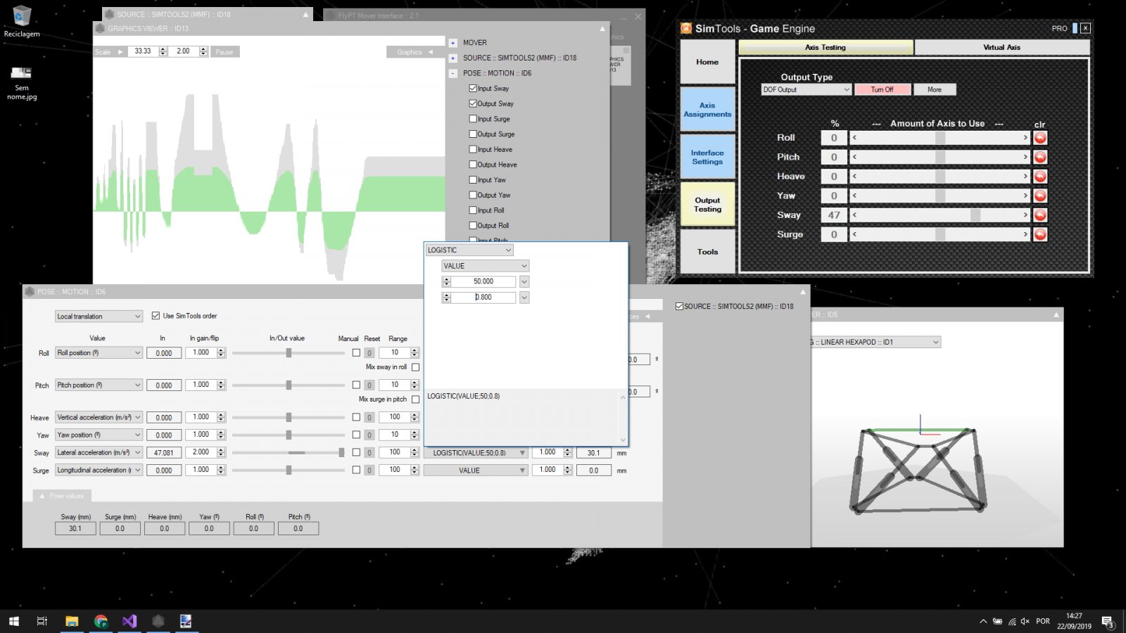

    We could also use a logistic filter:
    This is limiting range to 50.
    The factor is how "fast" it reaches limit.
    It's an exponential. Far from limit, the behaviour is almost 1:1, while as value reaches limit, it's compressed to fit the limit.
    Basic explanation...
    In the graphic, we can see the behaviour is retained, but inside the limit.
    Kind of a gain but exponential with a limit.
    It's a bit complicated to explain. Sorry.
    I'm trying to make a manual. Hope it helps when it's done.

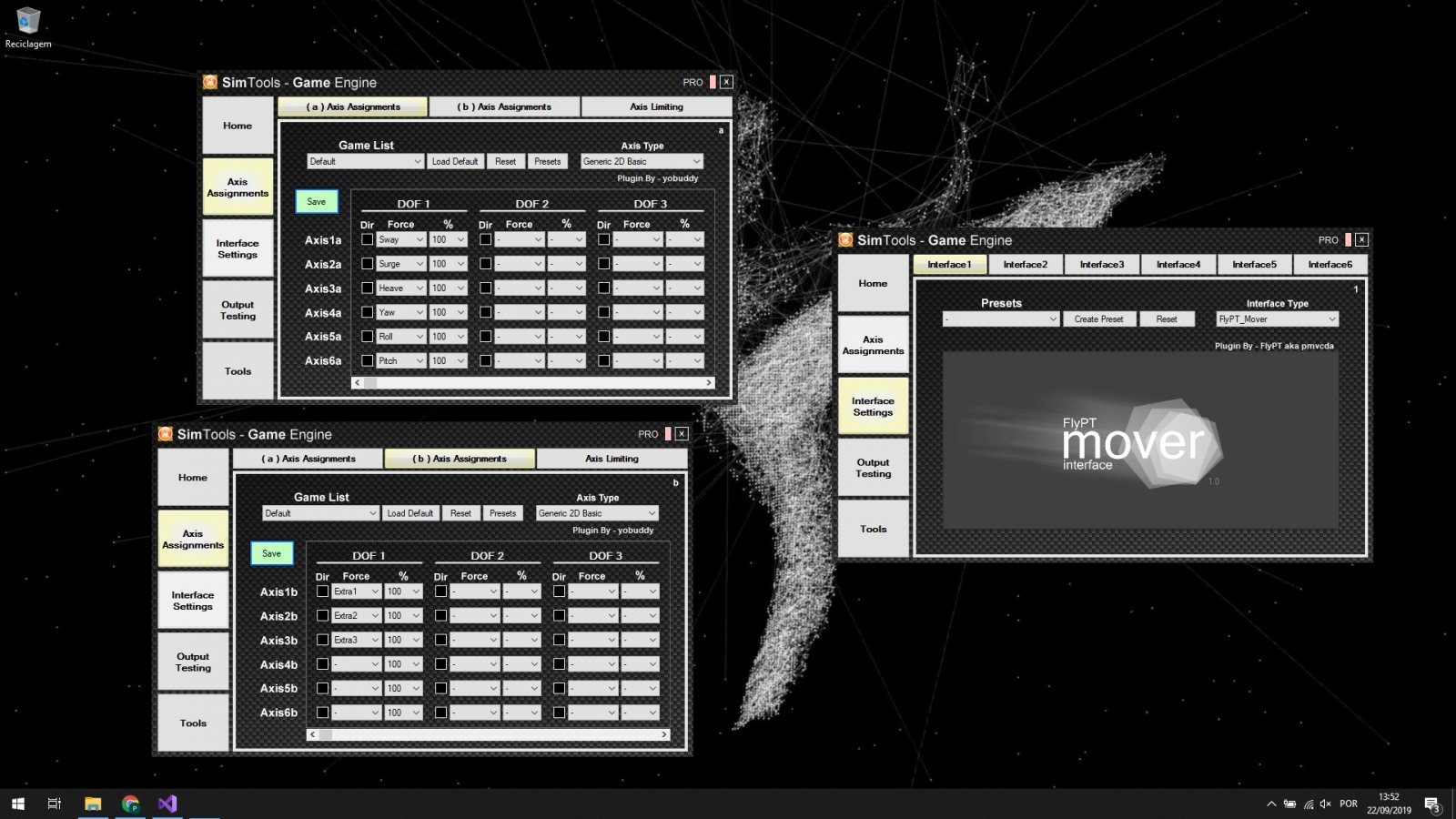

    Ok did my first test, so far it seems promising
    I use simtool and my test was with dirt rally (it tried direct source dirt rally but nothing)
    I send traction loss in axis4 (instead of yaw)
    I've setup as seen on the pic included
    The simtool tuning center value were left untouched
    My rig gain was 0.5
