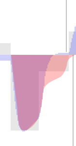

    Hey guys, hoping for some help with a "washout" filter.
    I have a HighPass at 2000, followed by two Low Passes at 100.
    Problem 1:
    Sometimes it overshoots into the opposite direction.
    Example:
    Is there any way to avoid this?

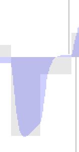

    Problem 2:
    The washout "eats up" signals.
    Example:
    As you can see, the Grey area, has two signals going into negative, however the filtered Blue area, does not produce a signal for the second bump in Grey.
    I'm looking for it to do something like this:
    Where the second, smaller signal in Grey, still produces a response from the filter, instead of being "eaten" by it.
    Any suggestions on how to fix these two issues?

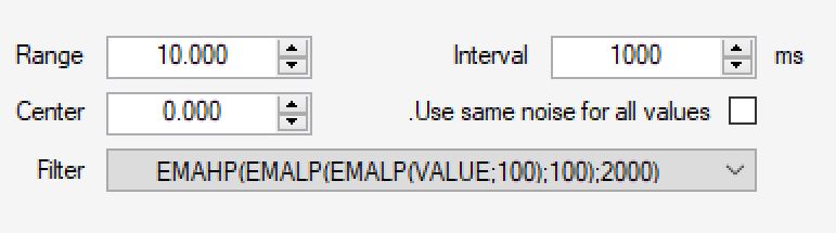

    Here is the simple filter chain that I'm using for these examples.

    This problem of the washout filter "eating" signals is really annoying, as what is happening; under braking I get the initial response of the dip down, but as I start modulating the brakes, I'm not getting anything back from the motion. The rig just steadily rises up over the period of 2000ms and any inputs on the brake pedal do not produce any additional motion, unless I completely let go of it.
    The overshooting problem is also an issue as it produces sometimes a violent rocking motion, as the filtered signal goes into the opposite direction, even though that there is no original signal from the sim, to do so.
