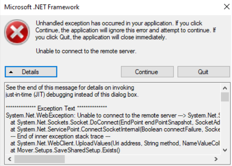

    Sometimes Flytp crashes and produces this type of message.

    Please hit the Details button and post the full error message.

  5. Marco Annunziata
    Dec 2, 2019
    130
    919Coins
    +19 / 0 / -0
    It's just because sometime your pc can't connect to internet, the mover send and receive some data through internet. Just click continue some times.

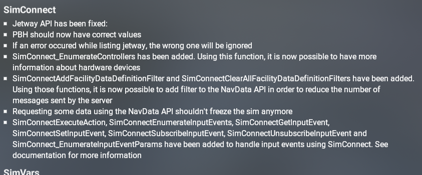

    After updating the MFS2020, I ran another test. Here's what the update does for simconnect:

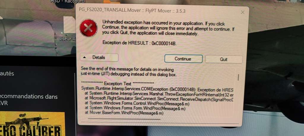

    Before starting the flight, I changed the FTP start order: before it started before MFS, now after when the aircraft is prepared and the VR started. I flew for 30 minutes without any freeze or lag, nice!
    Except that suddenly the 6dof went into safety (brakes locked) and returned to the starting position following this famous crash, which I was able to photograph this time:

    Here's how it works:
    System.Runtime.InteropServices.COMException (0xC000014B): Exception de HRESULT : 0xC000014B
    at System.Runtime.InteropServices.Marshal.ThrowExceptionForHRInternal(Int32 errorCode, IntPtr errorInfo)
    at Microsoft.FlightSimulator.SimConnect.SimConnect.ReceiveDispatch(SignalProcDelegate pfcnSignal)
    at System.Windows.Forms.Control.WndProc(Message& m)
    at System.Windows.Forms.Form.WndProc(Message& m)
    at Mover.BaseForm.WndProc(Message& m)

    enabled.
    For example:
    <configuration>
    </configuration>

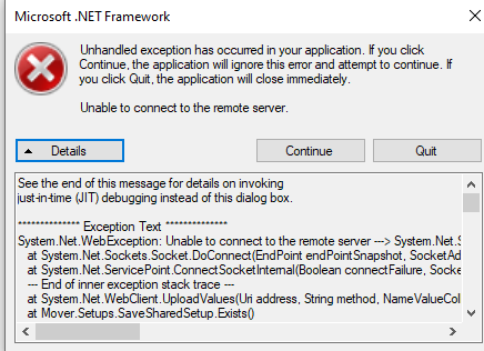

    Started getting the same error today. Looks like a failure to connect to a profile sharing site in Portugal. FlyPT server down?? Will recover if you just continue from the exceptions. Annoying but not fatal.

    yes, getting the same here. even hitting continue sometimes will not even open a .mover file, i have to Merge everything to a blank window.

    System.Net.WebException: Unable to connect to the remote server ---> System.Net.Sockets.SocketException: No connection could be made because the target machine actively refused it 85.242.31.127:80
