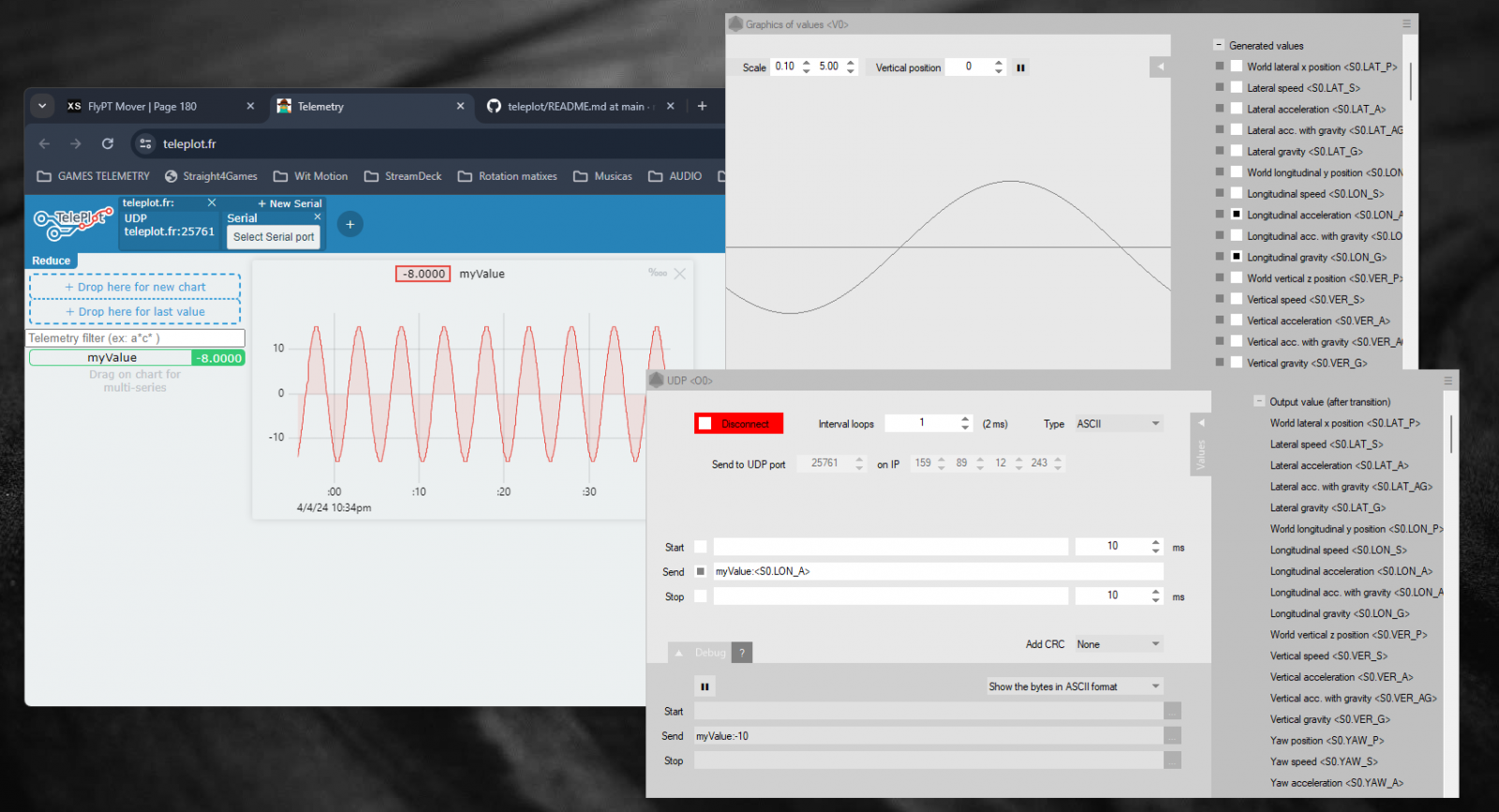

    That one already works:
    Add the ip and the correct string...

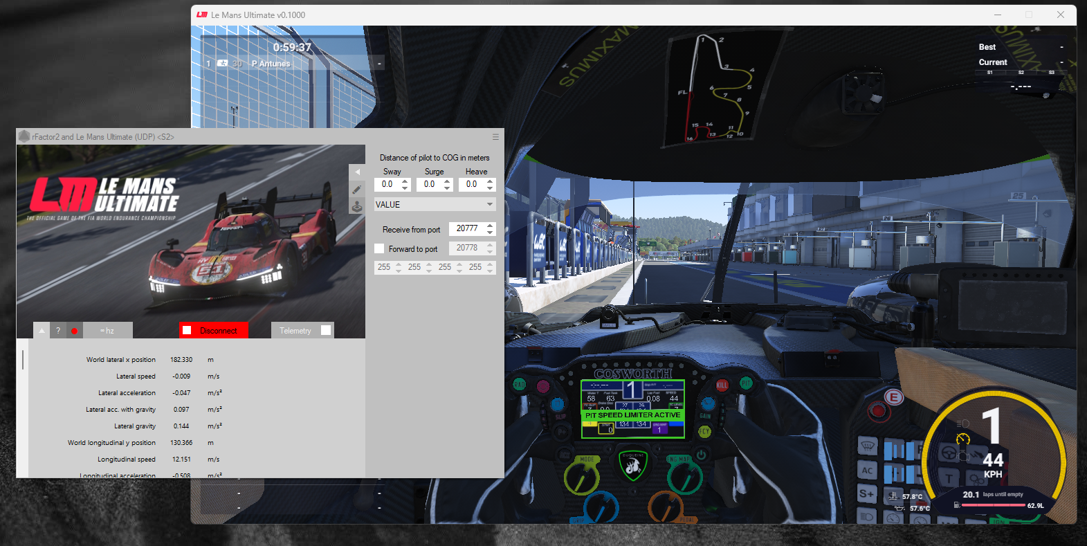

  6. Michelangelo
    Michelangelo New Member
    Apr 6, 2024
    34Coins
    Hi where Is possible to found this .dll for Le Mans Ultimate?
  7. pmvcda
    pmvcda aka FlyPT
    Nov 3, 2010
    2,237
    Portugal
    15,702Coins
    +2,674 / 17 / -0
    It's included in the download of Mover

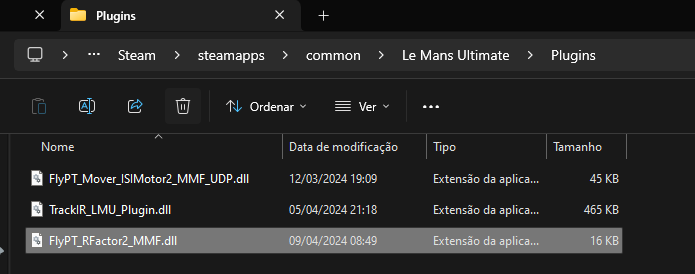

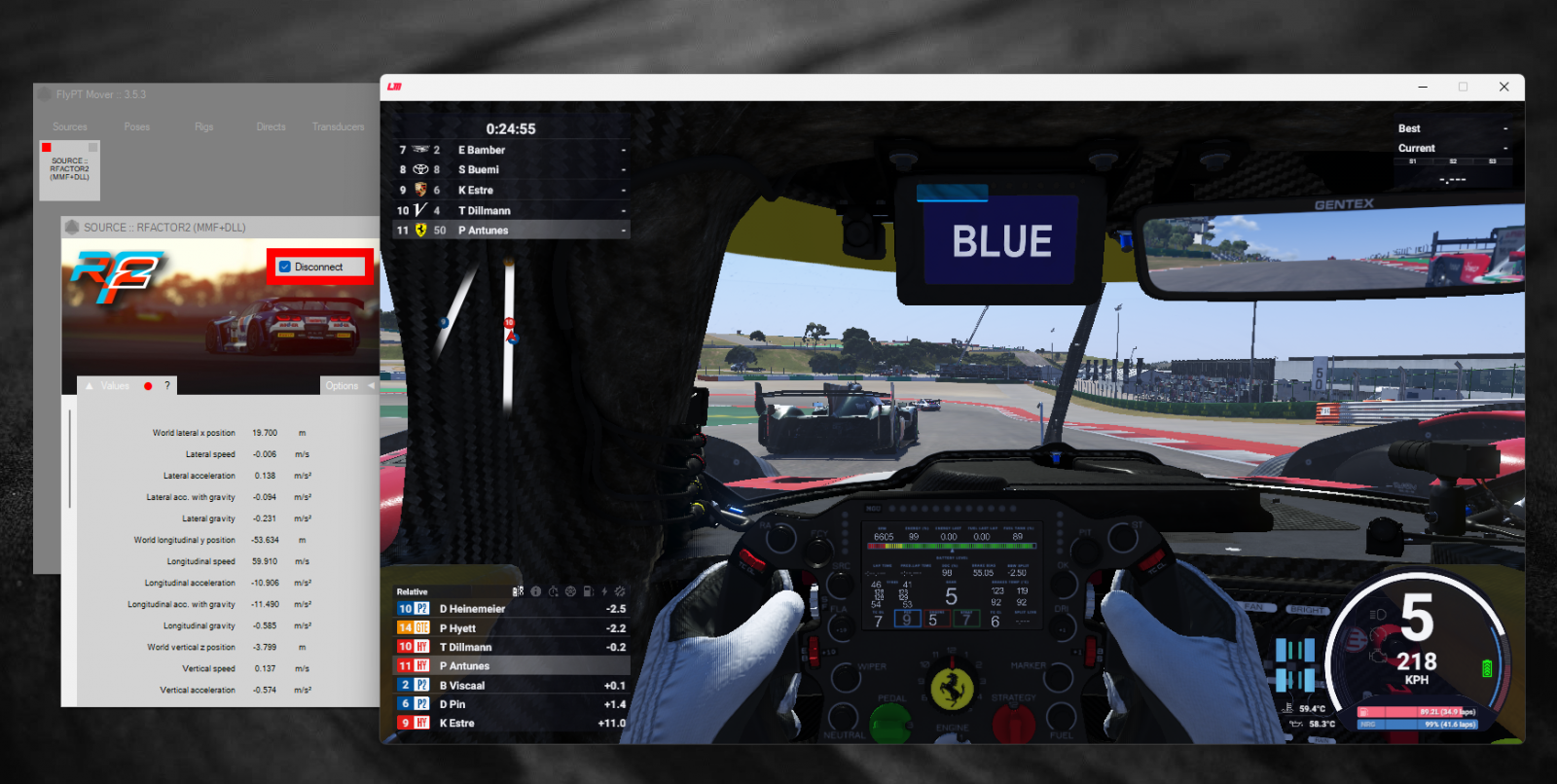

  8. Michelangelo
    Apr 6, 2024
    34Coins
    Ok but mine don't have rfactor 2 and Le Mans Ultimate words and image. Anyway rfactor 2 udp plugin source don't work. Is there a setup in .JSON Le Mans Ultimate to do. Please explain to me the full procedure to setup FlyPt to work with LMU
  9. pmvcda
    pmvcda aka FlyPT
    Nov 3, 2010
    2,237
    Portugal
    15,702Coins
    +2,674 / 17 / -0
    Ok,
    In the download of Mover, there's a folder with the DLL's.
    Pick the one called FlyPT_RFactor2_MMF and copy to the folder:
    C:\Program Files (x86)\Steam\steamapps\common\Le Mans Ultimate\Plugins
    You need to restart LeMans.
    Now in Mover, use the source for RFactor2.

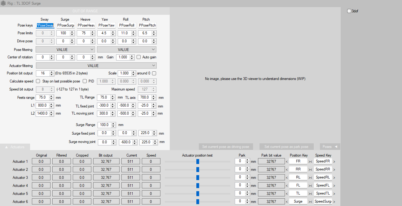

  10. somerandomguyinfl
    somerandomguyinfl New Member
    Mar 6, 2023
    6
    26Coins
    I have a 5DOF actuator style rig, 3DOF (4 actuators) plus Surge and Single TL from E-Racing Labs, all 150mm. I have gone through as many of the 181 pages on this thread as possible (LOL) and through all the documentation on the website but can't for the life of me find anything that describes what the measurements are for the TL and Surge fixed and moving joints, etc are. I understand range (75 = half of 150mm) but don't see diagrams anywhere. Any links to something I can read up on? thanks!!!
  11. pmvcda
    pmvcda aka FlyPT
    Nov 3, 2010
    2,237
    Portugal
    15,702Coins
    +2,674 / 17 / -0
    Sorry,
    You need to indicate the position of the actuator joints at the default position.
    The fields are x,y,z coordinates in mm
    For example, in TL, you set the position for the moving joint (the one of the rod) and for the fixed joint (the one of the housing).
    Do the same dfor surge.
    Carefull, X increases to the right and zero is at the middle of the left/right feets.
    Y increases to the front, and zero at the middle of the front/rear feets.
    Z is realtive to the middle of the feets actuators and increases up.
    After the next release I will try to make a better manual with more images and FAQ.

  13. Michelangelo
    Apr 6, 2024
    34Coins
    Sorry but this don't work for me. I have plugin enabled in .JSON file but Fly pt don't receive data and source isn't connected. I have seen in the post that speak about LMU that the image in the source Tab isn't the same that i have, and also the the words. It seams udp method not mmf.dll
  14. pmvcda
    pmvcda aka FlyPT
    Nov 3, 2010
    2,237
    Portugal
    15,702Coins
    +2,674 / 17 / -0
    That image is for the next Mover release.
    Just tested wit 3.5.3:
    It's working.
    Are you sure you put the DLL in the right place?
    You need the FlyPT_RFactor2_MMF.dll
    Careful, not the one for RFactor 1
  15. Michelangelo
    Apr 6, 2024
    34Coins
    Yes i put FlyPT_RFactor2_MMF.dll in LeMansUltimate Plugin folder that Is in Steam/Steamapps/common...I'm going Crazy:)
  16. pmvcda
    pmvcda aka FlyPT
    Nov 3, 2010
    2,237
    Portugal
    15,702Coins
    +2,674 / 17 / -0
    :thinkNot working? That's strange, do you have other plugins? If one is causing problems it might block other plugins from loading. Have no more ideas right now.
