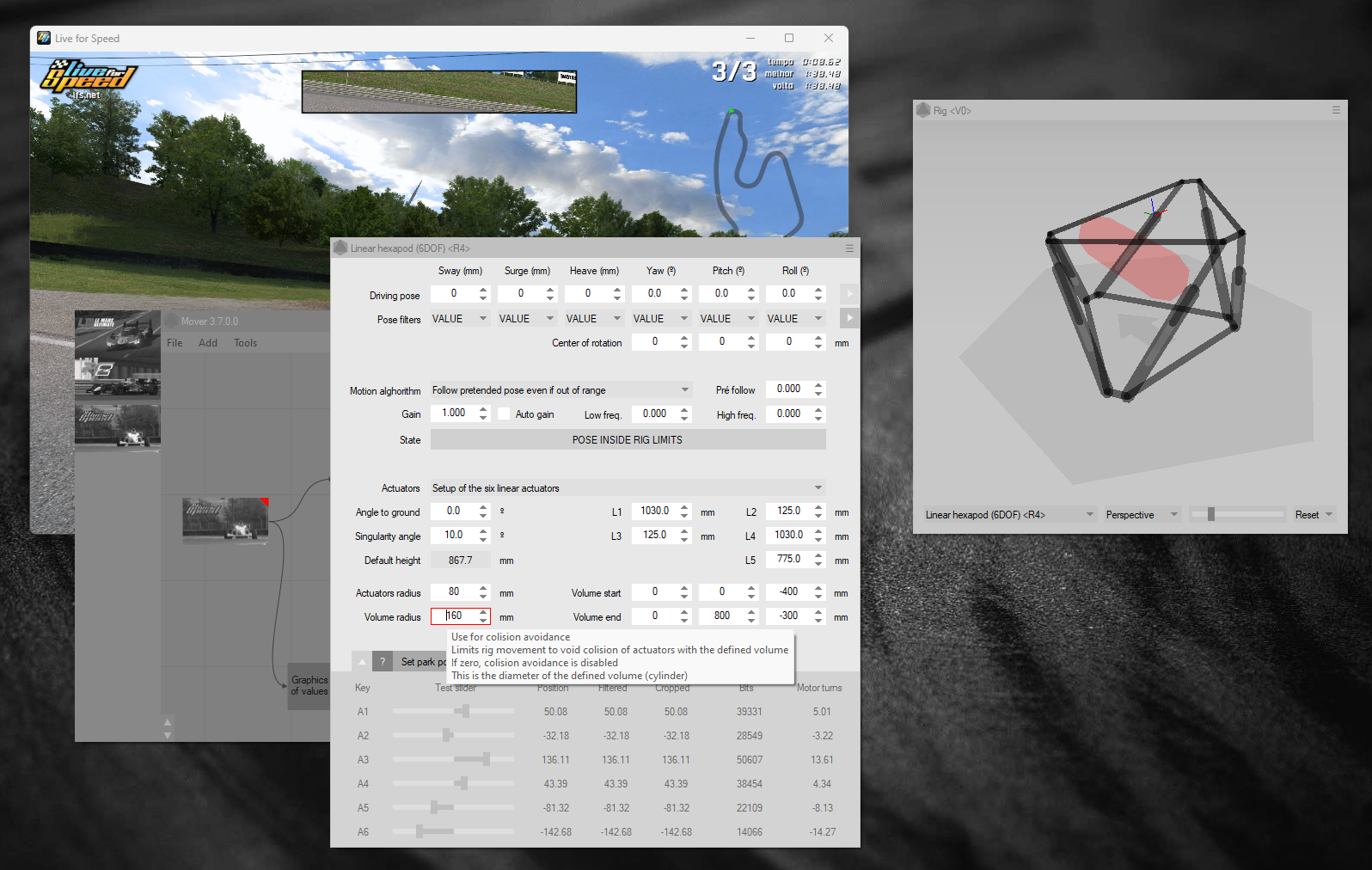

    So question: I have a 6DOF hexapod and the pedal mount is outside of the actuators but below the COR and the top of the actuators. This means that there are some extreme angles where it would interfere with one of the actuators in the front. So i have to limit the angles/moves to ensure there is never interference between my rig and the pedals.
    The issue is that this makes it where my limits are way below what the normal envelope of the rig could/should be.
    Is there any way to implement an "aggregate" limit so it ensures I'm not adding all the sway/roll/pitch at the same time but allow individual movements to maximize?

    Look what I have for the new release.
    It's not fully functional yet (95%, still missing a small part of he code)
    You define a volume (cylinder) and Mover tests colisions with actuators...
    I think that's what you want?
    With the new motion calculation, I avoid the colision and keep it moving with motion compensation.
    But, this is only for linear hexapods. For other rig types I don't have this feature

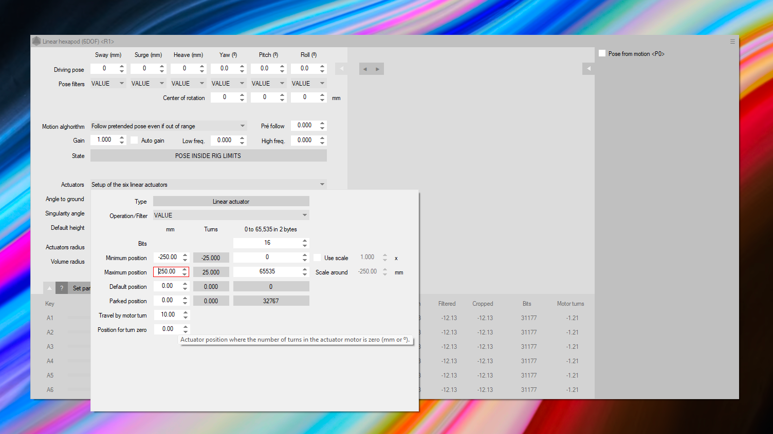

    Hello
    Hello FlyPT!
    So great to see your continous hard work and improvements on mover!!! Thank you so much!!
    When I had a look to your new rig configuration window, I was immedaiately missing the "dislocation by turn".
    You kindly implemented this feature for me in a mover test-Version (3.6.0 beta-version) to be able to test the official Odrive firmware. This feature is soooooo great and important !
    I am using this feature in my Odrive linear 6DOF since over a year now and it works perfect! Odrive has such a huge potential most people dont know yet.
    So please please keep this feature - I am sooooo keen on using this in a new official mover release!
    Thousand thanks!!

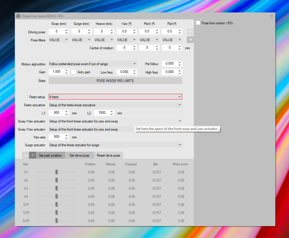

    Don't worry, it's in,
    The window was and is too crowded, so I added a new control:
    Actuator settings are inside this window.
    While in this rig they share the same settings, in other rigs thay can change. In those cases there's more than one of those controls, like here:
    1 for the 4 feets, 1 for surge and one for sway/yaw actuators.
    All have the turns included.
    The only thing missing right now is speed calculation because it needs feedback and I will leave it for later if needed.
    Colisions are prepared for all rigs, but only the linear 6 dof has the ui for that.

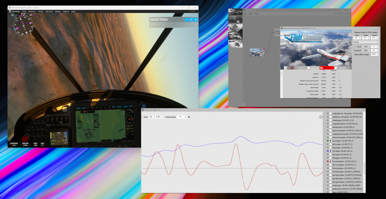

    3DOF, Arduino
    Would it be possible to take a look at MSFS's Yaw Acceleration please? The values are extremely jumpy and noisy, impossible to use compared to other axis accelerations.
  10. pmvcda
    pmvcda aka FlyPT
    Nov 3, 2010
    2,238
    Portugal
    15,708Coins
    +2,674 / 17 / -0

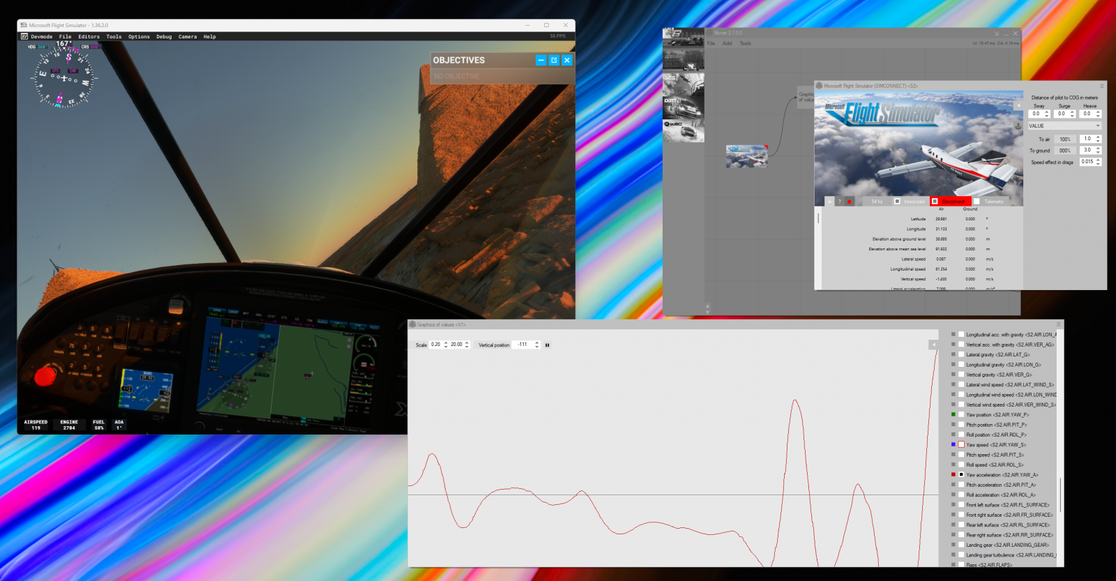

    I think that is solved on the new release:
    Red line is acceleration (without interpolation)
    I now have a more efficient code to calculate acceleration in MSFS
    Here with interpolation:
    EDIT:
    I use interpolation, because on those images, Mover is calculating at 0.15ms or 6666Hz:
