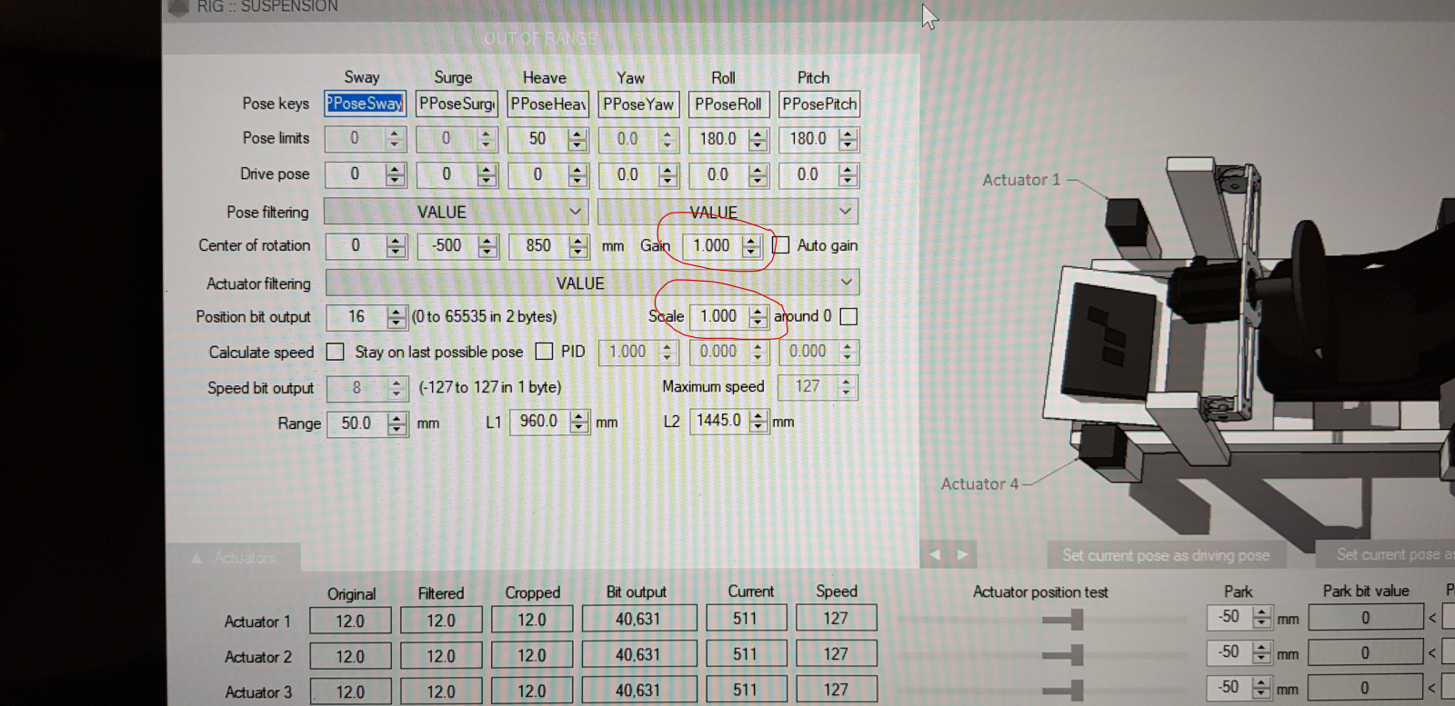

    have a question about the rig module, what is the difference between gain and scale ?
    thanks !

    I think i got it, scale affects the park position it seems to be like a offset.
    How works the auto gain ?

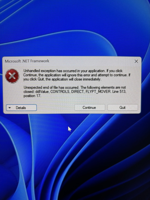

    Hey all, I'm in desperate need of some help.
    I noticed that my wind sim wasn't working for one of my titles (AMS2), so I tried deleting the module, and duplicating one that was working. However, when I tried to save everything as a local file, I received an error about hexadecimal X0.01 being an invalid character (I didn't save the exact error message). I've never seen that error message before, and I didn't change anything other than deleting a module. Anyway, I tried to continue, and got no further error messages, however now when I try to open the local file, I get a new error message (see photo) and if I continue, FlyPT just opens up a blank screen.
    I really hope I didn't just lose everything in my setup file! Please help!

    Here is the full error text underneath when I click details:
    System.Xml.XmlException: Unexpected end of file has occurred. The following elements are not closed: ddlValue, CONTROLS, DIRECT, FLYPT_MOVER. Line 513, position 17.

    @pmvcda Please see above two posts for a critical error with FlyPT Mover that is preventing me from accessing my one and only saved Mover file :( Any help you can spare would be so greatly appreciated. It has been so long since I setup my rig, that I don't think I could do it properly from scratch again, so I am really hoping that I won't need to!

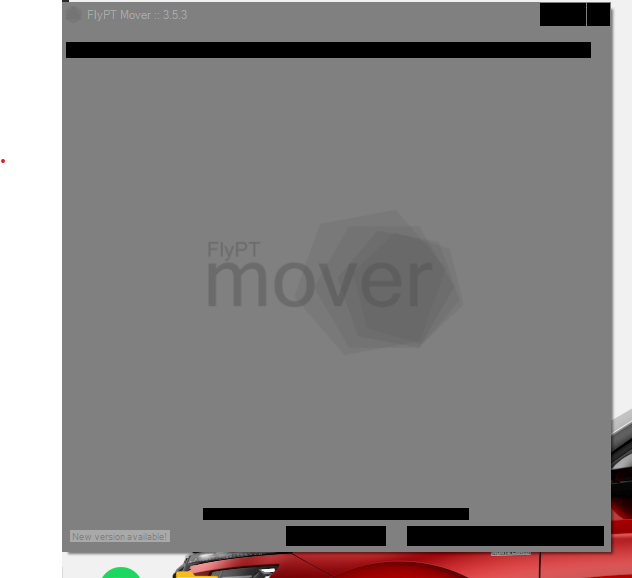

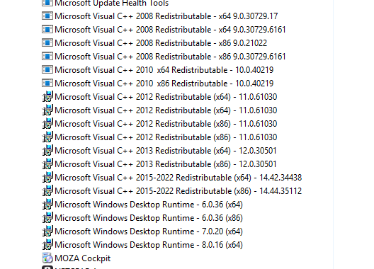

    Been using Mover 353 for a long time. For some unknown reason it will no longer open. It hangs before the main window is rendered properly.
    It has to be something that I changed or installed on my PC, but despite many days of investigation I cannot pinpoint it.
    3.7 runs Ok. I started to configure my rig with that but got stumped pretty quickly, so I am back to troubleshooting 353.
    Attached is a screenshot of the 353 window hanging without fully rendering.
    Also attached is the dot net versions installed, since I'm thinking this might be something todo with it.
    Any suggestions on how to troubleshoot much appreciated. Nothing in Event Viewer. Mover doesn't seem to have logging afaics.

    My flypt 3.53 also doesn't work after win11 upgrade, the same as the feedback in the above post

    A subsequent Win11 update caused my FlyPT 353 to start working again. However in the meantime I had switched to Simhub Motion, and very happy that I did.

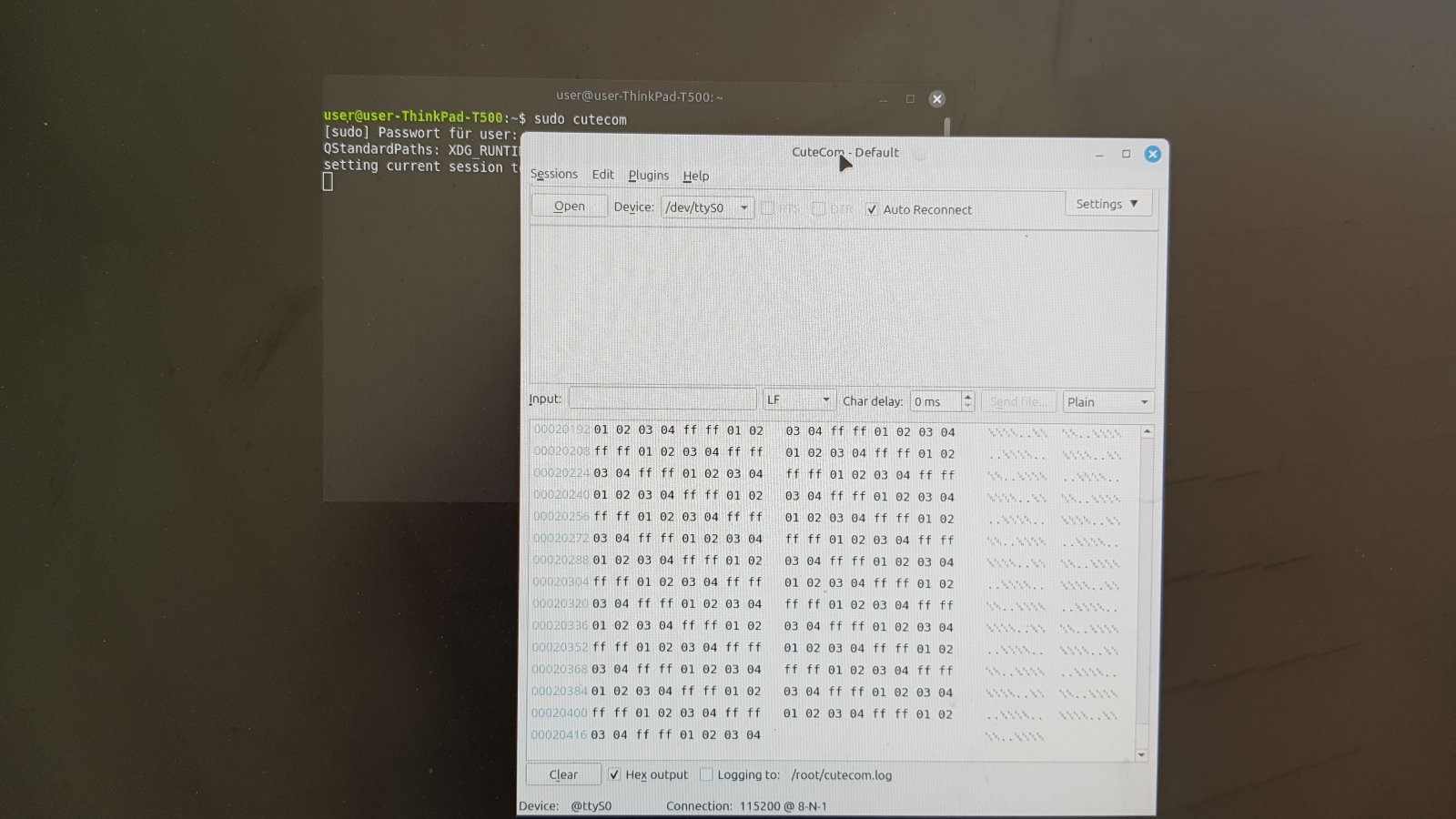

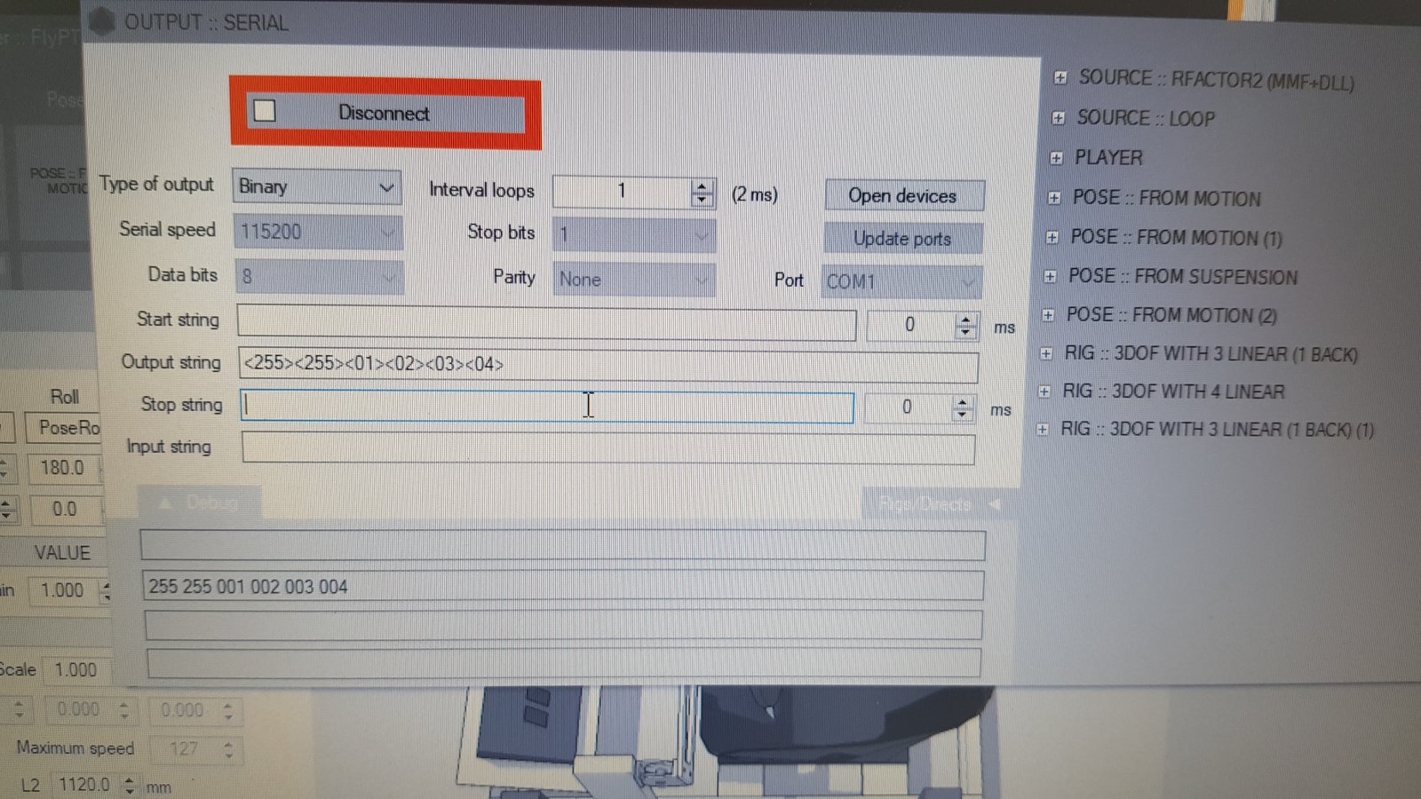

    Could anyone provide detailed documentation on Flypt? I'm trying to write Arduino code to receive output data from Flypt, but I don't fully understand how Flypt's output data works, so I'm still encountering errors. I need to understand Flypt's output to correctly parse it for Arduino. I've searched everywhere but haven't found any specific documentation.

    The documentation link is in the FAQs: https://www.xsimulator.net/community/faq/flypt-mover-page-and-setup.382/
    And the Flypt documentation and output examples, including Arduino, are available online: https://www.flyptmover.com/outputs

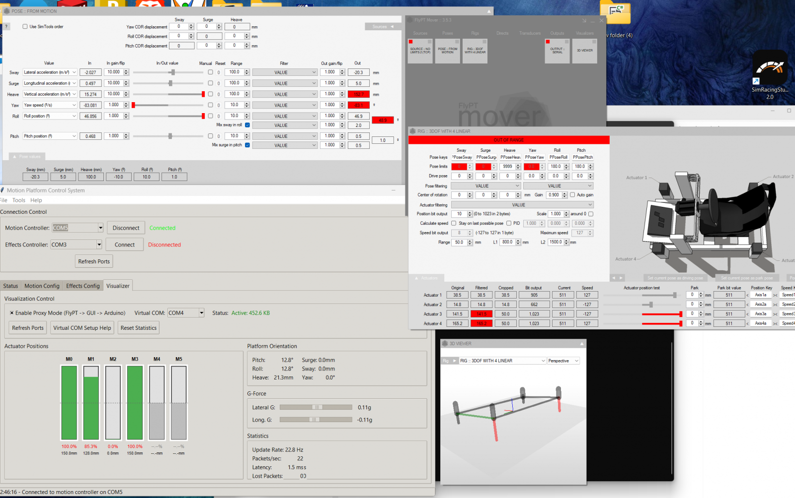

    you can also connect a second device with a twisted cable on your com port, to see what happens. (e.g. linux with cutecom) p1.jpg p3.jpg
