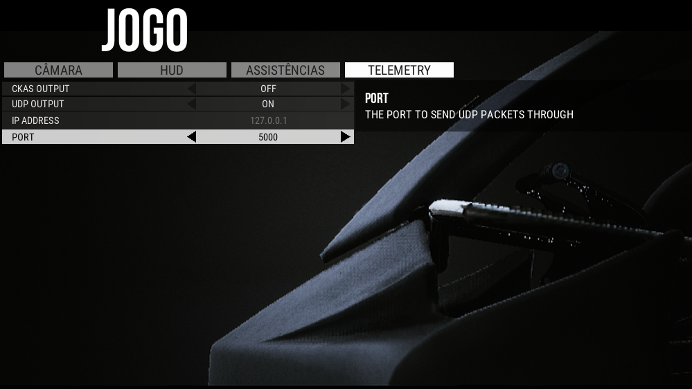

    Hi @pmvcda apparently no values in the telemetry seen in the Kartcraft source , can i just asl in case i missed something
    start mover
    start kartcraft
    Go to windowed mode ( so i can see Mover Modules and kart craft)
    drive round circuit
    telemetry data in kartcraft source module should be changing accordingly
    once i select kart craft as source then the rig Module should reflect the sim pose data..
    cheers
    By the way no need to answer back if your working on new version i'll keep playing with this setup good buddy
  2. pmvcda
    pmvcda aka FlyPT
    Nov 3, 2010
    2,237
    Portugal
    15,702Coins
    +2,674 / 17 / -0
    Did you enable UDP in KartKraft?
    Go to the KartKraft options-->Game-->Telemetry
    And enable UDP.
    Use port 5000 and IP 127.0.0.1

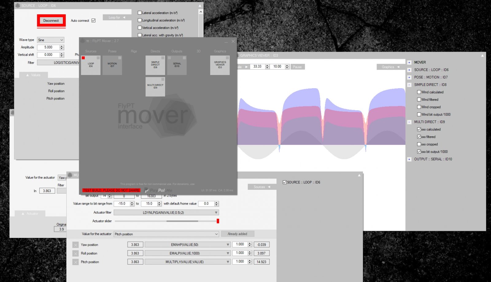

    Some news:
    - First pass on source transitions is made.
    - Some new filters implemented
    - New sources working (older games like Race07 and RFactor based games)
    - New poses
    - New multi direct to generate actuator output from mixing values from a source or more:
    Almost done:
    - Simplified output for Thanos boards. Missing some details to publish the new version.
    - Review some problems on the UDP output.
    So new version getting closer...
    Really sorry for the delay, but professional problems made time more precious.

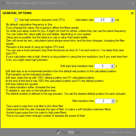

    FlyPT Mover 2.7.3
    New build to correct some bugs.
    Roll over is now working on rotations when used in the directs modules.
    But now it brings problems to the soft starts in the sources. Will solve it but it's going to take some more time.
    Added a small warning box on the bottom right, that turns red when calculation time is 2x the one we set in the options.
    In my tests, I get 15 ms sometimes, might be because of Visual Studio and all the testing, but I want to get some feedback if this happens to others.
    In case it's happening, it affects filtering and calculations.
    You can always change to high precision in the options:
    But this uses more CPU. If you have many modules, the load might not make a big difference.
    The way it works, load should be distributed and priority in the games. In reality the load are just empty loops to fill the defined time.
    DOWNLOAD: FlyPT Mover 2.7.3

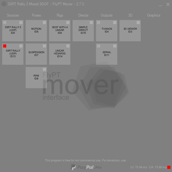

  18. hexpod
    hexpod http://heXpod.xyz
    Apr 18, 2016
    1,218
    berlin
    7,840Coins
    +376 / 5 / -0
    DC motor, 6DOF
    Oh that’s interesting !
    1.)
    I could finally see the timings issue thank your red square.
    I couldn’t see this before because I am using Air Manager which speeds up everything.
    You remember the small firmware utility which behaves same way ?
    Do the test if you like. Without, I have same timings for calculations as GUI both above 15ms. I launch the utility and bingo 2ms.

    Hi.
    Can you try the filters, running Mover in high precision clock. Just to be sure the problem is not related to timing.
    The jump on start is a problem, because Mover has no idea where is the rig.
    Better to move her to the start position before connecting her.
    I need to think of a way to achieve it.

    DC motor, 6DOF
    Air Manager or AVR has NO impact on the calculations while “use high precision” is selected.
    The values are:
    UI 18ms CA 1.20ms
    CA is steady and fits the selected „calculation rate” - 1.2 im my case.
    With “use high precision” unchecked I have
    UI 19 CA 20.
    In this scenario when I run AM or AVR the CA value drops to 2 ms
