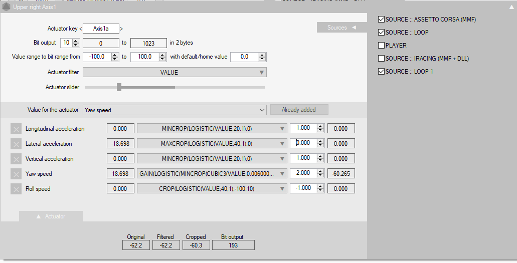

    Thanks, really appreciate you taking the time! Sadly it made no change. The values flip on the output side but the same as i were to just put a - in front of the output. WIP :)

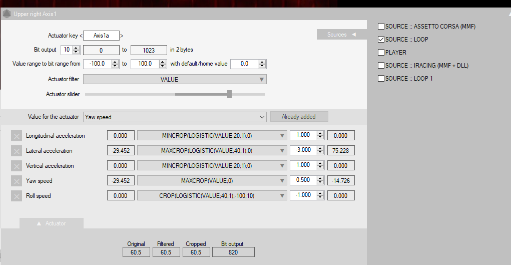

    Sure it makes sense which is why i mention it may be needed for other things but for my application it really doesn't work. . If it can really be soled by making them both positive with a check button I cant really tell you for sure since my programming skills aren't that good. further testing seems to say no when its combine, fine on its own. Every which way i test if i set the gain a bit higher or the lateral is to low and spin to fast it will dip below 512. It looks like it need some kind of hard stop in the filters. I do of course have it in the global but it would be nice to have it. Not a high prio anyway.
    Its time to chill for today though. Ive been at it for 10 hours. I could be quite off but of course so i appreciate any and all input!
    I can also make it work like this (gain is -1.000 in the filters)but still it will pass 512 and go below so if i spin on start it will go far below and hit my clipping settings.

    Maybe give a try with logistic filter. It could be with this function you will find a good combination for your application.

    Thanks. I've been experimenting alot with it but haven't found it that useful other than setting soft limits. Also gain does not care much about it so I have to crop it. There are some cropping options I haven't tried In elation to the main crop on yaw/sway though so it could be worth a shot.
    I had the same issue with traction loss and sway in simtools too and in the end I had to write an axis plugin with the api where I hard limited sway and traction loss. I couldn't use clipping cause it didn't work with my neg/pos heave and surge. I can use that with an axis from simtools but of course I'd prefer only using Mover. I haven't looked that much on cpu usage but I'll have to use two sources as simtools dosent have the roll speed I need so it doubles.

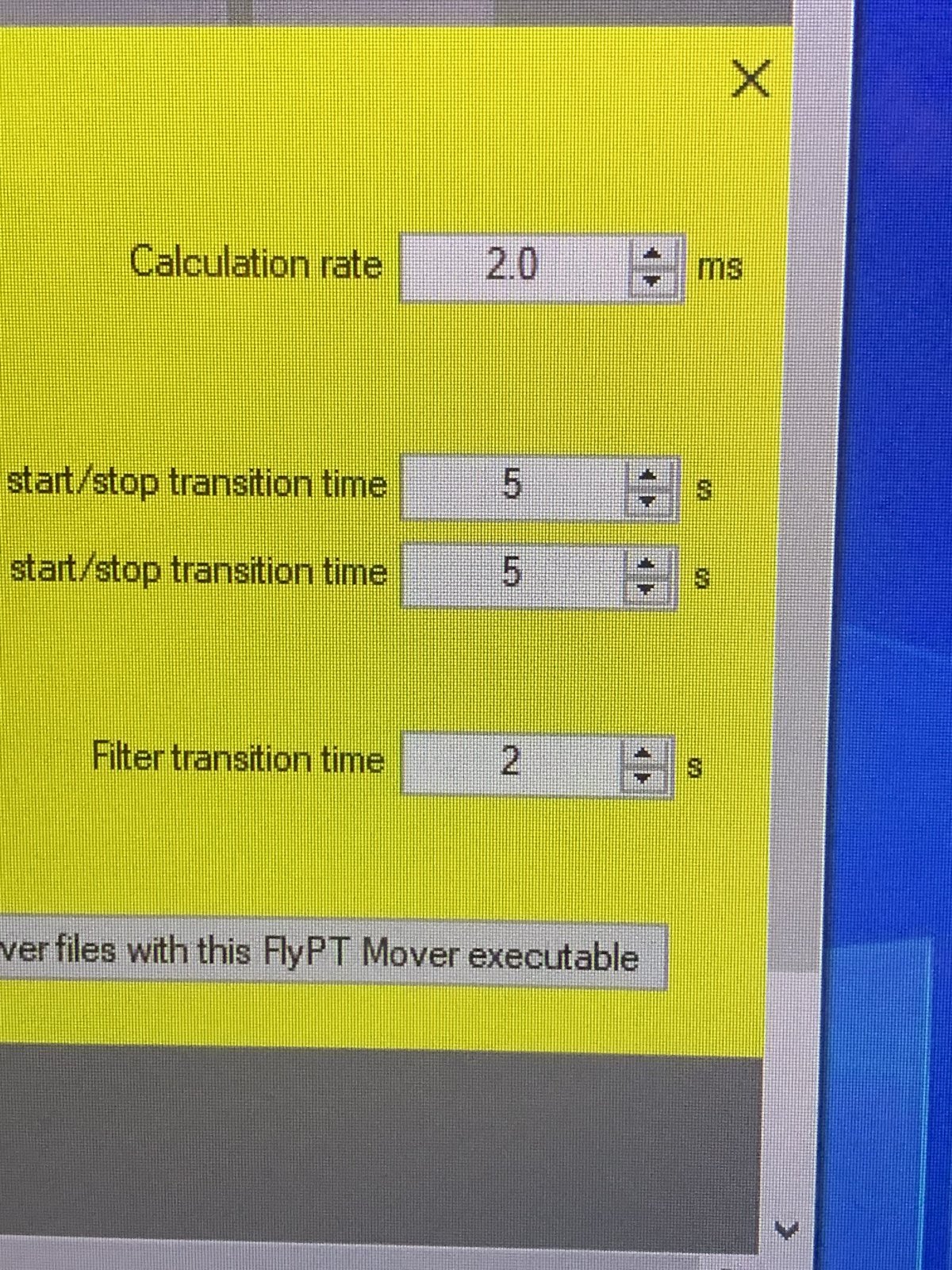

    When I start all FlyPT outputs with the v2.8 the actuators go to middle position in 5sec slowly, and when I stop them, they go back to min position.
    With the new build, at start they go to middle as fast as they can, and after stop they stay at the middle. Do I need a start/stop string or I missed something?

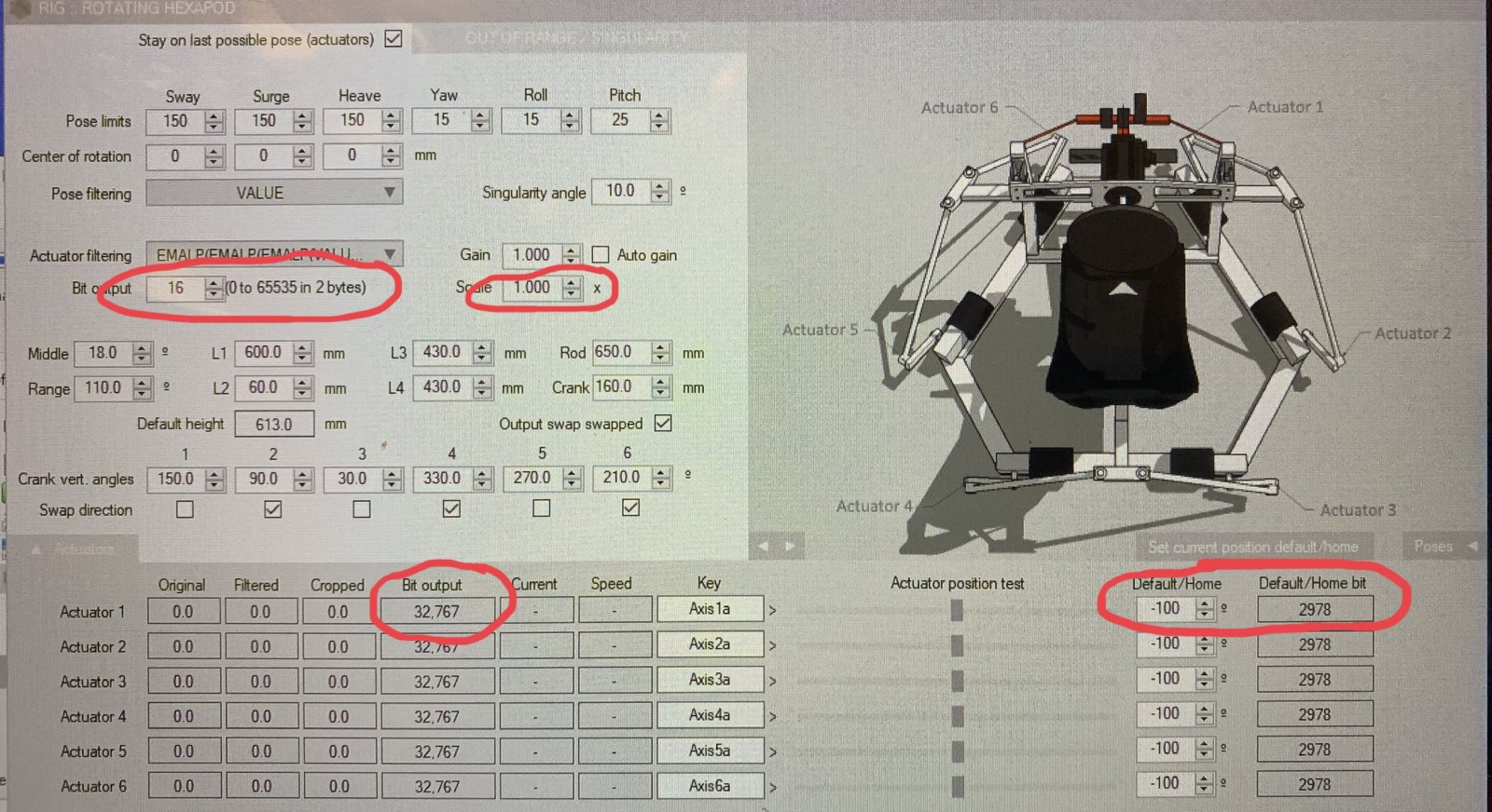

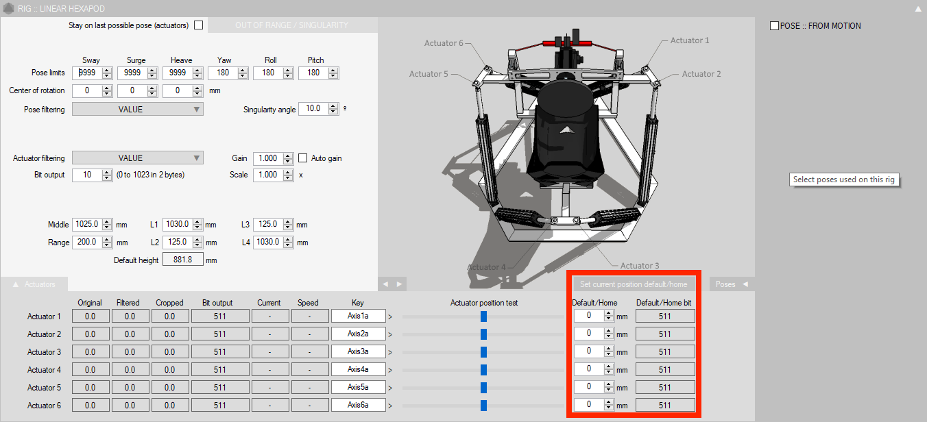

    You have to set the park/rest/default position of the rig in the rig module.
    Zero is the middle of the actuator, put there the minimum for the actuators ( in all actuators).
    In the above image I would use -200 in all actuators to have them in the lowest position (it's the range of the actuator).

    -200 ? What is the unit there ?

    mm or degrees

    Sorry I don’t fully understand.
    So in this case -100 (bit 2978) is an angle from the mid pos ? If I change mid pos. The bit output doesn’t change.
    Or it’s 100mm from the platform height ?
  17. pmvcda
    pmvcda aka FlyPT
    Nov 3, 2010
    2,237
    Portugal
    15,702Coins
    +2,674 / 17 / -0
    Hmmm,
    Should be - 100°
    -100 is the angle from the mid position.
    The middle is the default position, zero.
    So having the actuator at it's zero position (middle) should output the middle value of the bit range (32767 in your case)
    Now we specify the rotation range to each side of the middle. In your case 110º.
    So bit value of 0 is middle - 110º and maximum value of bit range is at middle + 110º.
    It's all relative to the middle position

    I think I understand but it this case if you change the mid position this value should be updated. Right ?

    No because it's relative to that position

    To be clear, my case is a bit specific because I am using 360 pos. sensors with a 0,5 ratio.
    The example picture I sent is not related to my case but still the fact it is not updating gives me unreasonable values.
    Maybe it takes a default mid range (if I recall it’s 30deg.) without updating it.
