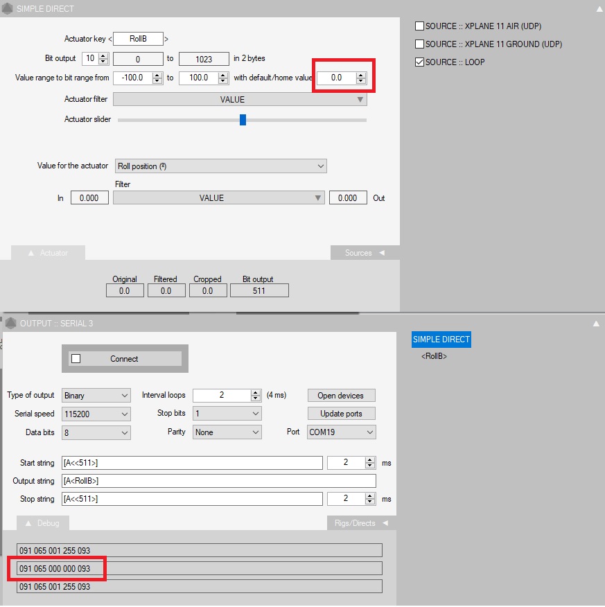

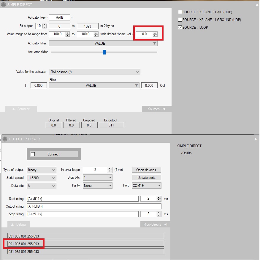

    Found a bug, I think? :
    On opening the program again after setting it up, I have to toggle every Simple Direct 'with default/home value' to have it actually be read by each relevant OUTPUT module. If not, the rig actuators will quickly go to max (as detailed in the output data) and then slowly go to center as required (not good in my rig).
    Before Toggle:
    After Toggling 'with default/home value away and then back to zero. The output string is then correct.

    @SeatTime ,
    Good catch.
    I'm looking at it, seems the mapping from range to value is not correct.
    It starts by default, always with a range from 0 to 100 instead of the user defined range.
    But I need to look at it better.

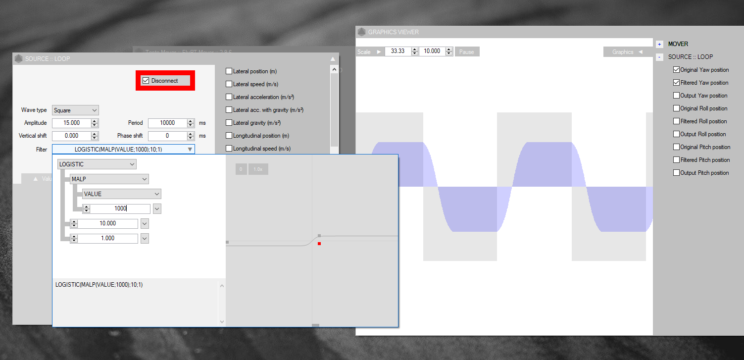

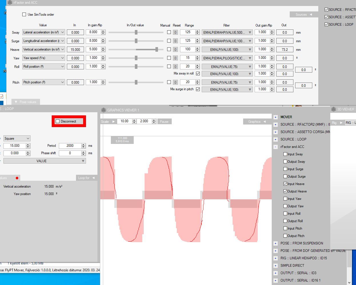

    I'd like to have a filter, that can make from a square wawe type to a sine output. I tried lots of variation but I could not find the best solution. Any of filters affects only the end of the movement, but I want it when it starts too. Wich filter can make smooth start?
  7. pmvcda
    pmvcda aka FlyPT
    Nov 3, 2010
    2,237
    Portugal
    15,702Coins
    +2,674 / 17 / -0
    To make it go down before receiving the signal, is impossible, I can't guess what value is next.
    The above example is just that, an example, because in practice with values changing, this might not work.
    What is the objective? Where do you want to apply this filter?

    Try to apply two or there EMALP in cascade. It can be the solution for you

    I have very agressive road effect in heave movements, there are lots of small hits, like a hammer knocks. At the end of moves its smooth but when the actuator changes direction it gets tiny hits. Its very good feeling on the curbs but strange on the tarmac. I want to get smoother start moving, like at the end with EMALP. Usualy it happens when actuators change direction.
    (I think it helps when it has a PID control in mover, or a different PID value going up and down in the sketch. Now actuators are faster going down than going up, I think because of load.)
    So I want to disappear those hits. I think it helps when the actuators start slower a bit.
    Until now the best when there are two EMALP in cascade like @hexpod says.
    Edit: LOGISTIC(MALP(VALUE;150);80;1) Looks good too!!! Thanks :)
    I make some experimentation more... Im on a good way now :)

    I see, I also get it.
    Think @SilentChill also feels it.
    But I notice it more in AMS2 or ACC
    In RF2 the feeling is great

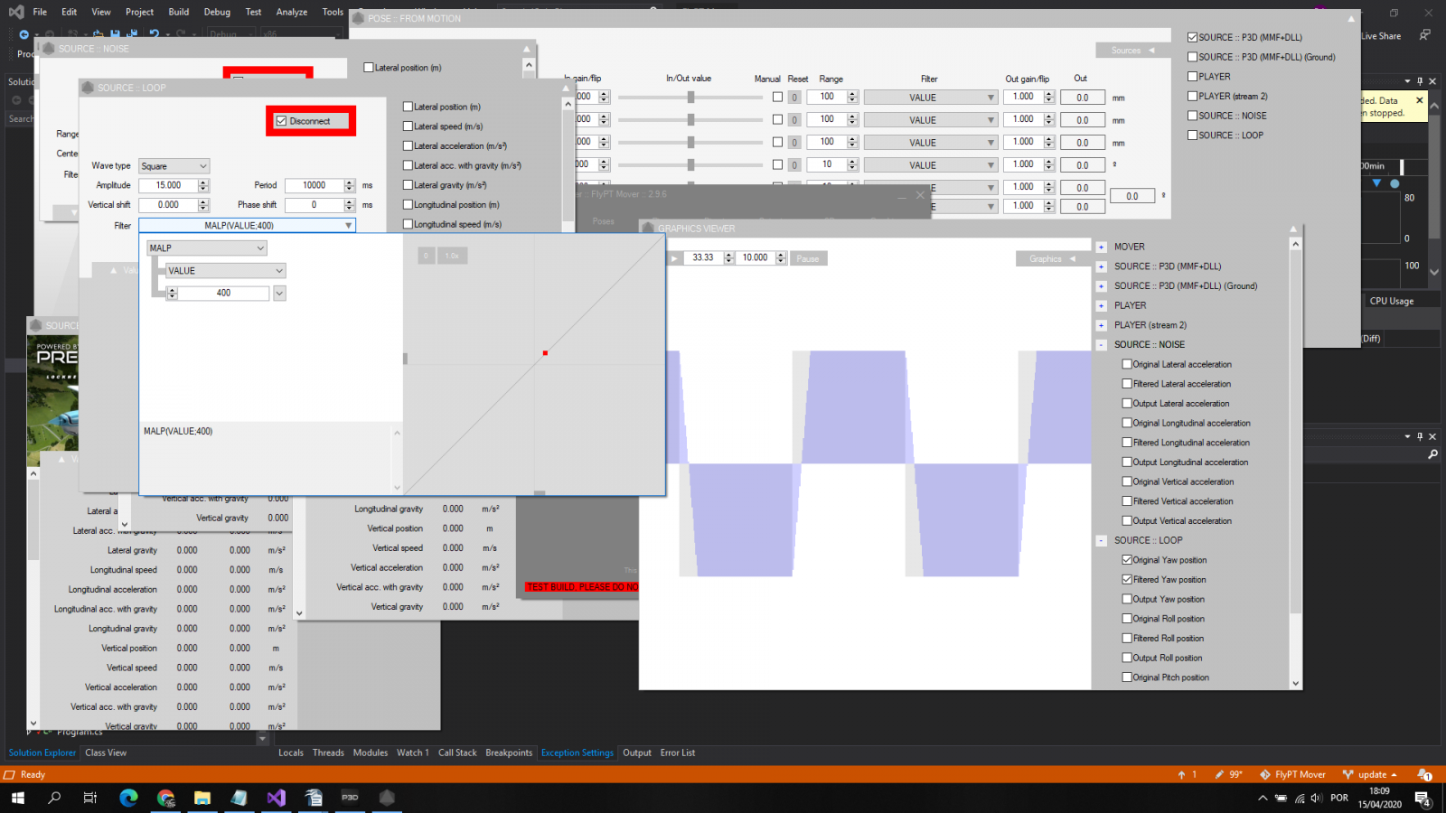

    Something I have to solve. We need some kind of softening. You could try the MALP instead of EMALP
    MALP is median average, while EMALP is exponential, that's why you get such a sudden drop.
    The MALP with the square wave:
    with 1 MALP:

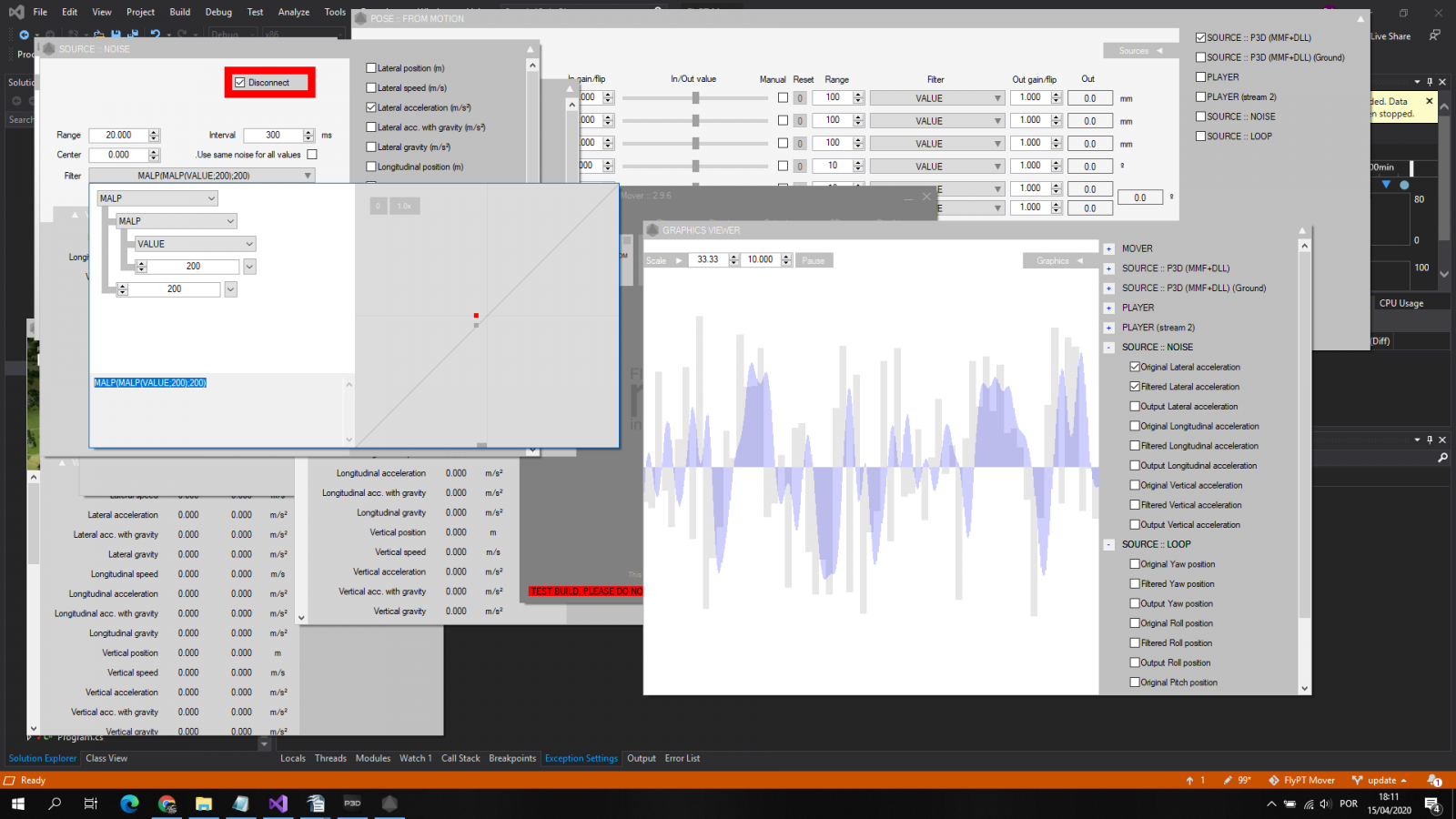

    In the first image, I try to simulate that road noise with random values filtered by two MALP, you can see it rounding and averaging.
    Try it, I still have to try.
    The more cascade MALP you have, rounder it get's

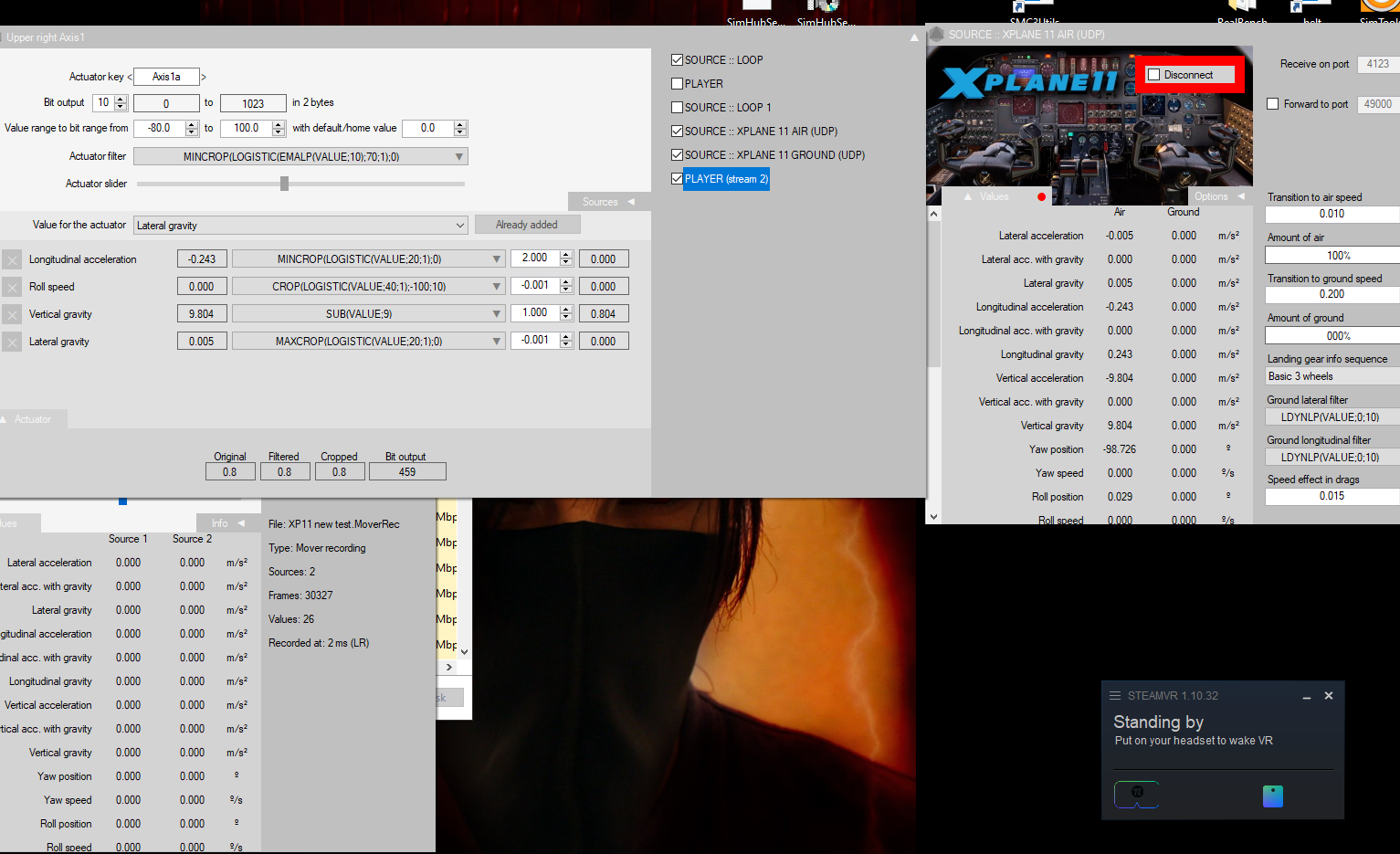

    Need some help.
    Ive yet to get any sort of meaningful profile with X plane. Ive tried everything i can think but i really cant get any sort of heave working.
    Could you give me an explanation how to set it up? I got no problems in Simtools.

    You are using just gravity. If there's no roll or pitch, the value is constant.
    Use vertical acceleration without gravity and remove the SUB(VALUE;9)
    To use gravity, you need to have a high pass filter, but softened like: EMALP(EMAHP(VALUE;200))

    Im using 2.9.7 in case you need it.

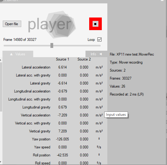

    Thank you for the quick reply though ive tried a lot of combinations. Vert acc just give the same value as Vert gravity but -9 instead of +9. These numbers are not constant and pith/roll on or off makes no difference. That's unless you mean i need to use pitch/roll speed for heave have the gravity ones for turbulence etc?
    Ive also tried a lot of gain settings. Increasing gains wont give any good results. Using the HP filter will set it them to 0 but i need 20 or more on the gains and there's not much movement. At 1 gain its 0.200 or so.

    I'm making some corrections for 2.9.8
    Will take a look at the data received to see what is going on.
    I want to release it today.
    EDIT:
    Did you try it live, without the player?

    Yes, I tested with player and in game about 10 15 times before giving up. Also watched the numbers when I game and they were the same

    Gravity is embedded in xplane. I guess, like in dcs. Vertical accel with gravity is the RAW variable.
    do you have “motion platform stats” checked ?
