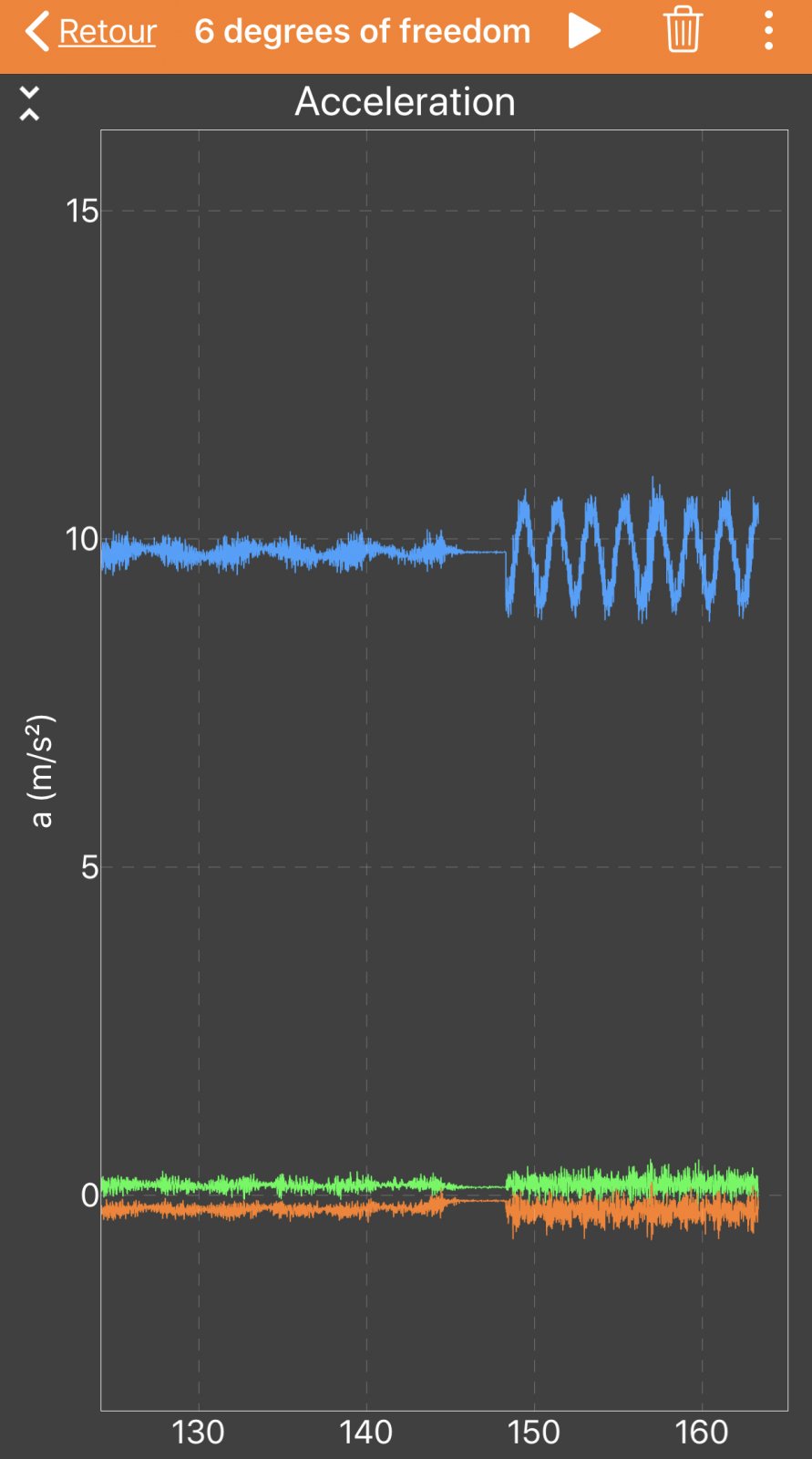

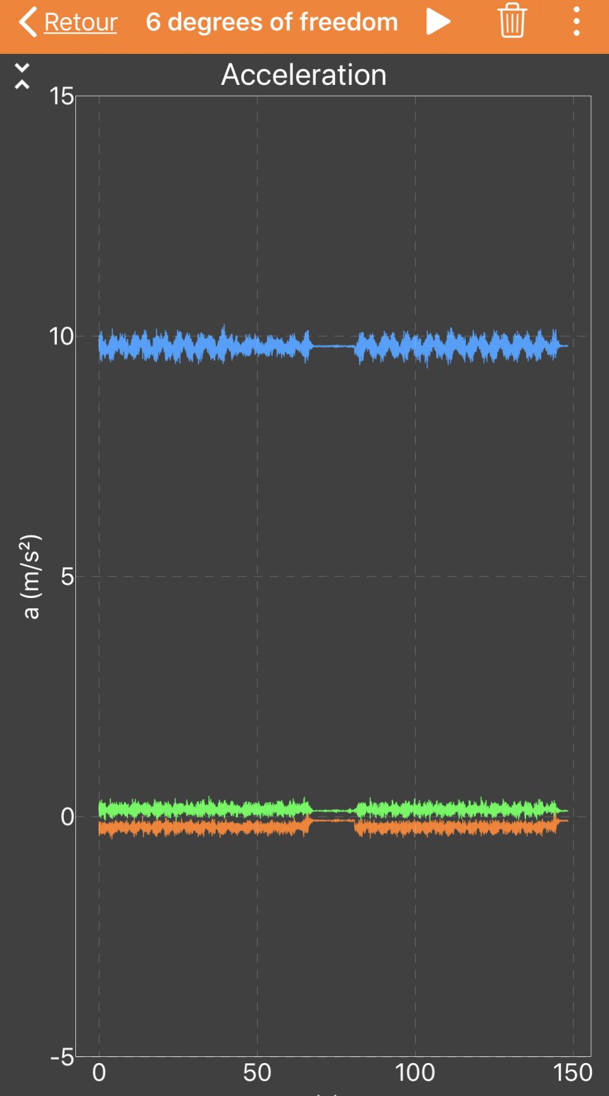

    ....and here I change the period from 7s to 2s :
