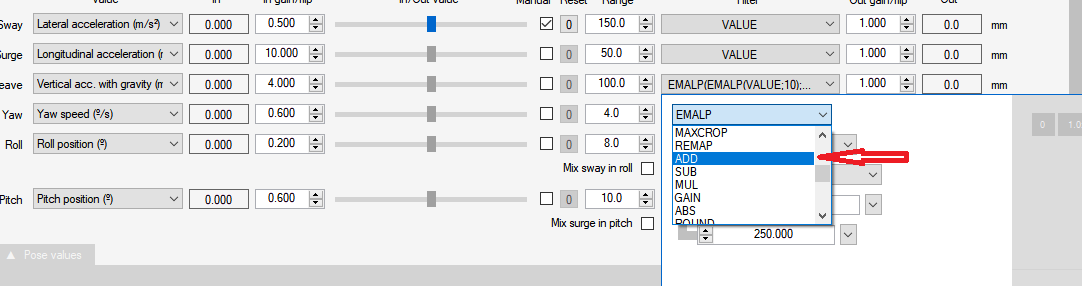

    Hi all!
    I want to add some more turbulence to heave, when flying in windy conditions (MSFS20). I tried a lot in mover (noise source, poses, directs,....), but nothing went or was satisfying. Apart from the noise function, I got weired behavior or interrupts in serial communication. Do you have any working solution to add heave? Thanks and merry christmas

    Try this filter : Add or Gain or Multi ..merry christmas !!

    Thanks Flymen! I dove deeper in your proposed settings and tried them all, but finally they all do only increase the whole heave. As a result, my sim goes up snd down too much/ fast also with the joystick up/down commands. Thats not what I wanted.
    What I tried was to add noise to heave. With huge values. With help of two Emalp filters I make them smooth. In this way I can get random +/- 50mm heave superpositioned. This gives such a good immersion of beeing really in the air!!! But this can not be the final solution, because the amount of aditional heave is allways the same, regardless of whether it is windy or not or you are on the ground or in the air.
    The perfect solution would be to grab the vertical acceleration in a seperate module, filter and multiply it somehow and the mix it to heave.

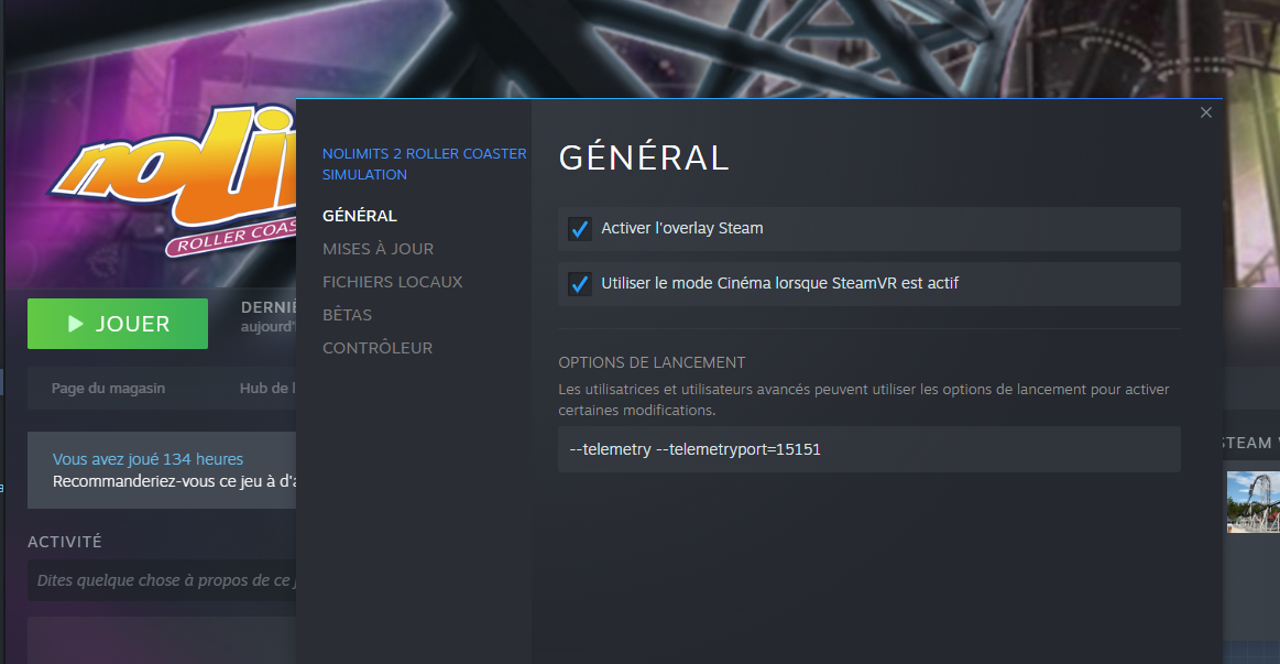

    Ok finaly work with : --telemetry --telemetryport=15151
    But the connection * Connect* must be set manually without the hook at the right time at the start game, only the hook does not work automatically !!!
