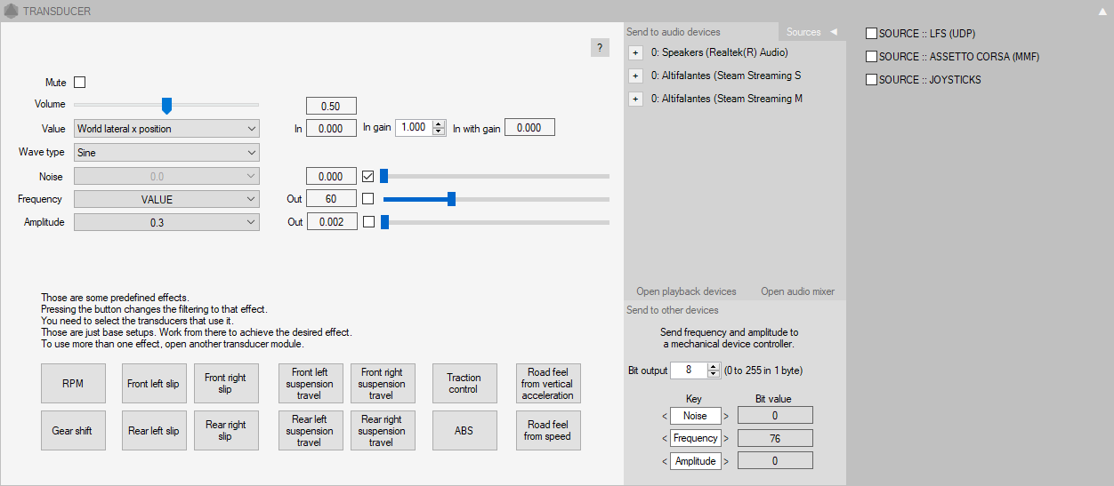

    Mover transducer module? Is this on the website for dl?

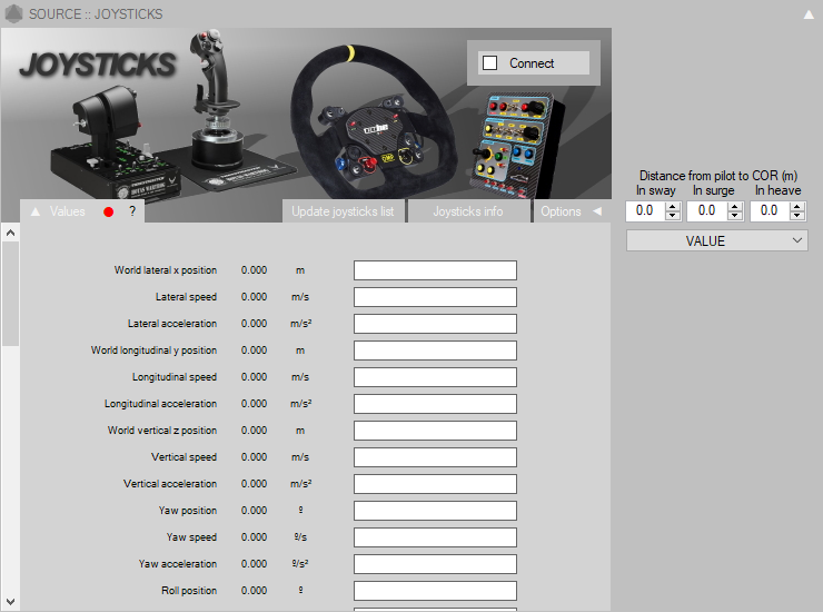

    To use it in Mover, add a Joystick source:
    You can assign the joystick buttons and axis to the values, by clicking the white rectangle followed by the desired control in the joystick.
    Then use this module like any source in the pose .
    Remember that the joystick outputs values from -1 to +1, so to have roll from -20º to 20º you need to use gain of 20.
    Same for any other axis/button.
    A good use is to define the fire button of a game to the longitudinal acceleration, and in the pose associate a noise filter.
    That way you get vibration from firing the gun.

    Yes, it's in Mover:

    But I just want to control manualy, by a joystick, my 6DOF system. So I don't want to get "vibration from firing the gun". I want to connect the joystick directly to my 6DOF system.

    You can,
    instead of clicking a button, move the desired axis to assign it to roll for example.
    But don't forgett to use gain in the pose module.
    Or you get just 1º to each side

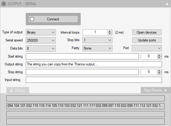

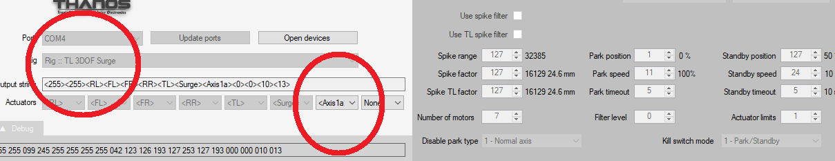

    I am having an issue with the Thanos AMC output. I have a SFX100 setup with Traction loss (motor 5), Surge (motor 6) and Sway (motor 7). I had to create a second rig for Sway and added it as <Axis1a>. The issue is that the AMC Output will not save the Axis1a. I need to add that every time I start Mover. FYI, I do not yet have all the parts for the SFX100 actuators but Surge, Sway and Traction loss actuators are working very well as I was able to create my own crude actuators.

    Ok, I see the problem. I will try to correct it in next release.
    Sorry.
    But you can also use the serial output if you want to.
    Just copy the string there.
    Give me a minute and I will post the other settings...

    @Historiker ,
    Use this settings in the serial output:
    The Thanos output is just a custom serial output.
    So to avoid the error right now, you can setup it this way.
    To the default serial, you need to chage the serial speed to 250000, put the port and copy the serial string
  12. Historiker
    2,163
    9,212Coins
    +2,181 / 19 / -1
    Thanks, you are a wonder
