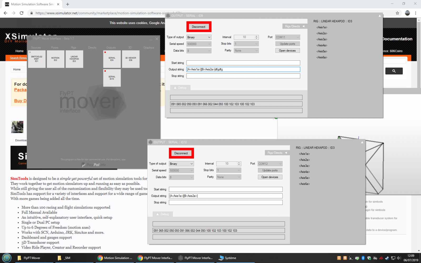

    I think I have a problem using the interface (I'm trying to switch from the previous flyput interface to this one)
    I'm using the lastest 1.7
    The problem, is that I have 3 arduino for my 6 actuator, in the old version I used 3 = 2 actuators in each ports.
    I'm trying to do the same, but as soon as I build a second serial interface, the formated output is the SAME for all the ouput
    In the screen cap, you can see I added a bunch a fasle caracter in the upper interface and there are in the debut of the lower one ....
    It seems that I canno't setup more that 1 formated output
    Am I doing something wrong ?

    Looks like a bug. Sorry.
    When I come back, I will clean all the code, with more testing and attention.
    All the last builds where made in a fast way trying to correct some speed problems. Instead of solving them, I added more problems...
    That's a static variable because of the threads.... :oops:
