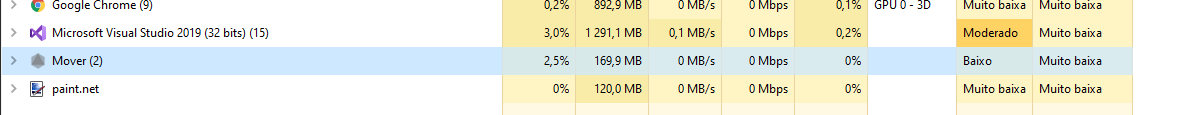

    @cfischer and @Avee ,
    It will run in Linux, so you can have a dedicated machine to run it on the "cheap".
    But in my laptop Lenovo Legion y740 with Intel(R) Core(TM) i7-9750H CPU @ 2.60GHz
    with an RTX2070 MAx-Q, I get:
    With window visible:
    With window minimized:
    But the window is OpenGL runing at 144hz.
    The above values are for a more complex scheme than what we see in the video.
    Not the ideal, but for now what I can do.
    It's that or no nodes.
    I might have a silent version without interface. But not sure it's worth.

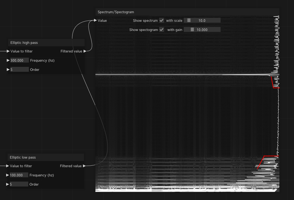

  4. pmvcda
    pmvcda aka FlyPT
    Nov 3, 2010
    2,282
    Portugal
    15,962Coins
    +2,733 / 18 / -0

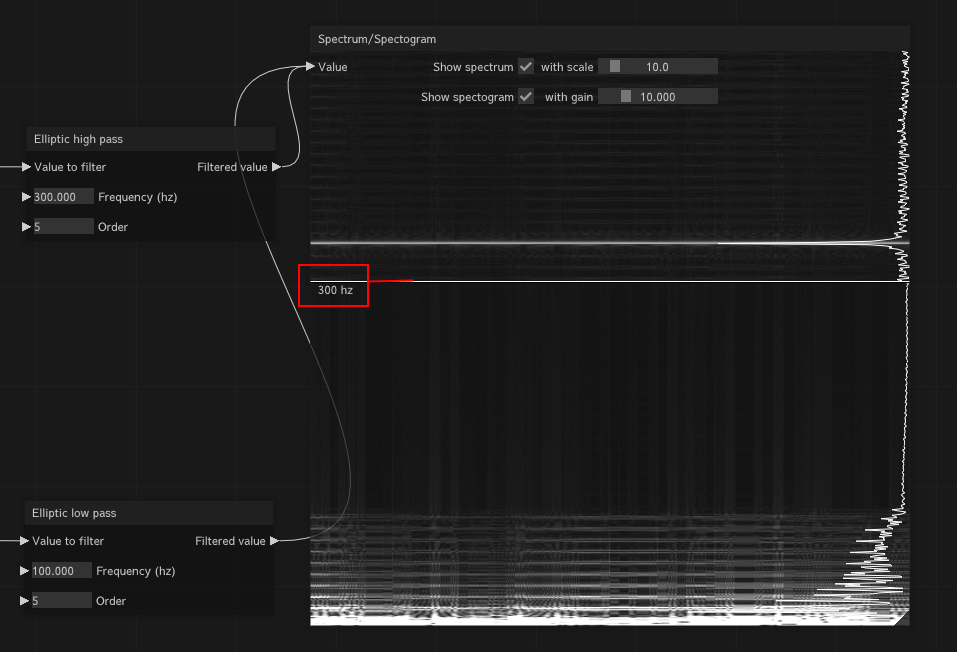

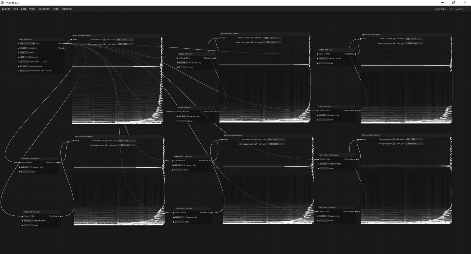

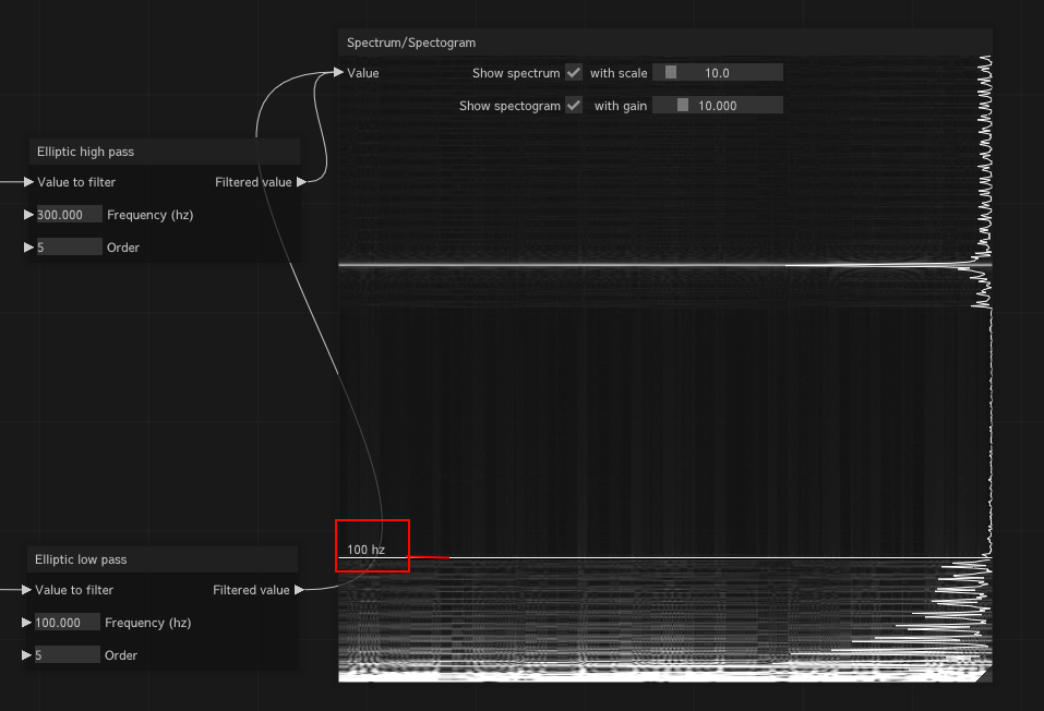

    It will be easier to comapre filters in 4.0:
    Top left, original signal with a 333hz sine and noise (333hz is the horizontal line showing in all the graphs)
    Top center: Bessel
    Top right: Elliptic
    Bottom left: Butterworth
    Bottom center: Chebyshev1
    Bottom right: Chebyshev2
    All removing the 100hz to 300hz range with order 5.
    I like the Elliptic, seems the best one.

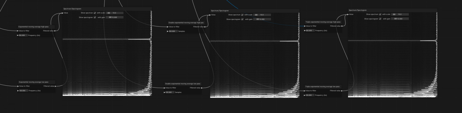

    And the EMALP, DEMALP and TEMALP
    Elliptic wins:
    Good definition in the cuttoff frequencies, keeping a good amplitude of the original value and an almost clean signal on the removed frequencies.
    Almost perfect matching on the frequencies limits:
    So try to use it in Mover 3.x (only up to order 4)

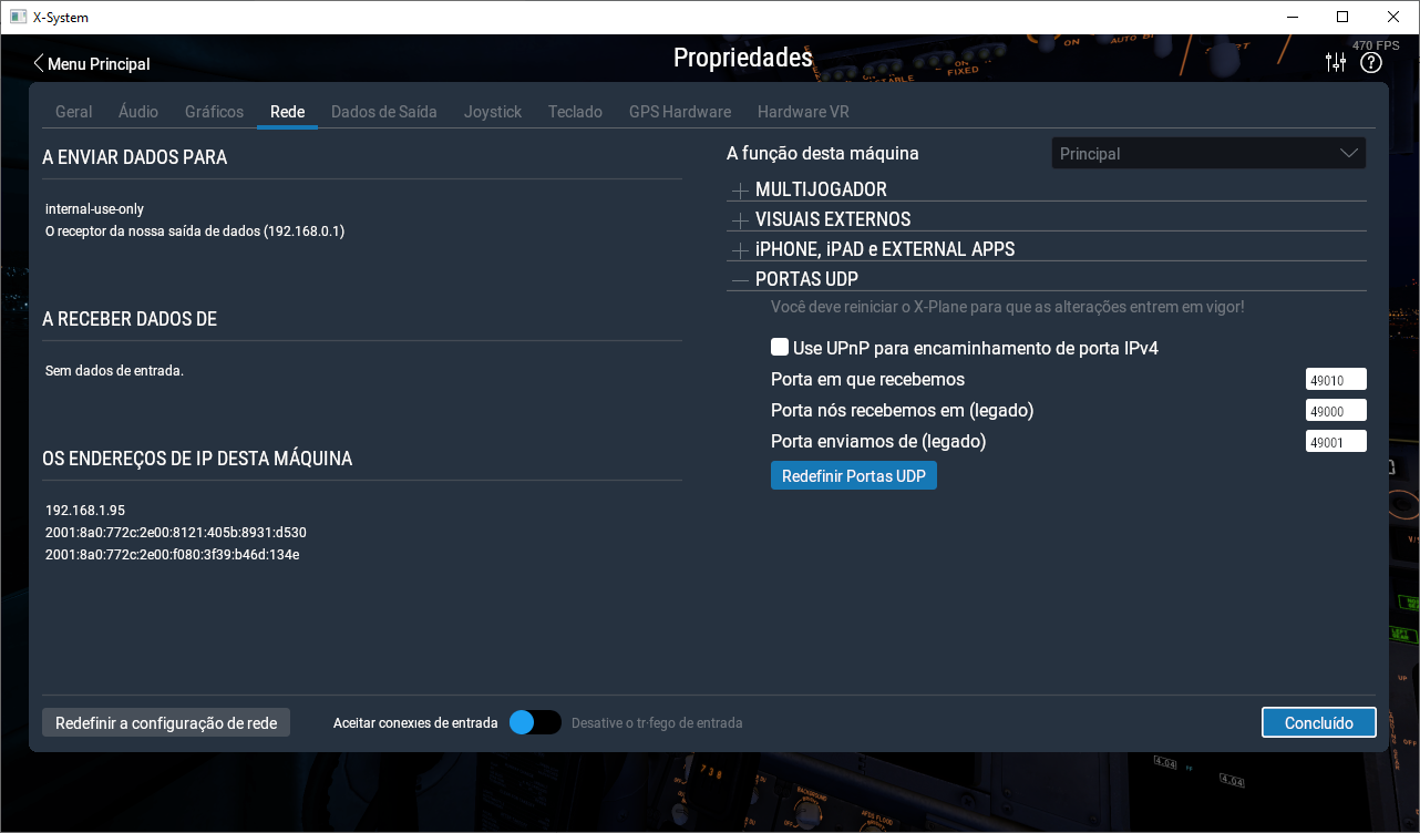

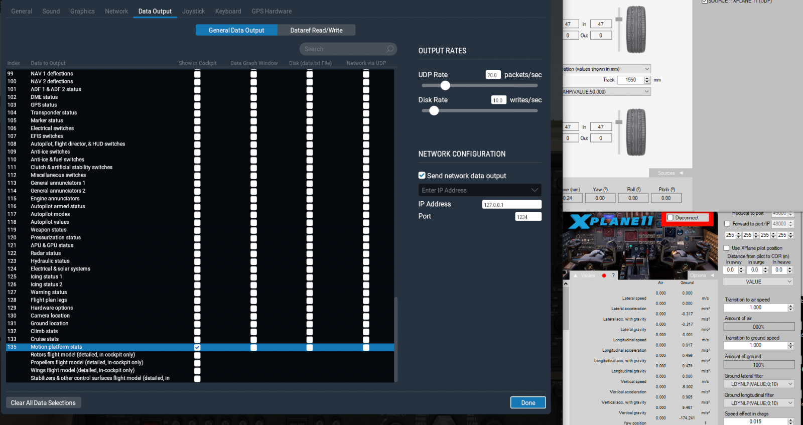

  5. Trung nguyen
    Trung nguyen New Member
    Mar 1, 2021
    - 95Coins
    @pmvcda
    hi
    As I see, Xplane-11 always sends data via 127.0.0.1 and 49000 and Flypt mover always receives data of Xplane though I check or not check data output, change port and IP in Data Output Tab. Is that right? Is that bug of Xplane-11 UDP?
  6. pmvcda
    pmvcda aka FlyPT
    Nov 3, 2010
    2,282
    Portugal
    15,962Coins
    +2,733 / 18 / -0
    Not a bug, but a feature.
    XPlane can send data in two ways.
    In that screen, you are sending the data selected on the list of that screen through the selected port.
    Mover uses the other solution, it asks for the data, you don't have to check anything.
    The port for that is setup on the network screen:
    It even asks you the port to use for the requests by external programs.

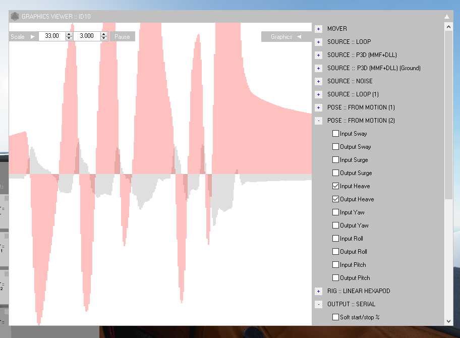

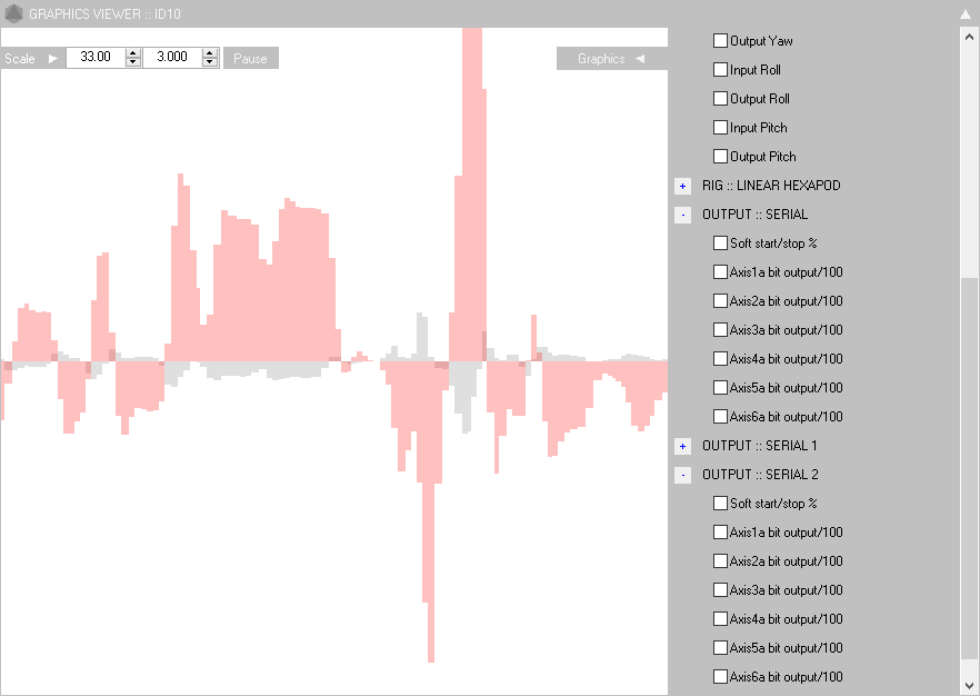

  10. PeterW
    PeterW alias Wickie
    Oct 21, 2018
    230
    Dipl. Ing. Mb (FH)
    1,768Coins
    +428 / 3 / -0
    Hi @pmvcda
    Since beginning with flight simulation (comming from race), I can see a strange behaveour with my rig.
    During huge movements - for example heave when flying a plane. I can feel "steps" in the motion, that feels like driving over a small pumper. This is disturbing the immersion at flying and I want to remove it.
    In the beginning, I thougt it was broken axial ballbearings of my actuator, but I replaced them with expensive and quality ones and nothing changed. The last two days I was playing around with filters and settings and sometimes I think there is a tiny impact - but not sure.
    So I started to look to the graphic viewer and it looks far away from smooth. The steps I can feel seem to match the steps you can se - but I am not 100% sure.
    Do you have any Ideas, how I could smooth the movement?
    Thanks a lot!!!
    Wickie
    Recording only heave, whith huge movements (made for recording)
    LOGISTIC(EMALP(EMALP(VALUE;500);500);220;2)
    With "high precision" - setting it looks even worse, but seems to feel tiny better:
  11. pmvcda
    pmvcda aka FlyPT
    Nov 3, 2010
    2,282
    Portugal
    15,962Coins
    +2,733 / 18 / -0
    With FS2020?
    The UI is updated independantlly of the calculations.
    The steps you see on the graphics can be caused by two reasons:
    -Getting data from game at low rate
    -The UI is updated slowwlly and some values are not updateda nd missed in the graphic (for speed reasons)
    When you use high precision, the calculation thread is more intensive and that causes the ui thread to update slower, showing more steps.
    Thi is not explaining waht you feel, just to say that the graphics are for guidance, not really precise.
    It's going to change in 4.0 where I store all the calculations.
    Tell me:
    Are you testing live data or recorded one?
    And if that's FS2020 , other game or in all of them and large movements.
    Doesn't seem a filter problem.
  12. PeterW
    PeterW alias Wickie
    Oct 21, 2018
    230
    Dipl. Ing. Mb (FH)
    1,768Coins
    +428 / 3 / -0
    Thanks a lot for the fast answer!!
    It really wasnt any setting in the mover!!! I was able to change some motor settings and now everything is butter-smooth!!
    Wickie

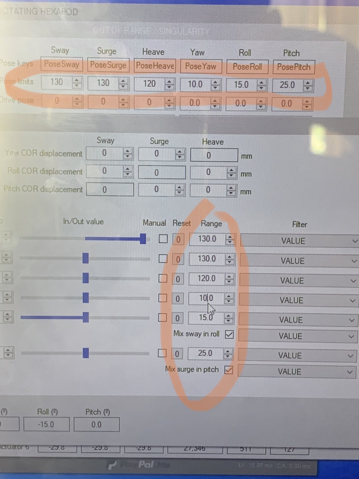

  14. Marco Annunziata
    Dec 2, 2019
    130
    919Coins
    +19 / 0 / -0
    Hello, sorry for the late answer but I got some issues with the servo driver which has a firmware bug if used in pulse and direction mode but the Chinese factory doesn't want to admit his issue so I must change supplier for the future platforms.
    From this video, you can see that when the pitch or roll position reaches the maximum angle, all the rig gets blocked until I release the pitch stick, which is the right on the joypad. But that does not always happen however when the rig gets in singularity position seems it doesn't such but in extreme singularity, the burst happens. Keep in mind that the ring never loses its position just got stuck for a while then the mover release all the packets buffered all in one time.
    Marco
  15. hexpod
    hexpod http://heXpod.xyz
    Apr 18, 2016
    1,228
    berlin
    7,900Coins
    +381 / 5 / -0
    DC motor, 6DOF
    I understand you want to do a stress test but your pose limits and range are not set in accordance to your actuator course.
    I would reduce them to something more reasonable like 200 for translations and 10-20-30 for yaw roll and pitch
  16. Marco Annunziata
    Dec 2, 2019
    130
    919Coins
    +19 / 0 / -0
    I agree with you but it was just to understand the reason for the bursts, the actuator gets stopped when out of range and that's an amazing feature, but I would understand the reason for the burst, I don't think is a mathematical reason
    Keep in mind that the actuator has about 850 mm of stroke and would be nice to exploit all and I have invested all my resources to create an adrenaline motion platform so the extreme positions are not all as a stress test
