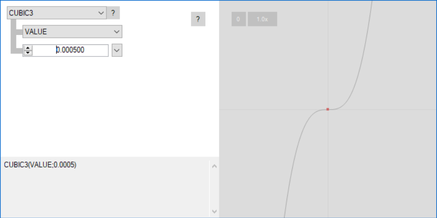

    Have a filtering question. Don't know whether it's a bug or a (correct) feature in DCS, but some piston aircraft show quite some yaw and heave acceleration numbers when standing with engine idling on the tarmac. (To try it yourself: Quick mission, Caucasus, TF-51D, Hot start from Batumi parking.)
    So when I adjust and filter my ground yaw and heave settings in order to getting full motion range when taxi-cornering on the tarmac or on touch down, the movements are too big when the motor is idling. I wouldn't mind some additional vibrations to my ButtKicker, but it's just too much.
    Question to pmvcda and all others: can we set up something like a 'dead zone'? A gateway that filters away the lowest VAUES (not CHANGES or spikes). Kinda cropping, but the other way round. Only big changes/values would come thru.
    Any other thoughts and ideas?
    P.S. I tried speed instead of acceleration. It helps some, but it's still too much vibration in idling.

    What I have been using to soften this is the spike filter. I set it to 3 (forget which field, but it is the middle one), and that does a great job to tone it down.

    I noticed as well strong low RPM shakes embedded in the flight model. I could filter them with simple EMA orders. I just put two or three of them in cascade to diminish low RPM shakes particularly on heave and roll. After that I find them very coherent and enjoyable

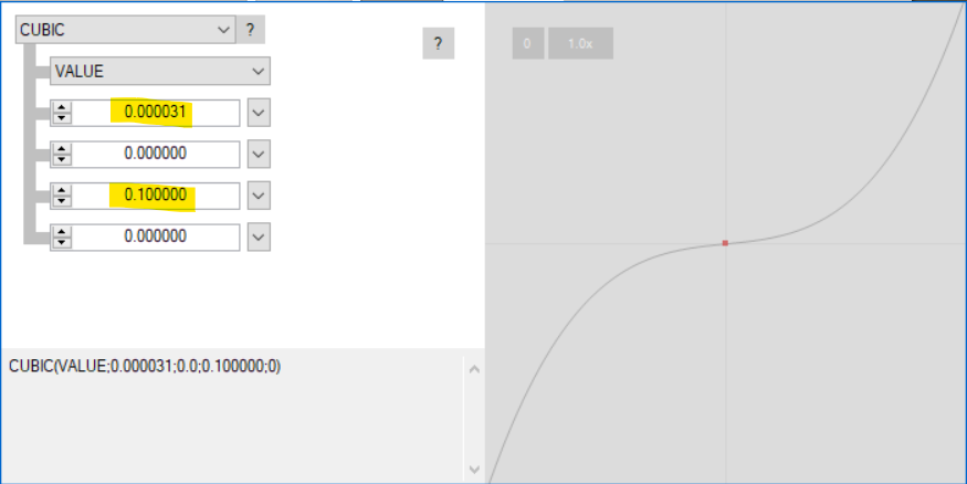

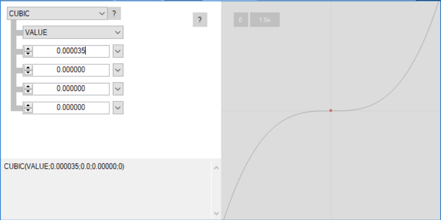

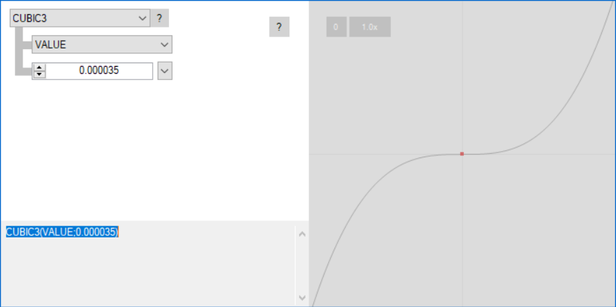

    EDIT: I actually found two filters CUBIC and CUBIC3 that may act like a 'dead zone' (Master pmvcda actually describes them as that). You do not have a mathematical Zero in it. But values are so low in the 'zone' that it works perfect for the intended effect of washing out the small engine rumbles while not compromising the big spikes or amplitudes when taxiing or at touchdown.
    Of course, the curve is an exponential (as the 'CUBIC' names imply), but I can live quite good with that. I thought of compensating the exponential curve by using speed instead of acceleration as input, but I found it wasn't necessary.
    You can tune the curves to a large extent, make a high exponential curve (as in pic cubic3_b), a 'clean' one (as in
    cubic_a) or you can increas the 'like deadzone' as in the other two examples (same result with any of the two cubic filters).
    And finally a big hail to whoever made up that we have two individual settings for Air and Ground!:cheers
