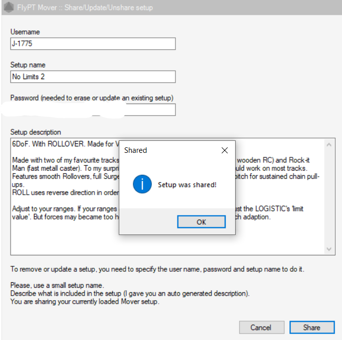

    So sorry @pmvcda to say that my upload issues are not gone with 3.5.1. After confirmation I don't see them in the repository.
    For help in debugging I attach the two profiles, also a sample of my description text (any 'forbidden' characters)?

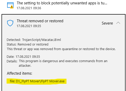

    @pmvcda there's one more thing you may want to know: 3.5.1 exe created a virus warning and was removed from my game system by Win10 native virus defender . However, F-Secure defender on my office system does NOT recognize a threat.

    The problem is on the ' used in the description
    I have to limit that or ... might have another idea.

    Never mind, once I knew and could replace the apostrophe, my uploads worked fine! There's actually more forbidden characters, like ° and «». Those don't mess up with the upload, but they add strange additional characters...
