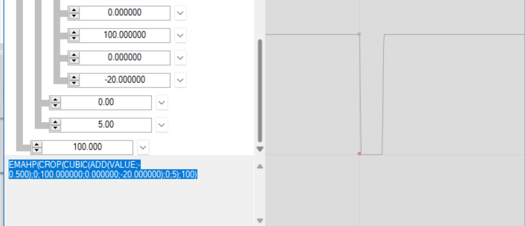

    @J-1775 Unfortunately as the gear % is affected by speed in drag (as it's intention was primarily to allow drag effect) it's hard to get a completely reliable result as full extension is a moving target and not always 1.0
    If a non speed-modified version of gear extension was exposed it would be more reliably triggered.
    That said, the methodology I think shows promise is below - this was based on Fly PT's advice elsewhere, I've yet to experiment much though.
    EMAHP(CROP(CUBIC(ADD(VALUE;-0.500);0;100.000000;0.000000;-20.000000);0;5);100)

    +10 / 0 / -0
    Hopefully screenshots attached.
    Basically if you consider the gear a value between 0 and 1 you are making only 0-0.X and 0.Y-1.0 result in changing value (in this case a quick jump between 5 at either extreme and 0 in the middle), and shunting the graph over to the middle by "ADD" -0.5.... Whether its best with HP or LP filter I've not yet tried.

    Thanks Zeeflyboy, will give that a shot!
    EDIT: I had my two MoverRecs from Spitfire and P-51 run quickly thru your filtering and saw quite the results I wanted. Actually I have two spikes succeding quickly each other, the gaps being differently wide on each of the four events (each AC, start and returning events). I'm sure I can tune that!
    And btw, the Spitfire had asynchronous gear ─ so maybe I should rather widen the gap instead of eliminating it! :)

    Great. I’d have a play with a LP at the top to alter the thunkyness too, and you can try altering the “b” of the cubic function to change how steep the walls are.
    Let me know if you end up finding improvements during your tweaks.
    Hopefully @pmvcda can expose a pure gear position in the source for MSFS/IL2/DCS to make it a little easier to trigger correctly.

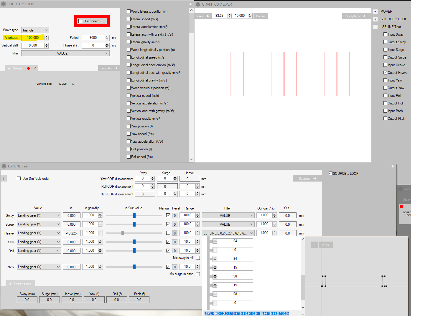

    EDIT: I guess I found a workaround! It's only the input fields that are restricted to integers. If I type in the values manually floats are accepted!
    @pmvcda: I have a problem with LSPLINE filter. When I 'draw' a simple spline (like the one attached) and test it with a triangle loop the graph comes up with the expected results ('barcode lines'). But only when the amplitude is set to 100. And because LSPLINE input values must be integers I can't scale down the spline to be within the range of my actual source (which is within 0-to-1). My natural instinct was to compensate with Gain, but that wouldn't work.
    I think LSPLINE and CSPLINE are interesting and useful filters that are not only very intuitive :), but in many cases may replace a whole chain of other filters. I appreciate if you'd look into this, thanks!

    I can add decimal places easily for the next build.
    Those filters are not what I wanted to.
    The idea was to have them dynamic, I mean the values could be filters, and the result could be filtered also.
    But this type of interface is problematic, and we have access only to the value we are filtering.
    In Mover 4.0 this is solved already, and can be really powerful.

    Thanks again Zeeflyboy. I was on the way of republishing my IL-2 profile including your suggestion, when I stumbled across the LSPLINE filter. Though its use in v3.x is indeed very limited (allowing no other filter before or after) it seemed like sufficient for my purpose. LSPLINE and CSPLINE are extremly intuitive to handle and to understand. And the drag'n'drop interface eases the creation of a filter even more. This is the 'compromise' jolt version 'for the lazy' I came up with. Works with 2/3 and 3/3 gear range, but gives an additional (unmotivated) jolt with the latter...
    LSPLINE(0;0;0.01;3;0.04;3;0.04;0;0.34;0;0.34;3;0.38;3;0.38;0;0.96;0;0.96;3;0.99;3;1;0)
