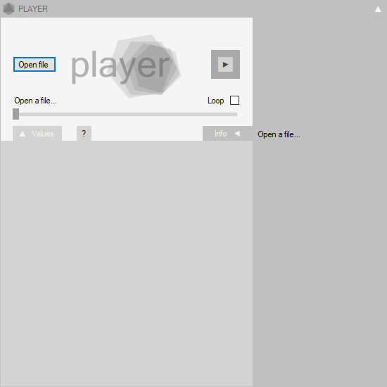

    I'm trying to demo MSFS2020 and the motion simulator to people with no experience of piloting a plane.
    I'm using a flight recorder for MSFS2020. Something like: https://flightsim.to/file/8163/flight-recorder.
    The telemetry coming from SimConnect through playback is quite rough, like flying through lots of turbulence. I assume this is due to the resolution of the recorded data by the flight recorder or maybe something else is going on?

    I need to see the data.
    How are you playing it in Mover?
    Sorry don't know this recorder.
    You can use a phone with Phyphox. The player included in Mover can read the data recorded by it.
    There's instructions somewhere in this topic. Give me aminute
    EDIT: Here: https://www.xsimulator.net/community/threads/flypt-mover.13464/page-18#post-185169

    FS doesn't yet have its own native flight recorder, so they are all 3rd party. But it's on their roadmap.
    I'm recording a flight and playing it back through MSFS2020 to recreate the flight visually. It's not a recorder to specifically record telemetry for Mover. However, when playing back a recorded flight, the FS2020 (SIMCONNECT) module receives telemetry, although not of the same quality as experienced during the recording.
    I have used the Mover recorder and player, but that doesn't playback to FS and control aircraft.

    Ok, I understand.
    Can't test right now, but that might be low resolution/frequency data. Is there an otion to increase the rate of data capture in that app?

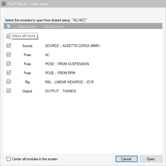

    Hi noob here. Just built a 6 dof hexapod with 80st motors and thanos. Is there any simplified video tutorial on applying filters. I can't wrap my head around it lol. TIA guys.

    Take a look here: https://www.flyptmover.com/basics/filters
    Next Mover version is going to include an easier setup. I think I'm going to call it black box.
    First one is specific for cars and makes filtering "invisible".
    If feedback is good I might go for an aircraft version.

    Hi mate thanks for your quick reply. I've had a look at that but still very confused. I have a light grasp on it. My main issue is the amount of filtering I need to apply.
    When will black box be ready to download?
    I had a sfx 150 and coming from srs this is definitely out of my league atm

    Next 3 to 4 days. Maybe earlier.
    Let me put this out. I think it will be easier.
    Something like smooth, amplitude and gain. not much for each dof.
