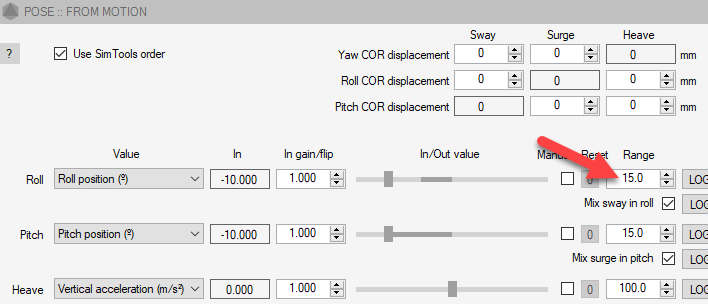

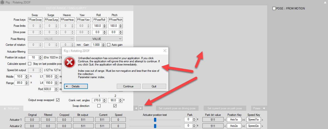

    I'm a FlyPT Newbie, started building my first simple 2DOF rig (PGSaw motors).
    1. Bug Report: I added rotating 2DOF rig, but there is no picture in the Rig window, and clicking on arrow that flips through pictures for other rigs I get an "unhandled exception" error.
    2. If I add 3rd motor for yaw (traction loss for car sims, not sure how to call it for planes) - how do I change the setup? There doesn't seem to be a rig that's 2DOF + traction loss, or 3DOF with rotational motors in correct configuration.
    3. Any guides or advice on setting up 2DOF rig for Flight Simulator 2020 in FlyPT? I can't find any guides about how to set up and mix inputs for 2DOF that would react to different events. For example I want to use roll speed for roll, but not return to neutral when stable roll is holding, but leave a little bit of an angle so the body feels it's at an angle, etc. Even the basics: I'm not clear how to map everything to just 2DOF.

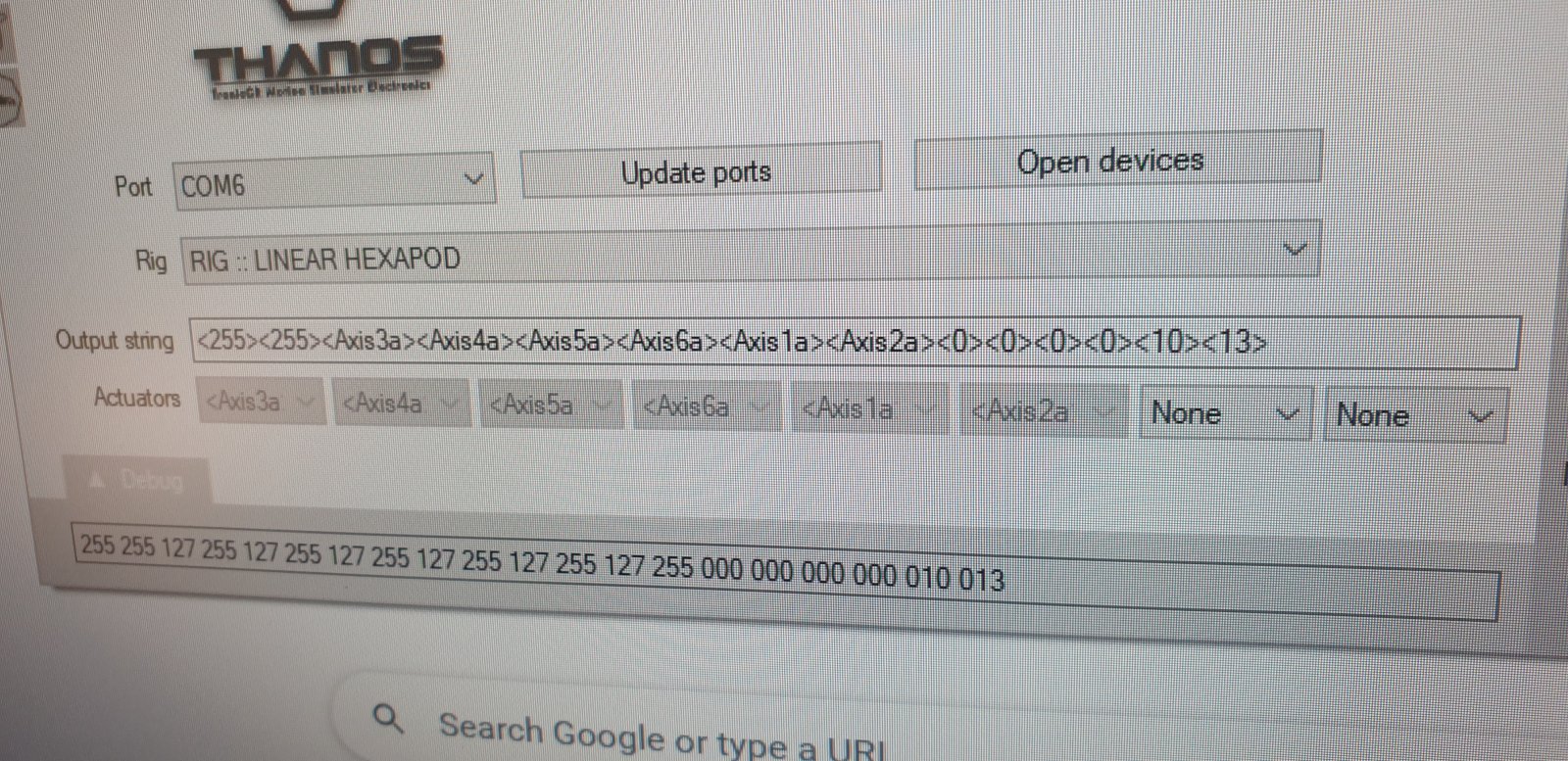

    Hi everyone,
    i have a stupid question.
    I've build a 6 DOF Rotary Platform with a Thanos AMC-AASD15A controller.
    Everything works super, except one little thing.
    With FlyPt Mover, my YAW axis always moves in the opposite direction.
    Is there a way to invert this here? In FlyPt Mover I tried to enter a negative value under gain for my pose, unfortunately without success.
    In the simulation view of FlyPT Mover everything moves in the right direction.
    Thank you for your help!
    Mario
  8. pmvcda
    pmvcda aka FlyPT
    Nov 3, 2010
    2,292
    Portugal
    16,022Coins
    +2,744 / 18 / -0
    Want to see some pics ;)
    Check the order of the actuators!
    Take a look here: https://www.flyptmover.com/outputs/thanos
    Scroll to the end of the page where I try to explain the mess we have with that.

    Yes, the pictures are still missing. I need to make them.
    To add the 3rd actuator, you can add a direct to control that actuator. It will be availlble to add to the output string later.
    For 2DOF rigs, honestlly, never thought about setups.
    But let me think about it. I will post something tomorrow.

    It's not just the picture itself - without the reference illustration it's impossible to tell what sizes do what: all the L1...L6 etc.
    I played with it for a few hours, and it looks like to mix pitch and roll acceleration into Pitch and Roll (in addition to built-in "mix sway" and "mix surge" I can add "DOF From Value" pose, and it will mix into the main "Pose from Motion" of both are selected in the Rig module. Am I correct, is this the best way to mix position/acceleration/surge(or sway) into one axis?
    Another question: When values sum up I see red "singluarity" message. For example roll and pitch by themselves look good, but when surge is added - it goes too much. Is there a "master clipping" somewhere, that won't let that total value exceed specific margins? SMC3 has its own limiter, but I'd rather make sure FlyPT won't try to overextend the motors and not rely on anything else. I see there are clip filters in rules, but not a master crop filter of some sort. Maybe I'm not looking at the right place...

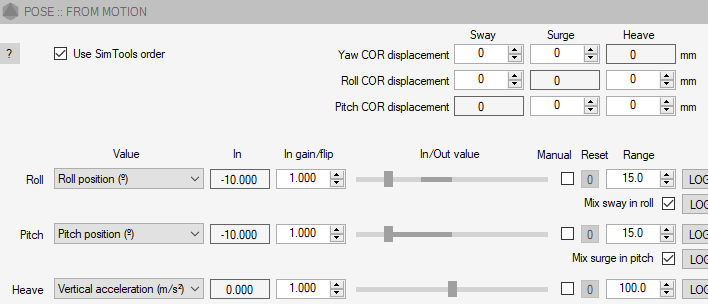

    Another question: what units does FlyPT use for "range", "intensity", "pose limits" and actuator positions (original/filtered/cropped)? Is it percent% 0 to 100%, degrees, value range like 256,512 or1024 or something else? What are the full value ranges of those variables, and if those are percentages, of what exactly?
    If Pose has "roll position" at Range 15.0, and a sway mix-in (original sway is at Range 100) - will the mix exceed 100% in full right roll + added sway for example? What will happen if it does? Will roll be only 10% of what happens in MSFS2020? Or are those units doing something else?
  12. pmvcda
    pmvcda aka FlyPT
    Nov 3, 2010
    2,292
    Portugal
    16,022Coins
    +2,744 / 18 / -0
    I'm on the phone, so please excuse me for some errors.
    You can add a 3d view to get an idea of what is each value.
    When you change them, you can see the result in the 3d preview.
    While in Simtools, you think of actuators position, in Mover you think in the pose of the rig.
    Mover calculates the actuators positions to achieve a specific pose. (you can do the same you do with SimTools by using directs, to directly control one actuator)
    The pose from motion module, generates a pose from the data received from the game. Usually we use linear accelerations and rotations positions or speed.
    The idea of the mix is to tilt the rig to make the user feel the constant linear acceleration.
    If you had surge, you could have acceleration variations represented on surge and the constant acceleration in pitch.
    This is the reason for using a high ass in the surge, to get variations and a low pass to get the constant values in pitch.
    This module adds this mix to the rotations.
    And this addition might cause values to go over the specified rig limits causing the message of out of range.
    Please, try to adjust dimensions first, by using the 3d view. They are milimiters. I will try to add a picture in the next build.
  13. pmvcda
    pmvcda aka FlyPT
    Nov 3, 2010
    2,292
    Portugal
    16,022Coins
    +2,744 / 18 / -0
    Linear is milimiters, rotations are degrees.
    If the sum of the mix and roll go above the range, the value os cropped to range.
    You are messing it a bit. And on the phone it's not easy to explain.
    I will be back explaining it.
    But alleasure units ar mm and degrees.
    The actuator bit value, is a value related to the amount of bits used by the actuator and the relation to the range of the actuator in mm or degrees.
    That relation can be changed with scale to adjust the values...
    I will explain better.

    So, in "Pose: from motion" the "Range" value 15 is in degrees, not just the actuator positions? If I want it to max out at my rig maximum roll, and let's say it's 10 degrees left and right, I should set range at 20?
    And "Heave" is in mm? That makes sense.

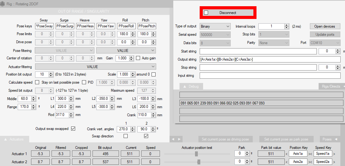

    I have a problem: my electronics and motors work with SMC3 Tools, both motors are moving and obey commands. However when I connect FlyPT - only one motor is moving no matter what I do. Here's what my connection and rig looks like:
    Connection parameters are taken from SMC3 Tutorial. One motor is working fine, but nothing is happening with another one. Both actuators are moving in 3D View and Rig bottom lines, but only one is moving in real life. When I disconnect FlyPT and connect SMC3 Tools again - both are moving fine. Close SMC3, open FlyPT - only one is moving again... What could be the problem? Something with connection settings or rig setup??? Please advise...

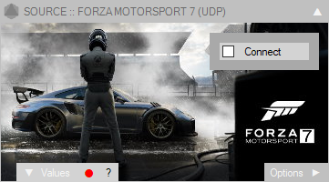

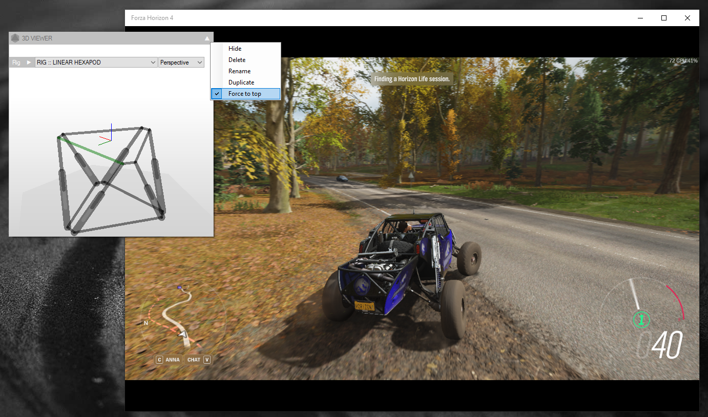

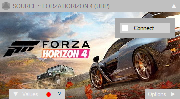

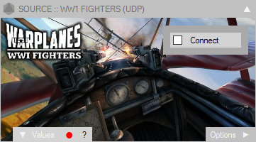

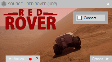

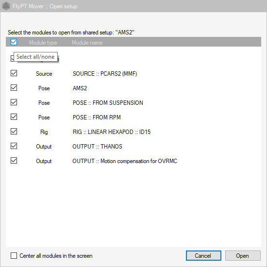

    Mover 3.5.3
    New version with:
    - New Red Rover source
    - New Forza7 source
    - New Forza Horizon 4 source
    - New WW1 source NOT WORKING CORRECTLLY
    Not much info and really strange values. Waiting for more info to correct it.
    - Added checkbox when opening setups, to select/deselect all the modules.
    - Added option to make modules top most, to hover the games when possible.
    Really needed in full screen only games.

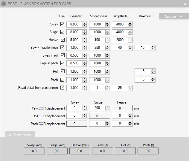

    Another important module added in 3.5.3 is the black box pose for cars.
    It's for testing purposes and the idea is to make it more intuitive to setup the motion for cars.
