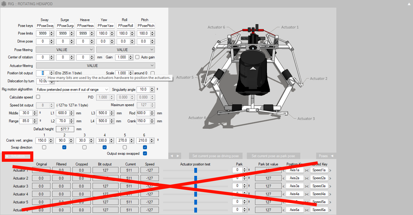

    I'm having some trouble getting Flypt Mover working correctly with some hobby servos. I'm using the arduino hobby servo sketch from EARobbie and have it working in Simtools.
    In Mover, I've setup a serial output and a 'Just Pose' Rig. I can get the first servo working as intended using A<Axis1b>] in the serial output but when I change this to A<Axis1b>]B<Axis2b>] Both servos will move but with a significant delay of around a second or so. I'm not sure if there is some incompatibility allowing the servo code to work on Simtools but not with Mover.
    Anyone got any ideas? Thanks

    Just to be sure:
    Are you using 9600 in the speed?
    Are you using decimal output?
    Are you using 8 bits in the rig/actuators? (from a fast look, it seems to use 1 byte to set the position)

    Yes, that's correct; 9600 Serial Speed, 8 Data Bits in both the serial output and Position bit output and Decimal set as output in the serial output.

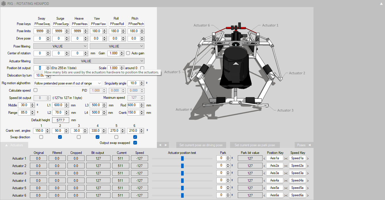

    And in the rig module?
    Did you change from 10 to 8bits?
    See attached image in the last post

    Yes I did, to give (0 to 255 in 1 byte)

    @GWiz ,
    Wait, I have one idea.
    Please try to hide the actuators info:

    I can hide the actuator info, but it doesn't seem to help.
