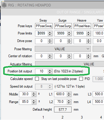

    For those struggling to get Arduino code and flyPT mover working, I have attached some code I wrote that works well and handles some erroneous data that the current released version of Mover exhibits during start and stop periods of serial output module.
    For testing with RC servos, I have found using output interval up to 100ms (10ms x 10 loop iterations) works perfectly well.
    Set the output to 10bit Decimal, 57600,8,N,1.
    Output string format is:
    A<Axis1a>B<Axis2a>C<Axis3a>D<Axis4a>E<Axis5a>F<Axis6a>X.
    Start and Stop strings can be: A512B512C513D512E513F512X. (just sets the midpoint of typical servos).
    This will work as-is, but can be fine-tuned with the below ...
    I have also attached an arduino code that moves each of your servos through their full range and outputs the min, mid and max values for each, you can use these values to fine-tune the other code (although its not necessary for concept testing.) Put the range test code on your arduino first, save the output from Serial Monitor to notepad and manually add the min / max values in the "MM_stewart_test4.ino" before uploading that to Arduino. Can also use the 'mid' values to update the Start and Stop strings above to fine tune for your particular servos.

    Fantastic job @Mat_Menzies ! This is a much neater code than the ham-fisted, clunky job I was trying to write. I had mine working until I removed the serial.print lines and then it would only work if I added a delay instead! It was the coding equivalent of building some furniture with only a hammer. Your code however is very neat and easy to follow for us amateurs!
    I couldn't work out how to get Mover to output in 10bit Decimal, so I changed to 8bit Decimal and altered the mapping lines to:
    servoData[0] = map(rawServoData[0], 0, 255, 0, 180);
    etc.
    I've tested it on both Simtools and Mover and can confirm that it works on both.
    Incidentally @pmvcda , The delayed servo movement issue I was having earlier appeared to be related to setting too low a Serial Speed in Mover. The code I posted earlier works OK in Simtools at 9600, but only at a higher serial speed in Mover such as 57600. It wasn't anything to do with the missing zeros when reporting smaller values.

  19. Mat_Menzies
    Mat_Menzies New Member
    Aug 6, 2021
    17
    94Coins
    +9 / 0 / -0
    Hi @GWiz good job on the 8 bit work around :)
    You can adjust the output resolution in your rig configuration panel here:
