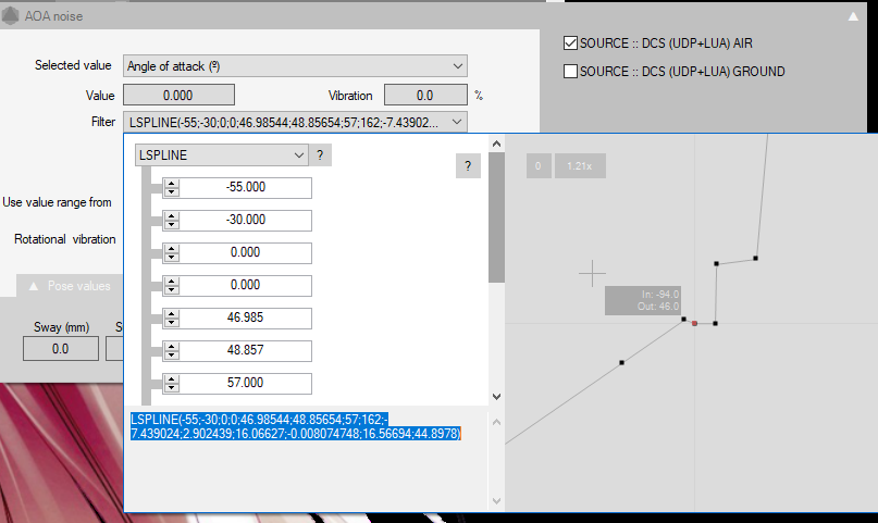

    hi
    TOPIC : DCS
    I have a problem with putting a pose.
    I would like to add the stall speed of the plane in DCS.
    So that at speeds below 270 km / h
    there were vibrations.
    Nice as if the vibrations build up as the speed decreases.
    Thank you and best regards

    The stall value works for some planes (i think) but i find POSE from noise generated from value (speed could work) and use a LSPLINE or CSPLINE filter works well to add noise. Easy to configure as you can set the points and have it to 0 for speeds above 270. I just use it for AOA and panel shake on my Viper though

    How did you get your AOA value?

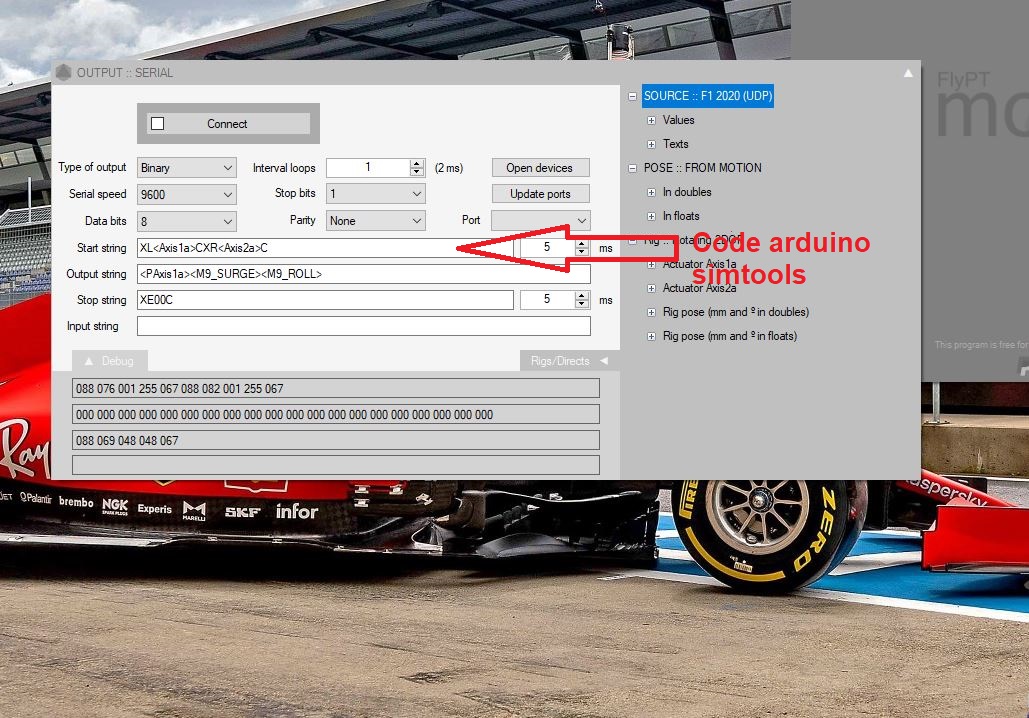

    Hello, I can not configure my arduino uno + saberthoot + 12v motor on flymover the game telemetry works but not the motors the problem comes from the output impossible to understand if a person can help thank you just showed me a picture of its setting output thank you .

    I cannot find AOA on my FlyPT version.
    Which version are you using?
    What kind of plug do you use for DCS?
    Thank you very much and best regards
  10. pmvcda
    pmvcda aka FlyPT
    Nov 3, 2010
    2,290
    Portugal
    16,010Coins
    +2,744 / 18 / -0
    Well, sorry for having a life outside of this...
    Now let's put it working.
    I don't know the settings used in Simtools to connect with Uno and Sabertooth.
    Never used them.
    Show here what you use in SimTools (get a screenshot).
    The settings in Mover should be the same.
    I think you told me that it was working on SimTools.

    AOA in DCS should be on the latest version... I think.
    I'm a bit confused with my work builds.
    To get it you need to update the Lua file to the latest one included in the download.

    Ok just saw this post.
    Try to increase the interval loops to 2 or 3 (in the output).
    Also make sure the rig is setup with 10 bits on the actuators.
    Just the output does nothing, you need a source, a pose and a rig to generate actuators.
    With actuators, you can select them in the output.
    From that image, there's no <Axis1a>. You don't have actuators set.
    Post here the setup file so I can take a look and see what is missing.

    Hello, please help here is the file I have an arduino with a code for simtools and a saberthoot for f1 2021 dx12

    Try with this:
    The file you posted had the lines swapped and you where sending a strange string.
    Please try and see if you get some motion.

    I have impeccable movement at 6 I will test the effects a big thank you
