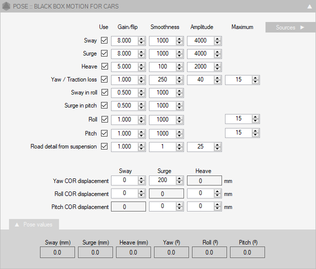

    Ok just try your tutorial for dirt rally 2.0 in YouTube to setup the rig dofreality h3 which is similar to my diy and no rig 2dof plus traction loss found to choose.
    I struggle a lot and hope, that I can use this one to make it better.
    i want to make virtual tracker as well for ovmc. But first I have to make a good profile for the motion. Unfortunately there are no tutorial on youtube with 2dof.. only 6dof
    I love the suspension and special the rpm vibrations.

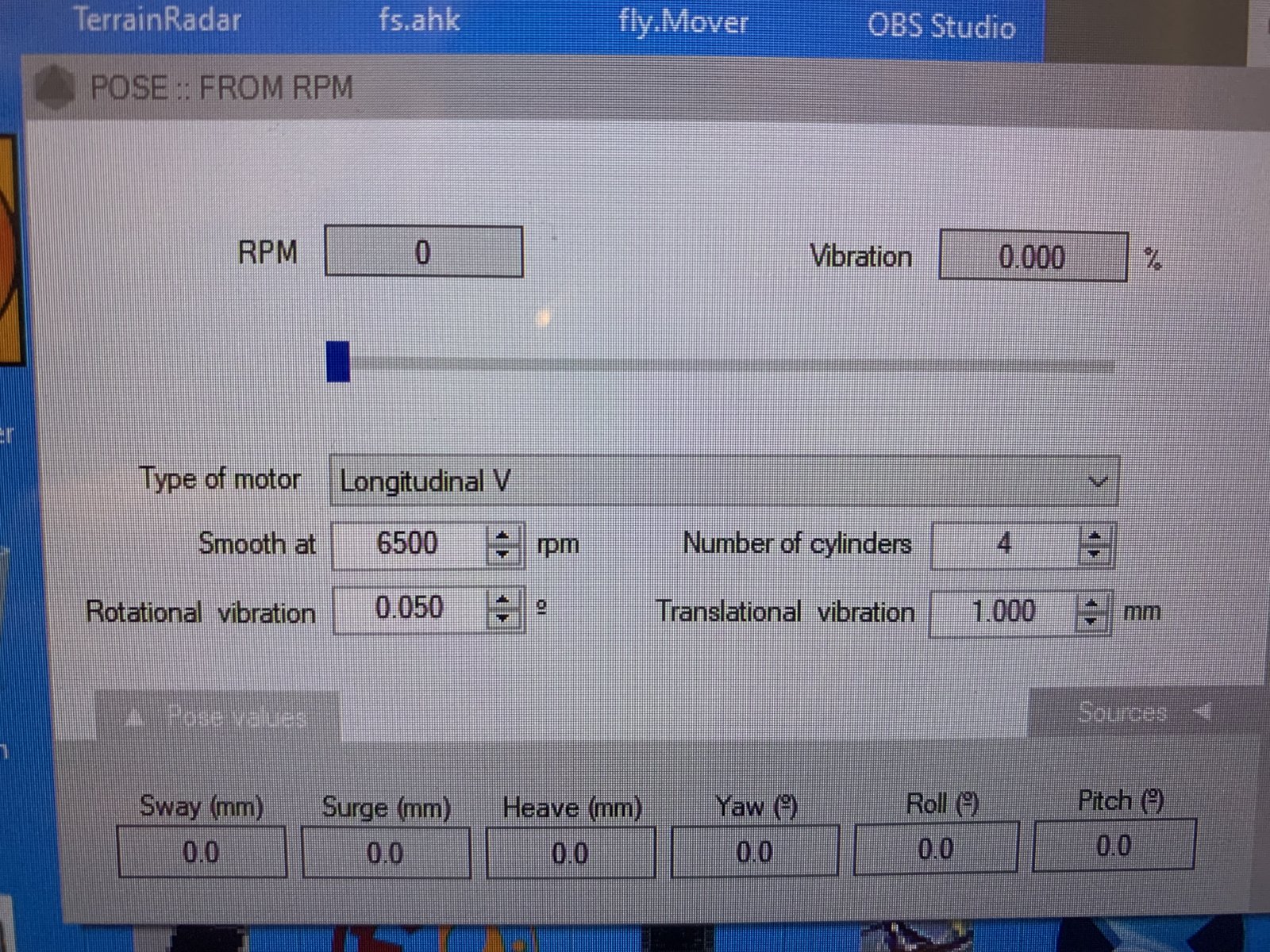

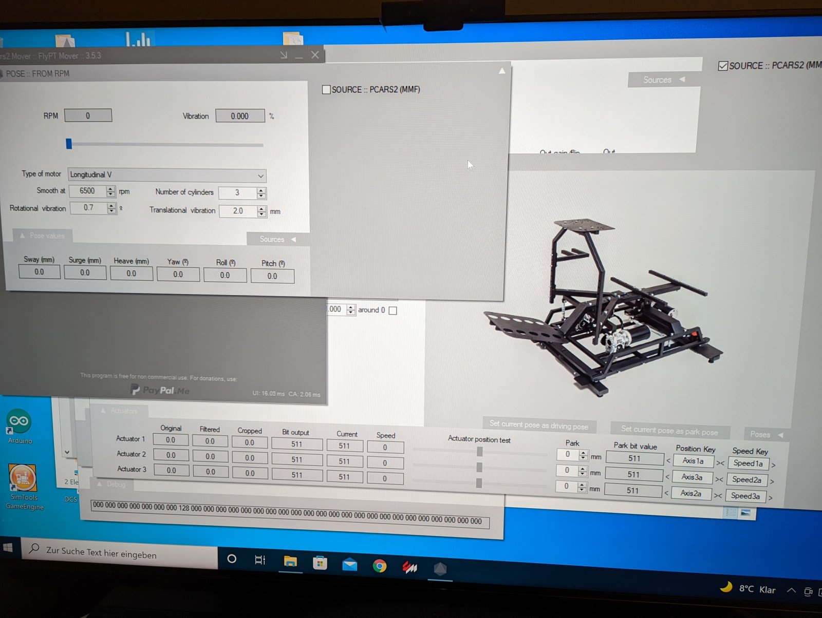

    Trying to get Pose from RPM to work. The only method I see to modify rig motion intensity is Rotational and Translational vibration. I set both to their absolute minimums of .1 and they are still crazy intense and unusable. I was just moving the RPM slider to test and don't dare go past the first click. Is this pose working? Anyone successfully using it?

    DC motor, 6DOF
    Can’t you go below 1 ?

    I used 0.1 for each setting which is the minimum setting and it is far too violent. It seems "Rotational vibration" is the hyper sensitive one. Using 3.5.3.

    I have a beta 3.6 and can go lower:

    As I mentioned before, here my settings for a 2dof plus traction loss system with CTC lever 67mm. As Rig I use in flmoover dofreality H3, which is the most suitable for my case.
  11. imagebuff
    imagebuff New Member
    May 17, 2017
    26
    Tomball TX
    269Coins
    +8 / 0 / -0
    Looks like the change I need. Thanks for letting me know.

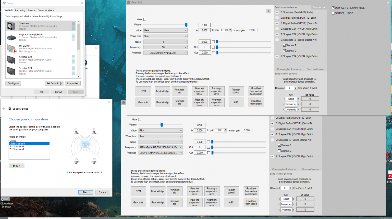

    By the way, has anyone gotten more than two channels from an audio source for transducers? My Sound Blaster X-Fi is configured for Quadraphonic but Mover only see's two channels. Works as four for other vibe software. Not a big deal but it would be nice to have all four bass shakers massaging my...er...ego :D

    Been hidden for some time, sorry.
    There's a bug in the transducer module.
    Found that some audio devices (most) are not showing all the channels.
    I have it solved for the next build.
    But it will take some extra time for release, I had to rebuild most of the code to get rid of some nasty bugs.
    There's going to be many updates, new features and a cleanup of some modules
    • Like Like x 10

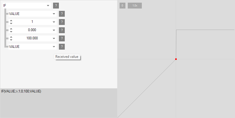

    Ok, will take a look.
    I have something new in the filters for the next release.
    Main reason for the delay...
    Think it's going to be good for this type of systems.
    - Conditional filters (IF ...)
    - We can use any of the source values in the filters by using keys
    Something like IF(LAT_A;>50;0;LAT_A)
    That 1 is > for now, not at release
    VALUE is the value as we have in current version, but we can uses for example LAT_A (lateral acceleration) or any other value in the numeric fields

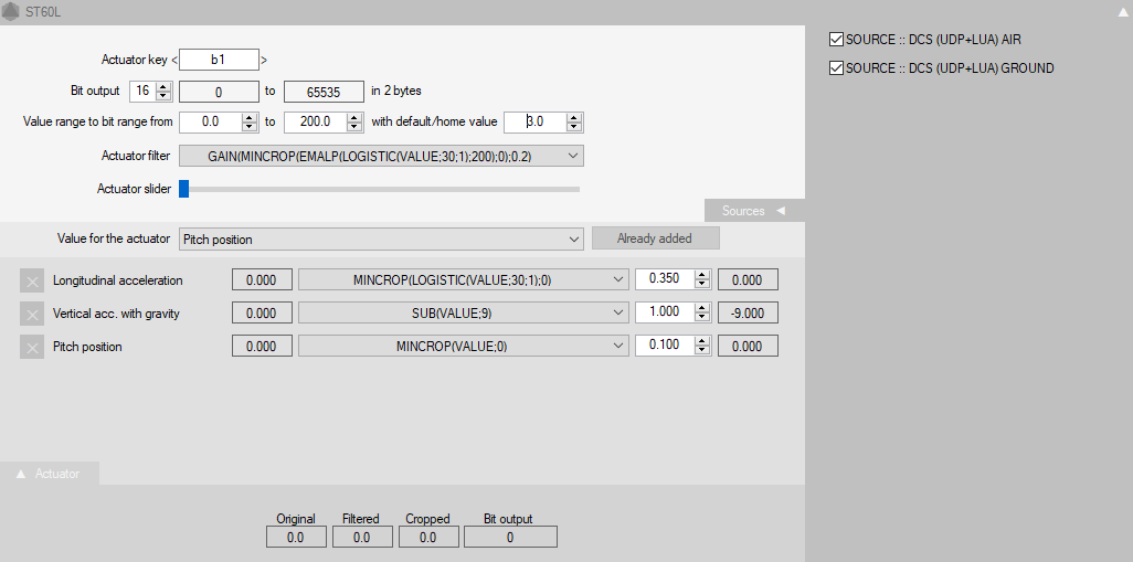

    Is that limited to the same source? Reason I am asking is, I would like to make a filter that only works when ground mode is sensed by the sim, which takes the current speed and uses a direct joystick (=different source) input for gain.
    My goal is not to wait for the simulator to calculate G force, but to initiate a motion cue in a certain situation as close as possible to control input. Steering on the ground in an aircraft or car is almost hard wired to the lateral Gs, and I want an effect without any delay from the sim.

    No it will be for all sources
    Something like:
    S1.LAT_A
    This is for source with key S1
    So if you add a joystick source, you can use the Lateral acceleration for that source.
    You can make things like: ADD(S1.LAT_A;S2.LAT_A)
    The only problem, I'm looking at now, is the use of those keys in filters we have on the sources.
    They are affected by the order the sources are calculated. So the value you get can be from previous calculation loop or already the new one on the current loop. Hope you understand what I mean.
    Those keys can be used in the outputs also.

    That's great! I think for my purposes, uncertainty about the sampling of the input data is not of great influence. I will have on ground braking and steering effects derived from the controls, and in the air I will take the sim calculated data. Since traction loss is not something commonly simulated in flying, I think that will work sufficiently well.
