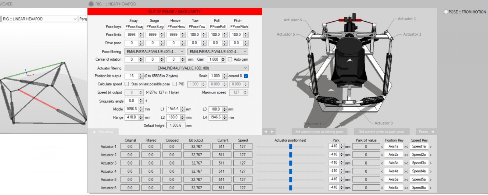

    Hello everyone,
    I'm having this little issue, the 3D view stays stuck when I uncheck the "POSE FROM MOTION" in the "RIG LINEAR HEXAPOD" am I wronging something?
    Thank you

    pmvcdaaka FlyPT I want to ask is it possible somewhere in FLYPT to set the speed of linear actuators if they are put into start position.thx
  4. pmvcda
    pmvcda aka FlyPT
    Nov 3, 2010
    2,253
    Portugal
    15,787Coins
    +2,698 / 17 / -0
    No, but do you mean when going to the start position?
  5. pmvcda
    pmvcda aka FlyPT
    Nov 3, 2010
    2,253
    Portugal
    15,787Coins
    +2,698 / 17 / -0
    Do you have more poses?
    If not I think the rig stays on the last position. I will check for the new release. That's something I noticed some time ago and for the new release I think it's solved.
