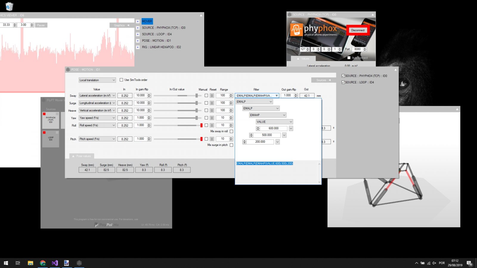

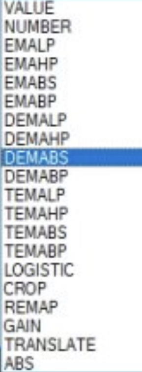

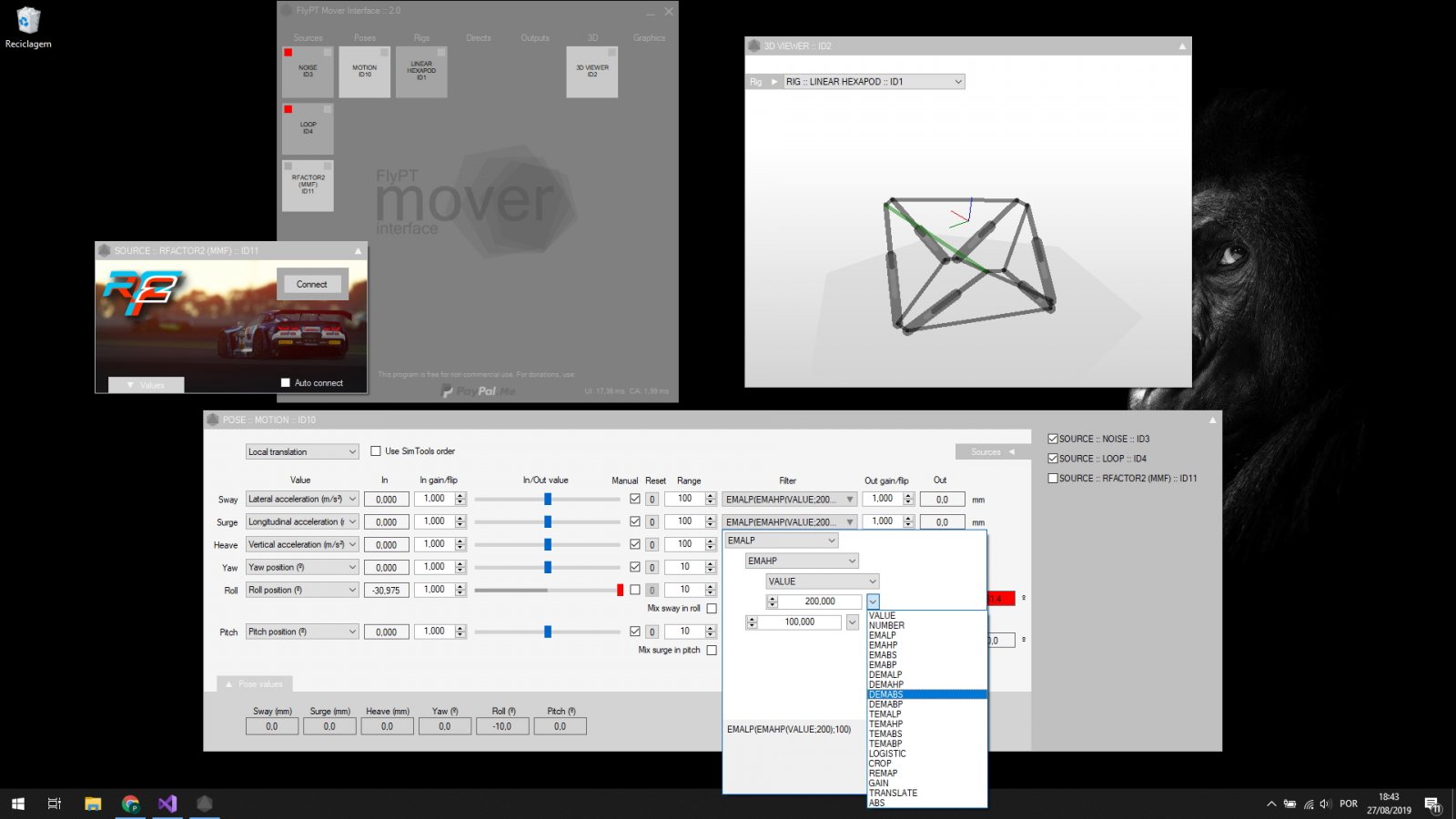

    What you see there is the basic commands.
    Now you can compose it however you want:

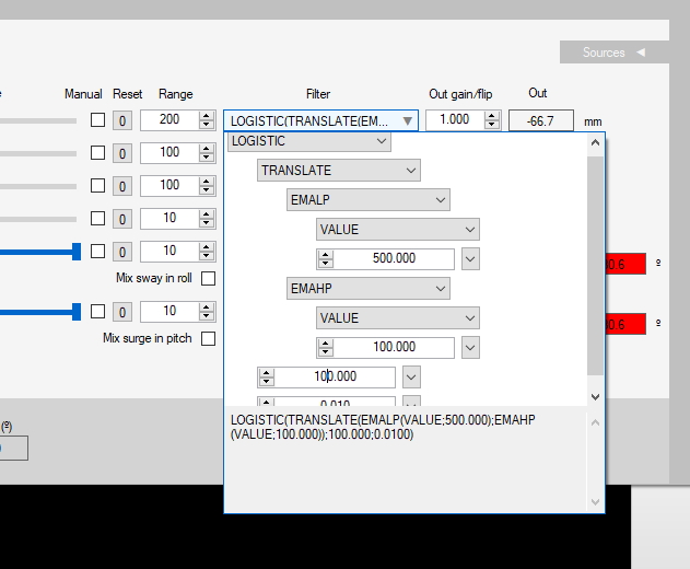

    Here's a 3rd order with the first has a high pass.
    You can now make 7th order if you want to. And you can change the number of samples used in each filter.
    You can even use a number of samples that depend on the value received.
    You can now make the most crazy filter on your mind.
    For example add a low pass and a high pass and in the end make a logistic (see sequence text result on the control):
    That TRANSLATION could be called ADD. Idea is to translate the signal by adding or subtracting a value.
    Like GAIN could be MULTIPLY.
    All the gains and ranges specified on the interface are there just for help and trying to simplify the use of the interface for those that don't want to go deep.
    On the background, what the program does is to add those parameters as filters to the filter you specify in that field, so all the input signal is treated as a filter from start to end.
    So the end filter text will have a CROP to the range and input and output GAIN.
    This is the change that took more time...

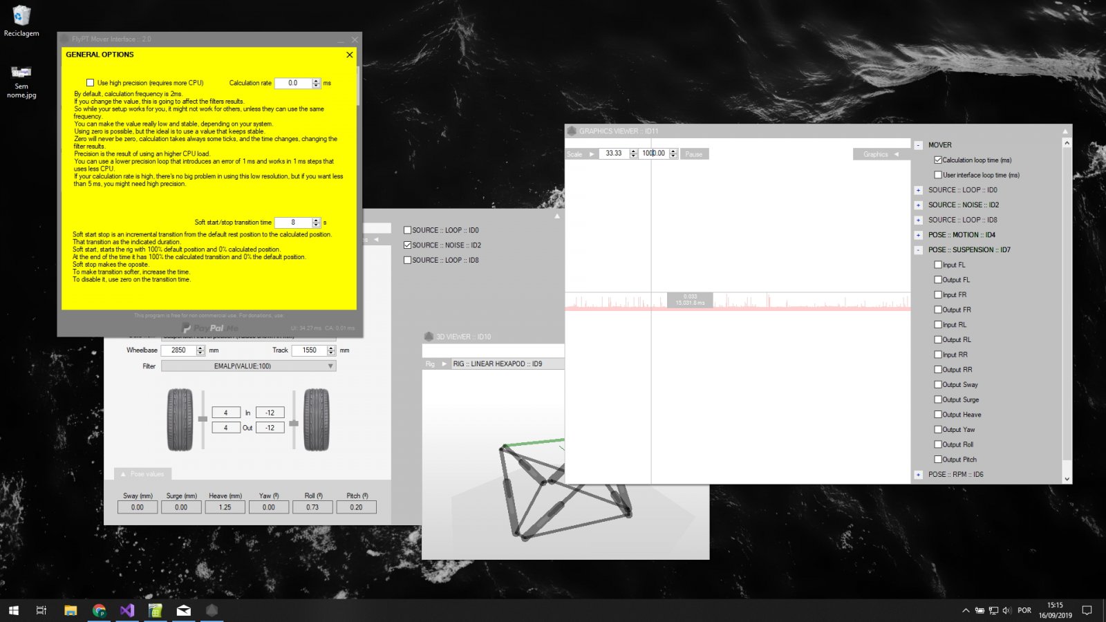

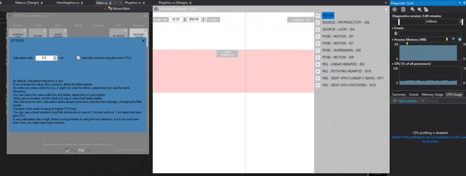

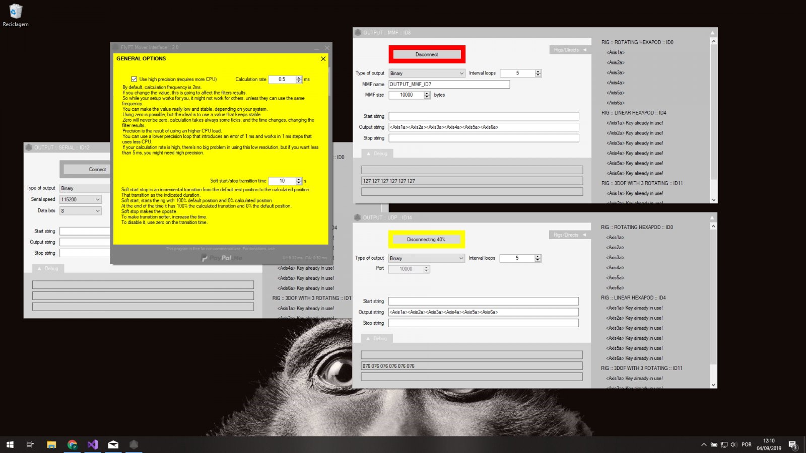

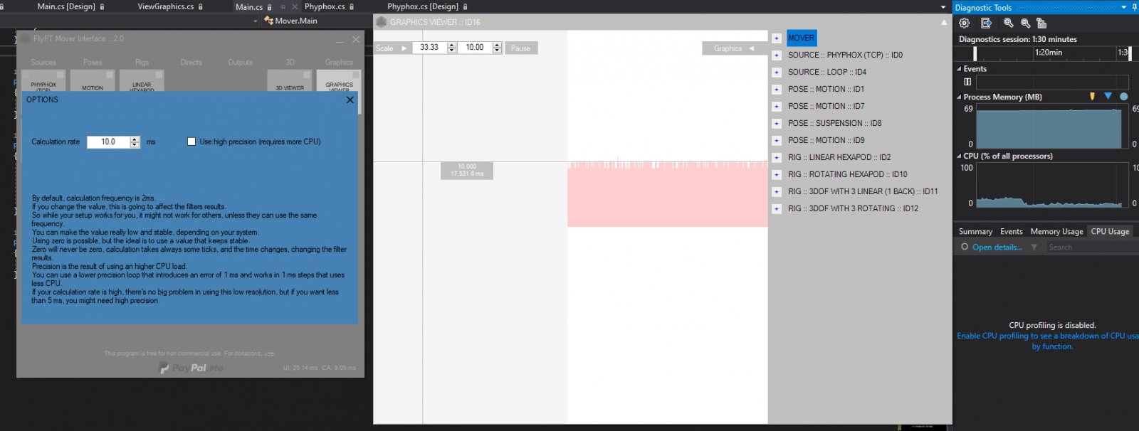

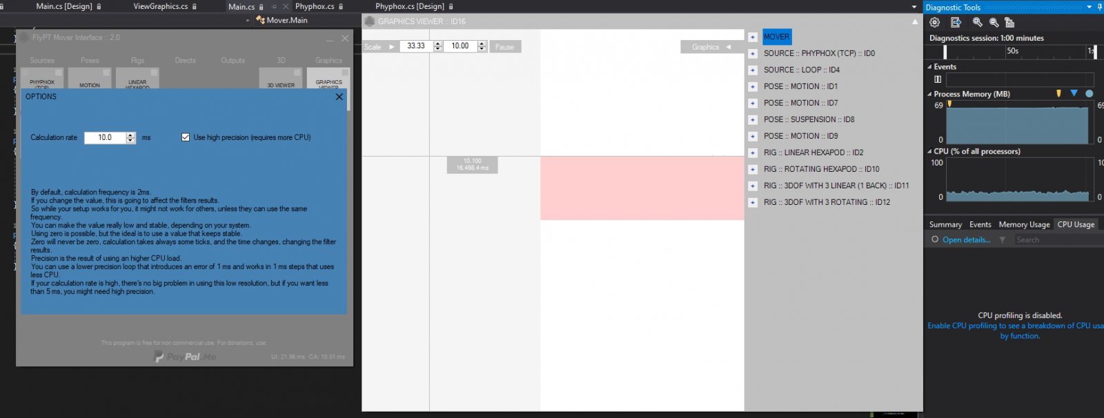

    Calculation loop time/precision.
    In the bellow picture, you can see the CPU usage when using the high precision loop:
    Here, CPU usage in my PC can go up to 20%, but we can achieve a really stable and precise loop time.
    This is important for rigs that use high frequencies of data.
    The graphic shows how stable we get the value (here for a selection of 10.0 ms).
    But if the high CPU usage is a problem, then go with the low resolution:
    CPU goes down to around 5% in this example.
    But precision is on steps of 1 ms and with an error of 1 ms.
    For rigs that receive data at 10 ms interval this is enough.
    High precision timer allows for even lower calculation rates.
    In my system, I can make a complete calculation loop in less than a 0,1 ms, keeping the value stable.
    Bellow an example with 0.8 ms calculation loop (vertical scale increased):
    The graphic here introduces more CPU usage, so while using Mover in a game, and after setting up everything, just hide all windows to get the best performance.
    Varying the loop time, changes the filters behaviour. So sharing data between users, requires that they are able to use the selected setup for loop time in their system.
    More soon...

    Right now there's only two threads, the interface with the user and the calculation.
    In graphics it's possible to see the load of each one in milliseconds per loop. It's easy to reach 100 ms in the interface, but we just want it to have an easy way of setting the calculation thread.
    Right now I'm finalising the soft start/stop and missing some images and touches for new rigs.
    Also need to review some new sources I might add. They are not finalised (Dirt 2.0, Roller coaster ad XPlane) .
    Also some new outputs to memory mapped file and UDP:
    Just some more days.

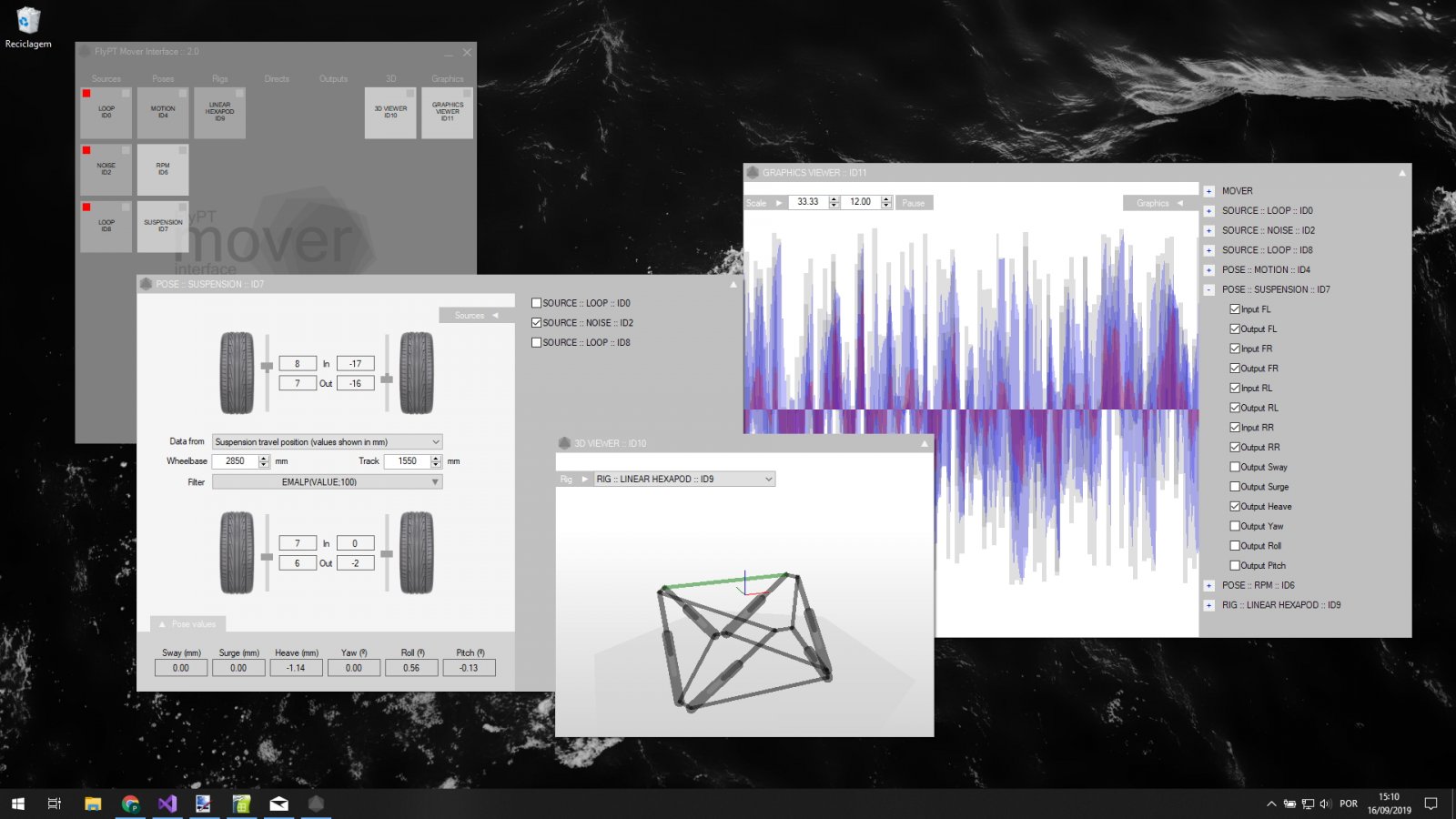

    Here's a screenshot:
    I'm working on the program right now.
    I was testing graphics on the suspension module.

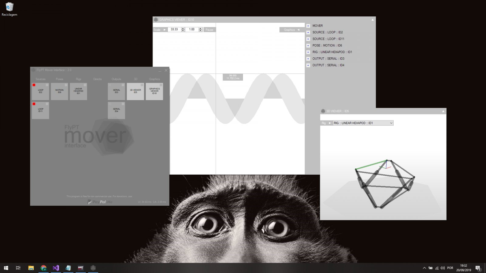

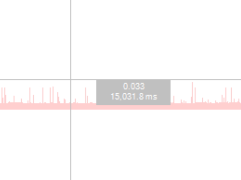

    Running on the laptop:
    Look at the cursor on the graphics.
    Pointing at the peaks on calculation loop. It's 0.033 milliseconds.
    So right now I'm happy with the results.

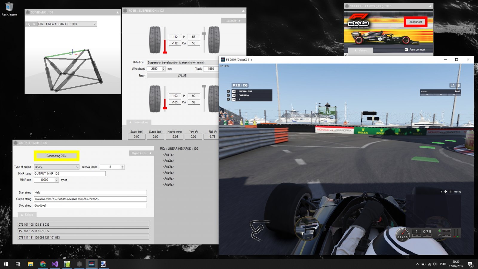

    Some tuning on the soft start stop:
    Also testing some of the new sources.
    Need to go through all to make directions all the same.
    Anyone knows the units used by F1 2019 / Codemasters games on the suspension travel/speed/acceleration?
    They seem strange...

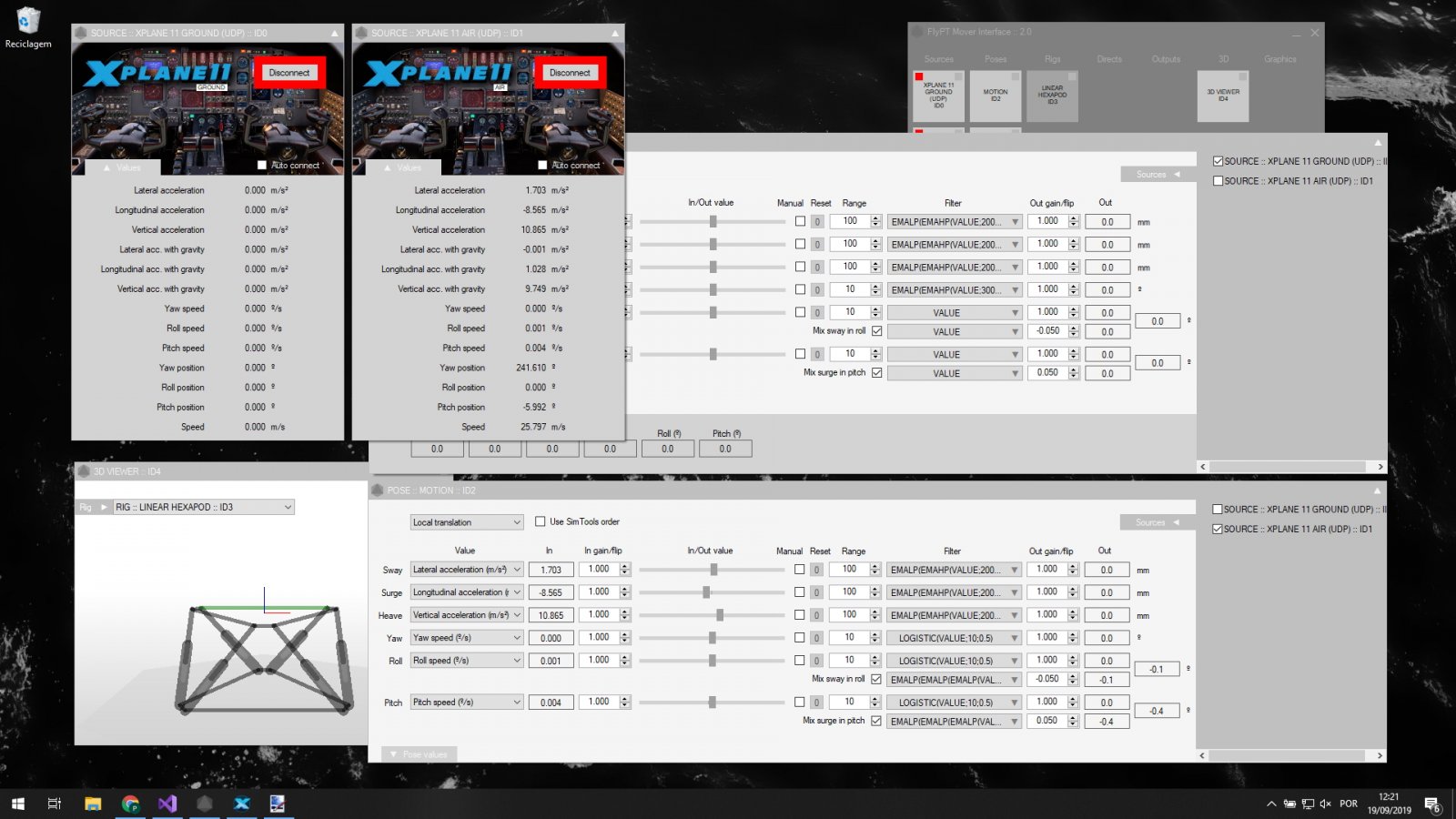

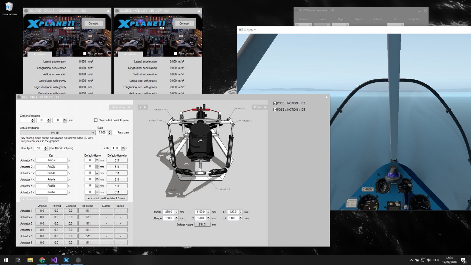

    XPlane will come with two sources (like DCS):
    One when grounded and another one when in the air.
    Why?
    You receive data only in one, then generate different poses with different filters for each one (with your preferences).
    In the rig definition we add both poses and the rig uses them sum of the two.
    That way, you can define different filters for ground or air.
    New version tomorrow!

    -New advanced filtering system.
    Allows the definition of complex filters with different values for all of them.
    That's the cause of the above alert. Be careful.

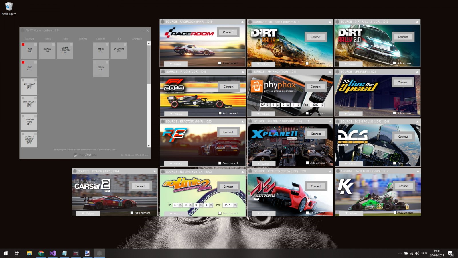

    Sources
    -Now we have 3 new values. They are the linear accelerations with gravity.
    So no more option to use gravity.
    -New sources:
    -Directions are not the same for all sources. Please report the ones that are different.

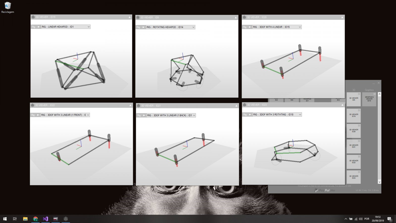

    Rigs
    -Added more 3DOF rigs.
    Now with 3 linear actuators and 3 rotating actuators.
    -New images with the actuators positions.

    3D Viewers
    -Enhanced visual representation of linear actuators.
    -Disabled thin lines that showed the calculated position/last possible position.
    Now actuators just turn red.
    -Representation for new rigs

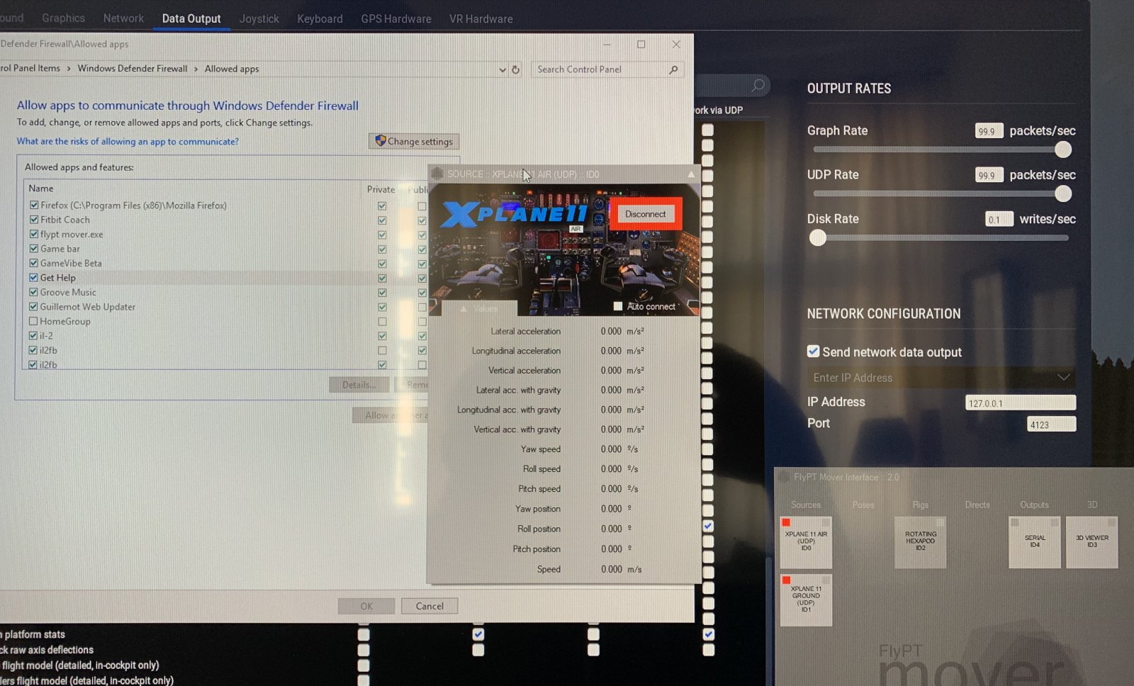

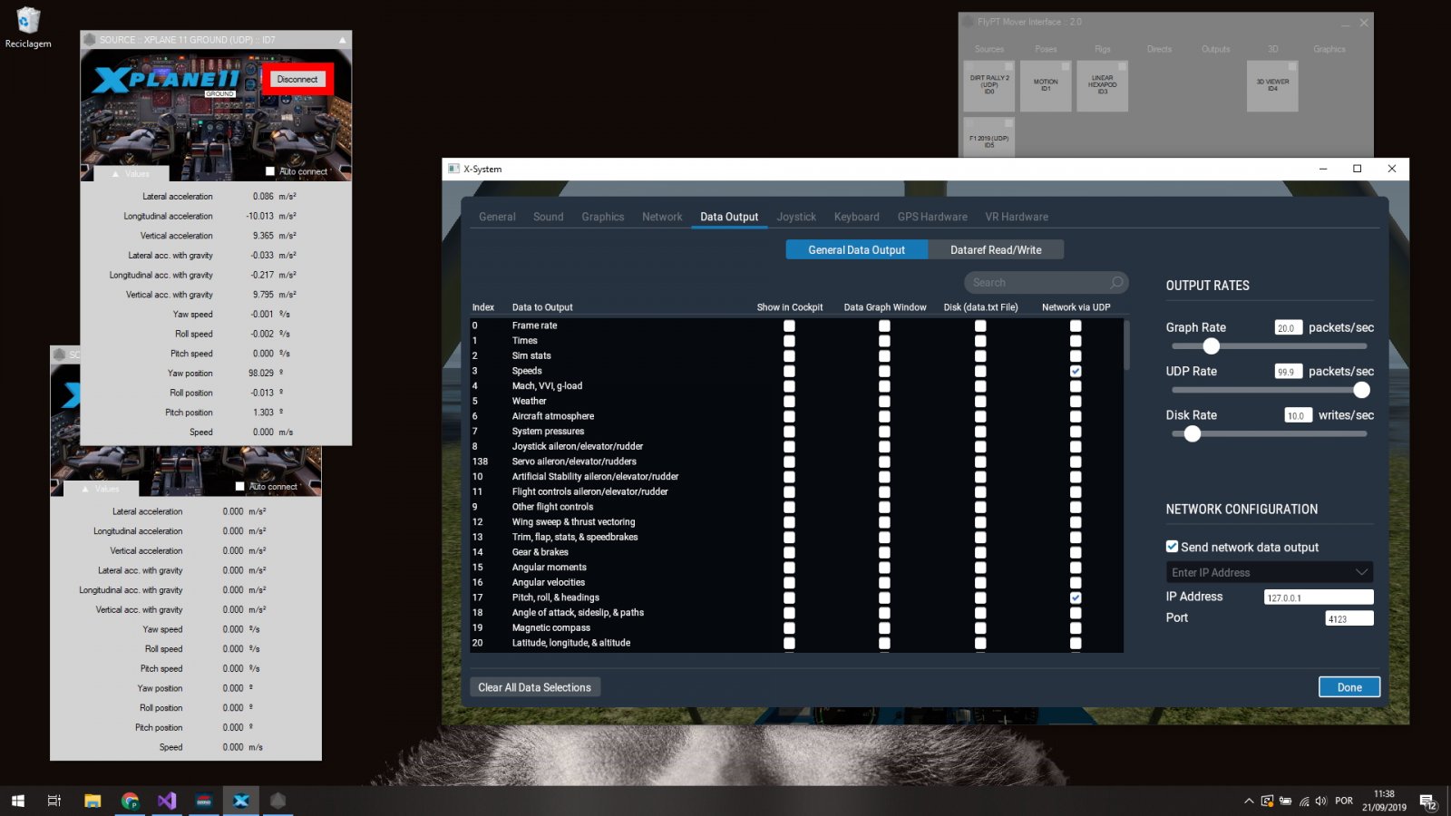

    Not getting values from xplane
    Is your port 4123 ?
  16. pmvcda
    pmvcda aka FlyPT
    Nov 3, 2010
    2,296
    Portugal
    16,036Coins
    +2,746 / 18 / -0
    Yes. Do you use 127.0.0.1 in the IP?
    This is my settings in XPlane:
    Checked network via UDP in:
    #3 Speeds
    #17 Pitch, roll and headings
    #37 Engine rpm

    You need to check those, specially gear forces to get data.
    I have to make a guide for each source.

    First Thanks for your fantastic job !
    For assetto corsa you have for plugin input UDP communication ( I’m noob for this ) . In your other sw you use MMF plugin ? In fact I don’t really know how to setup this . I used your direct plugin with UDP and it doesn’t work or could you tell me how to setup ?
    Thx
  18. pmvcda
    pmvcda aka FlyPT
    Nov 3, 2010
    2,296
    Portugal
    16,036Coins
    +2,746 / 18 / -0
    Ouch!
    I was working on the UDP version. And I activated the wrong one...
    MMF is there, but hidden :oops:
    UDP is not working yet. I will post a new version with this corrected.
    Give me some minutes.
    UDP is a network protocol. The advantage is that with UDP you can run the game in a remote PC and send data through network to the PC with FlyPT Mover.
    MMF is like a file but in memory. The game updates that file with the data and we read the data from there. It works only in the same PC, but it's the fastest one when we are on the same machine (game and Mover).
    If we are using a console, then we need UDP. But I don't know if any of the sources I have is compatible with data output from consoles...

    Should I see the values moving with this config ?
  20. hexpod
    hexpod http://heXpod.xyz
    Apr 18, 2016
    1,228
    berlin
    7,900Coins
    +381 / 5 / -0
    DC motor, 6DOF
    Aha I got some if I check Nr. 17
    Is it normal that if you don’t check the 17 there is nothing going in ?
