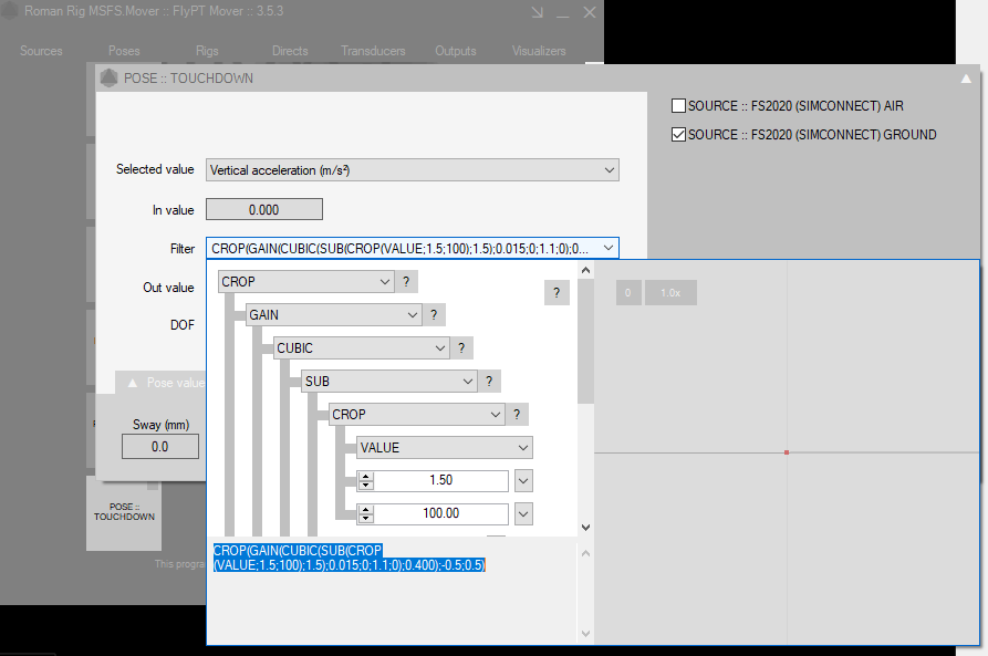

    I used more than your file. Your whole story and all the work that you shared inspired me to even tempt building my own motion rig. Couldn’t have done it without your help. To answer your question, I’m still not sure what specifically causes the touchdown motion. I simply added another pose by duplicating yours then unselected all air motion and selected ground. The first flight after making that change has the touchdown motion. I’ve had to go back to the original file a couple of times because the touchdown motion would disappear for no obvious reason. I’ll send a couple screenshots later today so maybe you can figure it out.

    I'm happy to inspire someone, thanks for sharing!
    As for the touchdown I did some research and figured it out, it works great. The secret is to use "vertical acceleration" but only for the Ground source and only negative values. And to have a short air to ground transition (set up at the source).
    Basically, the only way to have a significant negative vertical acceleration on the ground is the moment you touch down. Small ones have to be filtered out. A little bit of experimentation and here's what works for me:
    The acceleration is sudden and can be large, so CROP makes sure it doesn't exceed a certain value I feel comfortable with (that doesn't break my rig or my back). It's a safety limiter, basically, so start small and see what feels good. If you know your system limits, make a guess what fraction of the movement you want to reserve for the touchdown motion. Remember that if you crash, you will get a massive spike for vertical acceleration, that needs to be limited. GAIN tailors the spike to my rig, adjust to taste according to what your rig can do. I have a 2DOF so I routed it to pitch axis, and it feels great! Any normal landing I feel the touchdown quite naturally. If I really do a great feather-light landing, I don't feel it. If the landing is rough it's quite a shake. Really adds realism.

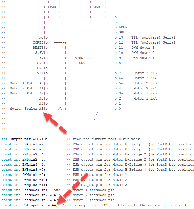

    In one of your videos you show a Pot with which you imply you can tune the sensitivity or movement range of the rig.!, If so how did you manage this, it would be a great way to change on the fly as it were.

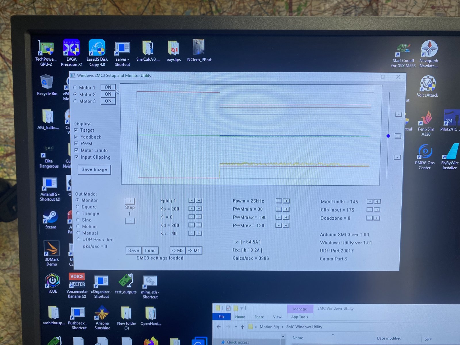

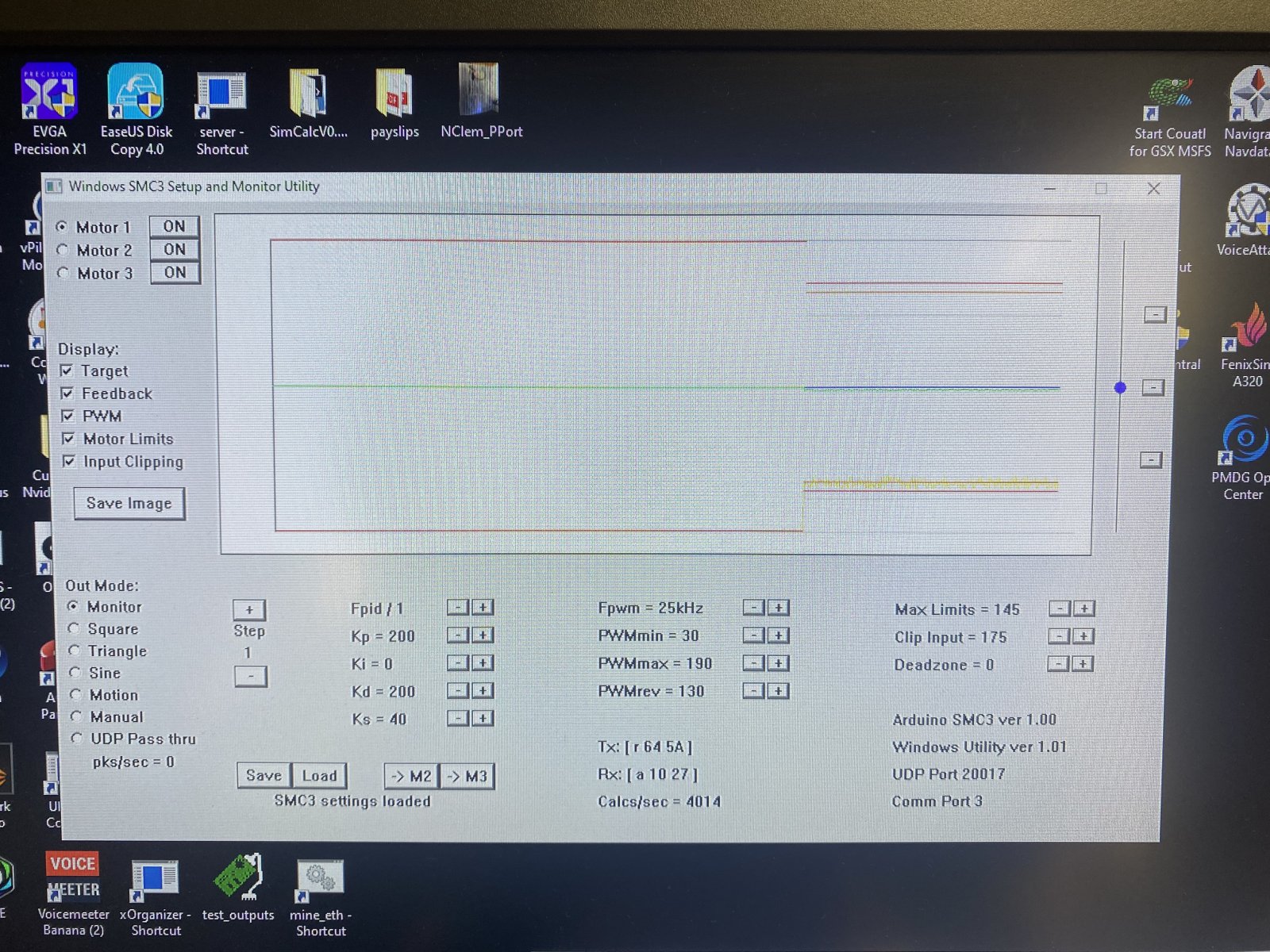

    It's a hidden feature in SMC3 Tools. The Arduino sketch notes the A5 pin as "motion scaler", so that's what I did. Just wire the pot there. Refer to SMC3 Tools topic. I changed it to A4 though, but it doesn't matter.

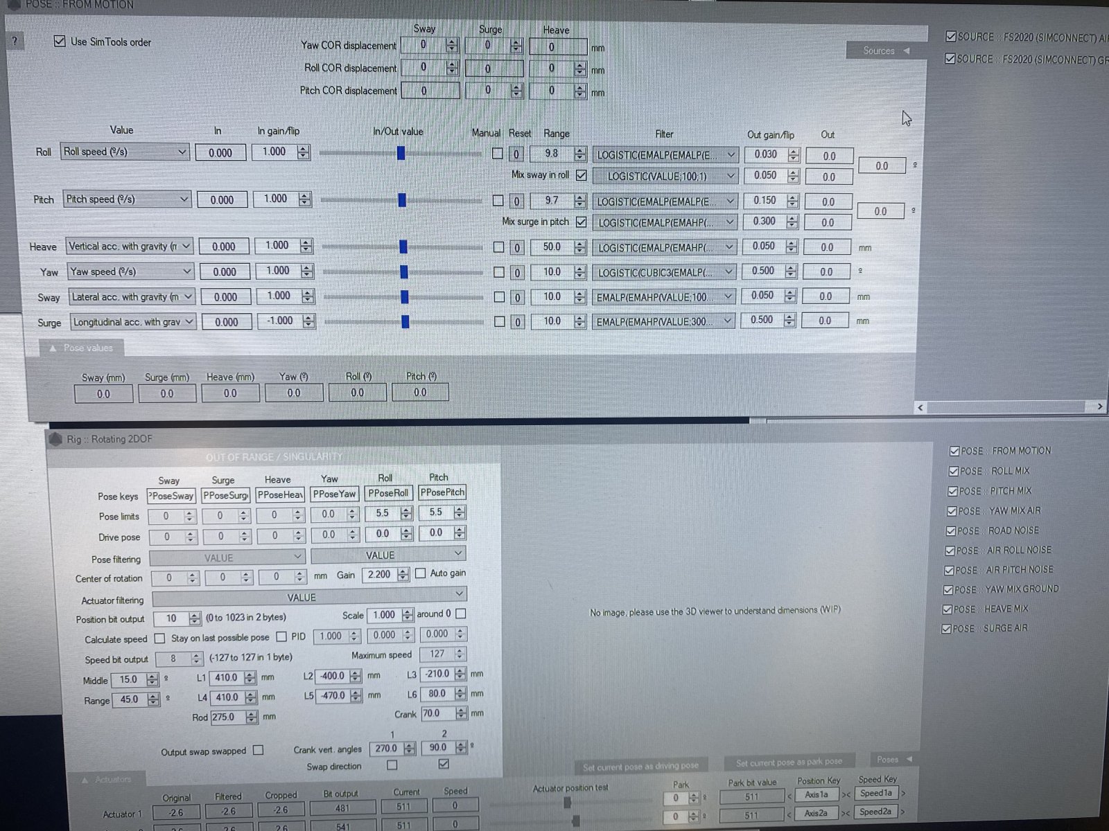

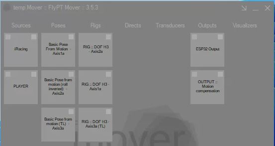

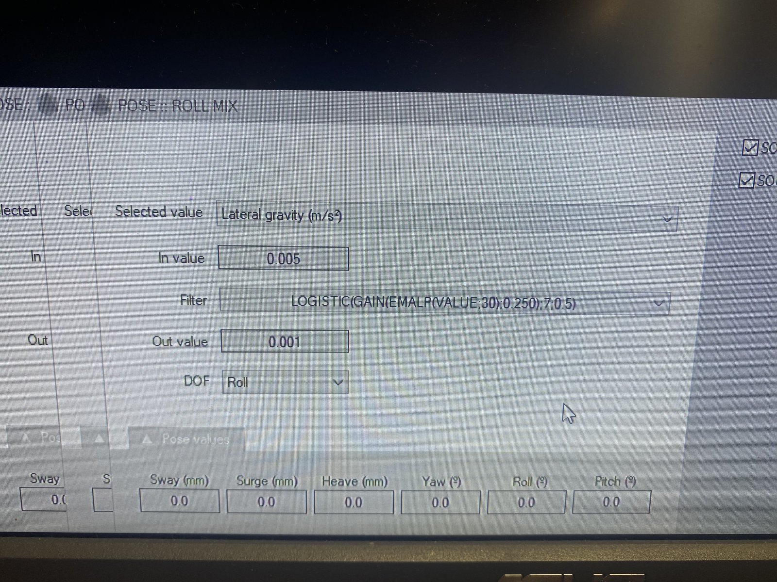

    Im having issues with trying to get my Pitch and roll axis working correctly. My problem is it is inverted!!. How do I reverse the pitch and roll movement so when I pull or turn in the cessna the rig follows.
    Also why are all Sway Surge Heave Yaw all in Red!!!!
    Any help would be much appreciated.
  14. Nick Clements
    Nick Clements Member
    Jan 7, 2019
    44
    95Coins
    2DOF, 3DOF, DC motor, SCN5, Arduino, Motion platform
    OK I`ve managed to sort out the inverted axis movement in pitch on my Rig. I changed the Gain to a negative -2.2 value, and all movements now in correct direction. Roll is still inverted???
    Still have the red boxes on sway surge heave and Yaw!!!
    OK. So now that Pitch axis is OK Roll is still inverted. Strange thing is if I look at 3d Viewer it all works correctly however the actual physical rig roll is inverted ????
    Any ideas?? The measurements are correct and the motors are orientated the same as my rig..
    Now if I swap orientation of these motors I can change Gain back to posative value and pitch works fine but roll is still reversed. And again the 3d Visualizer shows all is good!!!!But the rig is reversed on roll axis!!!!
    Totally puzzelled!!!
  15. John Snell
    John Snell Member
    May 31, 2021
    63
    192Coins
    +60 / 1 / -0
    Hi Nick.
    I have the same issues as you, so I am hoping someone else can help us both out.
    I've tried both a "DOF H3" rig and also tried a “2 DOF with rotating actuators”, but in both cases either pitch or roll is incorrect with no way to resolve that I could find.
    I am definitely no expert, but in case it helps...
    I now use three “1 DOF with single rotating actuators” rigs (or three "DOF H3" rigs), each fed from a different “Basic Pose from motion”, one of which has “Roll” and "Sway on Roll” inverted. This allows me to get the actuator rotation correct but makes things like motion compensation very difficult. I may have to try to reverse motor direction in the firmware instead.
    So any other suggestions would be welcomed by me as well. Is there a better way anyone please?

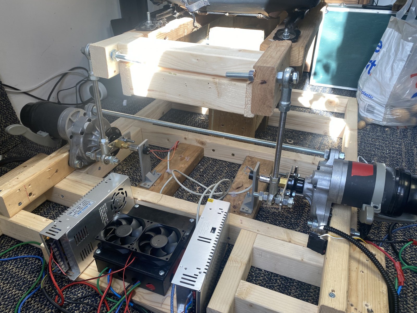

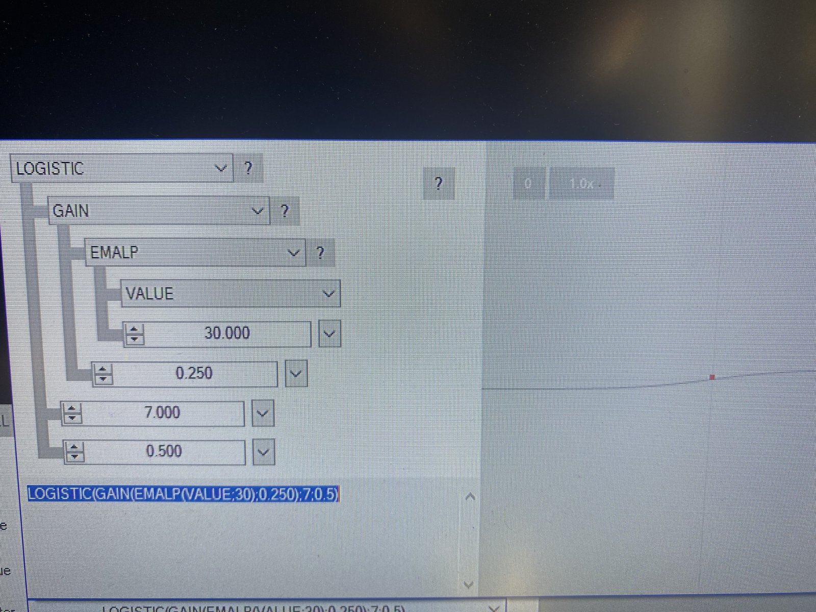

  16. Nick Clements
    Jan 7, 2019
    44
    95Coins

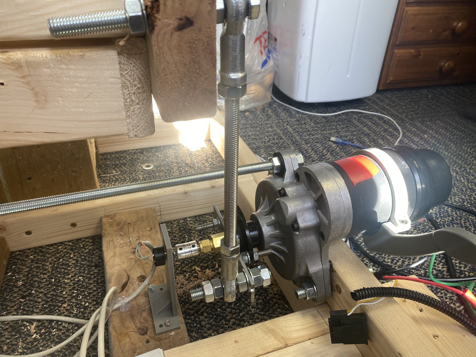

    While I’m trying to sort out the roll axis issue here are a couple of pictures of my setup. It has been built based on the design by Roman/Roman. The only difference is the motors are facing the opposite way to his..
  17. Nick Clements
    Jan 7, 2019
    44
    95Coins

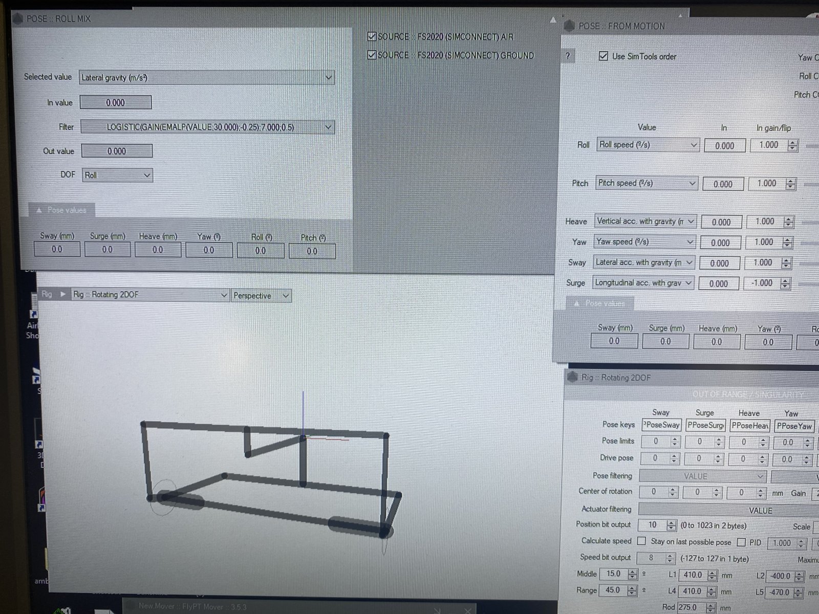

    Finally Roll axis now works correctly. I have switched the roll rotation from changing the gain value in the POSE: ROLL MIX from -0.250 to 0.250 .
