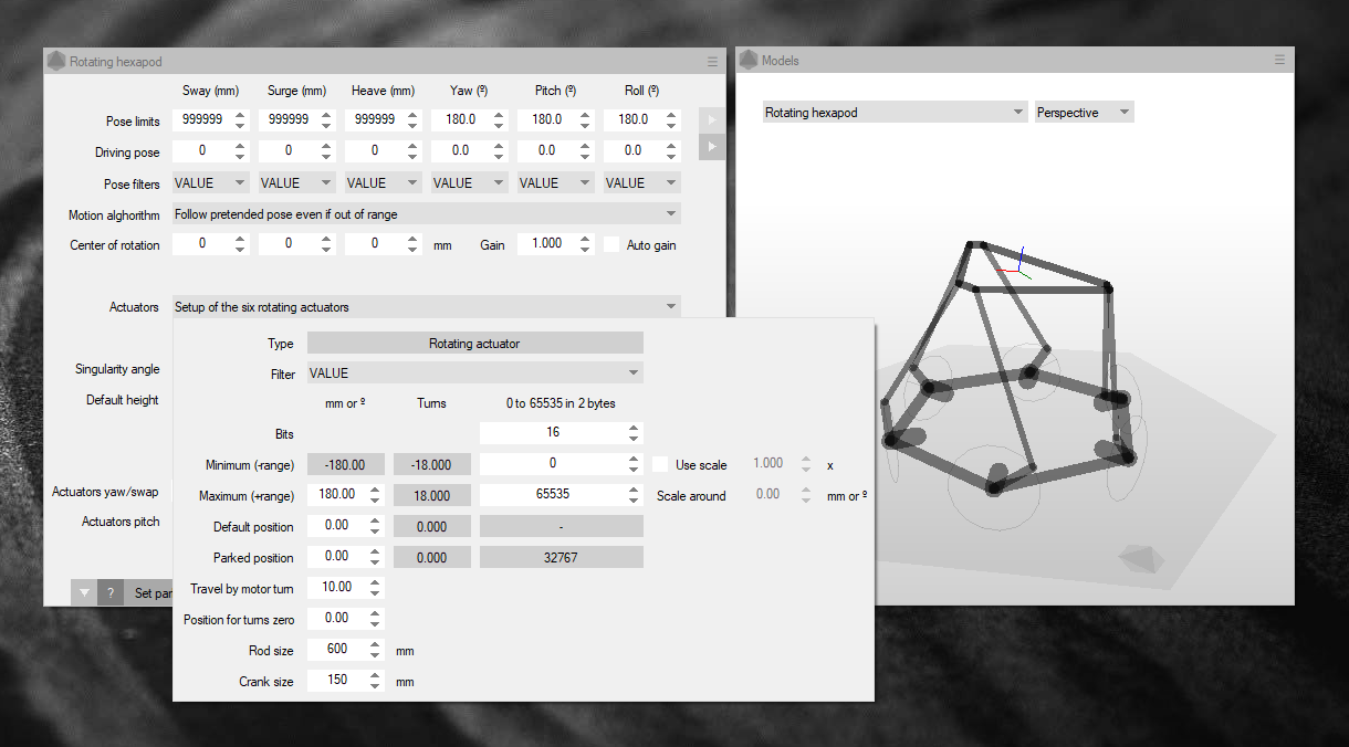

    Just to note that I did not disapear again.
    Just strugling with some work on the actuators:
    Trying to add a setup window for actuators...

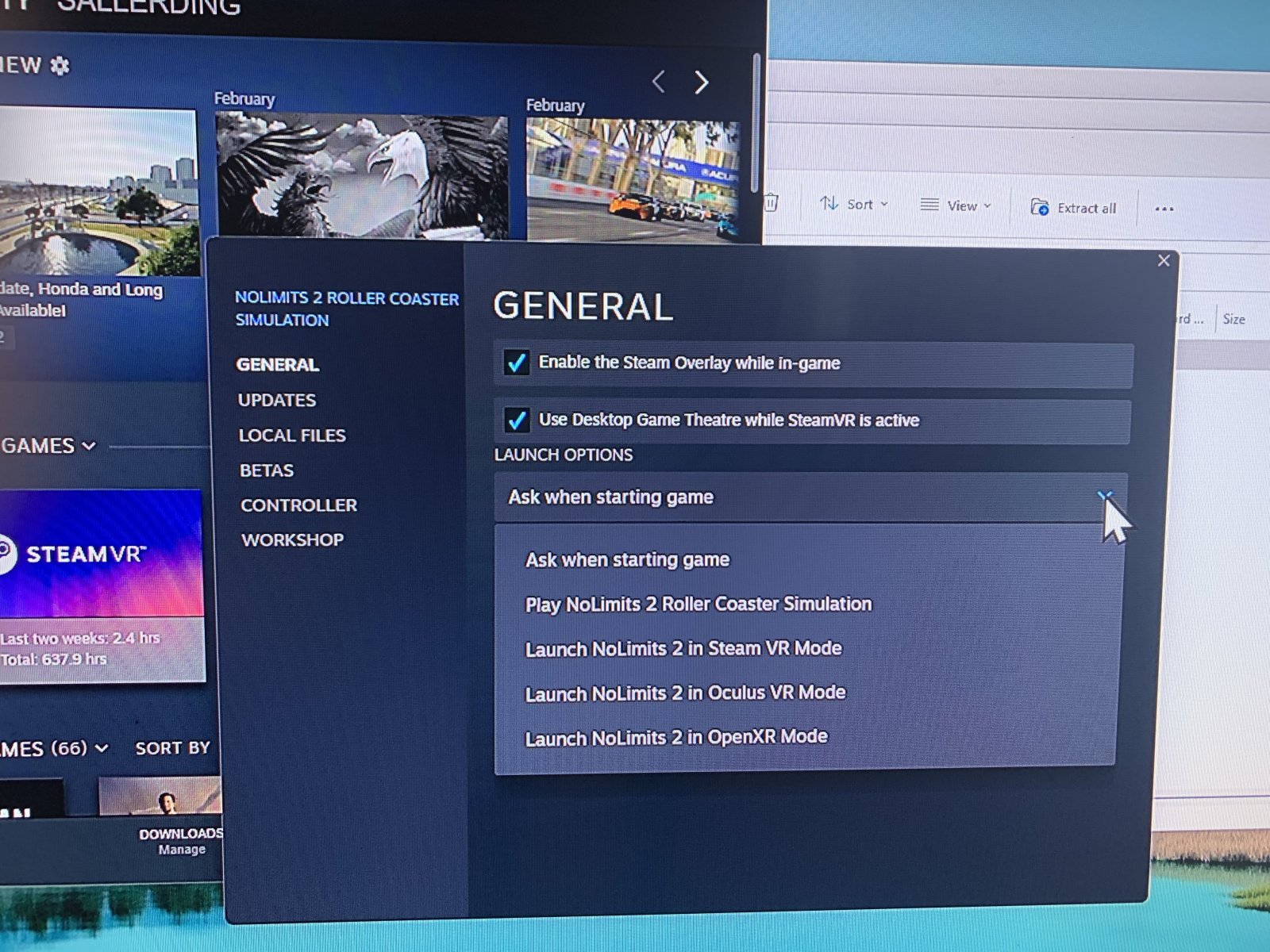

    I am trying to play nolimits2 and the select all sources times out and disconnects after just a few seconds. This does not give me any time to boot the roller coaster. The quick timeout does not allow mover to work. Anyone have a solution?

    Can you boot the roller coaster first at the station, pause it, then connect?

    no that is the problem. When I boot the rollercoaster it automatically goes into a full screen vr mode and locks the keyboard so mover can no longer get any keyboard commands.. Otherwise the ALT-O command would do it.. Crazy.

    I’ll have a look when I’m back home tomorrow. Can you start in non vr? Mine asks me at the start whether I want to go to vr or desktop mode. If so do you think that would make tbe difference for you.

    Ok so with steam, before you start no limits 2, you can amend the launch options by right clicking the no limits icon in the steam library and selecting “properties “. In Properties under “general “ there is a launch option when starting game to select desktop or vr. Perhaps if you revert to desktop startup, set and connect flypt, then you might be successful returning to vr once the sim has commenced and you are already connected.
