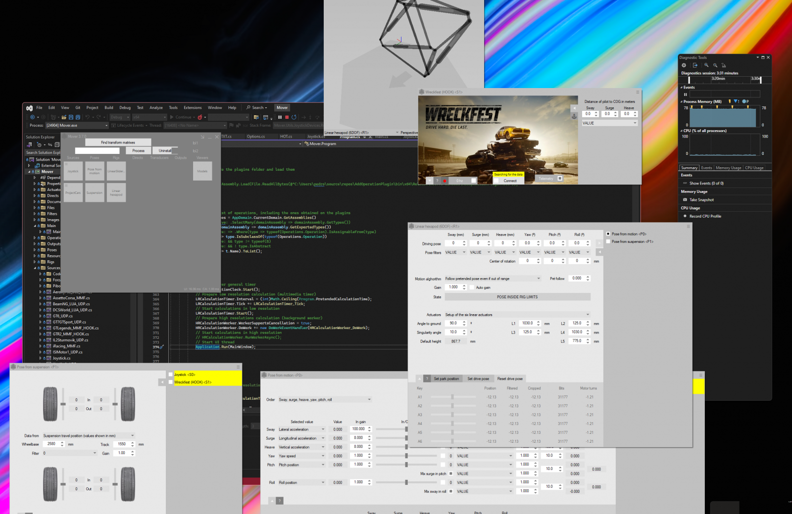

  10. Avee
    Avee Virtual Pilot
    Jul 5, 2020
    149
    1,167Coins
    +43 / 1 / -0
    Thank you for your continued development.
    What I currently miss is a speed limiting function for poses. Mover works by adding up pose commands, but there is no possibility to limit speeds for individual pose effects (other than dampening with filters, but this is not absolute).
    What I was thinking of is a MAXMOVEMENT(Value; StepLimit) filter. This would limit the commanded pose to be within a circumference around last commanded rig pose.
    So say I am at -1 pitch, I woiuld like the platform to move to +5 pitch, but in such a way that the rotation is not discernable to the VR user. So I limit the movement with the fiter MAXMOVEMENT(Value; 0.002). So with a standard loop time of 2ms, it would move by one degree per second.
    Internally, the filter would act like a CROP(Value-RigPosition; -1*StepLimit; StepLimit)
    In my example, this would give MAXMOVEMENT(5; 0.002) == CROP(5-(-1); -1*0.002; 0.002) == -0.98
    I would use this filter for motion queing, where it would take care of both the mixing in of sway in roll and surge in pitch, and also all the washouts. These are all things which should not be discernable to the user. By making the platform constantly, slowly "chase" surge and sway by rotations, I could simply give cues without adding wash out, because the washout is always provided by the platform chasing the surge and sway rotation. a 6dof would also have pose filters to slowly move all other dimensions to 0.
    Edit: it would maybe be easier to have discrete commands for all dimensions, that would remove the complexity in determining the difference between the commanded dimension and the rig pose. Those discrete commands could simply reference a single dimension of the platform instead of calculating a "bubble".
    Alternatively, this could also be implemented as a "pose from motion with speed limit". Where one would add targets for all dimensions as a normal pose, but Mover would execute them within the confines around the current position, specified in degrees/s or mm/s.

  12. pmvcda
    pmvcda aka FlyPT
    Nov 3, 2010
    2,290
    Portugal
    16,010Coins
    +2,744 / 18 / -0

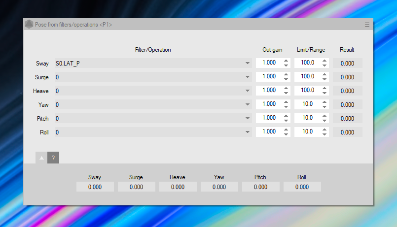

    I will add MAXMOVEMENT or something like MAXVARIATION to make it for all values, not just movement.
    There's another feature I did not talk, I'm adding plugins, and for now only the filter/operations is working.
    Can't show much, but it's in the menu and some of the filters in the lists are plugins for testing:
    Ignore the main window, it's WIP, and the menu needs cleanup
    By the way, we can now assign keys to modules:
    And reach the values of the modules in any filter/operation control or use them in the outputs.
    Something like:
    The module in the example is a new pose, generated just with filters/operations:

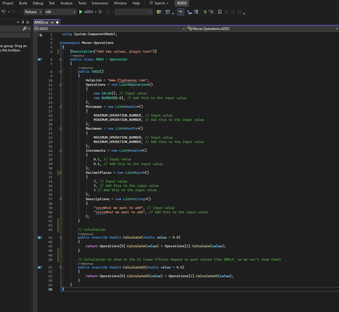

    An example of an ADD plugin code:
    (There's a bug there with to many decimal places, but the code is similar to this)

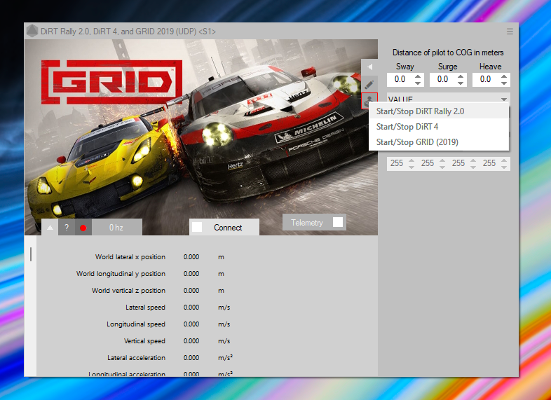

    Another feature:
    When possible, sources allow you to patch/unpatch the associated game and start/stop the associated game
    In the images the source is for 3 games, so we can select the one we want (images are rotating)
    The info about the game is searched in the registry to make it easier.
    Another feature is that we can now store a default setup in the registry, that opens with Mover.
    That way you can define the rig and outputs for the hardware you have and it's always present at startup for empty projects.

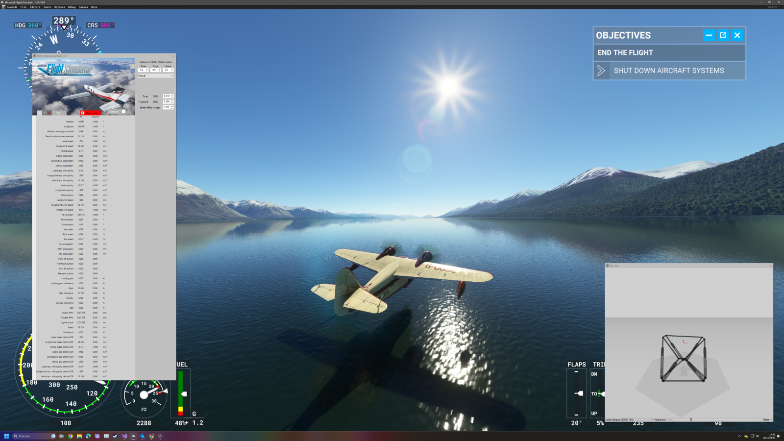

    Just ended a full review on MSFS...
    Any special requests for extra vars?
    • Friendly Friendly x 2
  18. PeterW
    PeterW alias Wickie
    Oct 21, 2018
    230
    Dipl. Ing. Mb (FH)
    1,768Coins
    +428 / 3 / -0
    Please, please add spoiler flaps ! Thanks a lot!!
  19. pmvcda
    pmvcda aka FlyPT
    Nov 3, 2010
    2,290
    Portugal
    16,010Coins
    +2,744 / 18 / -0
    OK, added SPOILERS LEFT POSITION and SPOILERS RIGHT POSITION vars.
    Was also thinking on those that want to make ffb joysticks and helicopter (cyclic and collective) controls, wich vars could be needed?
    Anyone?
    Vars are here: https://docs.flightsimulator.com/html/Programming_Tools/SimVars/Helicopter_Variables.htm
    and here: https://docs.flightsimulator.com/html/Programming_Tools/SimVars/Helicopter_Variables.htm
