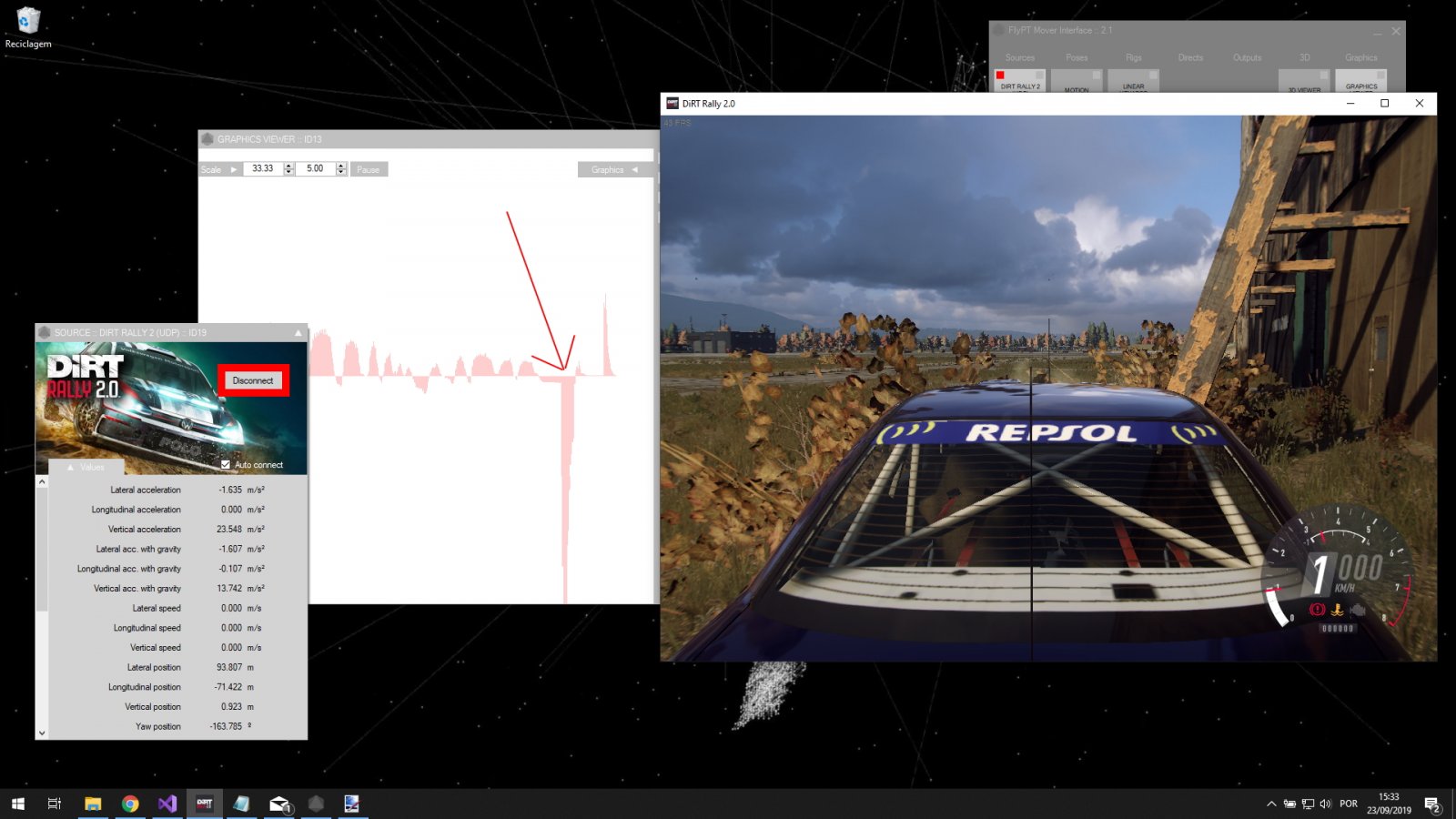

    OK, I was making some corrections in Dirt Rally 2...
    Can't understand the data they sent out.

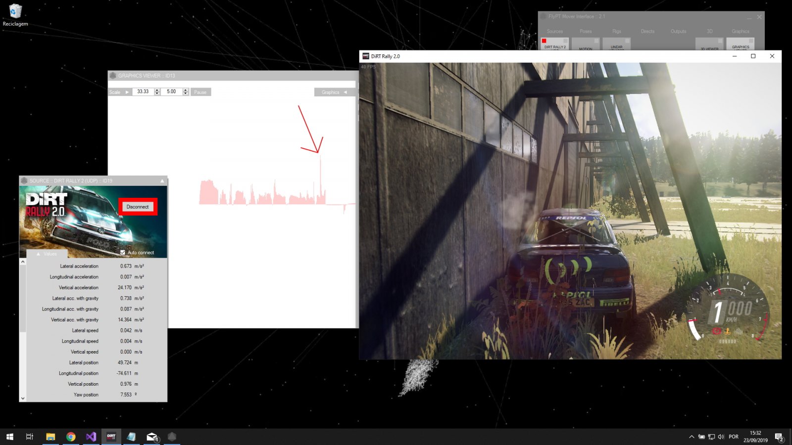

    Below image is the longitudinal acceleration they output from the game.
    Arrow points the instant I collided with the building (the car is perpendicular, but it was a front collision):
    That's strange, acceleration is positive, just like accelerations before (oscillations where due to gear change).
    If I calculate the longitudinal acceleration from elapsed time and velocities, I get this:
    .... Can't understand.
    Am I missing something here.
    The calculated one seems logical.
    What are they giving on the longitudinal and lateral accelerations?
    Is that helmet accelerations? I think so, that's the only logic to have acceleration that way.
    Or they messed the calculations... I doubt.
    Next release will come only with calculated accelerations (I have to make it to get the vertical ones).
    I had to correct some directions.
    I see people talking of problems on the SimTools plugin. Might have to do with time calculation.
    On crash, it seems they reset the timer, so we have to check for currentTime<>previousTime instead of currentTime>previousTime.
    If the counter resets, it's going to lock calculations of accelerations...

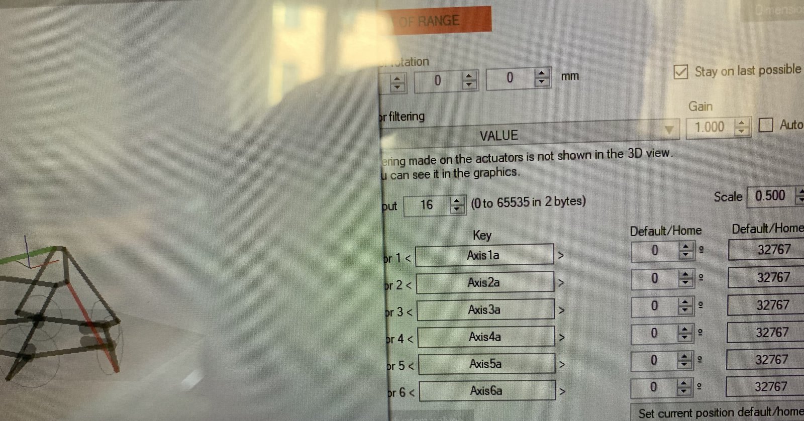

    DC motor, 6DOF
    Although checkbox “stay on last possible pose” is check, after hitting a limit on one actuator, the other actuators are still able to move.
    Is it normal ?

    No...
    Missed something there.
    I will take a look.

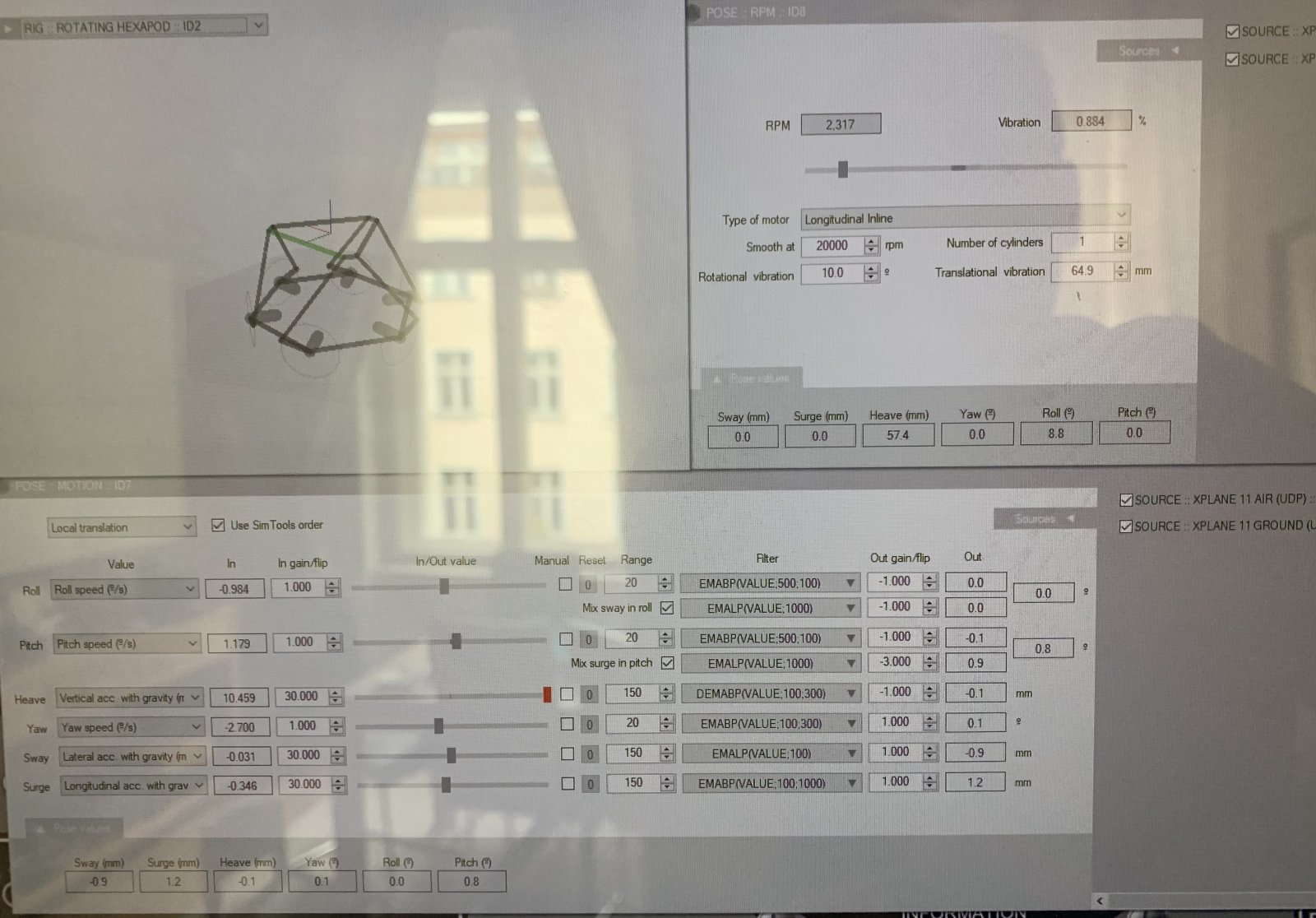

    Curiously, I can’t get the vibrations on the platform.
    I see them functioning but changing values even to the extreme ones doesn’t make them go through.
    Am I missing something?

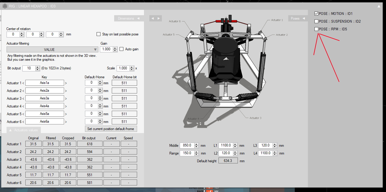

    In rig module, you have to select wich poses you want to use.
    Are you sure you checked Pose from rpm/motor?

    Excellent, it works!
    We could maybe imagine similar window for stall with setable start and end frequency;-)

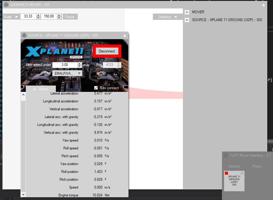

    I can’t see the images about the spike removal in the post.
    Btw. You could maybe output the motor torque as is for testing and vertical gear load divided by actual weight
    For ground:
    Landing gear weight is case 137 data 0 —- division—-
    Current weight is case 63 data 4
    For air:
    Warning stall for rumble is case 127 data 6
    For ground and air:
    Engine torque is case 36 data 0

    Torque is already included:
    See last value...
