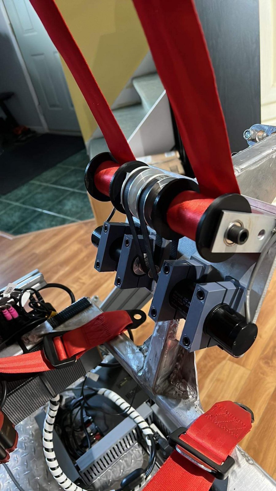

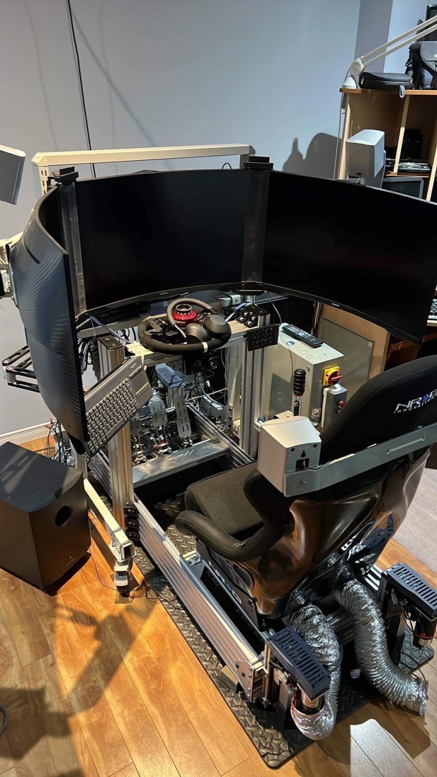

    DC motor, 6DOF
    @pmvcda
    Hi Pedro, Health comes before the new project, relax and take care of yourself because we want you in health in 2024.
    I have just finished a new 4DOF project (racing car for 3 screens) with esp32 and 4 motor on 500ppr encoder and with the same original program as for 6 DOF.
    I added two DC 24v motors for the seat belt and this without an encoder but rather with the direct option (brake) this gives very good results with asseto corsa game but against the brake data its at 1,000 as if I braked when the car is already stopped . Is it possible to add filters: the function (and).Exemple : Only if I have brake at 1.000 AND zero data 0.000 a longitudinal speed = brake 0.000 m/s, this way I could put my seat belt and start the game without being held in my seat before my departure .
    Happy Holiday and new year ( take care of you).:cheers

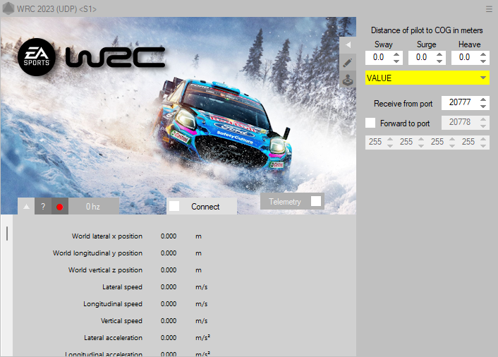

    ah great, glad to see you back in good shape, it would also be especially for the implementation of wrc 23 with flypt
  8. pmvcda
    pmvcda aka FlyPT
    Nov 3, 2010
    2,290
    Portugal
    16,010Coins
    +2,744 / 18 / -0
    Already in:
    • Friendly Friendly x 2

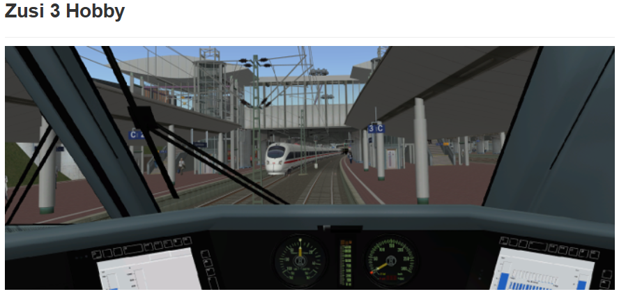

    Hi pmvcda, is it possible to integrate support for the ZUSI 3 train simulator in the new version? It is a very realistic train simulator that sends the data of the acceleration values via a TCP server. The protocol is very well described. It would be the first train simulator that is supported in your program and I would be very happy about it. You can find the programm on the page www.zusi.de.
    greeting Alex
  13. pmvcda
    pmvcda aka FlyPT
    Nov 3, 2010
    2,290
    Portugal
    16,010Coins
    +2,744 / 18 / -0
    OK, that's easy to add if they have the protocol. 30min

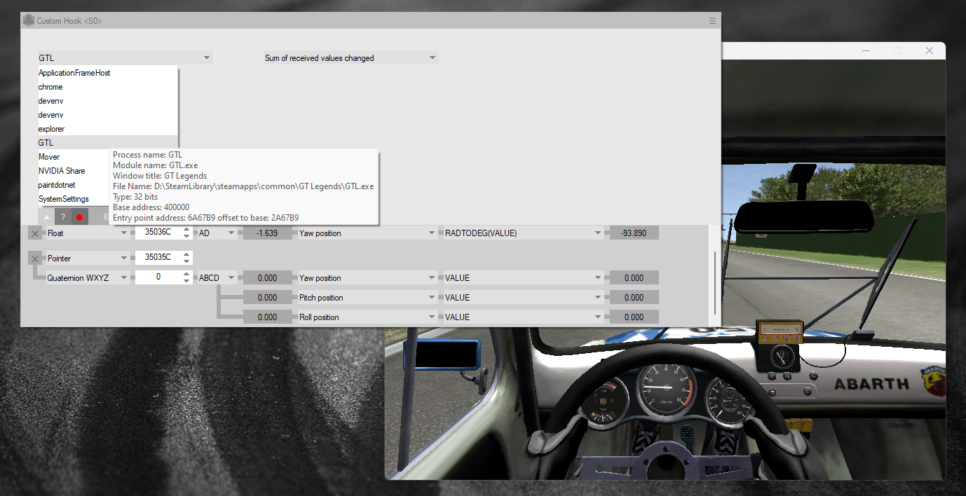

    So normally, what do you guys use the custom hook for?
  16. pmvcda
    pmvcda aka FlyPT
    Nov 3, 2010
    2,290
    Portugal
    16,010Coins
    +2,744 / 18 / -0
    Get data from games/software without telemetry.
    But they have a problem, when there's updates the hooks might change address.
    Usually I use CheatEngine to look for the hooks and use the custom hook to test the values and directions.
    A good example is the old GTL where we get telemetry but it lacks rotations. In the next Mover release I'm getting rotations using hooks and the other data through telemetry.
