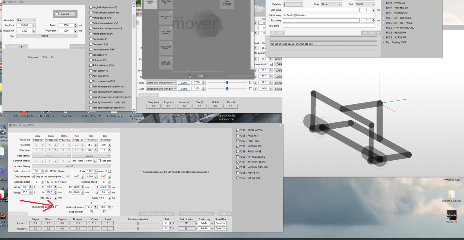

    I have a problem with setting the direction of movement of the arms depending on how the engines are positioned in relation to each other.
    Picture motor position
    https://ibb.co/p4Hh6Ym
    In this setting, everything works correctly and the movement of the arms is exactly the same as the motion preview in the Flyptmover 3D viewer window
    https://ibb.co/LxqRyMY
    When I turn motor #2 and reposition the arm, the arm movement is opposite to the preview in the 3D VIEWER window.
    Can I find an option in the program to reverse the arm movement?
    I thought about changing the polarity of the power supply to the motor but in such a case the Hall sensor in the SMC3 Utils program works incorrectly ( the green line of movement from the sensor goes opposite
    to the movement of the motor) the question is if I can reverse the power supply in the Hall sensor ? like it can be done for potentiometers?
  13. pmvcda
    pmvcda aka FlyPT
    Nov 3, 2010
    2,286
    Portugal
    15,986Coins
    +2,734 / 18 / -0
    You can reverse the Direction on a check box when setting the rig
  14. Attyla.pl
    Attyla.pl Active Member
    Oct 1, 2023
    308
    Polska
    1,348Coins
    +93 / 2 / -0
    Thank you for your reply, but do you mean the checkbox marked with a red arrow in the attached image ?
    If I check it, it changes only that the arms move in the opposite direction but not as I need.
    I send the signal from Source Loop Pitch speed to the controller and both arms should work up and down at the same time, and in my case engine 1 arm works up while engine 2 arm works down, when on the preview in 3D viewer I see that both arms should move in the same direction.
    Maybe my problem is that engine 1 connected to the power supply directly spins to the right and engine 2 connected exactly the same way with poles spins to the left ? Should I use the two engines rotating the same way 2 x left , or 2 x right ?
  15. pmvcda
    pmvcda aka FlyPT
    Nov 3, 2010
    2,286
    Portugal
    15,986Coins
    +2,734 / 18 / -0
    I mean the check boxes below the crank angles
  16. Attyla.pl
    Oct 1, 2023
    308
    Polska
    1,348Coins
    +93 / 2 / -0
    Thank you very much for your help, you guided me to the solution of the problem :)

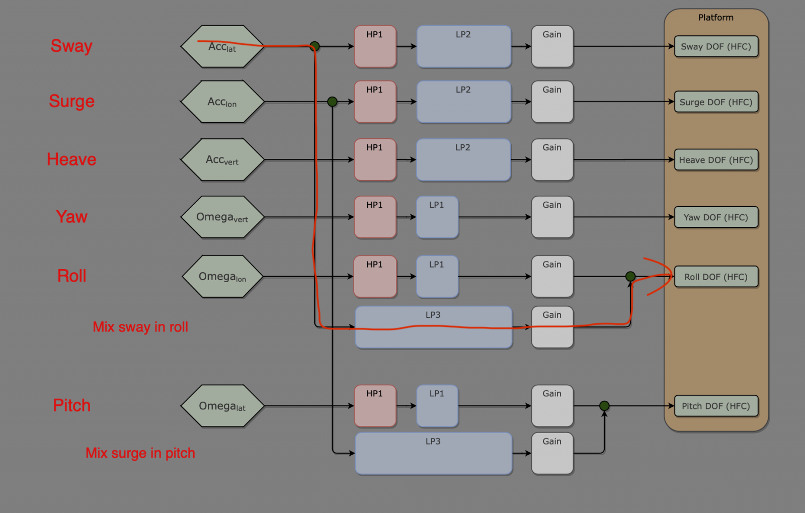

    Hi Everyone,
    It has been a while since i posted. My current rig is aiming towards a 3 dof with 360 degrees freedom. I am trying to simulate through the rotation of the 3 axis the G force to represent the forces inside a flight simulator or a F1 simulator. I have been trying to understand how to set this up in flypt but with no luck. How can input to is those forces? I know for example the math to convert longitudinal acceleration into a G force based on the distance of the pilot inside the motion simulator, but i cannot drive a single axis with that force. The plan i to combine al the 3 axis to recreate the correct force.
    Thanks in advanced.
  18. pmvcda
    pmvcda aka FlyPT
    Nov 3, 2010
    2,286
    Portugal
    15,986Coins
    +2,734 / 18 / -0
    I don't know if I really understand well what you mean, but here's what I do:
    First of all, cars and planes can be treated differently, but the base for all is to make you feel the forces.
    So, for example, in a real car, when you accelerate, you get longitudinal accelerations.
    There's some noise there when you change gear or go over some irregular terrain.
    What it means is that the acceleration has noise, it's not "constant". What I do in Mover is apply a low pass filter to remove that noise and get the "constant" acceleration.
    I also apply a high-pass filter to remove the noise.
    Now in the rig, if we have surge, it's always limited in travel, and you can't represent the "constant" acceleration.
    What I do is tilt the rig up (pitch) to feel some constant pressure in the back, simulating that constant acceleration. In a surge, I use the noise to feel the details.
    So, resuming: Low pass on pitch and roll, high pass in sway and surge.
    The pitch and roll filters are used in the mix surge/sway in pitch/roll.
    The pure roll and pitch are like the orientation of the vehicle in the terrain. If you are stopped in a slope, you can represent the slope in the rig with pure roll and pitch.
    Now comes the confusion:
    When you mix everything, some forces compensate the others.
    For example, in a plane turning and banking, if you put the roll and the constant acceleration together, they might neutralize each other, and then you might be horizontal in the rig.
    Or, for example, a car in an oval track.
    For your rig, from what I understand you have just rotations so you have to play with them only.
    Changing center of rotation (in the rig module) has no effect in your case. You can change it in the source for mover to correct the position in the received data, so the accelerations you get already have the position correction.
    Hope it's what you wanted.
  19. Grucho
    Grucho Member
    Jan 3, 2023
    48
    232Coins
    +10 / 1 / -0
    Thanks for the reply. So if i understood correctly, i cannot translate in a constant rotation on one axis the longitudinal acceleration? Because the math is kind of simple to convert it, i just need a constant value to multiple it by thr longitudinal acceleration.
    To make my self more clear, if i had the possibility to have an option to multiply on a single axis the a constant rotation, if the longitudinal acceleration is 0 i would zero out that constant acceleration, if it is higher i wohld just multiply it by that factor. And then i could apply a washout filter to bring the orientation of the rig to the rest position when i have no force.
    Whay I am looking at is basically trying to recreate lateral, negative and posive G forces with pure rotation.
