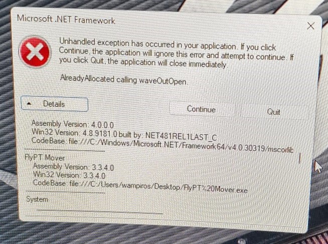

    Yes, there is a 5.1 system and the drivers are the realtek motherboard ones.
    Do I just have to physically disconnect the system or do I have to intervene at a software level on the drivers?

    Sorry,
    It's a bug in Mover. Works only with 2 speakers.
    Had and still have some problems for the next release. Still need to make a last check.
    For it to work try to disable the hardware or remove if a USB. Or avoid using the transducer module.

    I had the exact same issue a few weeks ago when I setup FlyPt for the first time. Worked perfectly on my laptop, but not my main PC (both running Windows 10). It was driving me nuts until I narrowed down the issue. Noticing that it was refrencing "wav output" or whatever, I figured it had something to due with my soundcard or drivers. Soundblaster AE-5, so I reinstalled and updated the drivers, but that didn't fix it. I eventually had to disable my soundcard and go back to using onboard soundcard (motherboard) which solved the problem.
    Looking forward to using my dedicated soundcard again when the bug is squashed. I like the 5.1 surround settings and other features it has.
    Thanks FlyPt for confirming the issue and for your hard work!

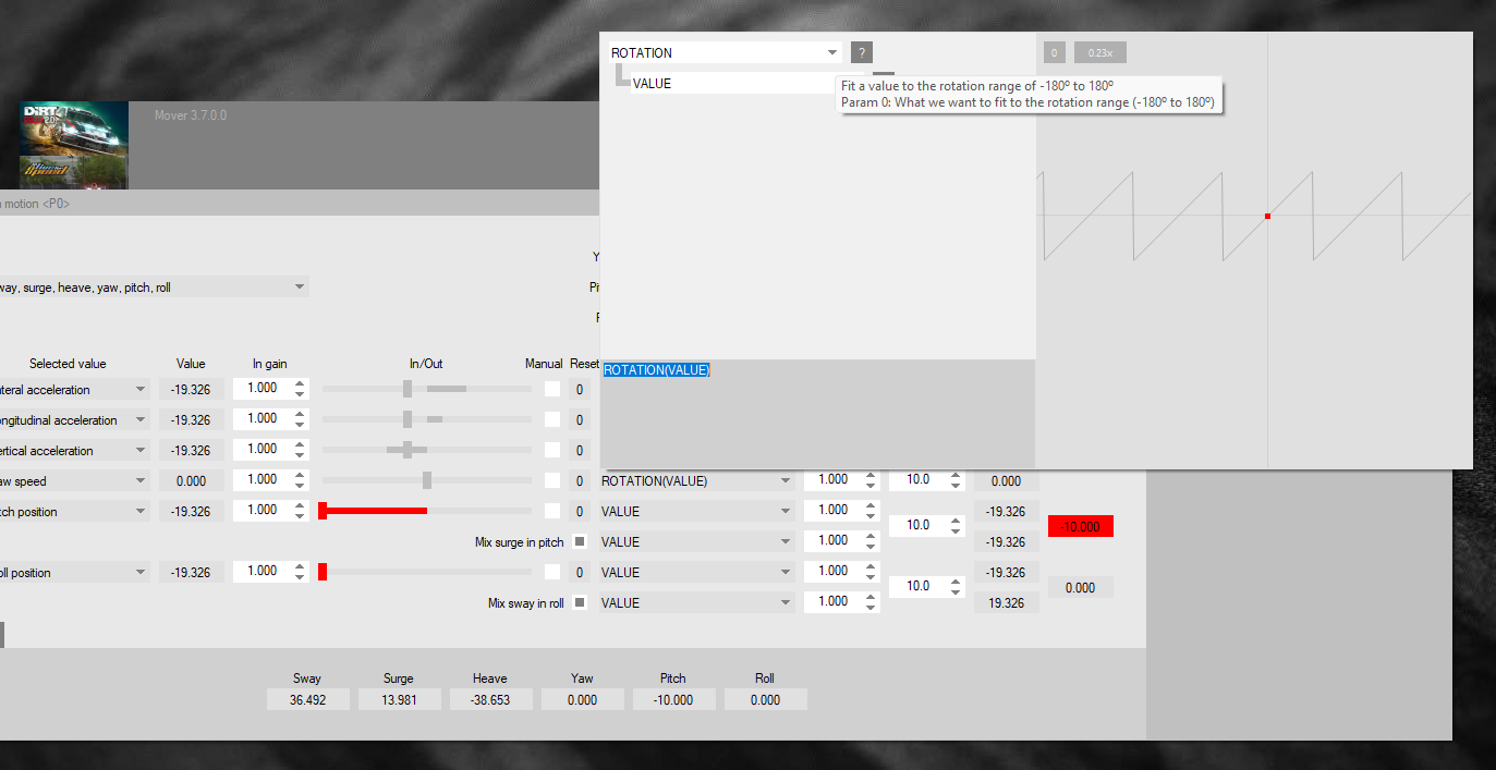

    I am using the pitch channel just to for testing. Is not connected to anything if not my motor. I set it to 2 the gain just to overshot and reach higher number the 360 to test the motion. I am still struggling though. I could solve the problem by usign this expression adjusted_angle=(VALUE+180)%360−180 but in the filter i dont have the modulo. This basically should reset always the motion once it goes over 180. Any other solution?

    Do you think you can add the division and modulo math function in the filters or is there an other way to reset the rotation past 360?

    Well, I confirm that the problem was precisely in the audio peripherals....by deactivating it through trial and error, I managed to start FlyPt Mover correctly.

    There's a ROTATION filter/operation in the new release that converts values that are beyond -180º to 180º into a rotation value in that range
    Example 190º would be -170º

    And this is the ROTATION filter:

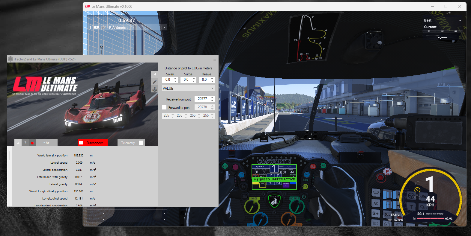

    Before anyone ask's:
    It's already in.
    For the current version, use the RFactor 2 DLL and put it in the plugins folder.
    Something like: C:\Program Files (x86)\Steam\steamapps\common\Le Mans Ultimate\Plugins
