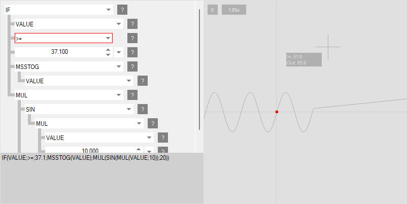

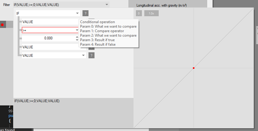

    Is it possible to have a filter that detect when the value is negative and apply a lower output gain on it or something similar to make the movement less hard on one side.
    This is on my pitch (the one mixed with surge). It feel a little too hard when braking but is ok when accelerating.

    I don't have the solution, but I agree with the premise - in every game if I increase the surge-to-pitch mix until acceleration feels good, the braking feels brutally hard. So I settle to having braking just a little too much, and the acceleration is barely noticeable. There should be a way...

    It will be on next release:

    Example:

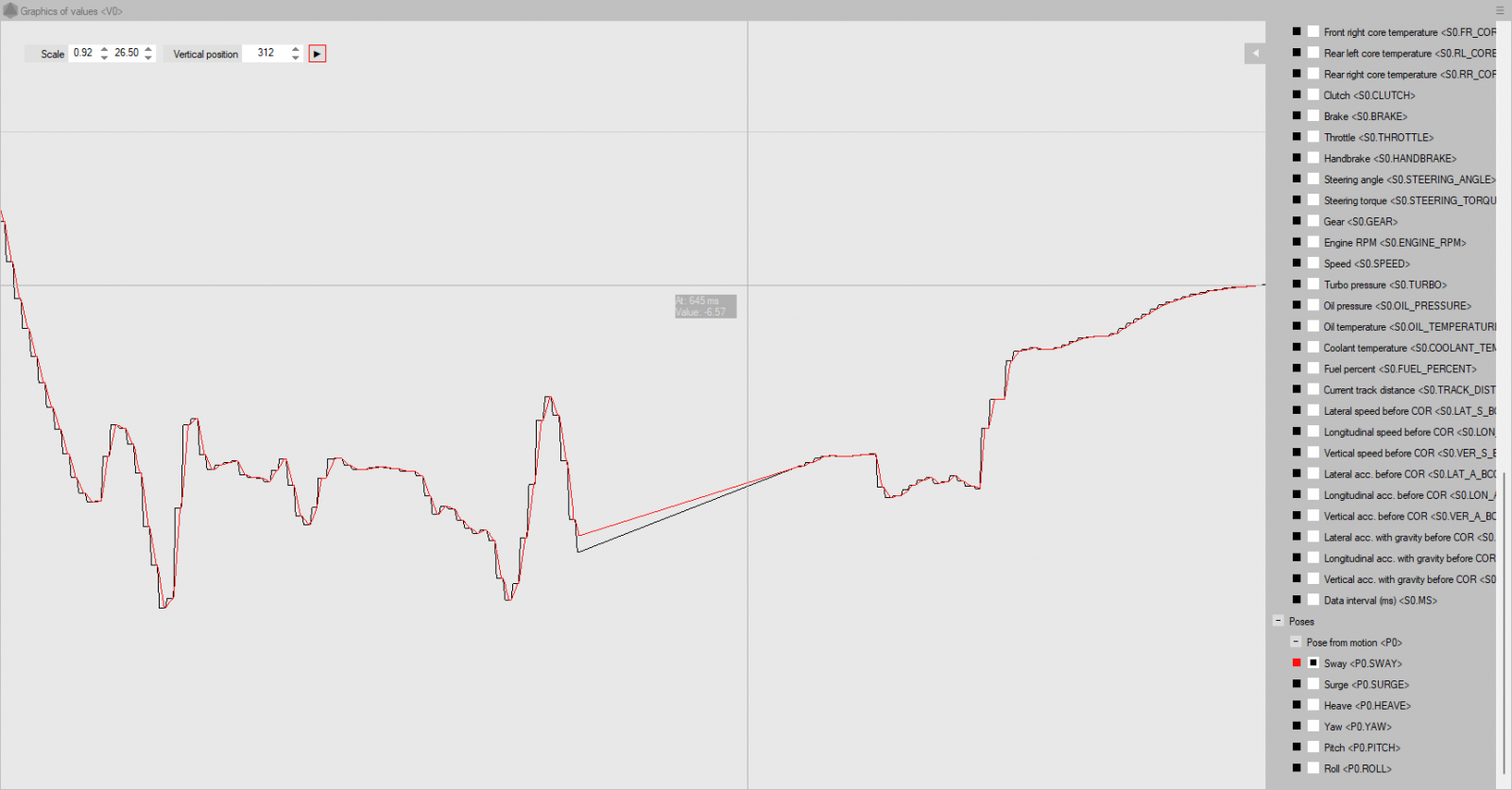

    ...Still on it
    to keep you interested, a new filter:
    Interpolation to increase some games data resolution

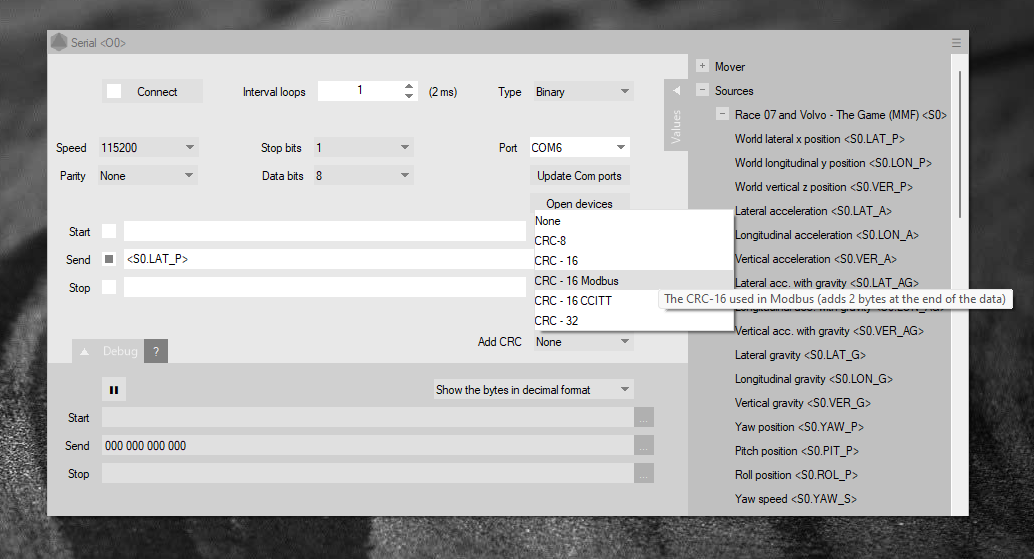

    You might be interested in CRC check for that:

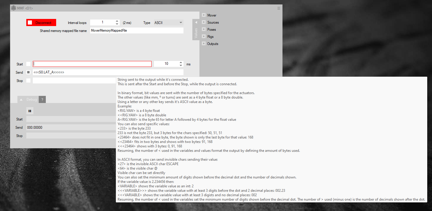

    or the new output string features:

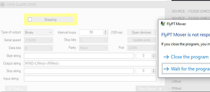

    I've been having this issue with my wind arduino, thought i could tackle it today.
    When i hit disconnect, it gets stuck on 'Stopping' and freezes Mover until i physically pull the usb cable from it:
    I'm thinking i need to add something in the Stop String, but not sure what. Possibly "STOP"?. And, what to put into the arduino sketch to do what is necessary after reading those characters. If i do a serial.end will it be able to start up again? even without serial i have a knob for manual wind control, so code is still running.
    arduino sketch here: https://pastebin.com/7gm42M1Y
    edit : SOLVED
    // get disconnect "STOP"
    if (bytesBuffer[0] == 83 && bytesBuffer[1] == 84 && bytesBuffer[2] == 79 && bytesBuffer[3] == 80 )
    Serial.end();
    setup();

    I have had this issue if I have set the COM port to the incorrect number/device. Are you sure 6 is correct? Have you any other COM port modules set in Flypt that could be incorrect?

    yep, i just edited my post with the solution.. needed some code to stop serial

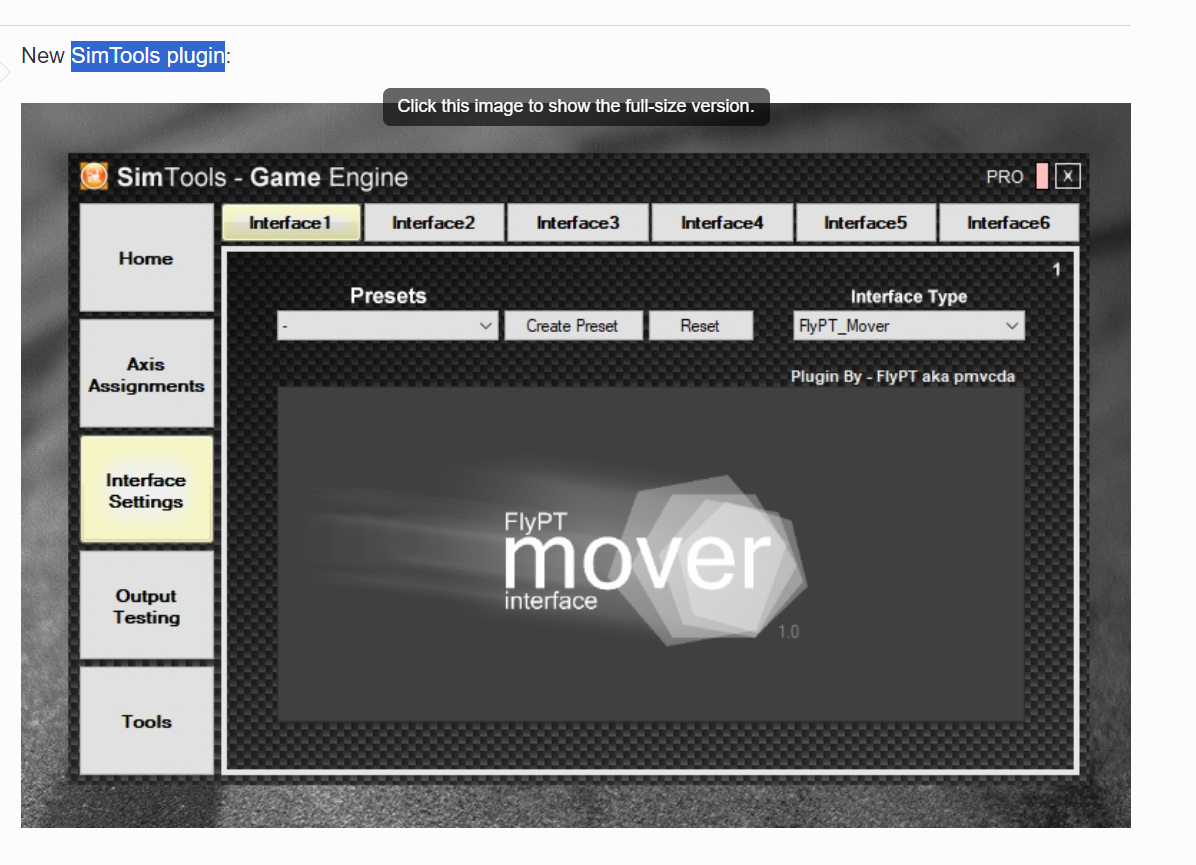

    Hi was wondering if there is a flyPT plugin/settings when using it with Simtools Ride player? Tried different Source within the FlyFT app - 'simtools' and 'Custom UDP' but so far FlyPT Mover is not connecting to Simtools.
    How do I select FlyPT_Mover interface type when I have FlyPT app running? see attached image
    Screenshot found here - https://www.xsimulator.net/community/threads/flypt-mover.13464/page-3
    I originally added this question to the FlyPT thread but admin moved it to New users.
    Many thanks
