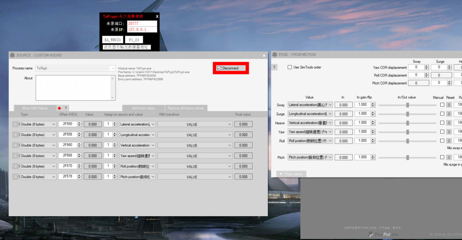

    This is a small plugin I wrote for Flyptp that supports F1_23 and EA-WCR. Currently, there is only a Chinese explanation available. Sorry for the inconvenience,And then it's completely free

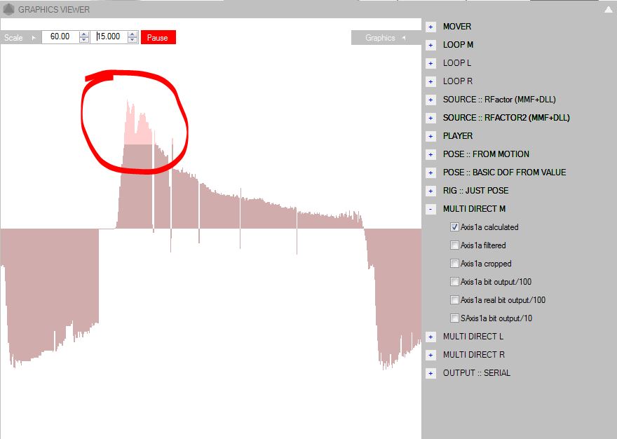

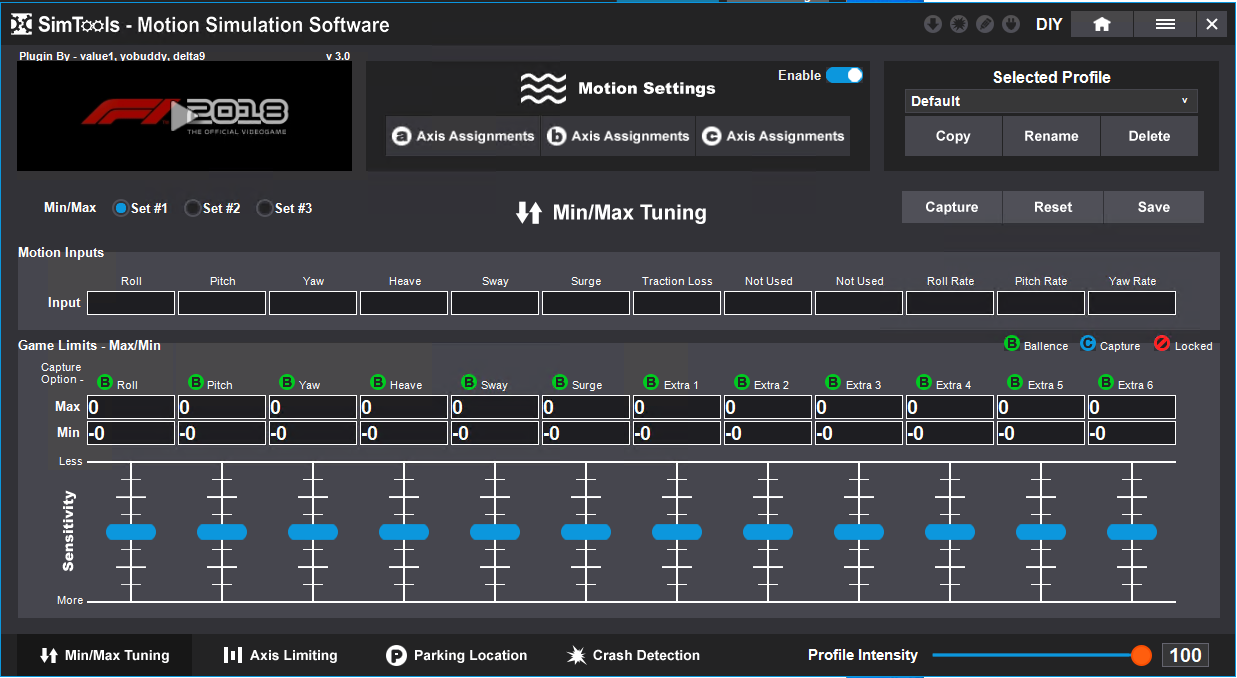

    1/ How can we apply a different range between the positive and negative values of the acceleration forces longi (for example).
    Like what we do in SIMTOOLS in Game Limits - Min/Max.

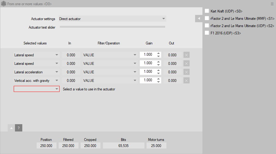

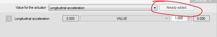

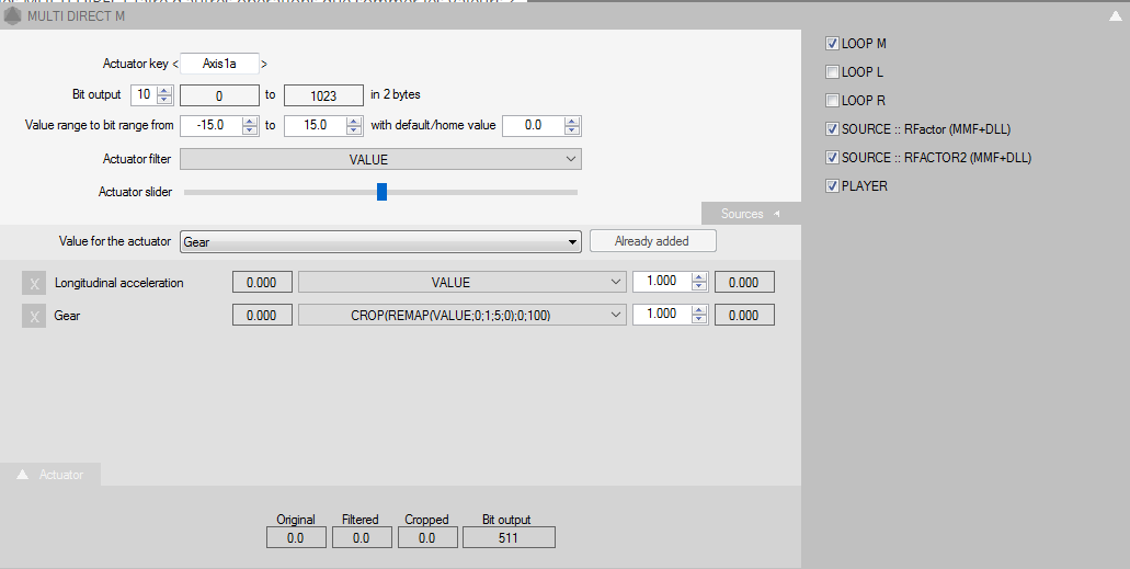

    2/ I use the MULTI DIRECT modules to manage the 3 rotary motors of my SIMU. For 1 DIRECT I would like to use the same input value twice to apply different filters when we are on positive or negative ranges. I have the impression that this is not possible. I thought about using longi accel and longi accel with gravity but it's not exactly the same thing.
    Do you have an idea to get around this limitation?

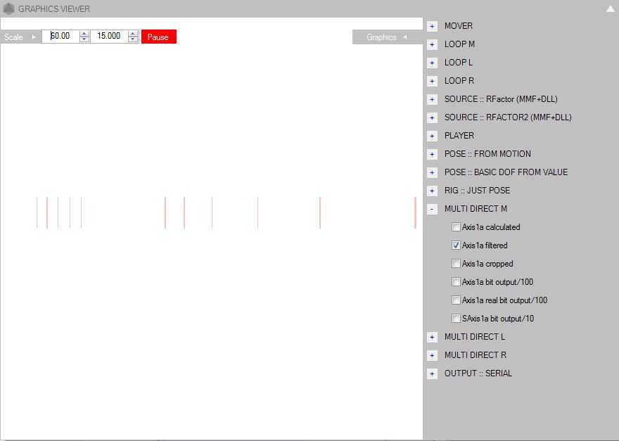

    3/ I am tempted to use the SPIKE filter to attenuate certain peaks when changing gear but this being an active filter (calculated) this induces a small latency. Can you tell what order it is?

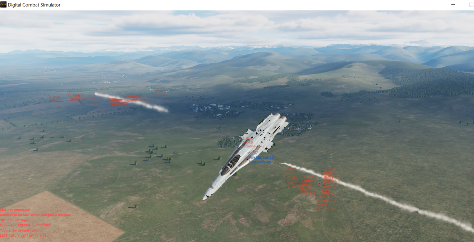

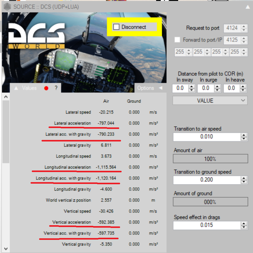

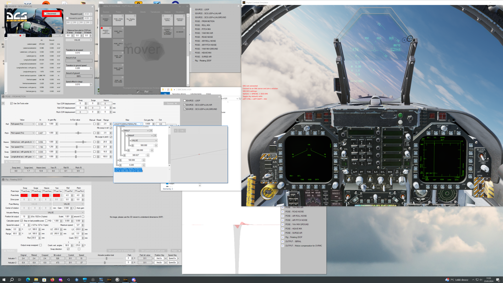

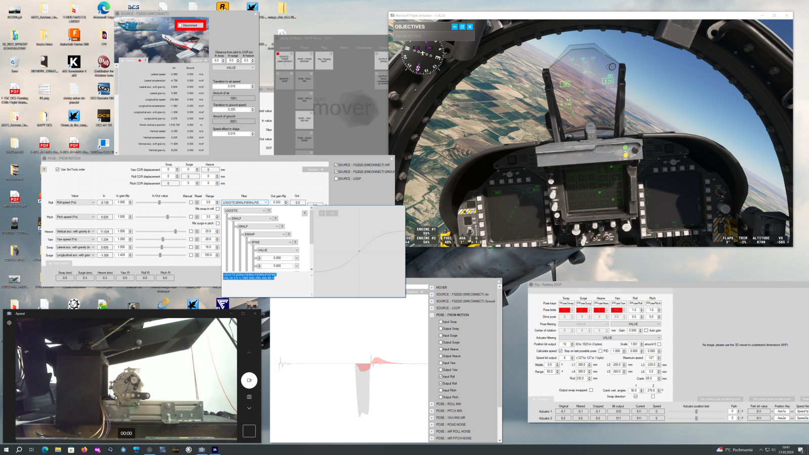

    Could I please, share a profile for 2DOF motion sim for the DCS game, I am trying to set up a profile using another profile from MSFS2020 but I can't deal with the situation when after the plane is shot down by an anti-aircraft missile the fuselage starts to buck violently, at such a moment sometimes one of the engines rotates the arm well beyond the normal operating range.
    I suspect that the values the DCS transmits when an aircraft is hit by a missile are too high, unfortunately I can't "cut" these values so that my 2DOF works properly.
    Please give me a hint.

    You can use the CROP filter to limit the values.
    CROP(VALUE;minimum value;maximum value)
    there's also CROPMIN and CROPMAX
    For now you have to use two multi directs.

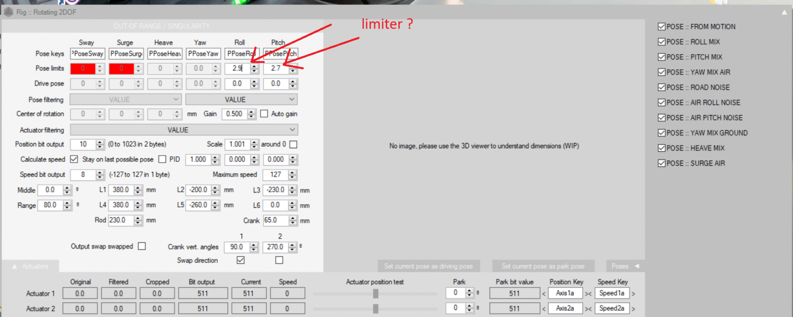

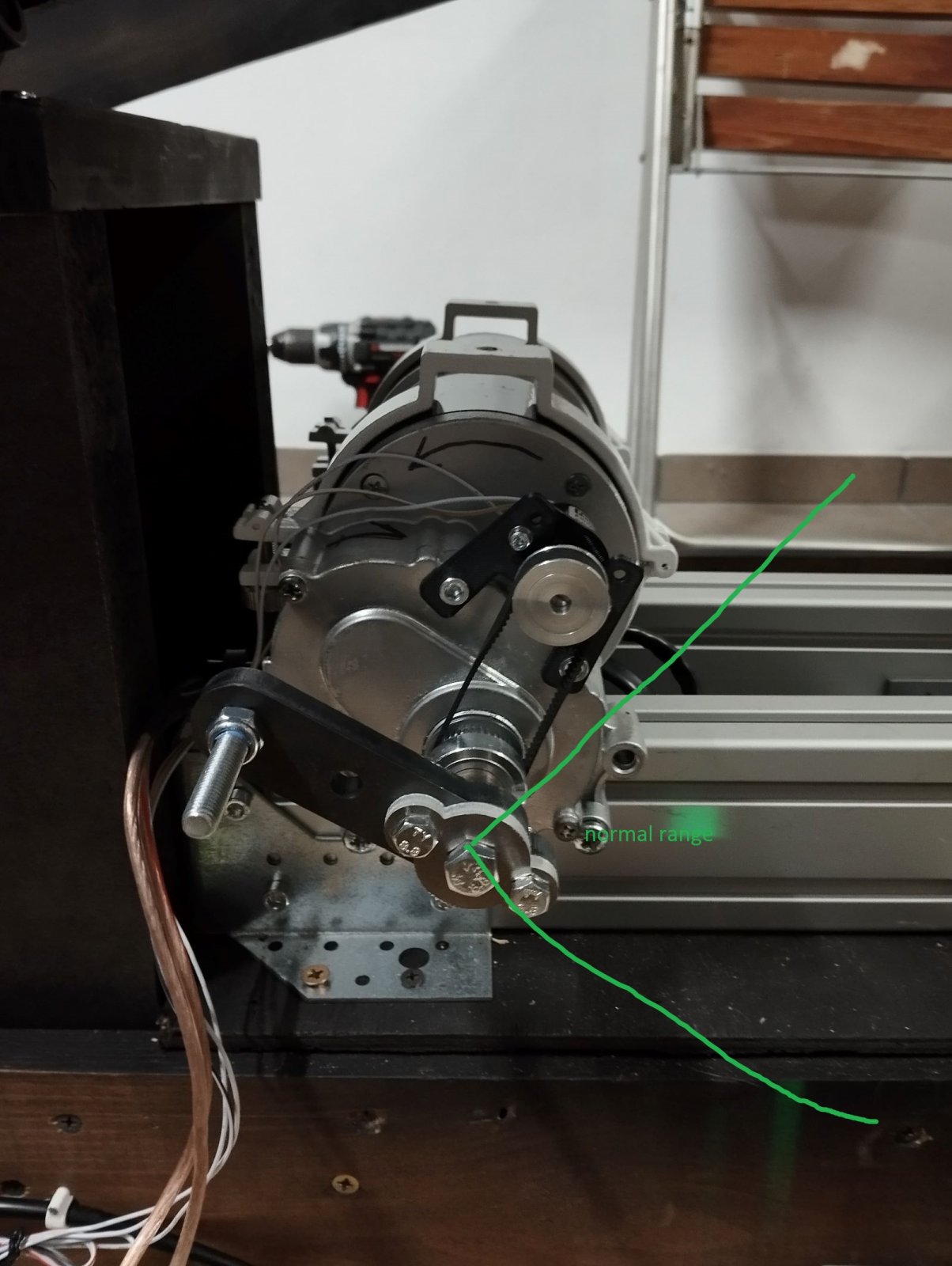

    Can you show the rig module please.
    I don't have the Mover with me right now, only tomorrow.
    I say this, because you can limit the actuators movement in the rig module to avoid that problem

    Thank you pvmcda for the answer, no problem I can wait :).

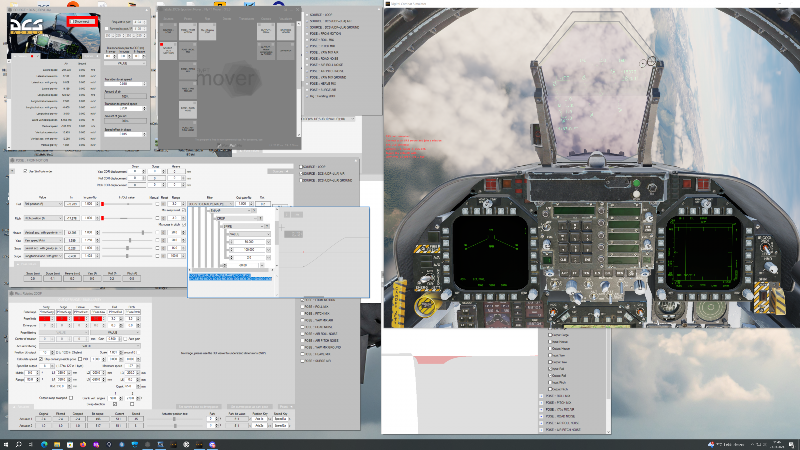

    My motion sim is a standard 2DOF, I found a motion limiting function in the RIG module but for some unknown reason it fails when the plane is hit by a missile.
    During normal flight everything works normally, the range of motion changes according to the imposed restrictions.

    I want to increase the longi acceleration for positive values. It's like a apply a multiplicator coefficient on positive values.
    In SIMTOOLS in define a different game limit for positive and negative values.
    How to do that with FlyPTMover ?
    Cause braking values are more importants than acceleration values but I want to obtain the maximum stroke also on negative than positive actuations.
    If I change the range for non symetrical range the actuator will not stay at middle position (neutral).
    For the subject of SPIKE FILTER.
    You said me :
    It's using exponential moving average. So you get some latency for strong filtering.
    But... the filter is in action only when "on spike" no while inside the allowed limits.
    I use this filter with this settings, what do you think about that ?
    40 of strenght of spike is it a too important level to avoid latency ?

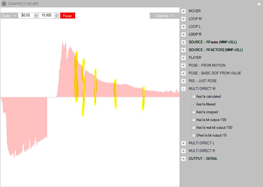

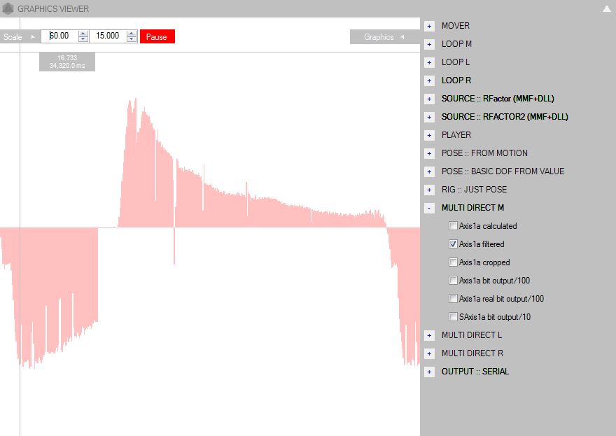

    In my tests and experimentations I have the idea to use the gear informations gived by the game to limit longi actuations during the gear changing.
    I try to use the passage by gearbox zero value between to gears to decrease the value used to action the longi motor on my SIM RIG.
    Some pictures to explain that :
    Peaks to decrease
    Gearbox change processed
    Result (wrong for negative values)
    Settings
    The problem is to change the sign of Gear value depending on whether we are accelerating or braking.
    The futher LOGIC OPERATION FILTER could allow that.
    For the moment I don't find solution.
    Have you got an idea ?

    Let me explain the spike filters: (there's 3)
    LDYNLP
    It's a linear dynamic exponential low pass filter
    Might have some lag
    LDYNLP (P1;P2;P3)
    • P1 is the value we want to filter
    • P2 is from the variation of value allowed before filtering
    • P3 is the strenght of the low pass (multiplier)
    In this filter the number of samples in the low pass is the variation of value (minus the allowed variation before filtering P2) multiplied by the strenght (P3)
    EDYNLP
    Same as the LDYNLP, but exponential instead of linear.
    Instead of using the variation of value (minus the allowed variation before filtering P2) it uses that variation squared, so the strenght of the filter increases exponentially with the variation (stronger than LDYNLP)
    SPIKE
    SPIKE (P1;P2;P3;P4)
    • P4 is the exponential to use (if 2 it's equal to EDYNLP)
    Same as EDYNLP, but instead of squared we specify the degree
    So for your filter SPIKE(VALUE;0;40;1):
    You are filetring all the values because you use 0 in the range without filtering.
    If you put 10 instead of zero, all the variation up to 10 (or -10) is not filtered.
    Using 40 is a strong multiplier. If the variation of value is 100, is uses 100*40 samples in the low pass.
    In the exponential degree you use 1, so it's the same as LDYNLP.
    If you use 3 the number of samples will be samples*samples*samples
    LDYNLP and EDYNLP exist just to make calculations faster (less parameters and operations).
    Hope I explained the insides of the spike flters in Mover. You can see that if you specify an allowed range, there's no lag because there's no low pass on that range. If the low pass is high, you get the lag, but that's what we want to avoid the spike.
    I think filters in the Thanos and Motion4Sim are different. I did not look at them on purpose to avoid idea contamination...

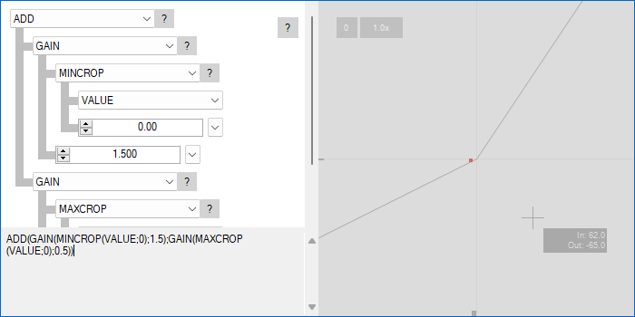

    An idea to increase the positive values and reduce the negative ones:
    ADD(GAIN(MINCROP(VALUE;0);1.5);GAIN(MAXCROP(VALUE;0);0.5))
    The value range to bit range in the direct module:
    The idea is to map a value to a bit value in the actuator.
    That default/home value is in reality the parking of the actuator.
    So if we map value from -50 to +100 we say that the actuator at bit 0 is for value -50 and maximum bit value is for value +100. It's just a remap.
    You should act on the filter of the direct and adjust the calculated value to your desired range.
    Just think of it this way:
    You have the actuator that can travel from 0 to 200mm (physically).
    You are calculating values that you send to the actuator.
    I can decide that I want position 80 in the actuator to correspond to the zero of the calculated value.
    For that you need to ADD(VALUE;80) to the filter. This means that if you calculate 0, the actuator is at 80mm.
    If you send -100 the actuator is at -20mm (it's out of the 0 to 200 range so it crops to zero)
    If you send 100 the actuator is at 180mm.
    You can also use gain to change the relation or the remap.
    The value range to bit range is just a remap to say that a calculated value is for a specific bit value. It has to do with the hardware and would be ignored if we sent just the position we want.
    In your case it's not a measure, more a empirical value you need to map to the actuator.
    I would say to put it from -100 to 100 or -1 to 1 and do all the math in filters to match those values.

    Changing the sign of gear change depending on acceleration or deceleration:
    Only thing that I remember right now is to use gear variation (-1 or +1), but there you don't have the acceleration.
    This is why vars and conditions are needed...

    I have a question about the EMAHP filter.
    I am using the profile from Roman Design, the question is why when I tilt the aircraft in the roll axis to the left and leave it in such a position first the program generates the correct movement of the engine lever in accordance with the movement of the aircraft and then generates the movement in the opposite direction to zero and exceeds this value generating the movement of the lever contrary to the direction of rotation of the aircraft. Removing the EMAHP filter from the roll axis removes this error.
    Below is a screenshot and two short videos showing this situation.
    Roll with EMAHP
    Roll without EMAHP

    This is a good question that has already been answered many times in this topic. The HP filter (return to center) is part of the most popular "classic washout" algorithm - the best solution for the hexapod's limited "workspace". A slow return to the center (below the speed of vestibular perception) is the best way to fool the brain, which generally only perceives a change in angular velocity, ignoring the constant angular velocity. As has the fact that speed cannot be perceived, only its changes (acceleration).
    The aim of high-fidelity signal processing is not to translate all real-life forces within the limits of a simulation, which is intrinsically impossible, but to eliminate false forces as far as possible. In an aircraft simulation, keeping the platform tilted during constant roll would, I think, be a false cue. In most cases, you should only feel the roll in and out.
    Cheers - heXpod

  18. Attyla.pl
    Attyla.pl Active Member
    Oct 1, 2023
    308
    Polska
    1,349Coins
    +93 / 2 / -0
    Thanks for the reply, but looking at the Graphics Viewer window in FlyPtmover, I noticed different behavior of the EMAHP filter depending on what is the signal source for the roll axis:
    1. if the source is "Roll position" then the use of the EMAHP filter is perfectly correct, and when the aircraft is tilted to the left, the platform tilts to the left and then slowly returns to the horizontal position
    2. if the source is "Roll speed" then the use of the EMAHP filter causes the platform to behave differently, and after tilting the aircraft to the left, the platform tilts to the left then quickly returns to neutral and crosses it to tilt to the right and only return to the horizontal position.
    Question what filter can I use to use as a source "Roll speed" to get a fast tilt according to the direction of "Roll speed" and then a slower return to the horizontal position ?
    Below are two screenshots showing the operation of the EMAHP filter depending on the source of the signal.
    Translated with DeepL.com (free version)
  19. hexpod
    hexpod http://heXpod.xyz
    Apr 18, 2016
    1,228
    berlin
    7,900Coins
    +381 / 5 / -0
    DC motor, 6DOF
    I'd advise sticking to "speeds" (angular velocities). I think you can experiment with LP and HP weights to get the right behavior. Try superimposing LP or HP filters one after the other LP-LP - HP-HP-HP (second or third order). This changes the abruptness of the behavior. The more you repeat the same filtering (two or three times), the more gradual the response will be. That way, you can decide on the amount and harshness of the inclination. Depending on scenario, the adverse kick when you stop rolling is not necessarily a false cue.
