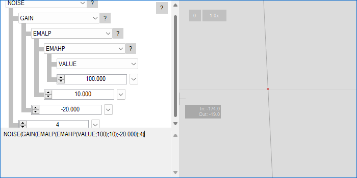

  15. pmvcda
    pmvcda aka FlyPT
    Nov 3, 2010
    2,292
    Portugal
    16,022Coins
    +2,744 / 18 / -0
    Ok, was looking at it.
    For that Mover version, I only see NOISE as a solution.
    There you can define the frequency of the noise change.
    The problem is that noise is between 0 and the value you define and being noise it can be near zero sometimes.
    Please try that.
    NOTE: I told you I would look at it later because I did not have access to the old Mover at the time to see your setup...
