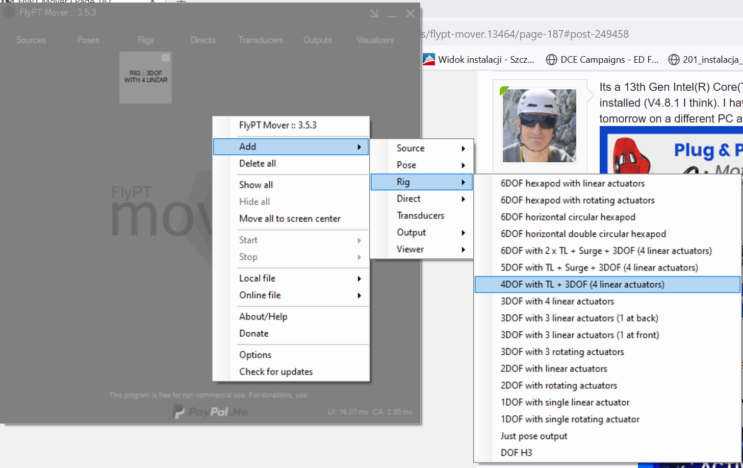

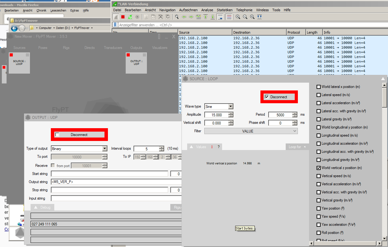

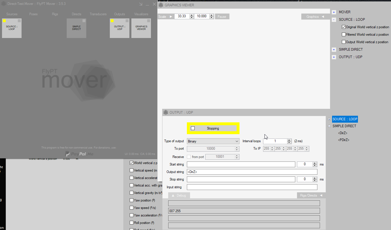

    We are currently trying to get started with our 3DOF rig. I'd like to do a very simple test at the beginning before trying to use real motion data from the sim software. So I started with a blank screen and added a loop source, a simple direct and a UDP output. However, I encounter several problems:
    1. Each time I start FlyPTMover I get an unhandled exception. It says
    WaveBadFormat calling waveOutOpen
    Mover.MoverAudio.MmException: WaveBadFormat calling waveOutOpen
    at Mover.MoverAudio.Wave.WaveOutEvent.Init(IWaveProvider waveProvider)
    at Mover.Utils.Audio.AudioMix..ctor(Int32 _deviceIndex)
    at Mover.Utils.Audio.UpdateListOfAudioDevices()
    at Mover.Main.Main_Load(Object sender, EventArgs e)
    at System.Windows.Forms.Form.OnLoad(EventArgs e)
    When I click "continue" the main window opens and it seems to work, though.
    2. Opposed to the documentation where it is said that all modules are saved upon exit and re-loaded when I start the software again, later, I always get a blank window and nothing is saved. If I save the modules manually using the Menu -> local file it works as expected.
    Did I make something wrong installing FlyPT mover? There is no installer included, just an .exe file. Can I simply run it in any directory?
    3. I have problems interpreting the UDP output window. What does the Connect/Starting/Stopping button with the checkbox mean? When I pressed "Connect" for the first time I got a dialog from Windows asking if I want to allow access to the local network. I answered "yes". Now I can't modify the "To IP" anymore. If it's 255.255.255.255 I expect it to do broadcasts but I can't see any UDP packets going to the network in WireShark.
    How is this supposed to work?

    Hmmm, it's not just the UDP output that does nothing. I think the whole software is in some sort of idle state or demo mode, I don't know. If I select "start everything" in the menu then some lights appear in the corners of the source and the output module. But I don't see anything in the graphics viewer. Also suspicious: the UI and CA times in the lower right corner of the main window display "0.00ms" all the time.
    Maybe the calculation loop thread was killed due to the unhandled exception?

    Its a 13th Gen Intel(R) Core(TM) i5-13600T 1.80 GHz running Windows 10 22H2. The latest .NET framework is installed (V4.8.1 I think). I have some other PCs in my workshop but they are very old (WinXP). I'll try it tomorrow on a different PC at home.

    Next question: Is there any example of a rig & pose/filter setup with 3DOF? There must be at least one with 4DOF (two vertical actuators in the front and two in a delta-arrangement in the rear. I could take that to start with and simply ignore the yaw component.
