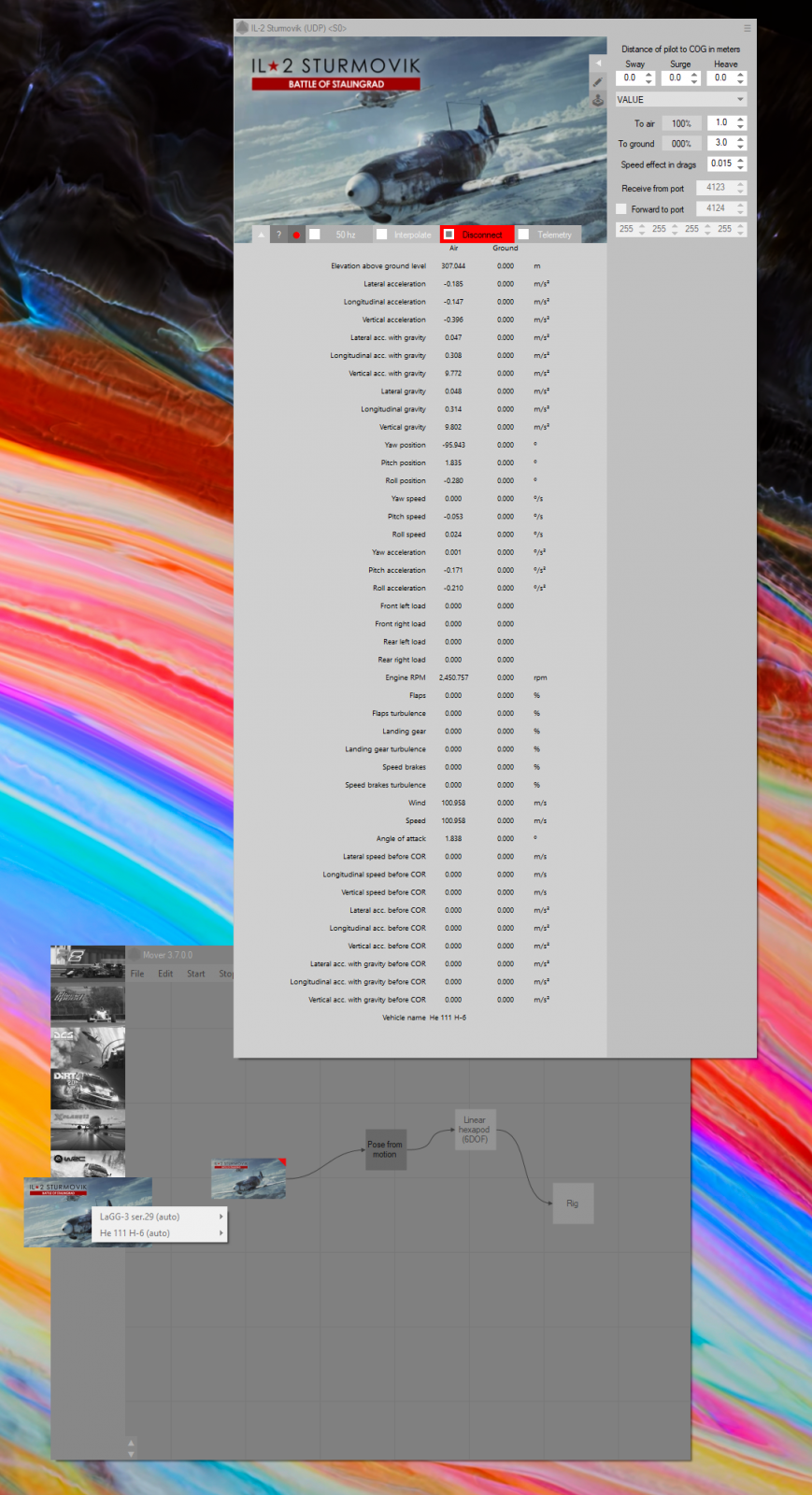

    @pmvcda I discovered with horror that the planes in „flying circus“ (1stWW) in the il2 series are incompatible with those from previous series. I am trying to figure out the accel directions which seems different to those from previous releases. Those with gravity you set up back that unfortunately doesn’t work with the WW1 planes.

    Coming from them, it's possible.
    Give me some feedback if you can please

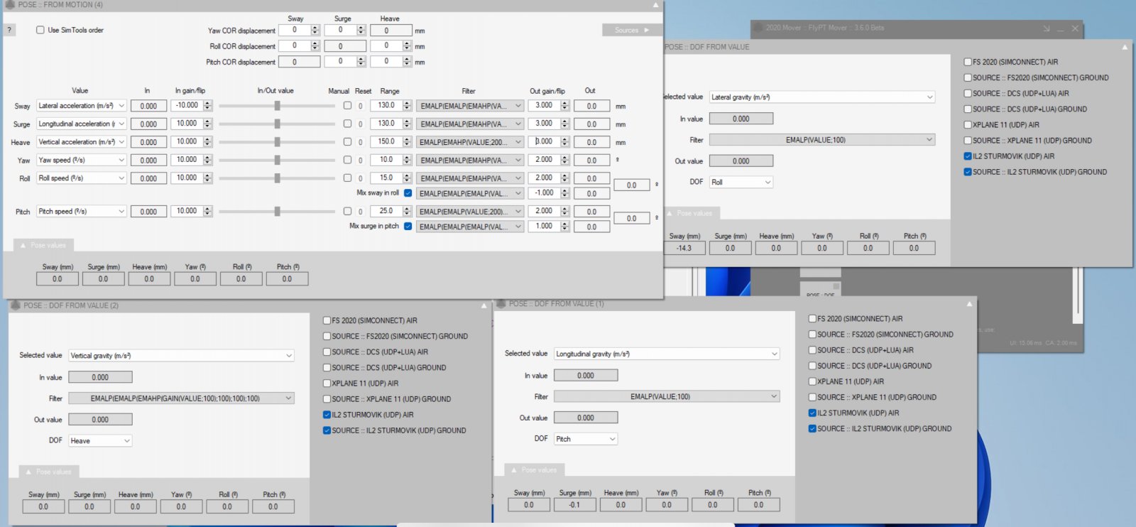

    Ok, after a quick analysis (I always can be wrong) I think the sway (lateral accel.) is inverted once we choose WW1 birds. You can see the overcome in the screenshot (minus sign in “sway” and “mix sway in roll) which shows how great and flexible mover is. You should guess why the accels with gravity are getting stuck. I it’s possible to fix directions in flying circus without breaking them in other series you can go for it.
