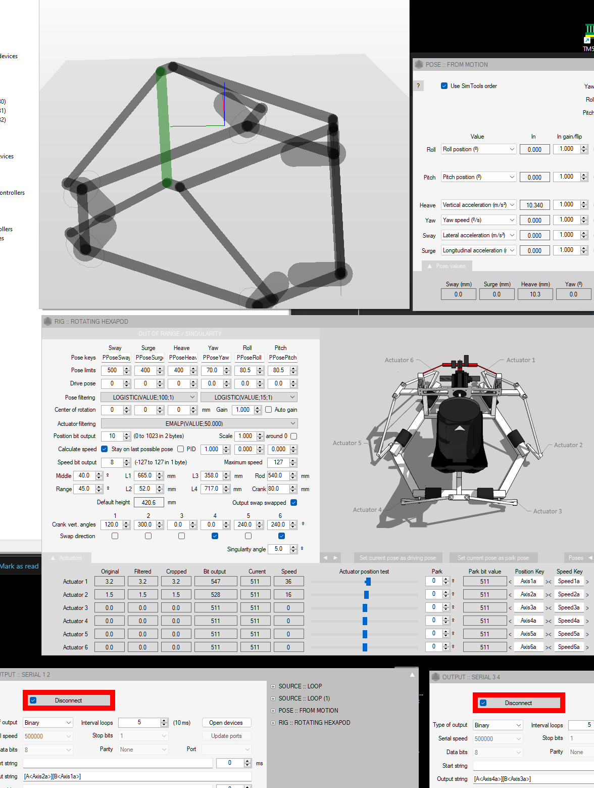

    How do I reverse motor directions? I'm building a 6DOF rig and half of my 6DOF motors are rotating the wrong way. 3 motors have "swap" enabled - so the 3D viewer looks correct. I tried disabling "swap" on one motor, then the crank went to a crazy position in the viewer, so I corrected the "crank vert. angle" (from 120 to 300) but then the motor is still rotating the wrong way. I'm missing something simple...
  6. Historiker
    2,163
    9,212Coins
    +2,179 / 19 / -1
    In the pose from motion - in gain/flip make the number a negative.
  7. Ronan Design
    Jun 4, 2021
    270
    Toronto, Canada
    1,716Coins
    +143 / 2 / -0
    No, the problem was that some actuators moved in reverse, in the RIG, before the pose etc. I solved it by inverting one motor of the motor pair in SMC3.

    You could do it in swap direction bellow the crank vertical angles

    It made the motors flip in the viewer and crank would be on the opposite side. To make it visually tight, I had to change the angle by adding 180 degrees, but it didn't behave right anyway. Could be some other problem with my setup. Anyway, SMC3 change worked.

    Yes, I reversed the second motor on each board. That fixed the issue.
    Checking/unchecking "swap" checkbox in FlyPT results in motor flipping to the outside of the frame (it was inside on my design), and so the crank reverses not only the direction, but an angle by 180 degrees. And if I then corrected the angle so it appeared normal in 3D View, the rig itself behaved incorrectly. But fixing it in SMC3 did the trick.

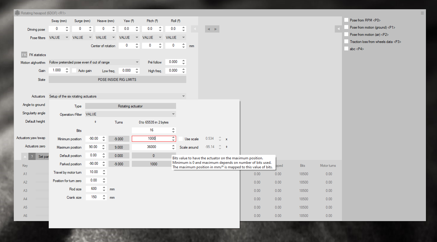

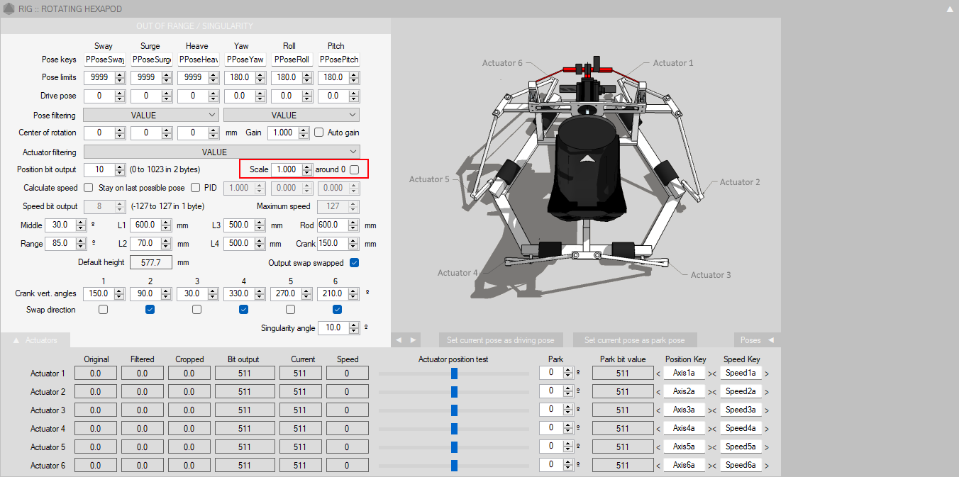

    How do I match the range of motor arms movement to the FlyPT model? I have a DIY hall angle sensors that return arbitrary angle data, so the 6DOF system motors have a certain range (about 90 degrees) from min to max values (clip to clip), let's say 94 degrees (+47/-47). In the FlyPT rig model I specify certain sizes, and it expects to send a certain movement (2 degree for example) and get a 2 degree movement from the rig. But how do I make sure the actual movement conforms to expected movement? I think there's supposed to be a scale multiplier somewhere that's supposed to match the actual movement to expected movement, but I'm not sure where...
  13. pmvcda
    pmvcda aka FlyPT
    Nov 3, 2010
    2,292
    Portugal
    16,022Coins
    +2,744 / 18 / -0
    There's a scale option (in red) you can adjust to make it match.
    The problem (just an example) is if you had 8 bits resolution and map them for a range of -90 to 90º, Mover doesn't know that. So you need to adjust the scale:
    Now scale can be adjusted from zero degrees (middle) or the minimum position like -90.
    This makes you match 5º in Mover to 5º in reality.
    In the new Mover, you can map the bits to positions (in the controls near the one in red):
    allowing any mapping or still use scale

    Thanks for the quick reply! So I'll use the scale to reduce the range to fit the model.
