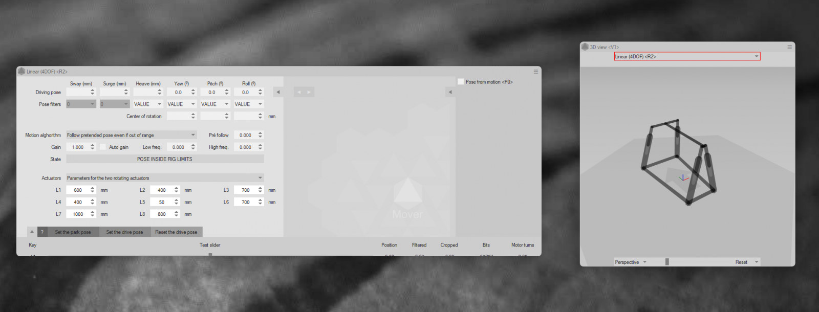

  3. tadeusz
    tadeusz New Member
    Nov 4, 2025
    14
    94Coins

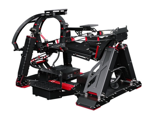

    Dear colleagues, I've been using FlyPt for years. I'm very happy with it. I have a question: is it possible to use the platform from photos?
    If so, could you tell me where I can find such a tool?
    Best regards, Tadek
  4. Motion4Sim
    Motion4Sim Member
    Jun 13, 2020
    93
    Europe
    747Coins
    +113 / 1 / -0
    I just had a look, and I don’t think FlyPT-Mover supports the kinematic model you’re showing in your photos. You’d need some kind of extension that can calculate the motor positions for that geometry.
    You could give it a try as a 3DOF setup with 4 actuators, as long as your motor control is FlyPT-compatible. Just keep in mind that the positions won’t be accurate — it’ll move, but probably not in the way you expect. Whether that’s useful to you is another story. Mechanically, though, there shouldn’t be any issues since the bearings can handle that kind of setup.
    If you’re actually planning to build such a platform yourself, I’d really recommend going straight for a 6DOF. There’s plenty of support and documentation out there for that geometry.
    Have you checked the latest beta version of FlyPT-Mover? Maybe there are some new geometry options in there. I haven’t spent much time on it myself lately since
  5. Nisch
    Nisch Member Gold Contributor
    Feb 20, 2019
    56
    Technically retired software developer
    Phoenix, AZ
    253Coins
    +128 / 0 / -0
    Motion platform, 6DOF
    Yeah for that kind of money and to not have 6DOF is crazy.
  6. tadeusz
    tadeusz New Member
    Nov 4, 2025
    14
    94Coins
    Not that expensive...
    I can buy it for 2500 euros.
    Best regards,
    Tadek

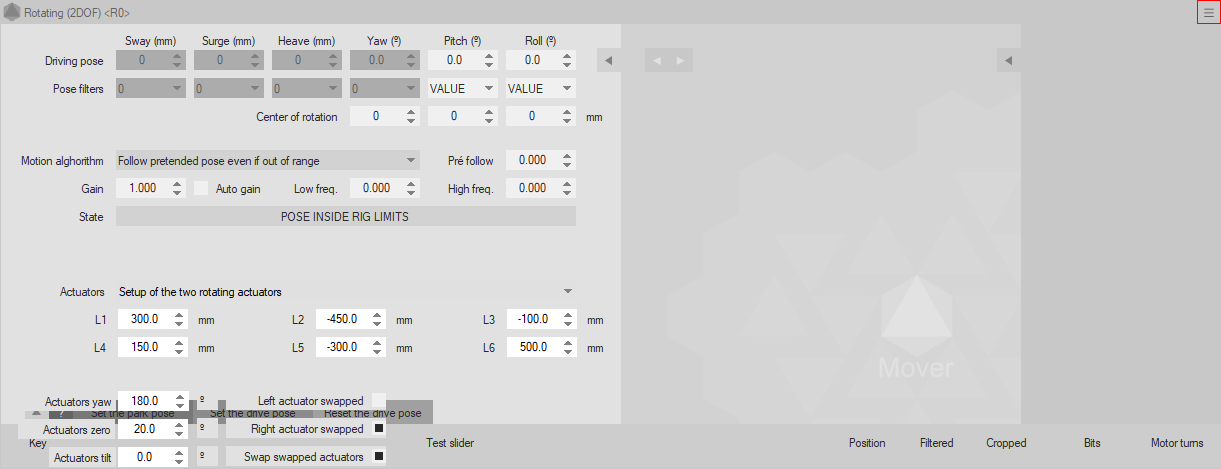

  7. Andrey Av
    Andrey Av New Member
    Oct 10, 2025
    14
    75Coins
    Hello.
    I'm building 2DOF motion platform for MSFS and investigating FlyPT Mover currently.
    I've added the Rotating 2DOF Rig and see some overlapping in controls:
    Is it a known bug? Is there a way how to fix that on my side?
    Thanks.

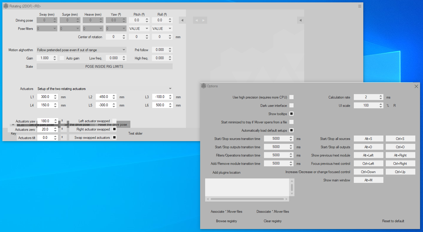

  8. pmvcda
    pmvcda aka FlyPT
    Nov 3, 2010
    2,296
    Portugal
    16,036Coins
    +2,746 / 18 / -0
    Yes, it's caused by scale
    Try to change scale to 100 in the options
    I need to update the 2DOF modules

  10. Andrey Av
    Oct 10, 2025
    14
    75Coins
    Thanks for the fast response!
    It is already 100 in the Mover options. Windows scaling is also 100%.
  11. Andrey Av
    Oct 10, 2025
    14
    75Coins
    UPD: Setting scale to 125 helped to carry those background controls out of the foreground ones. Thanks.

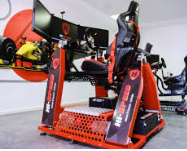

  12. tadeusz
    tadeusz New Member
    Nov 4, 2025
    14
    94Coins
    Hi
    Thank you pmvcda
    You're the best
    What do you mean: "I need to change some calculations to be an exact match"
    Do you think there's a chance this platform could be adapted to work with FlyPT?
    It uses bus control. What do you think could replace it?
    all the information I have now is from the manufacturer's website
    https://web.motion-sim.cz/racing
    Thank you for your interest.
    All my hopes lie with you.
    I'll just use heave/pitch/roll
    Best regards,
    Tadek

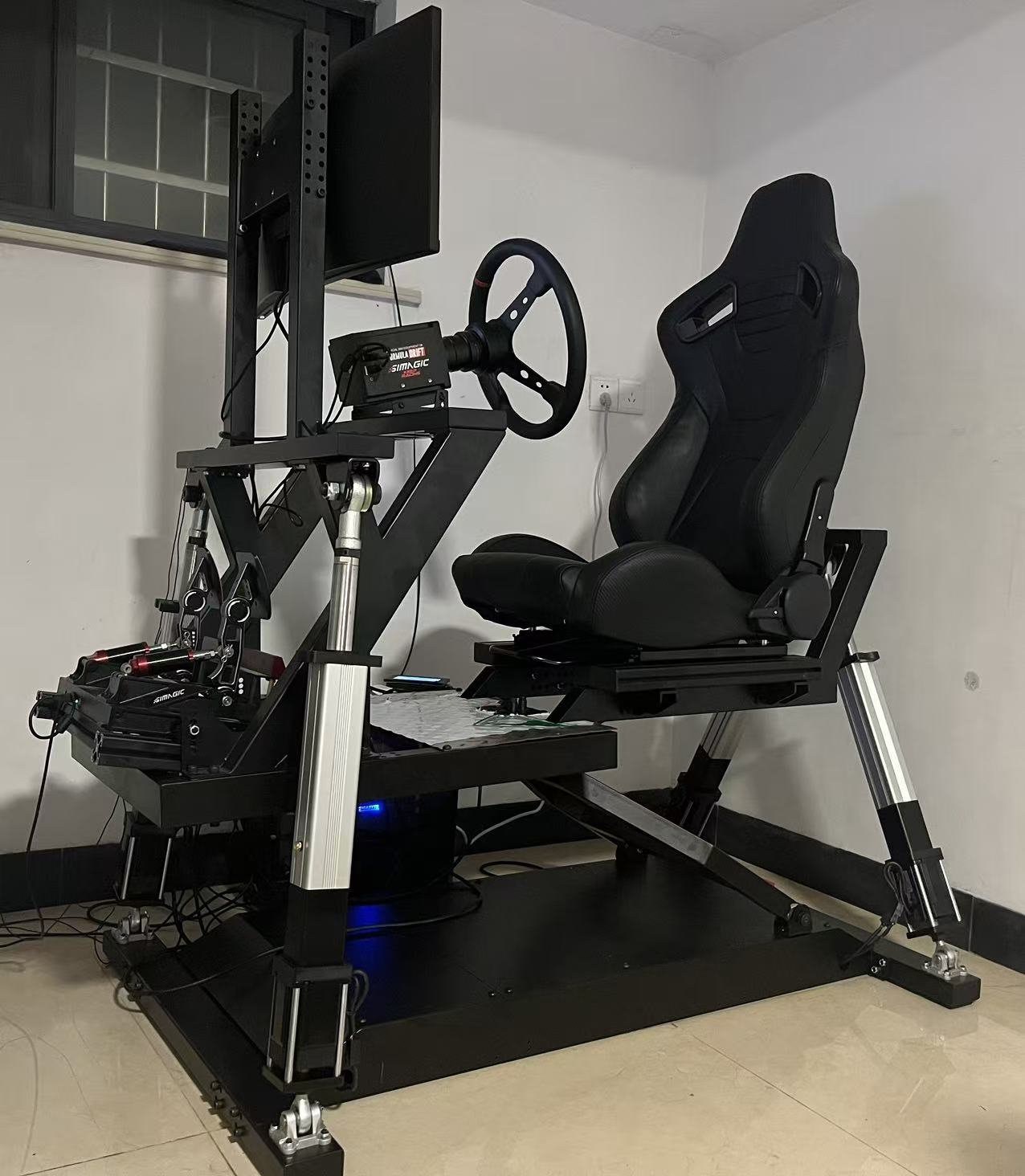

  13. lsjzyi
    lsjzyi New Member
    Aug 27, 2023
    8
    china
    14Coins
    Has a new version been released? I have this structure.
  14. tadeusz
    tadeusz New Member
    Nov 4, 2025
    14
    94Coins
    Hi lsjzyi ,
    How do you control your platform?
    What program do you use?

  15. Motion4Sim
    Motion4Sim Member
    Jun 13, 2020
    93
    Europe
    747Coins
    +113 / 1 / -0
    You should first find out which motors the Czech simulator uses. Then you can think about which controller you’d like to use if the original one no longer works or if you don’t have a license for there system. Please also share which motors your simulator uses. You mentioned it’s bus-controlled via CAN/modbus /Ethercat ? That could be problematic, since most DIY controllers only support Step/Dir motors as an interface.
    What Mover provides you with is the position of the rig or the individual motor positions bit by bit. You basically still need an interface that converts this for the motors. With Mover, you can output this data serially via COM ports, USB, or UDP. your interface has to support this kind of data input

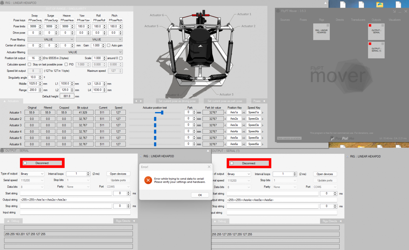

  16. Selfsimmer
    Selfsimmer New Member
    May 27, 2025
    24Coins
    I'm using:
    FlyPT Mover 3.5.3
    2 x Arduino Mega 2560
    6 motors (3 for each Arduino)
    I can control motors 1-2-3 by connecting one Arduino. Or I can control motors 4-5-6 by connecting the other Arduino. But as soon as I try to control all motors, by connecting both Arduinos, the problem shows up. I get "Error! Error while trying to send data to serial! Please verify your settings and hardware"
    For testing purposes I've the motors laying on a table, they are not connected to a rig yet.
    Does anyone know what causes this problems? Any help much appreciated.

    strange, can you show some information of the device manager com/lpt port maybe a device mismatch.
  18. Selfsimmer
    May 27, 2025
    24Coins
    Thanks for your reply Wingert, I'll upload the information from the device manager. Port 5 and 6 is what I see in FlyPT Mover, so that looks okay to me..?
  19. pmvcda
    pmvcda aka FlyPT
    Nov 3, 2010
    2,296
    Portugal
    16,036Coins
    +2,746 / 18 / -0
    Try to increase the loops up to 8 and test. If it works, lower the value until it crashes.
    Not sure it solves the problem, but please try
    Edit: interval loops should be at least 5ms for those arduinos
  20. Selfsimmer
    May 27, 2025
    24Coins
    Thanks so much Pmvcda. I've changed the loops to 8.
    Now what I'm seeing:
    If I connect one Arduino, it works fine. I can get the motors (1/2/3) to move. When I then connect both Arduinos, I can't get any motor to move anymore. But! I'm not getting any error from FlyPT anymore. So there is some progress, I think.
    Just I don't understand why I can't get any motor to move any more once I've connected both Arduinos.
