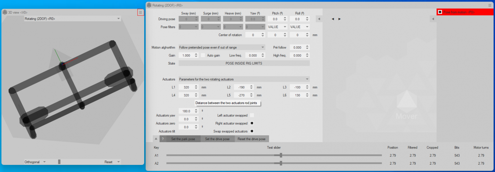

    I still don't see some controls even with scaling.
    Do you have any plan when you are going to update the Rotating 2DOF rig?
    Thanks.

  6. Andrey Av
    Andrey Av New Member
    Oct 10, 2025
    14
    75Coins
    Updated to 3.7.0.15, rotating 2DOF looks good now.
    Thank you so much!
  7. Andrey Av
    Oct 10, 2025
    14
    75Coins
    Hi.
    Noticed another small bug in 2DOF rotating rig.
    The L1/L4 tooltips say "distance between two crank/rod joints" but it really draws the distance from the ujoint zero plane to the crank/rod points (and I suspect it calculates that internally the same way).
    It does not cause any issue, I've just entered 0.5x value here.
    Also the Actuators yaw/zero/tilt value fields are shifted up a bit, but it is just a cosmetic issue.
  8. pmvcda
    pmvcda aka FlyPT
    Nov 3, 2010
    2,293
    Portugal
    16,028Coins
    +2,745 / 18 / -0
    Corrected for next release, L1 and L4 are the distance between rods. You need to change your setup on the next release (no 0.5x)
    sorry

  10. Andrey Av
    Oct 10, 2025
    14
    75Coins
    Hope I'm not annoying.. )
    Found another a bit more serious bug - the 2DOF rotating rig doesn't save several actuator-related settings:
    Independently on how you set states of these checkboxes and save as a local or a default setup - when you load your setup later they will be in this state.
    Unfortunately I need another state of them so I have to fix it each time I load my config.
    It would be also very good to include into the next release if it is possible, thank you in advance.

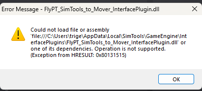

  11. Trigen
    Trigen Active Member
    Nov 25, 2018
    491
    2,892Coins
    +184 / 1 / -0
    2DOF, 3DOF, DC motor, Arduino
    Just came back from a year abroad and i had to reinstall due to some errors. I noticed FlyPT_SimTools_to_Mover_InterfacePlugin.dll dosent seem to work with simtools 2.6.1 Not a valid interface plugin. Looks to be the same on 2.5.1
    I need it for traction loss. Any quick fix for this and is a Simtools 3 interface plugin out there somewhere?
  12. Trigen
    Nov 25, 2018
    491
    2,892Coins
    +184 / 1 / -0
    I used chatgp to figure it out and i had to right click the dll choose properties and unblock it from a check box. Now its working as it should
    "That error means the FlyPT → SimTools interface DLL is incompatible or blocked.
    Most common causes: wrong SimTools version (v2.x vs plugin build), missing VC++ runtimes, or Windows blocking the DLL.
    Fix: install the exact plugin version for your SimTools build, install VC++ 2015–2022 x64, right-click the DLL → Properties → Unblock, then restart SimTools as admin."
