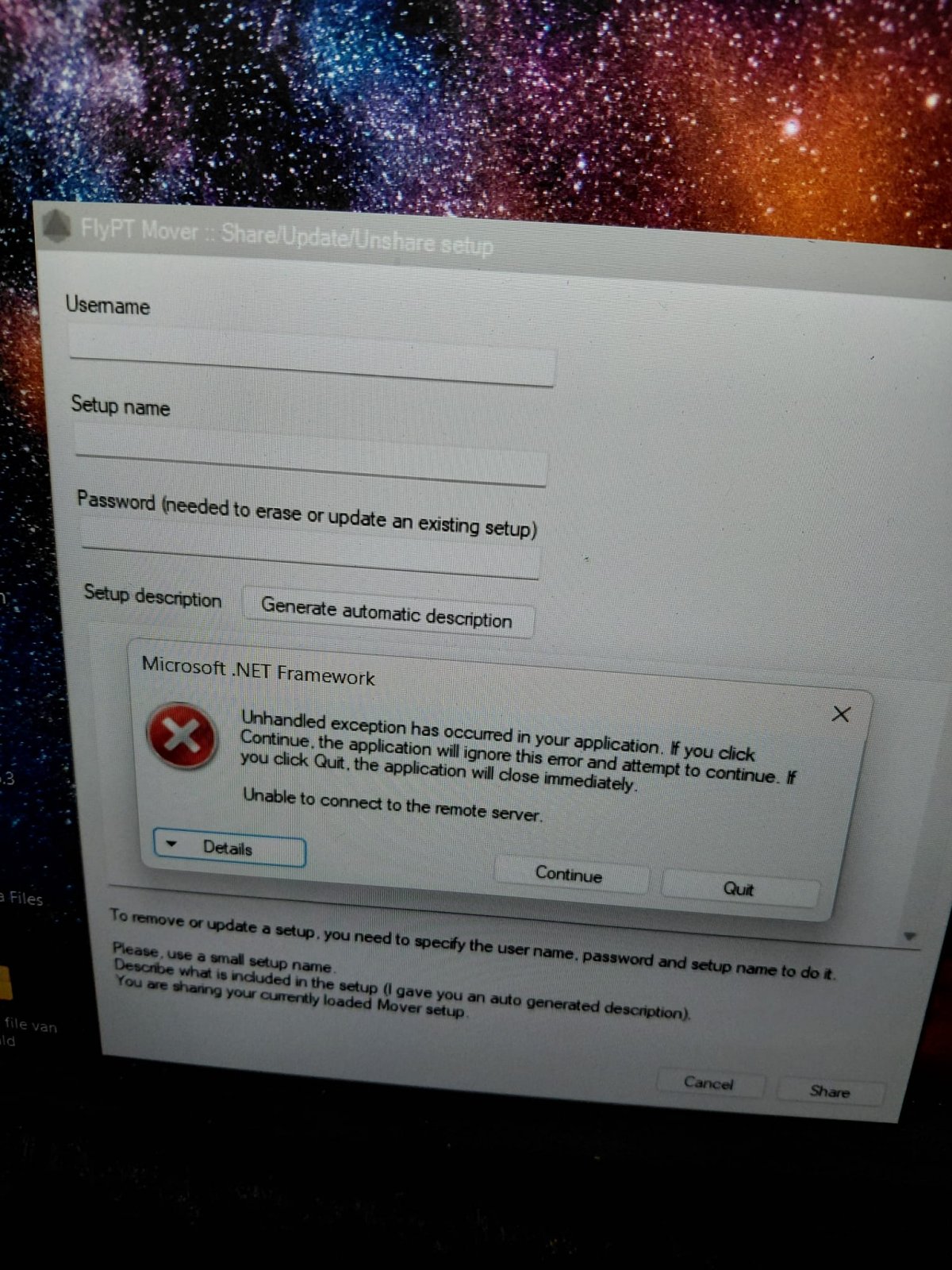

  4. Pietbrok85
    Pietbrok85 New Member
    Jan 16, 2025
    15
    Venlo
    53Coins
    Hello everyone, maybe someone can give me some usefull advice on next problem thx!
    FlyPTMover 3.5.3
    When starting the programm, a lot of times (not alway's) the error message: "unable to connect to remote server" (see att picture). (btw i did not select the menu share / unshare..., its comming automatically)
    When i ignore the message FlyPTmover seems to work all right, however i don't like ignoring error messages.
    Tried on a different pc, same result. Thanks for advice and kind regards, Piet

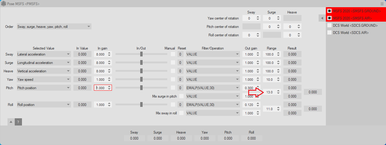

  5. Andrey Av
    Andrey Av New Member
    Oct 10, 2025
    14
    75Coins
    Hi.
    I found that for a pose it is possible to set a fractional number as a range, and it looks being accepted, but when I save the config and then trying to load that - it says that the fractional number is not acceptable.
    Is it a known bug?
  6. Tean33
    Tean33 Member
    Jan 12, 2023
    39
    255Coins
    +17 / 0 / -0
    @Andrey Av From your screenshot it looks like your using version 3.7. You'd be better to ask in the thread for that version.
