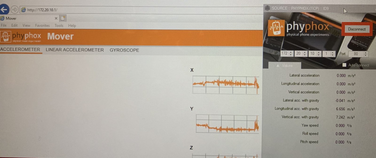

    Which one you need ?
    On local network I have 192.168.1.111 on iPhone hotspot I have 172.20.10.1

    Try this:
    Replace with your IP's
    One of them should work.
    If you have PhyPhox started and capturing data you should see the following when you refresh the page:
    That's the text I need.

    Only accelerations...
    Are you sure you checked the other options?

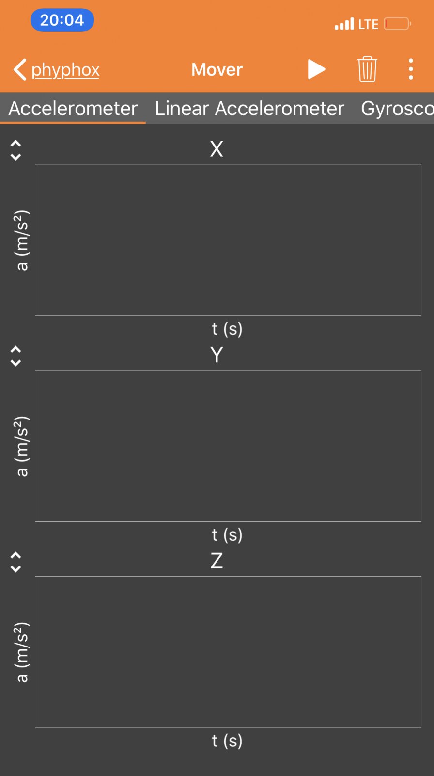

    You see this in the iphone screenshot I posted above.
    All three are there. Not on the same screen but when I swap I can see them
    Strange

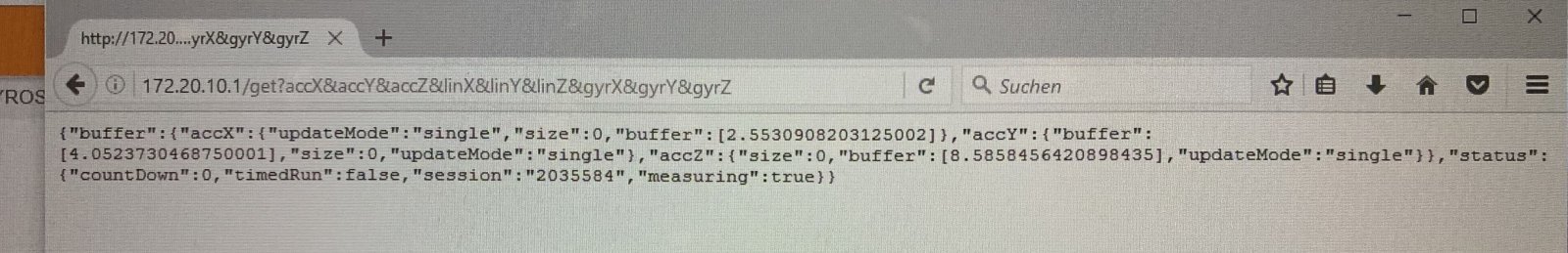

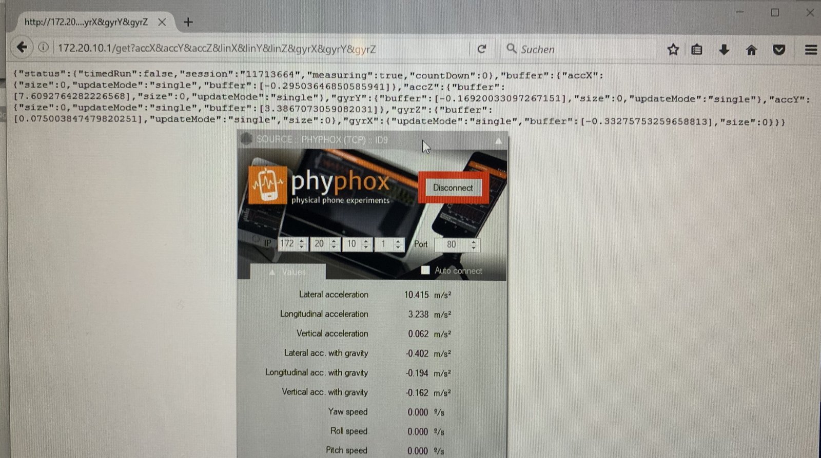

    Seems the phone is not sending all info.
    I get the info from that text.
    Try with your home network IP

    Indeed it seems that even if you select internally in the phone (add simple experiment) several sensors, - only the first is going through.
    I have a 6dof experiment with two sensors on the same screen (loaded from xml file) and I am getting 6 variables from it (gyro and accel with g).
    They’re assigned wrongly in the plugin.

    The problem here is that I don't look at the code searching for the string.
    The order is always what I show here:
    "accX":{"size":0,"updateMode":"single", "buffer":[-3.1713596E-1]},
    "accY":{"size":0,"updateMode":"single", "buffer":[9.4173527E-1]},
    "accZ":{"size":0,"updateMode":"single", "buffer":[9.6670103E0]},
    "linX":{"size":0,"updateMode":"single", "buffer":[-4.3199997E-2]},
    "linY":{"size":0,"updateMode":"single", "buffer":[-3.09E-2]},
    "linZ":{"size":0,"updateMode":"single", "buffer":[-1.067E-1]},
    "gyrX":{"size":0,"updateMode":"single", "buffer":[2.4958209E-3]},
    "gyrY":{"size":0,"updateMode":"single", "buffer":[-8.37758E-3]},
    "gyrZ":{"size":0,"updateMode":"single", "buffer":[-1.2217305E-3]}
    Gyro are the 3 last lines
    Since your phone is not sending the linX y and z, it puts gyro in the wrong line
    And my code just grabs the line and removes the value from there (it's always in the same place, so code is faster)

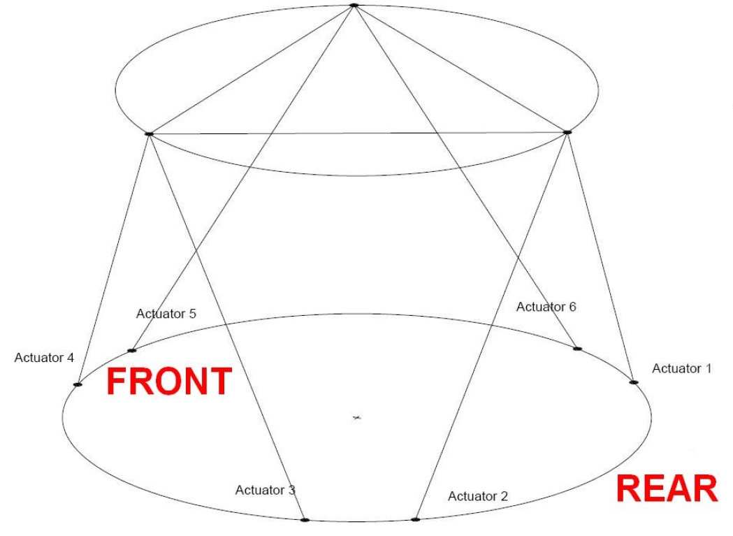

    Hi @pmvcda
    Now it would be a good time to consider adding a proper AMC serial interface plugin. Perhaps a modified Serial module that has preset all except the Com port and the 2ms delay?
    Also the current string axis order has to somehow adjusted for 6DOF automatically to reduce the confusion on the AMC users as all other software is using a standard order for actuator order for the 6DOF platforms. Here is what I have to enter so you have the correct order on the AMC controller:
    <255><255><Axis3a><Axis4a><Axis5a><Axis6a><Axis1a><Axis2a><0><0><0><0><10><13>
    Here is a quick demonstration of the AMC-AASD15A controller connected to the FlyPT Mover 2.3:
    For 4DOF doesn't really matter as its easier, but perhaps its a good idea to keep same numbering (not sure if the following string is correct numbered):
    <255><255><Axis1a><Axis2a><Axis3a><Axis4a><0><0><0><0><0><0><0><0><10><13>

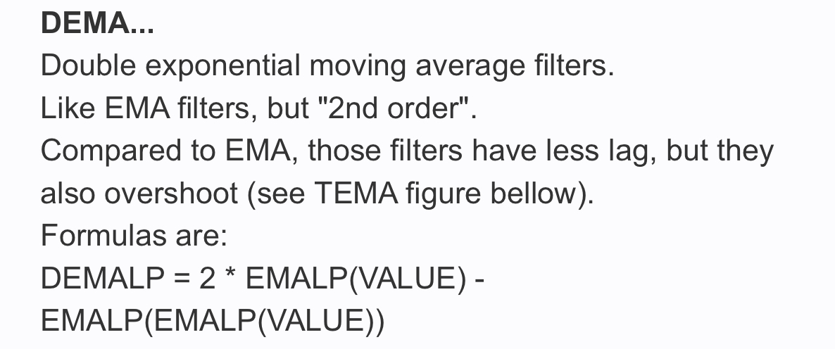

    Maybe I could also interfere in your tutorial.
    For better pedagogy, I think it could be helpful not to mix up the filter ordering with double triple approach, and NOT to call DEMA - “EMAf filters, but “2nd order””.
    To my understanding, the ordering (superposing in different stages) has nothing to do with DEMA or TEMA math. Especially the entry curve are very much different and might be useful in different scenarios.
    https://www.norwegiancreations.com/...al-moving-average-filter-speeding-up-the-ema/
    Now, from what I am reading in your very well done tutorial, the user could easily mix up TEMA filter with EMA of triple order. (Same for DEMA)
    It might be useful we agree on the terminology we use in order to avoid confusion and communication issues.
    So again, DEMA is a first order filtering unless you start to superpose it in cascade in Mover.
    Are you agree ?
