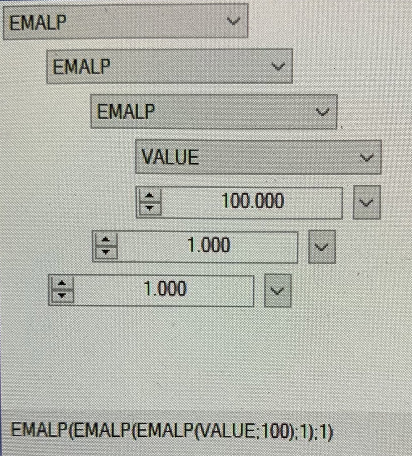

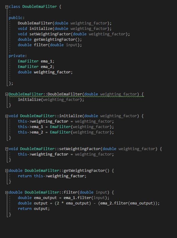

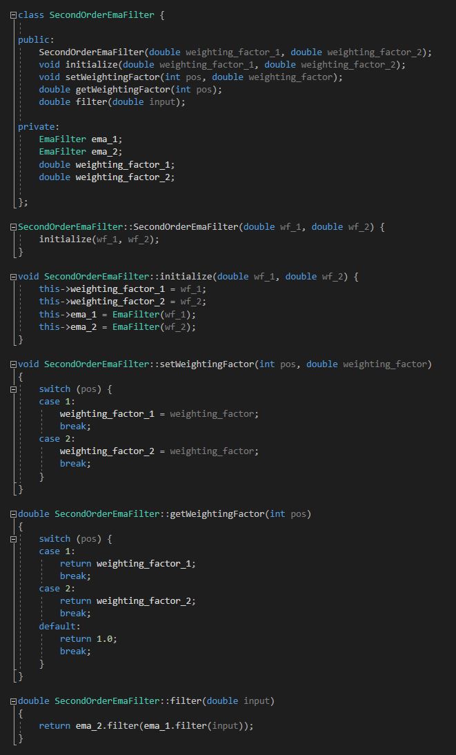

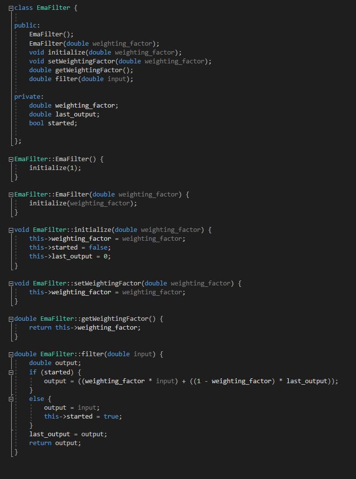

    for comparison here 3 classes in c++ of ema, dema, and second order ema:
    // Low pass filter using an exponential moving average approach.
    Specify a weighting factor, then get filtered values calling filter().
    The weighting factor determines how strongly the last input value affects the output. 1 = no filtering. Decreasing below 1 increases the filter amount.
    //Low pass filter using a double exponential moving average approach:
    DEMA = 2 * EMA - EMA(EMA)
    Specify a weighting factor used by the two EMA functions, then get filtered values calling filter().
    // Low pass filter using a "second order" exponential moving average approach (EMA of EMA).
    Specify weighting factors used by the two EMA functions, then get filtered values calling filter().
    The weighting factors are applied in order, so the first weighting factor is used by the EMA filter that is applied to the input first.

    Re EDITED:
    This IS the correct way to construct the third order in Mover !

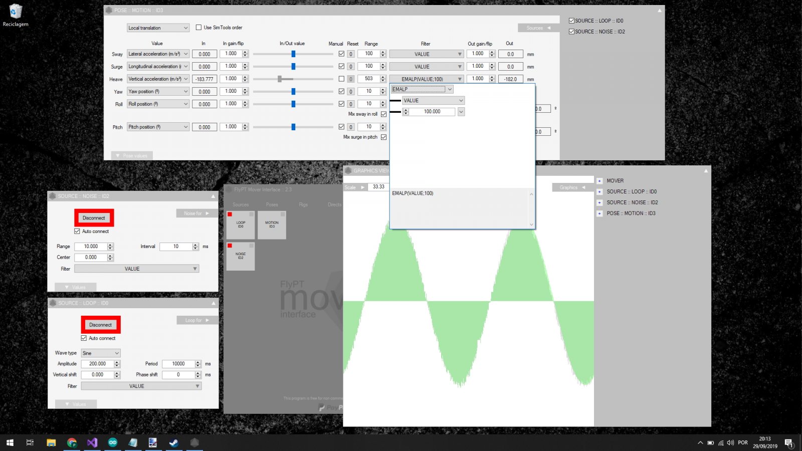

    Well, I definietly have to slow down my fingers and speed up my brain.
    I increased the graph horizontal scaling to 20 and reduced the weighting factor to 3x500 in Mover.
    Your solution seems to work perfectly.
    One has keep in mind that the weighting factor in mover have a values ten times bigger for similar behaviour in comparison to hexapod.

    Are you sure that you enabled shared memory in pcars and are using the MMF source
    I will test later

    No problem,

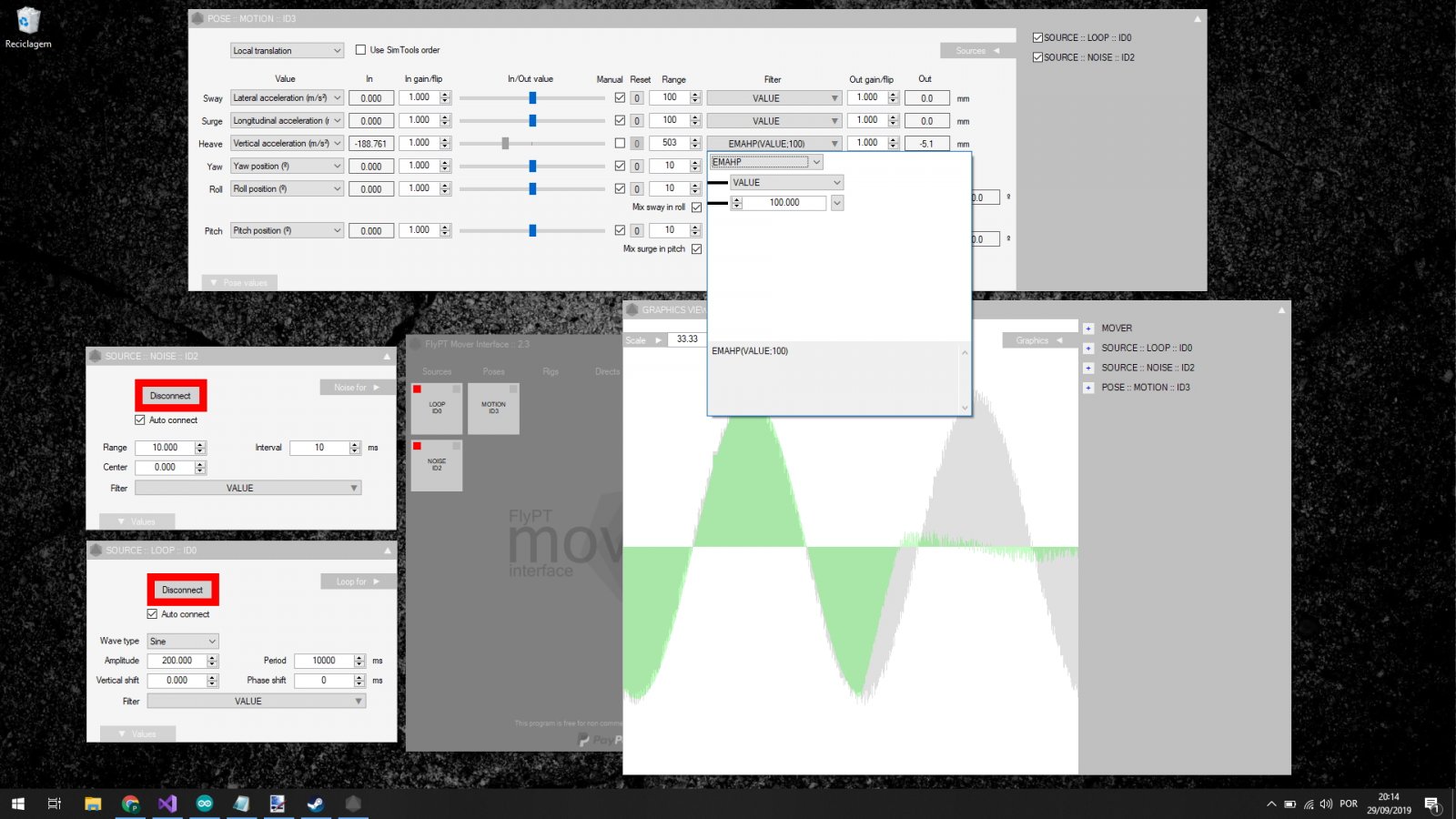

    In mover loops run at 2ms, soe each sample for the filter is taken at that speed.
    The parameter you insert in the filter is the number of samples
    In the old program, loops where at least 16ms, usually more.
    So the effect of the filter is not the same
    Try to put 16ms in the Mover calculation loop to compare

    @hexpod,
    Because of the above, I added decimal places to the number of samples
    2ms in Mover is1000 samples in 2 seconds
    In old program @16ms you get 125 samples

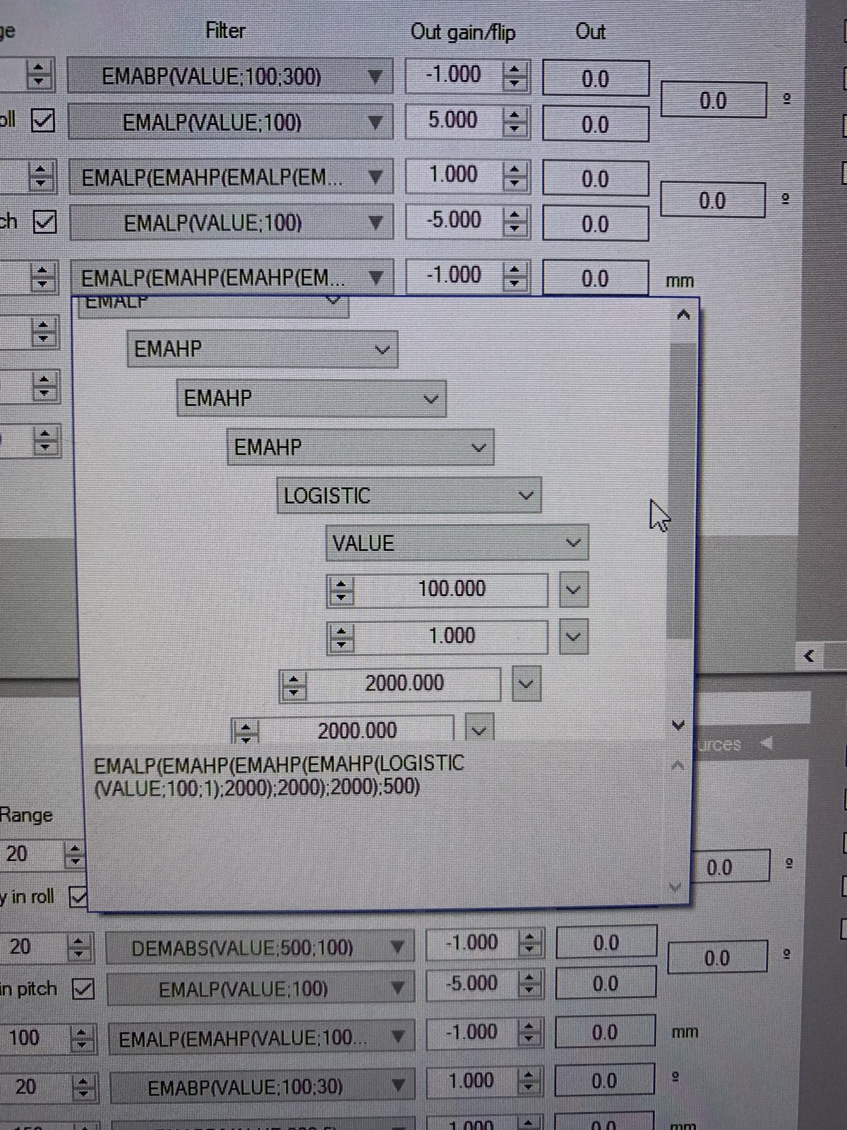

    Btw. The following screenshot is a very plausible scenario. I am a bit blind which value correspond to which filter. Maybe slightly longer window and eventually tags : it could be numbers right next or inside select boxes. Whatever.. Just something more readable to know which is which
    Btw. Loop feature is very cool.

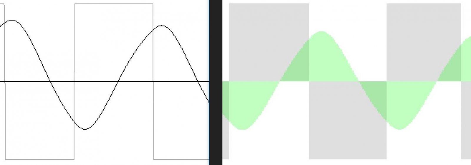

  13. pmvcda
    pmvcda aka FlyPT
    Nov 3, 2010
    2,292
    Portugal
    16,022Coins
    +2,744 / 18 / -0
    I already tested. Need to see, there's something wrong.
  14. pmvcda
    pmvcda aka FlyPT
    Nov 3, 2010
    2,292
    Portugal
    16,022Coins
    +2,744 / 18 / -0
    @hexpod,
    I got filter transition working.
    Each time we change the filter, the defined transition time is used to change from the old filter to the new one:
    Graphic of a low pass
    Now changing to high pass
    Transition in 2 seconds, we can see the progression, it's not a vertical line.
    But needs some more work, I don't want the filter to make transitions when we change the number of samples, only when we change the type.
    Also solved some other small bugs.

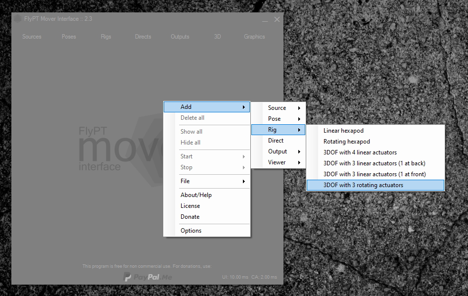

    @gianlu320, Don't be sorry,
    I have to explain it better.
    Since English is not my main language, I have some problems passing the info.
    You are the first with this kind of rig in Mover.
    So you are now an official tester! :p

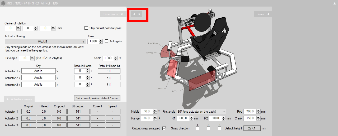

    So first let's setup your rig.
    Open the menu and delete all modules, the add the rig:
    Now open the rig and in your case, I think you have two actuators at the front (one at the back), so select 60º in the position of the first actuator:
    The green represents the front of the rig.
    There's no yaw for this rig, but we can use it also.
    But for now, let's start with this...

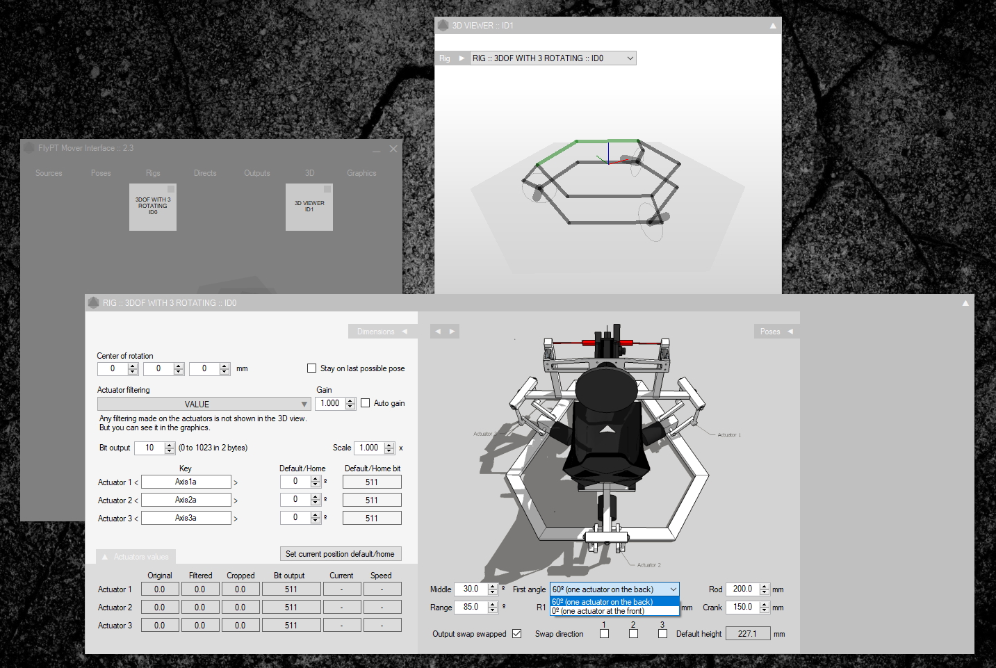

    @gianlu320 ,
    Now we need some measures:
    Use the marked arrows to see the images that show what measures you need on the rig.
    Try to be precise, 1 or 2mm difference is no problem, but ideally use exact dimensions.
    I also need the config you use in simtools to connect with the rig.
    Can you get a screenshot? Would be great to share with others.

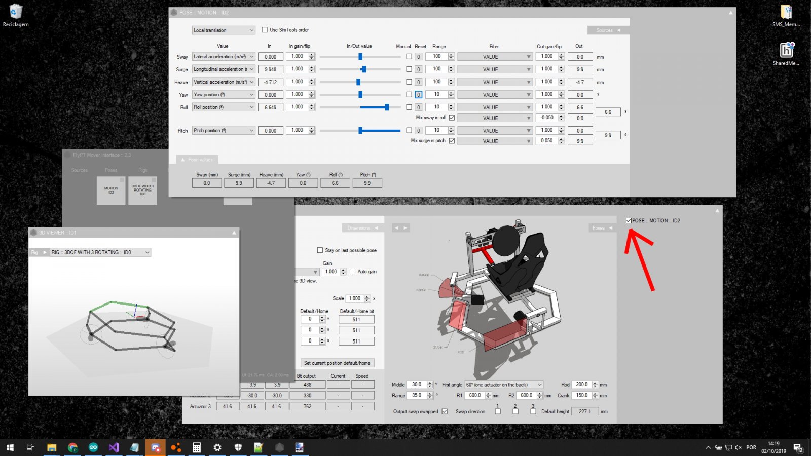

    You can also add a 3D viewer to see the rig.
    Add also a pose from motion.
    This is the filtering system that converts the pose received from the games to the pose we have in the rig:
    See the arrow?
    To use that pose in the rig, you have to check it in the rig. You are saying to apply that pose to the rig.
    You can also have other poses. They can be generated from suspension of cars, engine vibration and others...
    They all appear in the rig list, but the rig uses only the checked ones. Their effect is added.
    So if you have pose from motion + pose from engine rpm, both are added and the rig motion is the result of the two.
