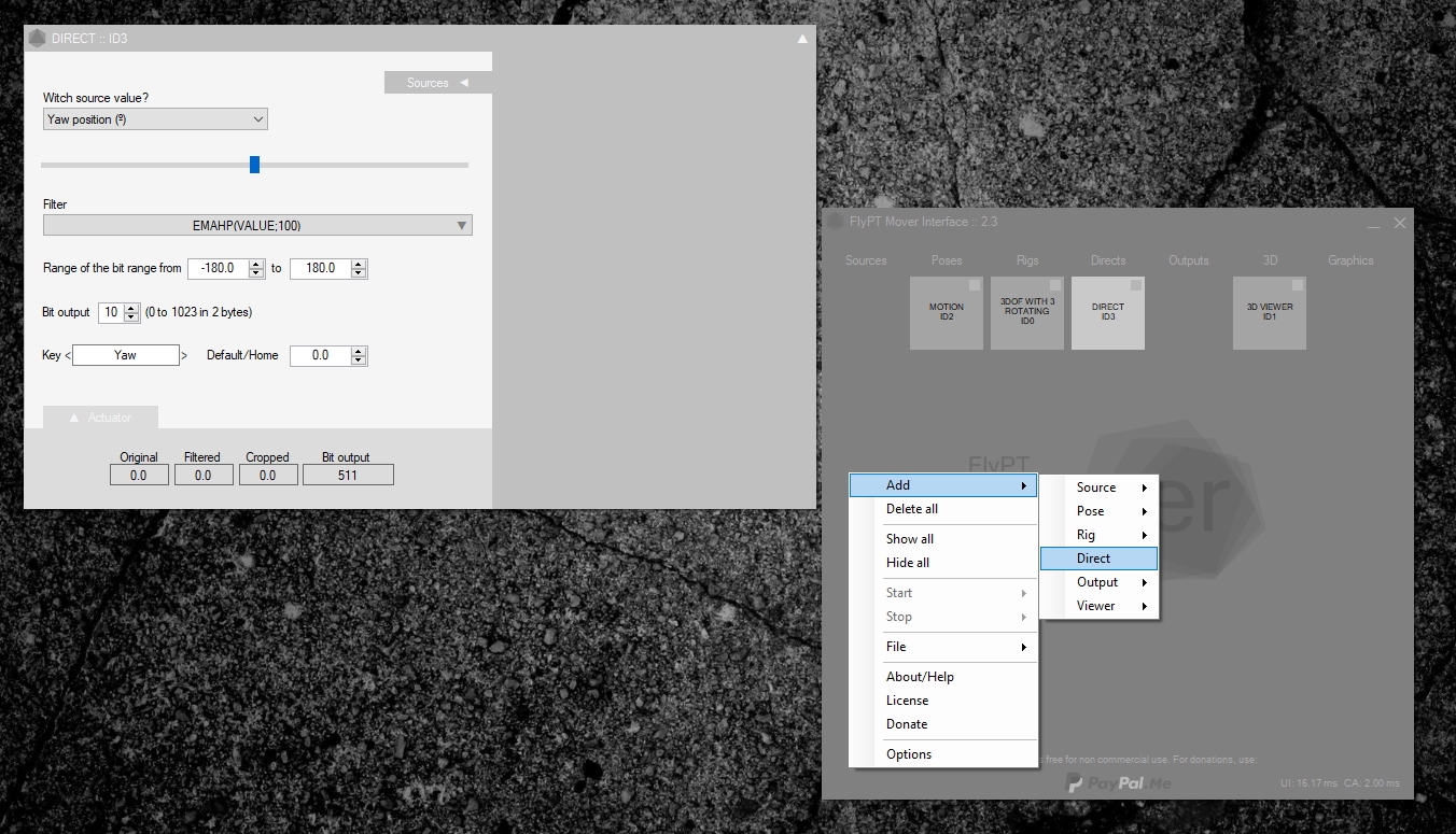

    Can your rig do multiple turns in yaw or is it limited to a maximum number of turns/degrees?
    To use yaw, you have to use what I call a direct: Sem nome.jpg
    What we want is to generate an actuator (axis in simtools) that represents yaw.
    So we select as a source value, "yaw position" (--> LOOK DOWN IN THE TEXT, MIGHT BE BETTER ACCELERATION) that's where we are pointing. Now this depends on what behaviour you want. This could be just acceleration.
    But if you can turn anywhere, using position is a 1:1 match to what the game sends.
    In the range, we define the minimum/maximum value we are using. This needs more explanation, but to start, maybe try this.
    In bit output, we use the number of bits you receive in your rig for that actuator.
    In this rig it should be the same you have in the rig definition/output from SimTools.
    We also define the string that represents the actuator. In this case I called it Yaw.
    ATTENTION! There are holes in this. If you are at 180º and the game sends you at -180 to make a complete turn, what you see above is going to make the rig rotate to the other side at full speed.
    So be careful. Never tried this situation and I don't know the rig and it's limitations.
    Might be better to stay with accelerations instead of position

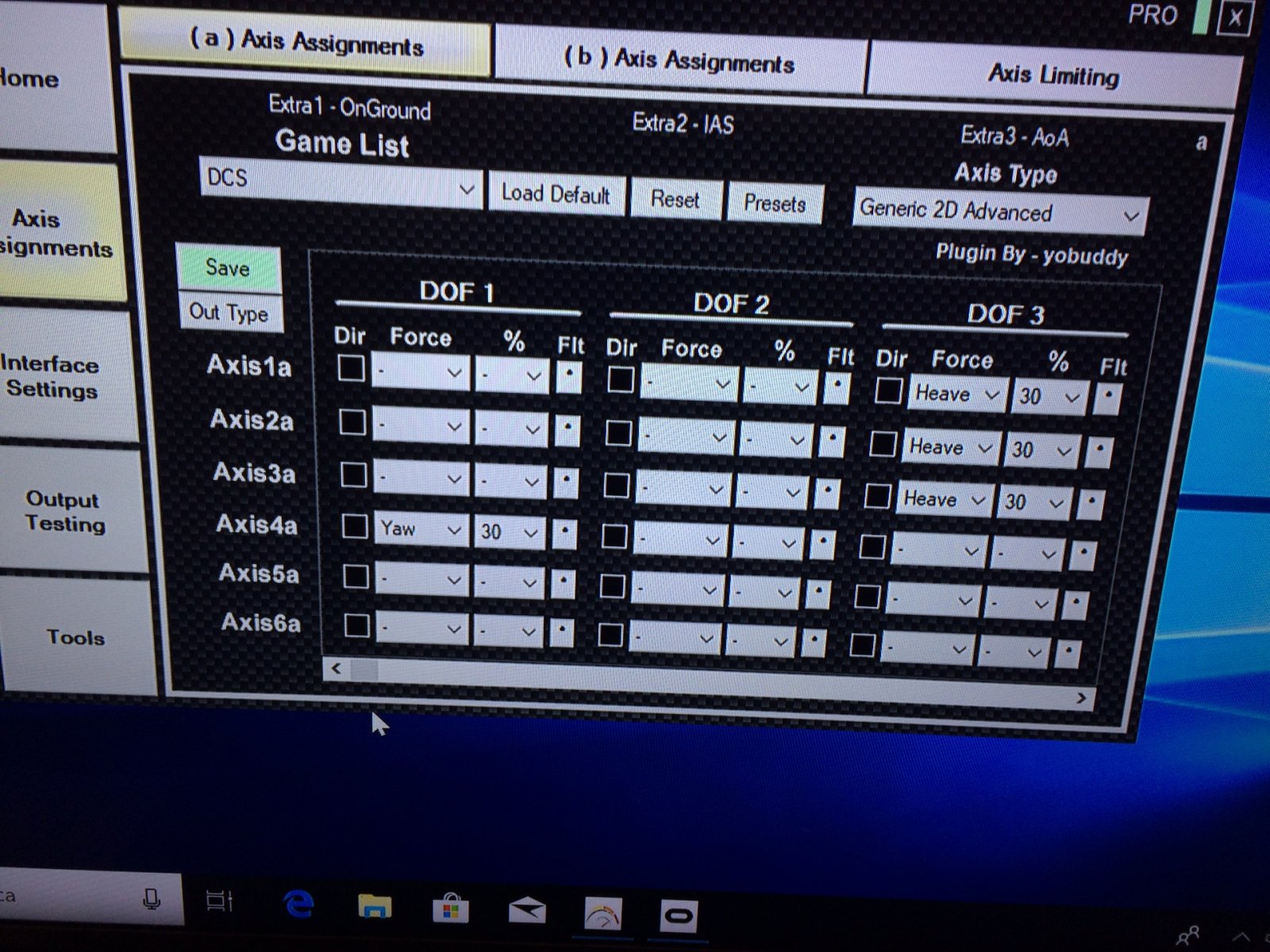

    Thanks for all the explanations
    So first of all , yes my rig is a racing cube
    for what regards yaw I think it can do multiple turns but limited to two maximum turns. (720 degrees) but I'm not sure because I've never tried it and I've always limited yaw just to few degrees left and right due to space available in the room where the rig is.
    For what regards precise measurements of range, rods etc it will take me a while because everything is enclosed so I need to unbuild everything and lift the base or as an alternative I can send an email to the factory and ask for this data.
    This second option would be better so I don't have to disassemble everything.

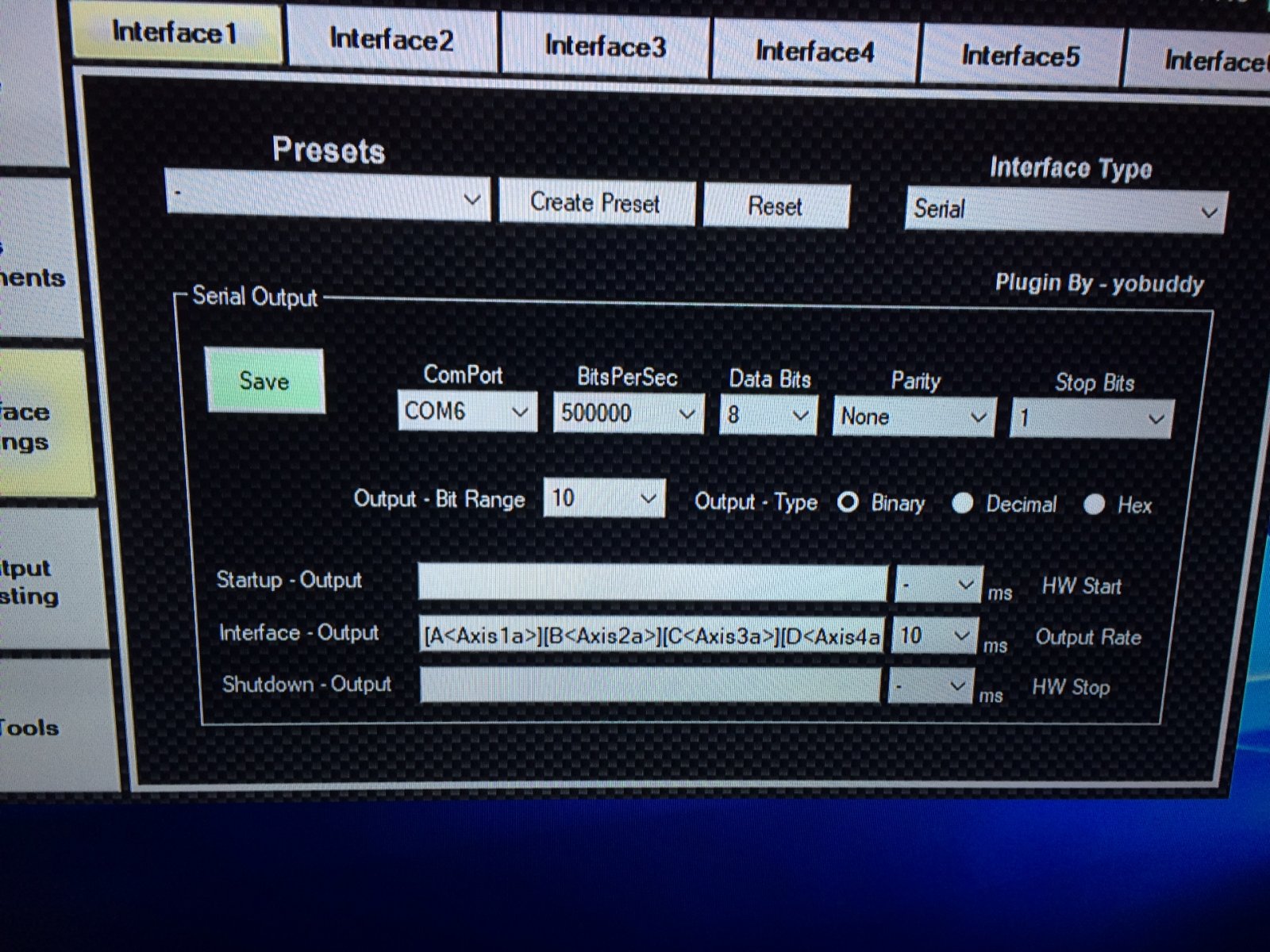

    This is how my rig is setup in simtools interface wise
    It uses only Interface N1 (racing cube V3) so this is it configuration wise.

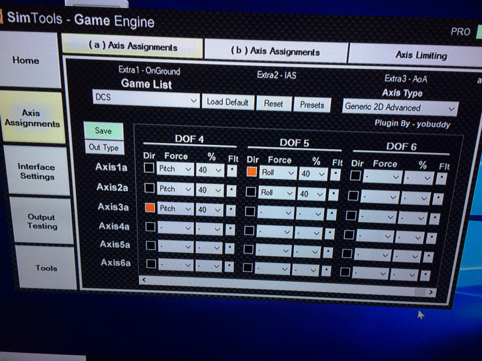

    For what regards my Simtools DOF settings here they are:

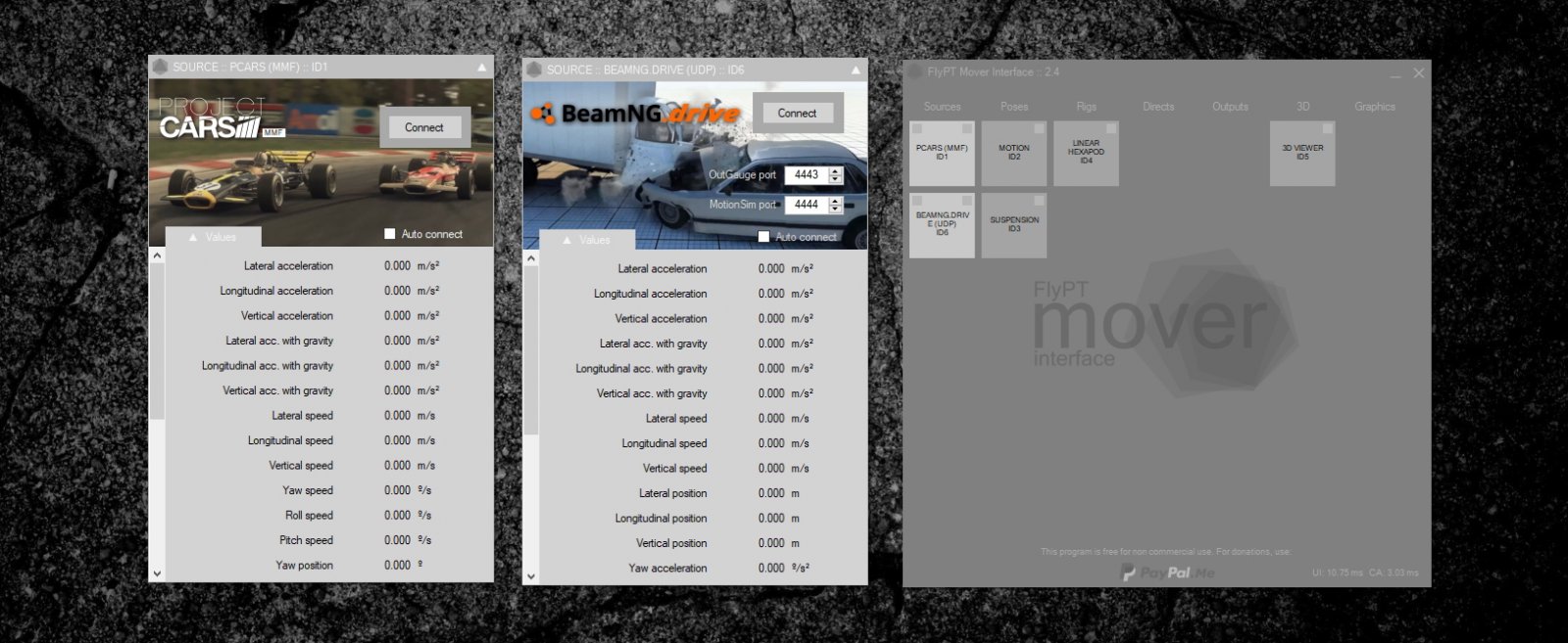

    FlyPT Mover 2.4
    Download in first post of the topic!
    Old files generated by Mover 2.3 might not be compatible! (depends on modules used)
    What's new/changed:
    - Solved bug that started Mover always in high precision calculation rate.
    - Changed calculation of Logistic filter. Better fit to the original signal.
    - Solved bug in directs module. Filter was not updated when changing the range.
    - Added BeamNG.drive source.
    To setup BeamNG, open BeamNG Options -> Other
    Then check the boxes for OutGauge support and MotionSim enable.
    In the OutGauge port select 4443
    In the MotionSim Port select 4444
    You can select others, but those are the default in Mover. If you want others, the you have to change the ports in Mover.
    Lower the update rate to the minimum. Same for accelerations smoothing. You can use just the Mover filters.
    There's an example file with a setup for BeamNG. Not tested with a chair. Just to give an idea of setup.
    - New soft transition between filter changes.
    When we change the filter, for a defined period of time (adjustable in the main menu -> options), the filter transitions from last setup to the new setup.
    This is now implemented in all Mover filters.
    - Added Project CARS source (PCARS1)
    Uses height of tyre in place of suspension travel inside the suspension module.
    Use a EMAHP(VALUE;1000) filter to move the displacement to the center and grab most of the variations.
    - Added ports configuration to DCS sources.
    - Added suspension info to XPlane - Add item #63 in the outputs of XPlane11
    You get the suspension load as a suspension acceleration on the 4 wheels of "cars".
    So now we can use the pose from suspension module with XPlane.
    Since all 4 wheels have the same load/position, the result is only heave.
    I recommend the use of a EMAHP(VALUE;2000) on the suspension module.
    Look for the XPlane11 sample setup in the examples folder.
    - Reworked low speed filter while in ground for XPlane.
    Now the filter executes transition from low to high speed.

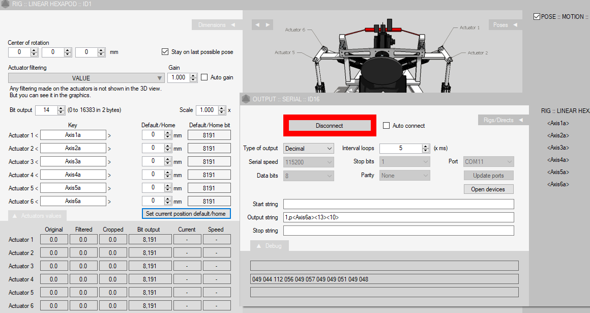

    Im having trouble connecting with the serial.
    I have verified I can send this string by other terminal programs with same settings.
    Could it be that the line feed and carriage return commands are not setup in your output?
    I could easily be wrong here, not sure how serial commands stuiff works.

    Did it work on the old program? (EDIT: Yes I saw your comments in another post)
    I see a bug there. instead of converting <13><10> to CR LF chars, it's generating the chars "1310".
    That's an error in the decimal string generation. I have to solve it.
    Sorry.
    I will upload a new version as soon as I can.
    EDIT: I noticed also that you where using 15 bits before, and now you have 14 in the rig.
