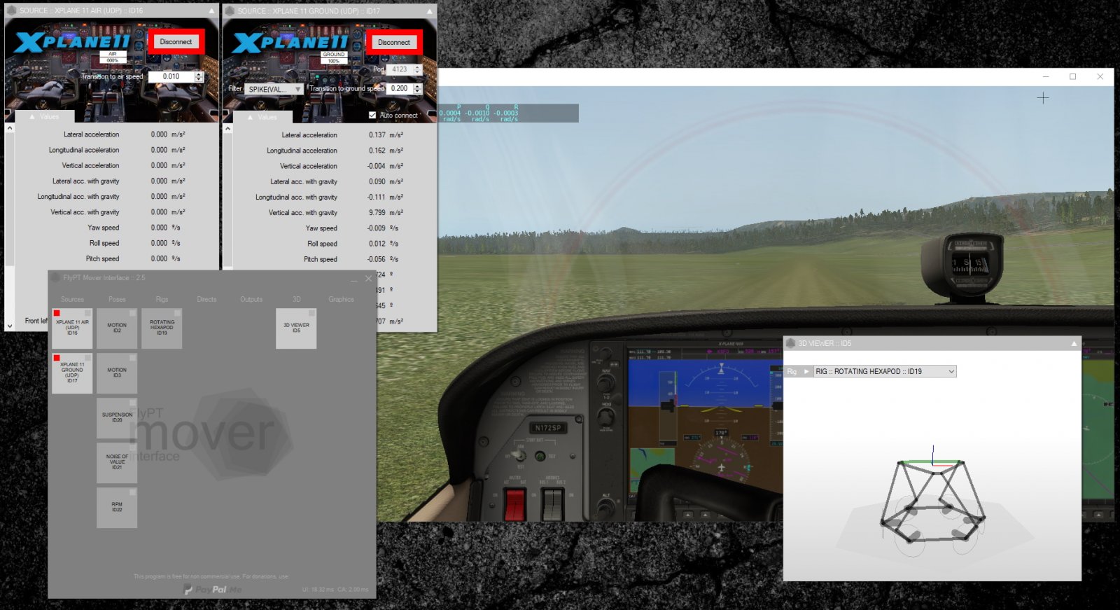

    FlyPT Mover 2.5
    New build for download in the first post of the topic.
    What changed:
    -Solved bug in serial output, that did not allow to send CR and LF in the proper way (decimal output). @JAD please make a test.
    -Removed old files from old filter system.
    For XPlane11:
    -Cleaned XPlane11 source.
    -Just one click to open and close both sources (air and ground).
    -Transition between both states with user defined speed for each direction.
    -Filter for accelerations in ground source. Allows testing with filters, but predefined filter seems to work(at least on the graphics since I could not test in the rig)

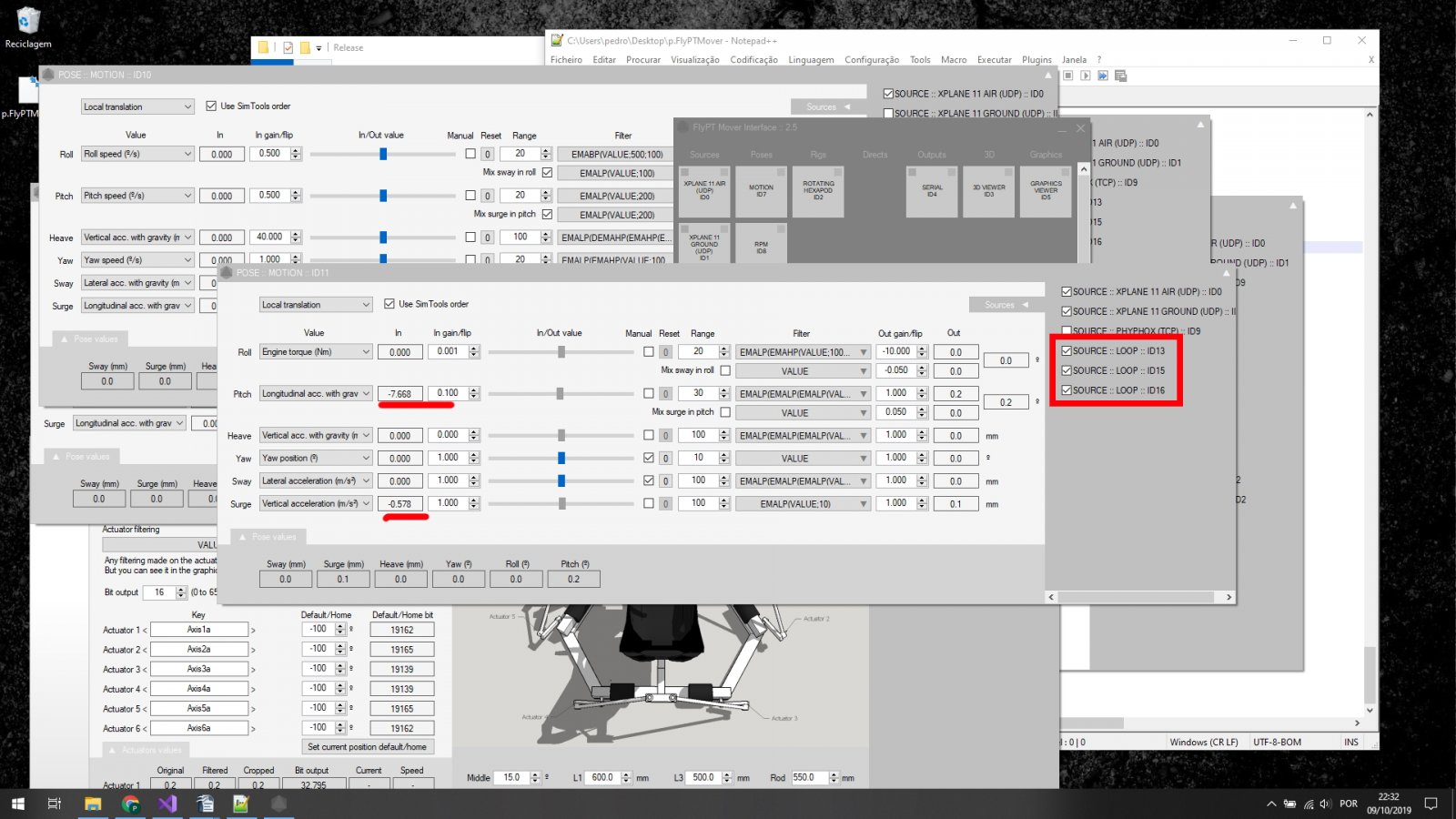

    You are using 3 poses from motion. They might cause interference.
    But I can't open the file.... that's strange. There's a bug somewhere, that doesn't allow me to open the file o_O
    I see that you use in the rig those 3 poses from motion. One from air, one from ground and one with both and the loops.
  20. pmvcda
    pmvcda aka FlyPT
    Nov 3, 2010
    2,296
    Portugal
    16,036Coins
    +2,746 / 18 / -0
    @hexpod ,
    I opened the file.
    You are using an huge resolution for my laptop... All windows out of range.
    But here:
    You have loops generating values on the pose that is used in the rig.
