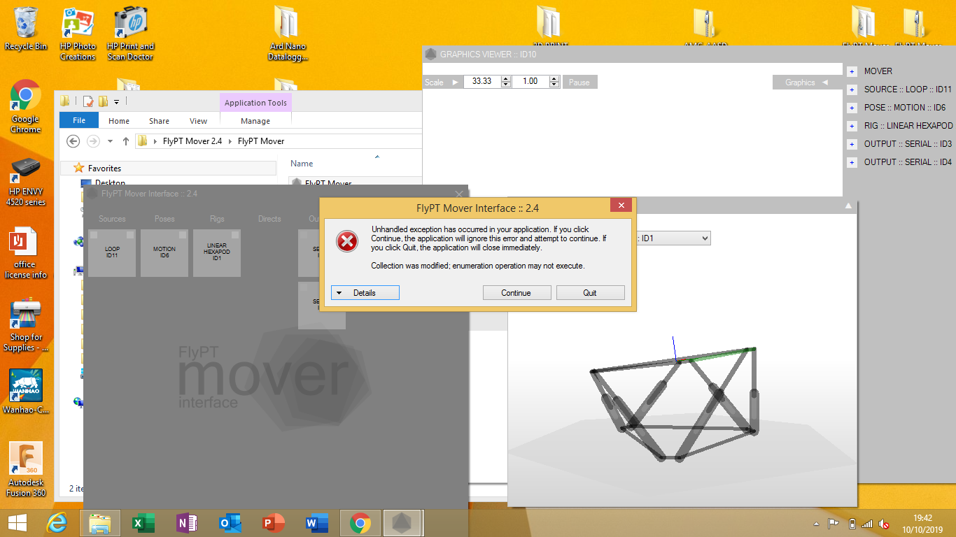

    Hi @pmvcda sorry for asking this , been trying to get to grips with Mover and was making progress , now all of a sudden whenever i try to open saved setup File i get this error message , Tried reloading form original Zip files to overwrite any corrupt files but now i get this message any time i try to open a saved file :-( what have i broken LOL still cant gett this PC to connect serial @250000 Baud but again thats most probably wrong setting on my part as everyone else's version ove Mover works fine ..

    Ouch!
    Sorry. Try the new version 2.5 (might not solve the problem).
    Seems to be some problems there. It's not corrupt files, it's when Mover tries to close all modules that where open (I think).
    Also, not all files are compatible between versions!
    Edit: Where you trying a downloaded file or XPlane?

    Hi @pmvcda thanks for rapid reply, iwas trying to reload a previously saved xx,Mover file , had it all working and so was saving each experiment as it were so id have a fall back .
    i have several versions of Mover on this PC ( im a info hoarder :) ) all in separate folders etc so did not think there would be any conflict ..
    would it be better to loose all the previous versions and just keep latest V2.5 on the system ? loving the program jsut want to get to next test stage with AMC-AASD15A controller Communication ...

    Please, go always with the latest build unless specified on the download post.
    This is always WIP. I'm working on the files to make them the more compatible possible.
    The next build (2.6) is going to have some more security in this area.
    And might open the older files, at least in part (2.5 already has some workarounds).
    So use latest build and keep the files to try open them in the next build.

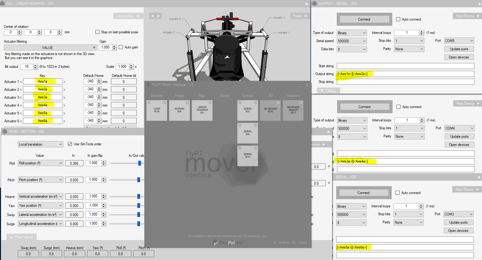

    First I like to thank you @pmvcda for the amazing work you're doing with this peice of software.
    I tried to implement MOVER into my 6DOF linear hexapod platform, for each actuator I am using a 24Volt/300 wats DC motors, every 2 motors are controlled by one 2x32 Sabertooth, the sabertooth is interfaced with an arduino, this is done as per @BlazinH original post on this forum:
    https://www.xsimulator.net/communit...ket-serial-pid-motor-driver-w-softstart.9277/
    So overall I have 3 arduinos (1 for evry two actuators) that I need to control by MOVER over serial conection
    When I went through the setup I got to a point where in theory I should be able to get the platform to move (I used loop source for testing), but I was unable to get it to work, see in the screenshot below the settings I have, I tried to write the output string in ultiple ways with no good results, When I click on conect in all three output modules it shows as being connected, but when I start the loop nothing happens. Can any one take a look and give me an advice on what to do.
    Thanks again, you guys are the best.

    I think you have the serial wrong.
    You could try the file I made for @Pierre Lalancette :
    https://www.xsimulator.net/community/threads/6-dof-from-scratch.9409/page-35#post-185967
    I think he's using the same setup.
    Before opening a file, version 2.5 has a bug, you need to delete all before opening the file, or rename it to lastsetup.Flyptmover and put it in the Mover executable folder.
    Don't forget to change the rig dimensions and com ports.

    Those are my serial setting. They work with my arduinos and sabertooths.

    Thanks, I'll try it and let you know how it goes.

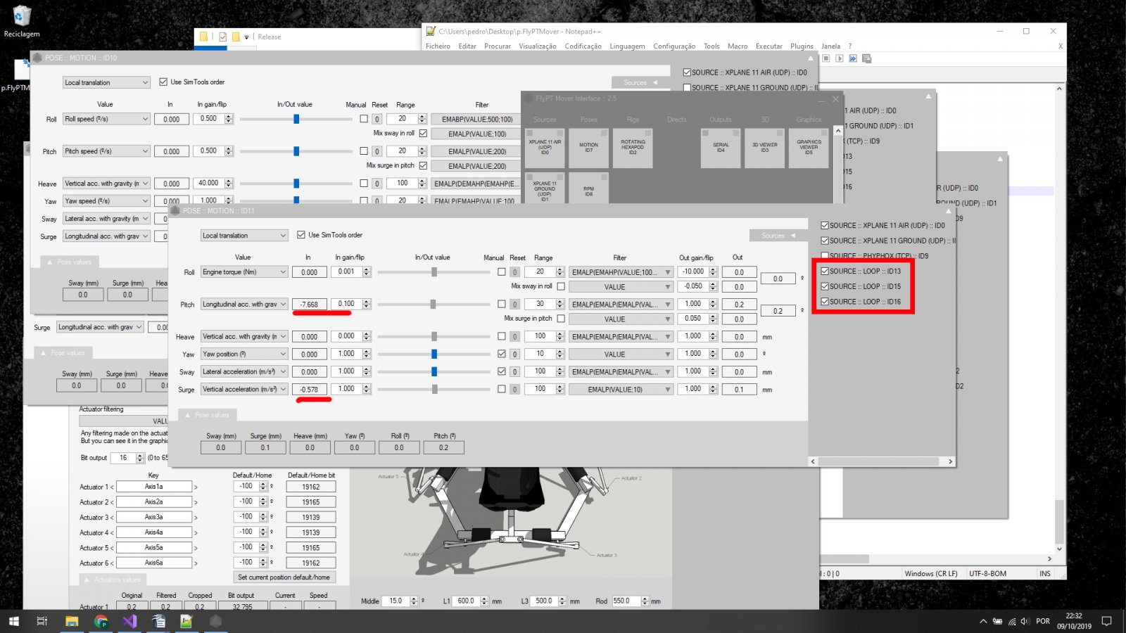

    How to assign for one axis two game effects. For exemple I would like to add for roll , the roll world inclinaiason and roll speed ?
    I know that the values aren't not the same , degres and m/s .
    Maybe it's not necessary but as you developed the software you know what is possible or not
    Édit : to give an exemple i think to a bump on a race Track . If you take the roll car orientation, not sure you have the information.If you have the roll speed or roll acceleration from the car you will have the information .You use the roll speed or acceleration to tilt the sim rig like the real feeling .
    Edit 1 : is it possible to add source using pose noise and select roll speed for exemple . The problem is how to assign this just for one axis (roll ) and not all 6 dof axis ?

    Something is not right, I can move each actuator from SMC3 manually, but I can't move them from MOVER even when I use the setup file that @pmvcda pointed me to.
    I'm stuck here and can't think of anything to do.

    Have you tried Hexapod, the ancestor of mover? Just to see if you can get it moving with it.
    Sorry, I have no other idea for now.

    You need to create two motion windows
    I believe that’s the way to mix different sources on same axis
