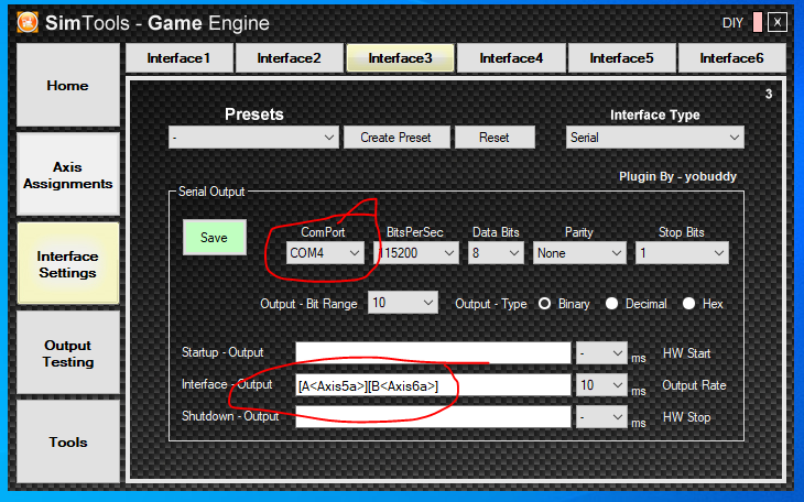

    If I'm right here Simtool Output testing can only be evaluated by whether the motors move or not when I move the sliders, but that does not happen.
    22,202
    154,675Coins
    +11,209 / 57 / -2
    Do you have a Default Profile configured, as that is what Output Testing uses?
    And try the Baud rate at 500000 in the Interface Settings.

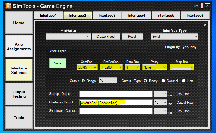

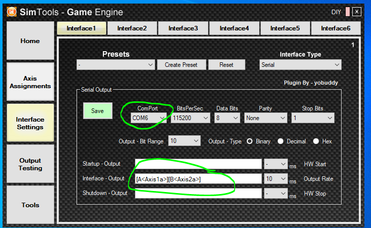

    Can you guide me more on the defualt profile, I'm not sure I got that.
    As for the baud rate I tired both 500000 and 115200, the reason for testing with 115200 was to match the sabertooth baud rate, it was one of many trials.
    22,202
    154,675Coins
    +11,209 / 57 / -2
    In that case pin 8 to Gnd changes Baud from 500000 to 115200: https://www.xsimulator.net/communit...ket-serial-pid-motor-driver-w-softstart.9277/
    In the Axis Assignments tab of the SimTools Game Engine you can allocate axis % to the Default profile then save it: https://www.xsimulator.net/community/threads/official-simtools-user-manual.12424/

    @pmvcda & @noorbeast I have good news here, I found the problem and got it fixed, it turns out that I was using the the windows utility for tuning the PID in an incorrect way. In simple words I thought the utility is only to drive motors manually till you find the right values, but in reality it turns out it will re-write those values simultaneously to the arduino EPROM, so what I was doing at the end of each calibration session I was droping the power down to 0 to stop the motor and move to do something else, this means I was basically telling the arduino to use zero power to drive the motors.
    Next I will do some final adjustments and see how it goes...... but I have both MOVER and Simtool working now.

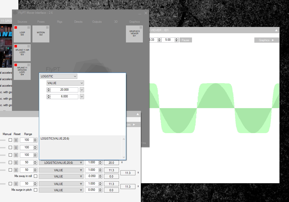

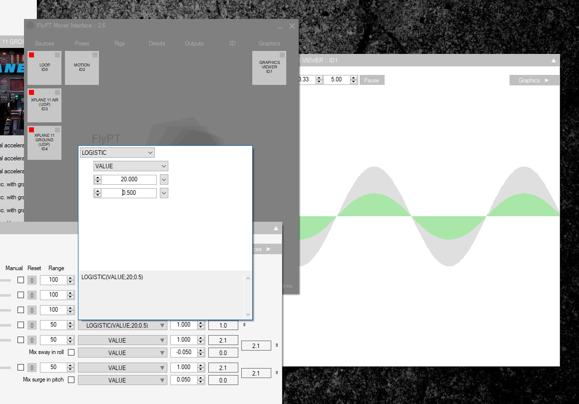

    Changes/Fixes:
    - Corrected the logistic filter again. It was bugged on the last build.
    So now, we specify the maximum value and how "fast" it goes to that value.
    Setting an "how fast" of 1.0, is the fastest possible, without getting results above the input (see above image)
    Bellow 1.0, goes slower:
    Above, works like a gain, climbs fast, but it's limited to the maximum range:

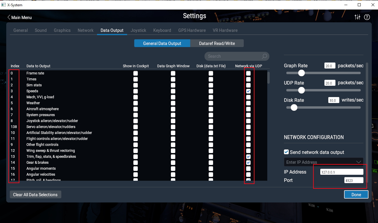

    Instructions to setup XPlane11 for Mover 2.6:
    In Xplane, you need to select what you want to send through the UDP port:
    In the left, you have the numbers to identify the info, in the right column, check the ones you want to use. And you should check:
    #3
    #13
    #14
    #17
    #36
    #37
    #63
    #66
    #67
    #127
    #135
    In the IP, keep 127.0.0.1 if Mover runs in the same PC, else, insert here the IP of the PC where you have Mover.
    The port, should match the one used in Mover. Be careful here, XPlane has many 3rd party applications, be sure the port is not in use by another application.

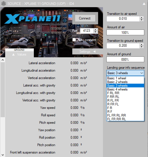

    Looking at the source, we can see two fields with the amount of each source used on the transitions (%). They are yellow when the transition is occurring.
    Landing gear option is a way to specify the type of landing gear.
    This is used to generate a pose from suspension.
    The options are the sequence used to define the landing gear in XPlane.
    For example F RL RR, means it uses 3 wheels, where the first one is the F=Front, second RL=Rear left and RR=Rear right (FL=Front left and FR=Front right).
    Choosing one of those options, calculates the travel in each corner of the rig, generating heave, roll and pitch from that data.
    We also have Basics. with those we choose one depending on the number of wheels, but they just generate heave.

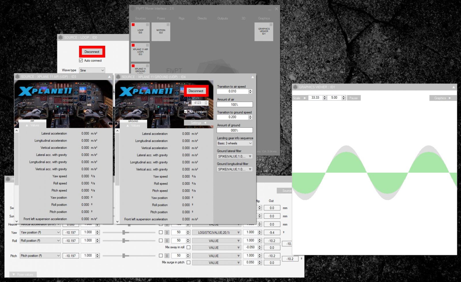

    There are also two filters to filter the lateral and longitudinal accelerations when the aircraft is on the ground.
    This is used to eliminate the spikes sent by XPlane (bug from XPlane?).
    In those filters, I recommend the use of the the filter SPIKE (since 2.5).
    The spike filter is used to remove big changes in values.
    We use two values to define the filter:
    First one is the diference accepted, for example 3.0
    Second one, amount of diference used, for example 0.05 (5%)

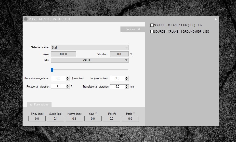

    That info can be used to generate vibration on the rig through the use of the pose "Noise of value".
    What it makes is generate random noise from a received value. The received value alters the amplitude and frequency of the noise depending on it's value.
    Select the sources and value you want to generate vibration.
    You can use a filter to change the behaviour of the value.
    Select the amount of rotation and translation used in the vibration (maximum amplitude)
    The "use value range from" and to is to specify the range of the selected value that defines the minimum and maximum vibration. Beyond those values, vibration is constant.
    Play with the toy ;) there's some interesting cues there, specially in aircraft's.
